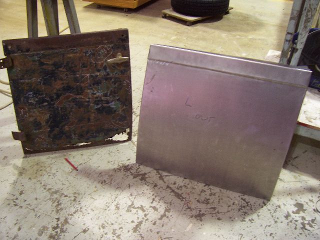

    want to get something done real quick and a pickup i can use everyday to carry a bit of stuff.
    roadster quarters are first up once the rpu is done, then closed cab pickup then eventually coupe!
    going to measure up a original rpu back section on saturday
    heres a pic of the inner door skins, probably will leave it without any holes or swages

    outer skins are starting to look good, 75mm longer than standard

    yes it has and we are within a couple of millimeters, you could use our panels as a replacement for an original one

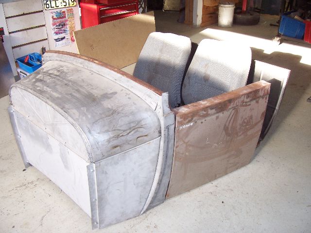

    making the bucks takes lots of hours(so far we have been on this about 3 months, all day saturdays and most afternoons after work)
    the cowl top is probably the most labour intensive with about 3-4 hours in it.
    the firewall pieces are easy with about half to an hour.
    cowl sides are probably 1 1/2 hours each as they have to be e wheeled.
    posts are about 1 1/2 hours as are inner door skins.
    outer skins a bit longer as they have to be e wheeled.
    then we still have to put it all together, fit the hinges and locks, steel it out, make the back section, still a way to go yet
    the aluminium is a good drift as it is softer than the steel. i round off all the edges on a belt sander first and occaisionally have to dress up the edges as the can get dented and fold over, causing more marks in the steel
