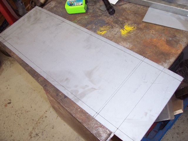

    started on the rear cab side pieces today. mark out all your folds onto the piece of steel first, somne have to be marked on the other side as you have to fold both ways to make the swage line around the top and the botttom
