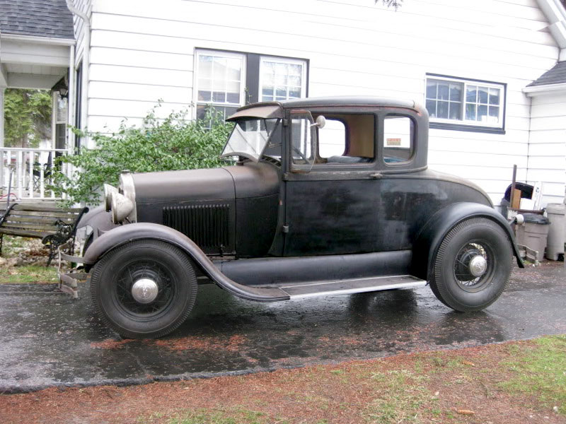

    Kev, Got to agree that Joe McClelland's Sports Coupe is the way to GO ! Just the right profile and stance. Seems to fit your idea of a sport coupe. Just add the right little changes to make it yours.

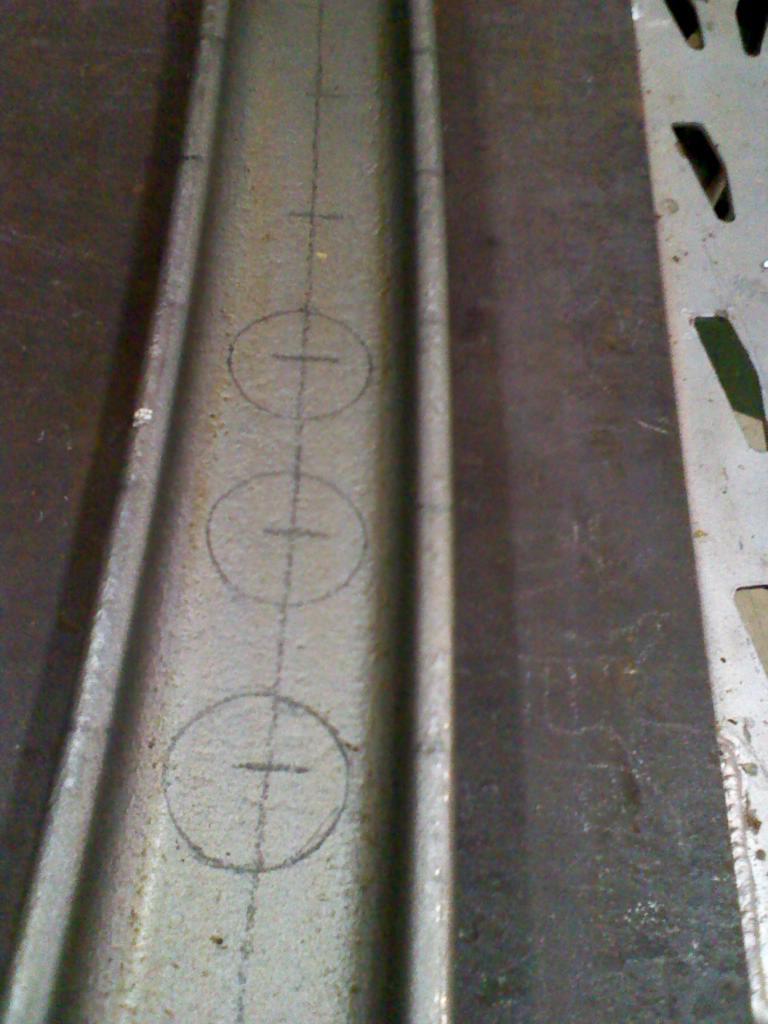

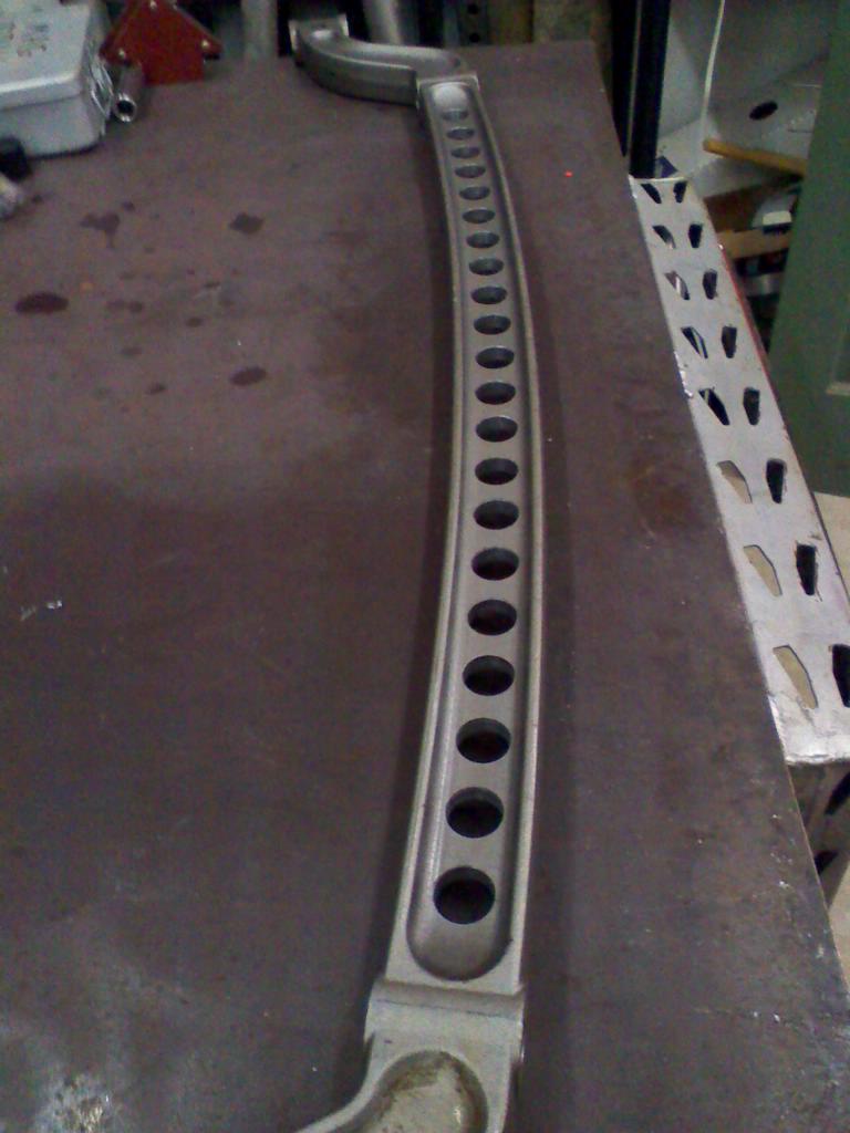

    Got some more work done tonight. Drilled the new SoCal 4" dropped axle with (21) 1" holes. I used a Milwaukee Magnetic Slugger drill. This is by far the best tool for this job. Drills a perfect hole and only took about an hour from start to finish. After a little de-burring it should be ready for paint or chrome. The SoCal axle is a killer piece. The quality is the best I've seen.
    Here's a few pics....

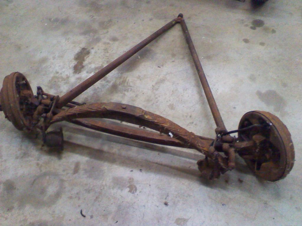

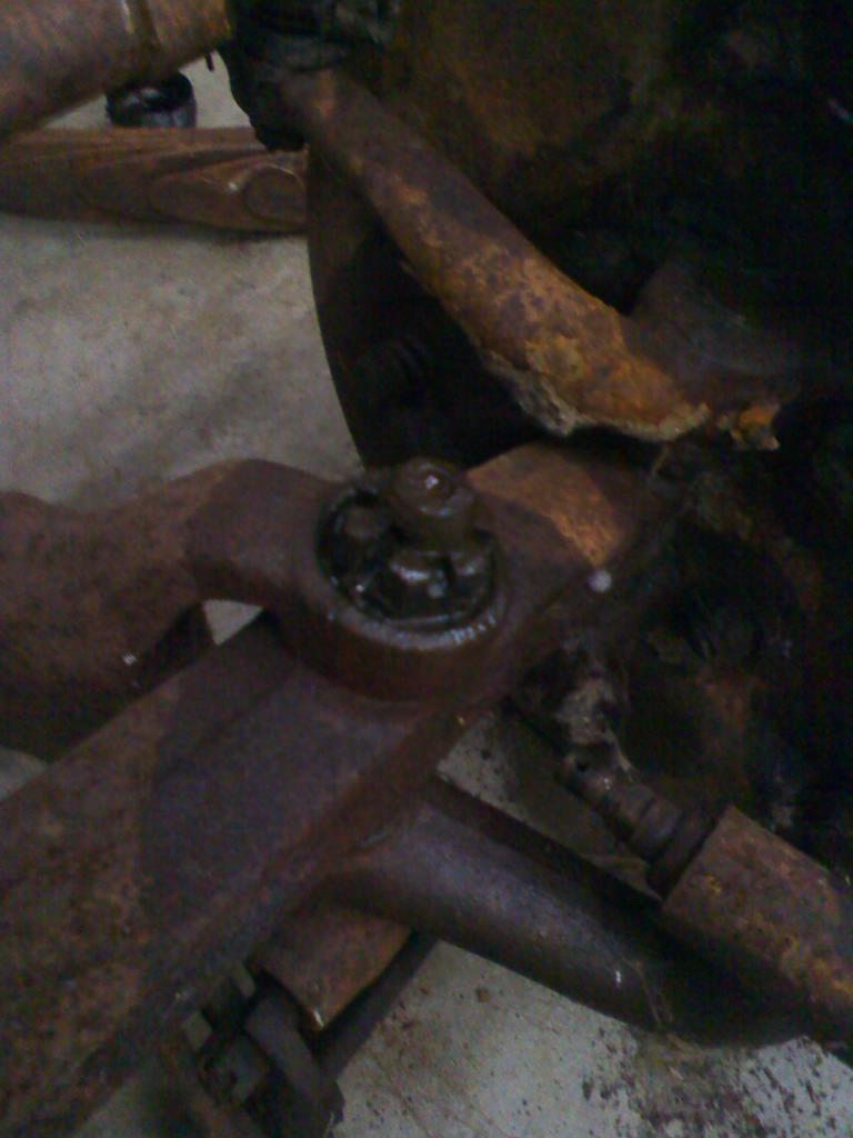

    I've been stripping a '40 Ford frontend this morning for the brakes and wishbones. Everything was going JUST FINE.... Then the perch bolts. Damn they are stuck. Here's a few pictures.
    Any tricks to getting these damn perch bolts out?

    Oh man, this car is going to be cool. I love the plans and the axle looks awesome. Tell me more about that contraption you used to drill it with, never seen anything like that before. So is it getting a 4cyl. engine or a V8?
    Did you use some heat from a torch on the frozen bolts? That might free them up. You said something about wire wheels? Lets see your plans on that.
    Keep up the good work. Glad to see you working on this one again.

    The drill is a Milwaukee magnetic base drill that uses a broach type bit similar to an end mill. It has a spring loaded center pin to line everything up with your punch mark. It's intended use is for steel fabrication, for column base plates. We use it in the electrical field for all kinds of different things. It also works great on Hot rod stuff. ;)

    I'm going to put some heat on the frontend parts in the morning. After a couple of ****** knuckles from the hammer and chizzle... I'm done beating on it.
