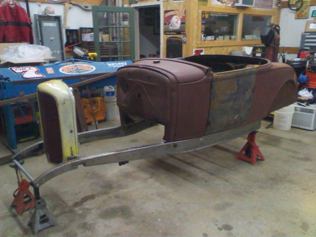

    Mine too Jeffrey. Just about perfect in my eyes. Here's what I have for later... Will it look as good without fenders?

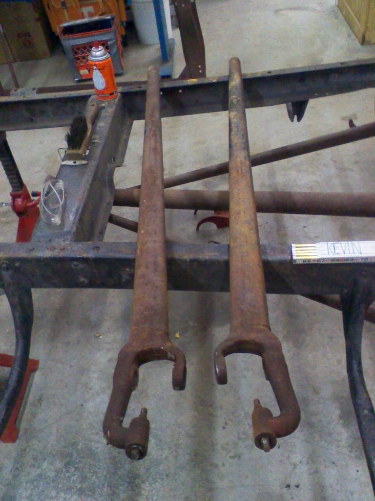

    Any clues on adapting '40 brakes to an A model rear end?
  6. OoltewahSpeedShop
    Joined: Oct 18, 2007
    Posts: 3,103
    OoltewahSpeedShop
    I scavenged a '40 rear end. School me on the way to adapt it.

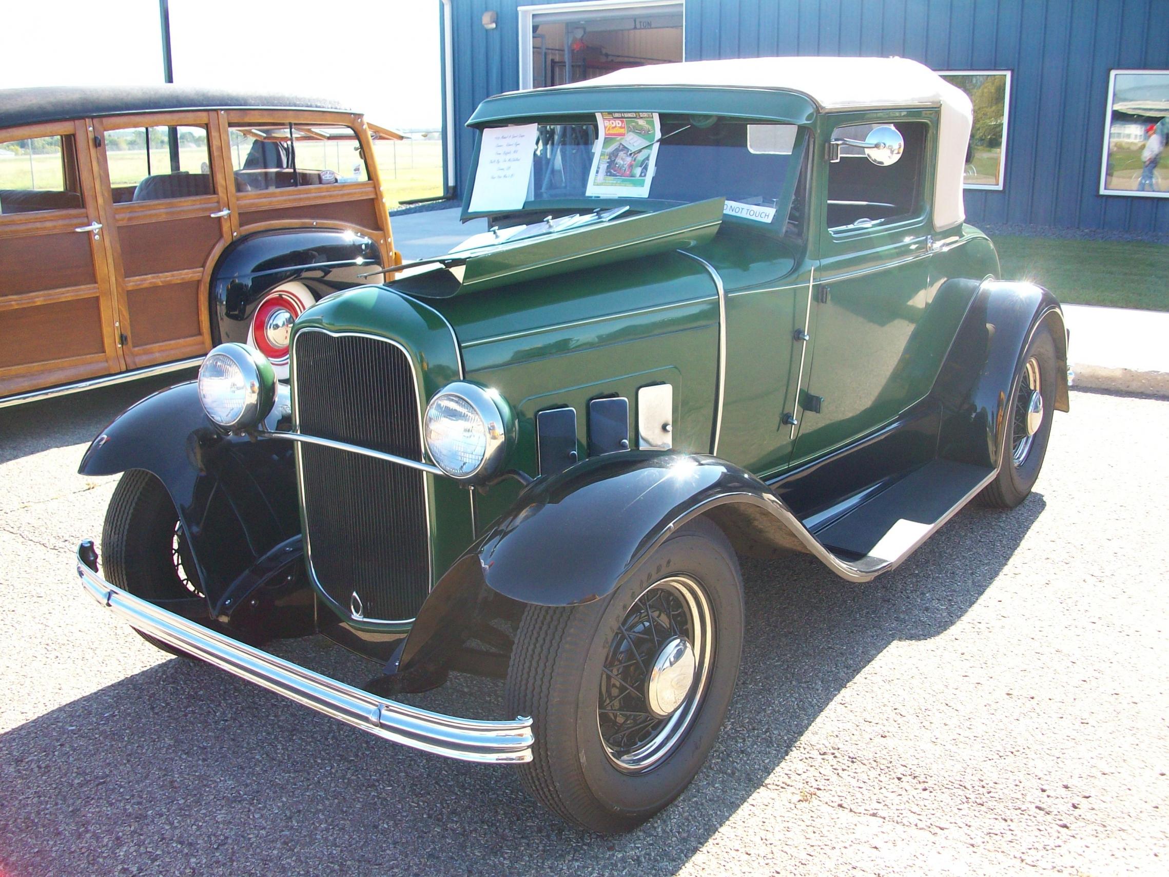

    I took these pics in South Dakota last summer
  11. OoltewahSpeedShop
    Posts: 3,103
    OoltewahSpeedShop
    I wonder if the present caretaker is a Hamb guy? I'd love to get some recent details on this car. Is it still banger powered?
  12. Fomocokid
    Joined: Aug 1, 2009
    Posts: 573
    Fomocokid
    from Rapid City
    Sorry I honestly can not remember for certain but I think it was
  13. Chris
    Joined: Jan 5, 2005
    Posts: 14,500
    Chris
    No, V8...look at the shot of the back with the hood open, you can see the head

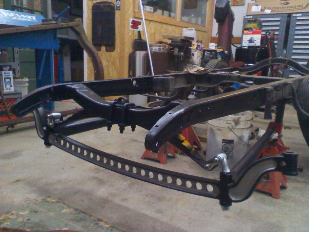

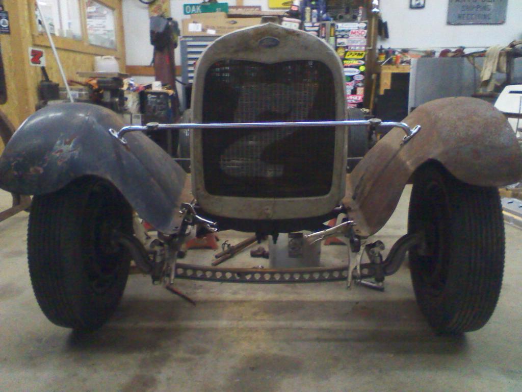

    Posting these up for Kevin, his computer's on the fritz. I'll let him explain what's going on though.
    Here are the new pics....
  20. OoltewahSpeedShop
    Posts: 3,103
    OoltewahSpeedShop

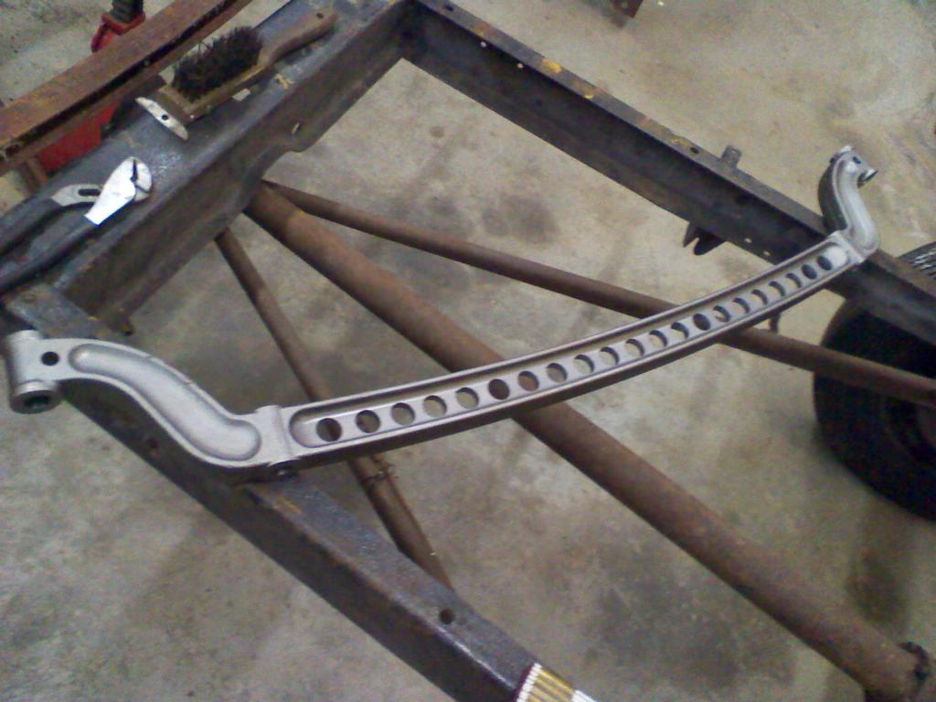

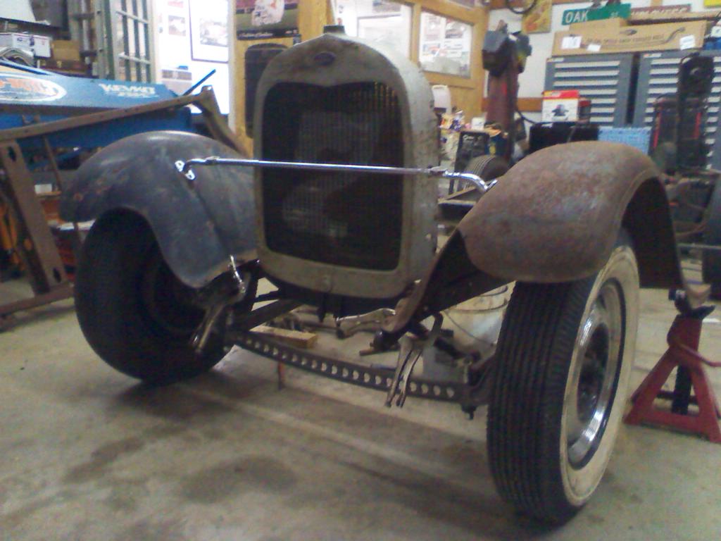

    First of all, thanks for posting the pics Jason. The Hamb is a great thing. Pics from Tennessee posted by your buddy in Hawaii, pretty cool.
    I used a set of '40 wishbones, cut the old spring hangers off, wire brushed them good. I decided to use heim joints on the bones because I already had them. We cut them down to 40" so they would clear the running board brackets and battery box, since we are running fenders. I'm planning on leaving the battery in the stock location, but don't know if it will clear the hyd brake stuff?
    I planned on using the stock A model front spring with a few leaves removed. It is mocked up in the shots with the fenders, but it's to wide. The So Cal axle perches are 2" narrower than stock. So.... I went with a Posie's reversed eye spring.
    In the last couple of shots everything is painted semi gloss black with the inset of the axle painted a metallic nickle. I'm using Superbell dropped steering arms on '40 spindles after I cut off the stock arms.
    I'm cleaning up the rest of the front brake stuff and getting them ready for paint. Up next is adapting the '40 rear end and torque tube to the '29 ch***is and banger.

    After a bunch of looking and measuring, the splines on the '40 enclosed drive shaft seem to be the same as the A model. On the trans end anyway.... Is this right? I thought I read somewhere I would have to respline the shaft to fit? I know it will have to be shortened, but is that all?

    JeffreyJames
    from SUGAR CITY
    I thought they were different as well. Check with Chris or look through his threads because I believe that he had to change over the splined because they were different. Maybe on his roadster?

    Chris got me straightened out on the drive shaft. The transmission end of the shaft is the same on the '40 & '29. So next up is shortening up the '40 torque tube, shaft & wishbones to fit the A model wheelbase. I'm going to leave the spring behind on the rearend, so there will be a little bit of fab work on the rear crossmember.
