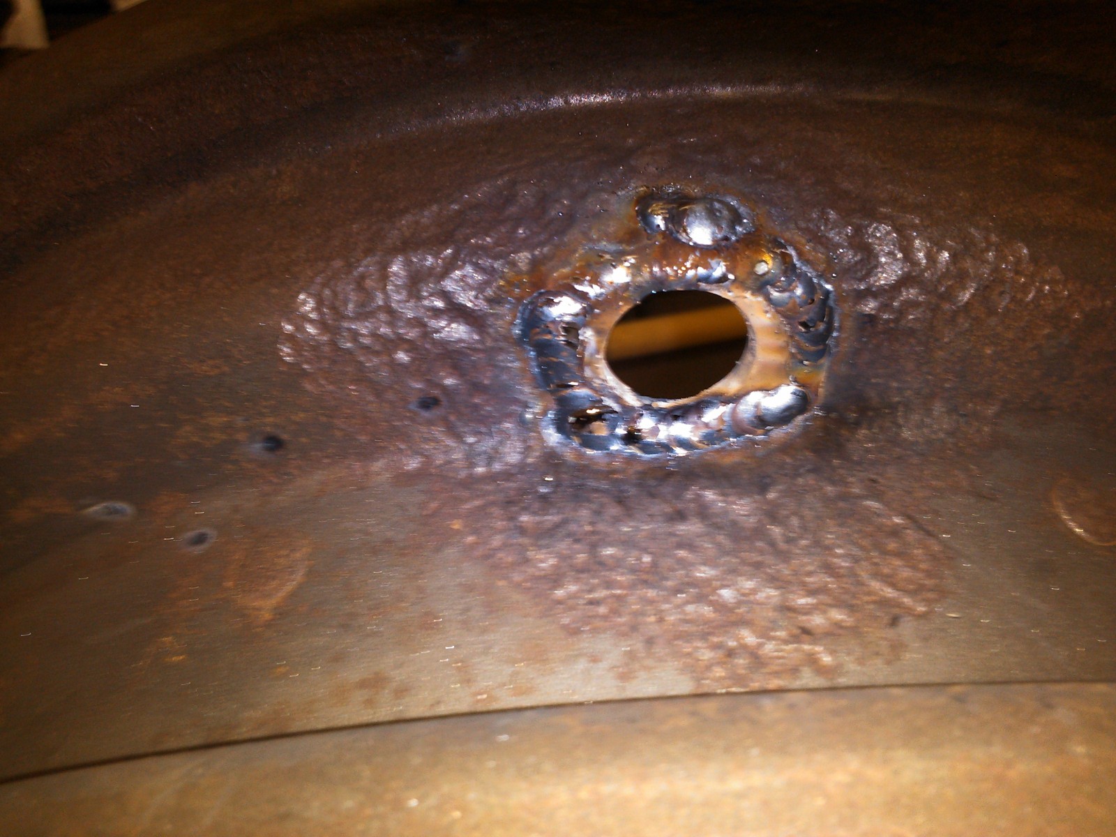

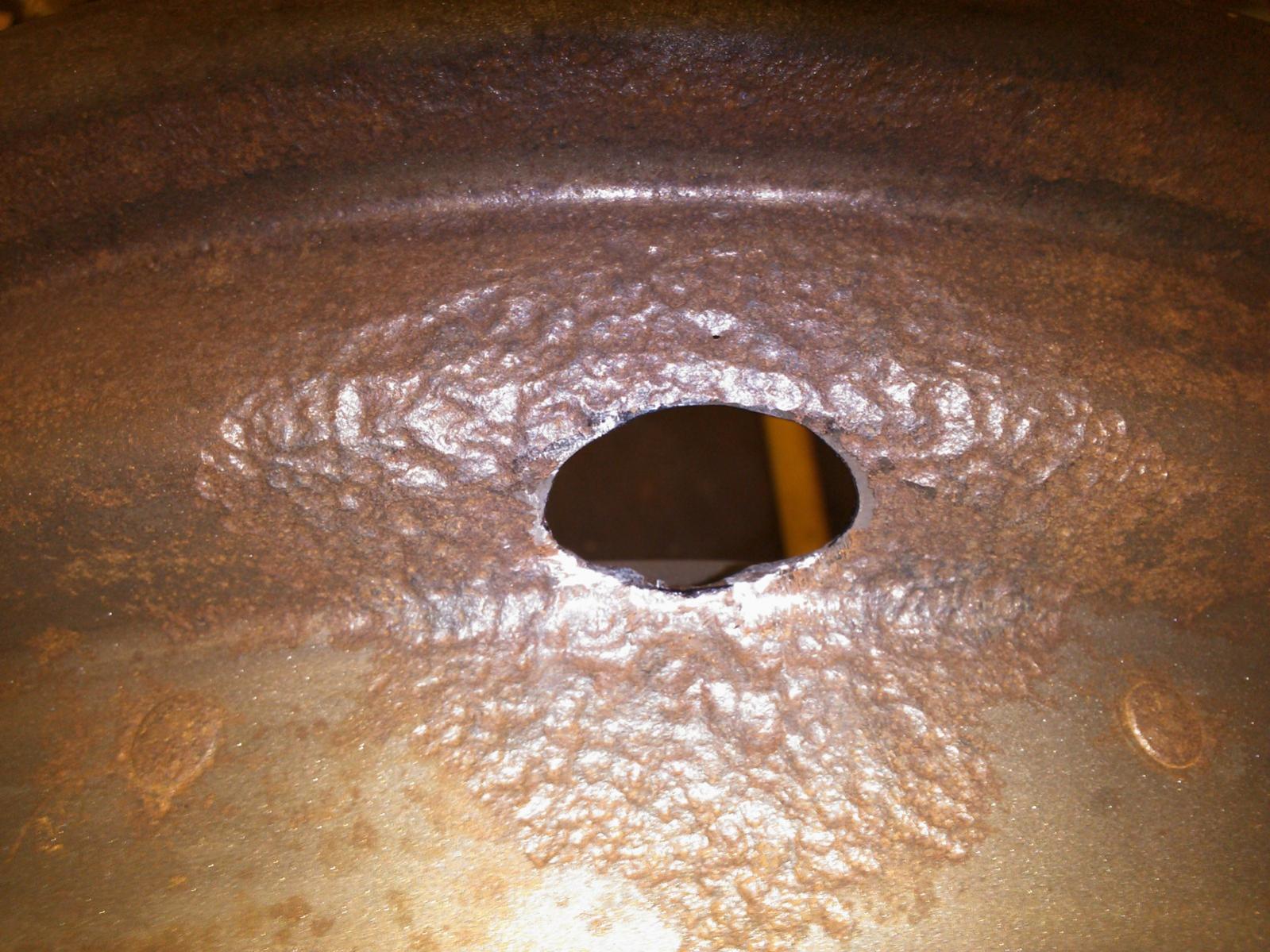

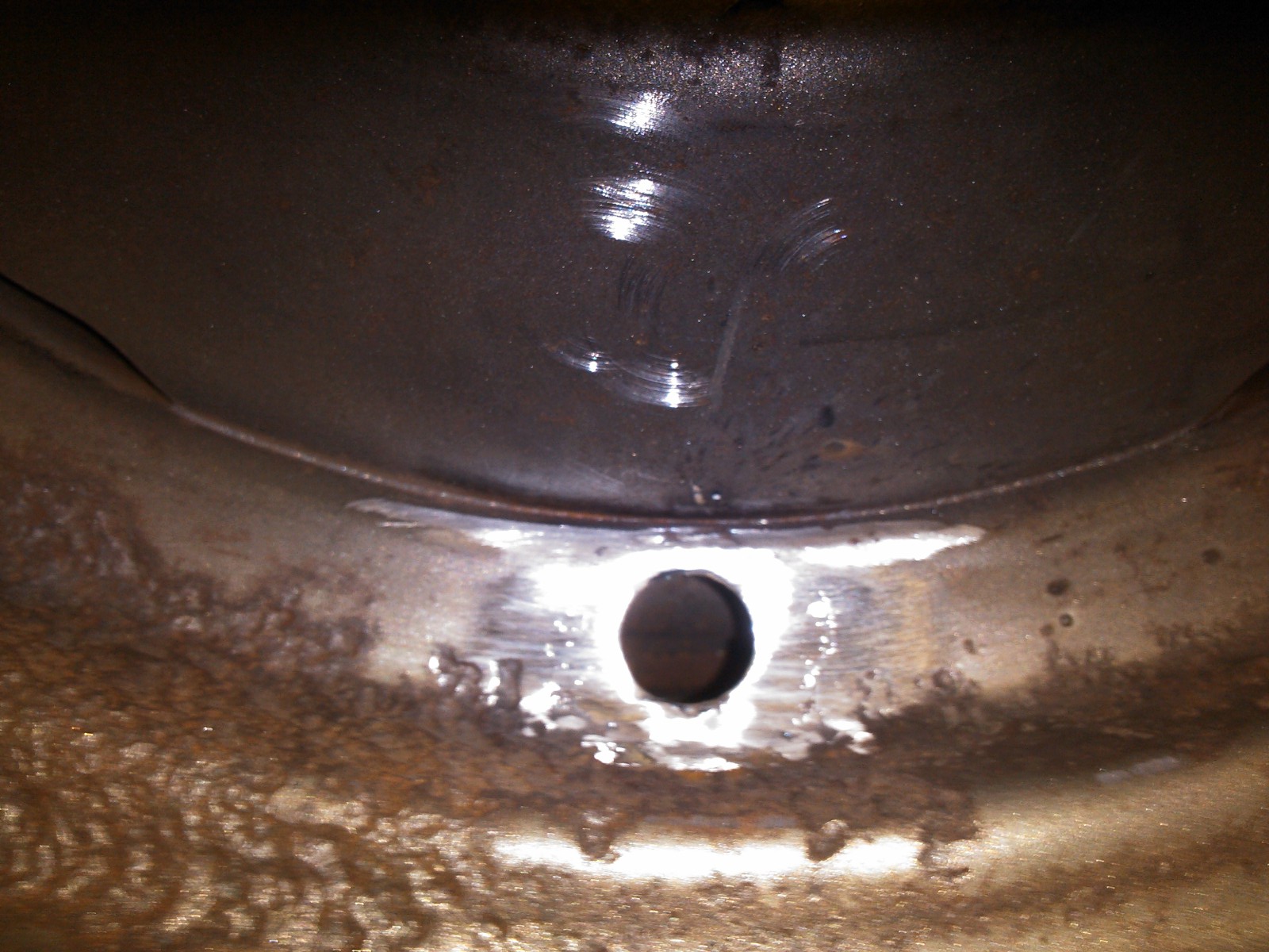

    I looked through the stash and drug out these wheels. 2-16X4 and 2-16x4.5 that were pretty rough. I hung onto them because they savable, but they needed some TLC. I blasted them this morning and got to work on the damage. Someone had obviously cut the old tires off with a die grinder and cut thru the outer rims on 2 of them and one had a rusted out stem hole. Didn't take pics of the rim damage, but it was an easy fix. Here's how I fixed the stem hole.
    5/8" flat washer fit the valve stem perfect so I die ground the rust back to clean metal and cut the washer down to fit the hole. Zipped it up and smoothed it back down. Easy peasy.... ;)

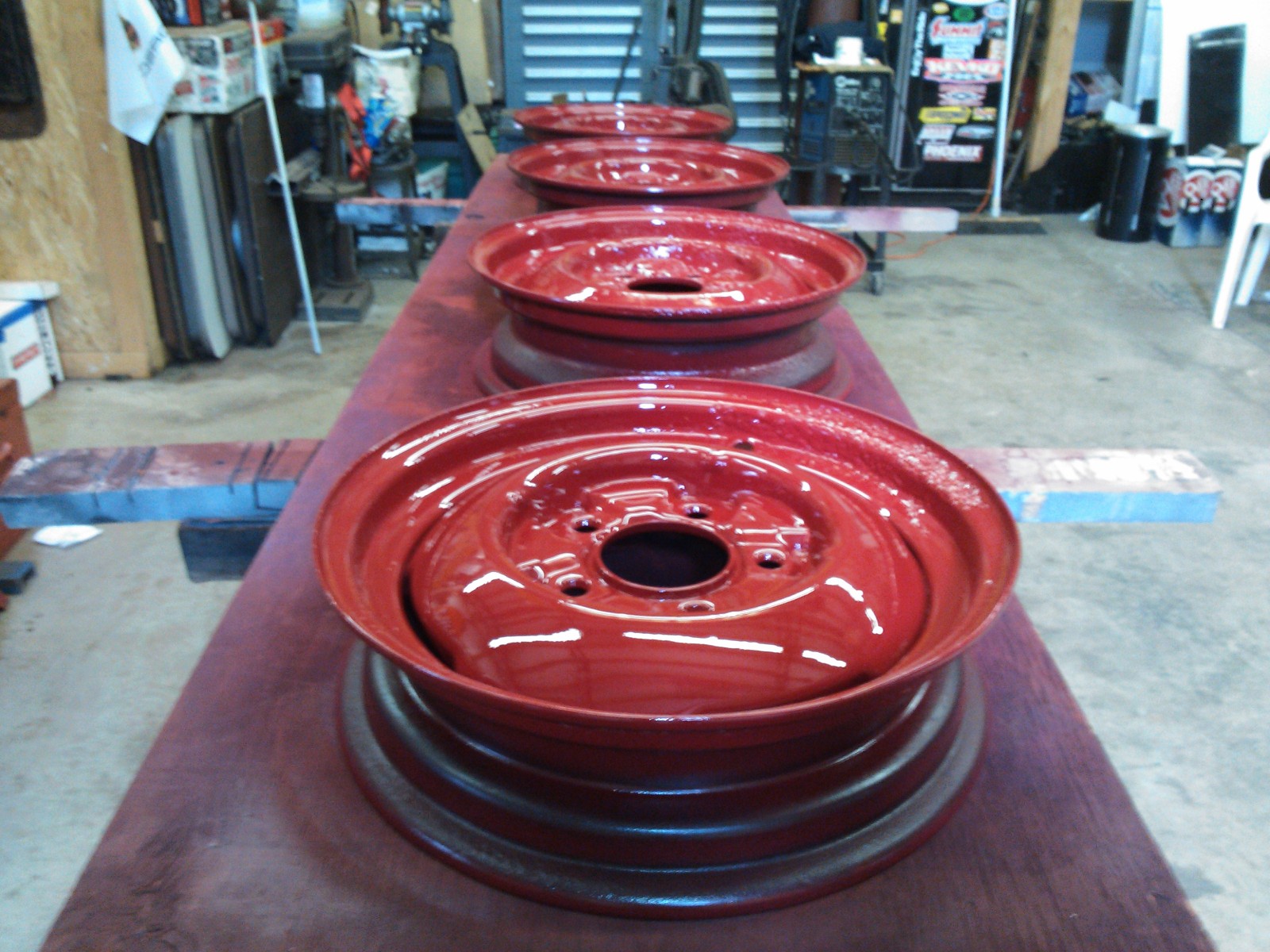

    After getting all the issues straightened out, now it's time for some primer and paint. The seats are dark red, so I went with it on the wheels too.

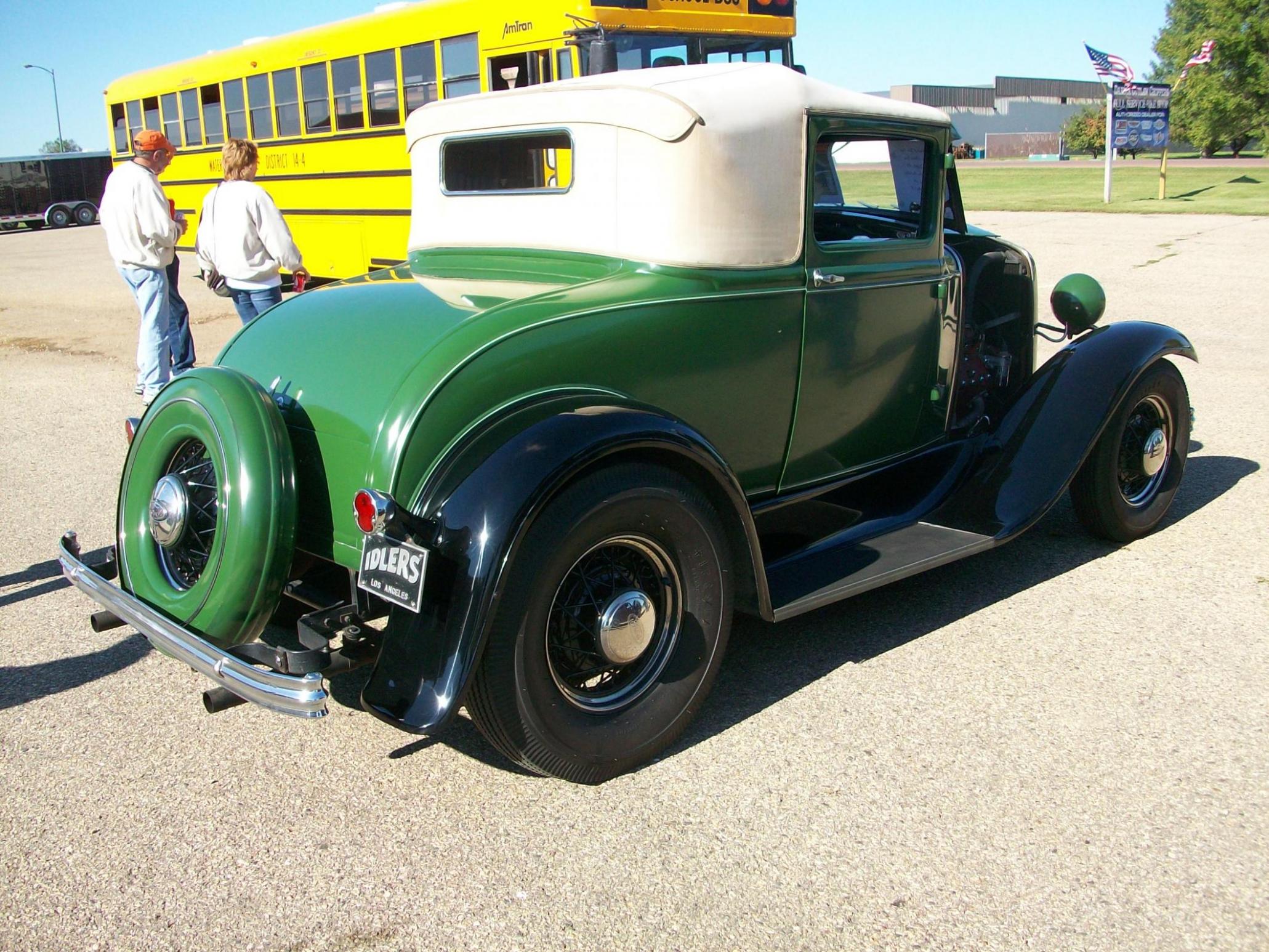

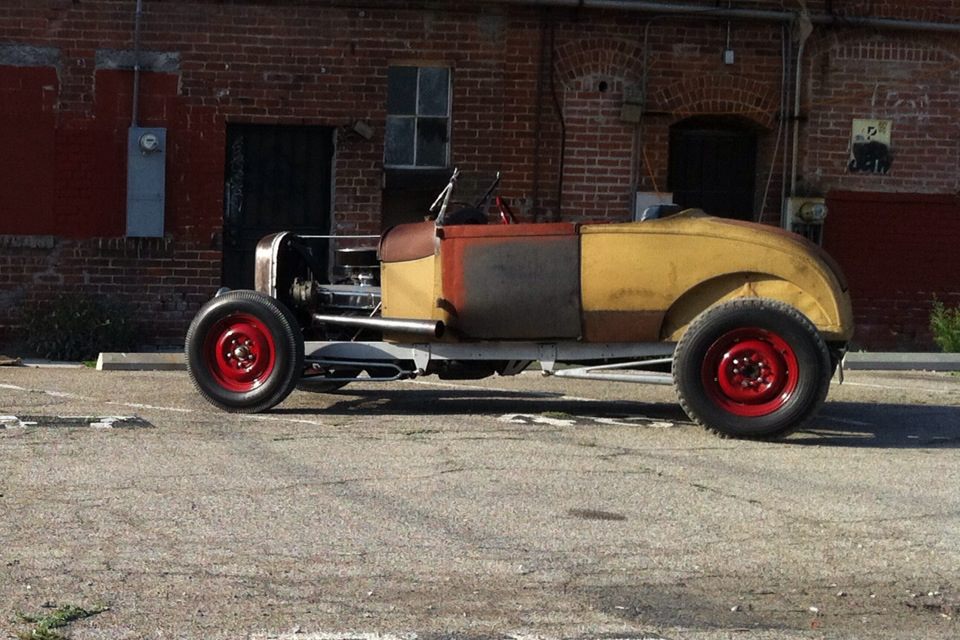

    your car has a Trunk lid and the Business Coupe eliptical brace for the Oval 1/4 Window and the sport coupe Rear Bow ? changed sometime in the past ? here is my 29 Business Coupe Brace with the Short Bow and Boot Brace that attaches to the Eliptical.

    Mine is a very early '29 Business Coupe that never had the oval window. According to what I learned from the Ford Barn guys, mid year 1929 the top bows changed a little and the Business Coupe's got the oval windows. Trust me, these top bows have NEVER been off the car (until today). We originally thought it was a Sport Coupe, hence the thread ***le.

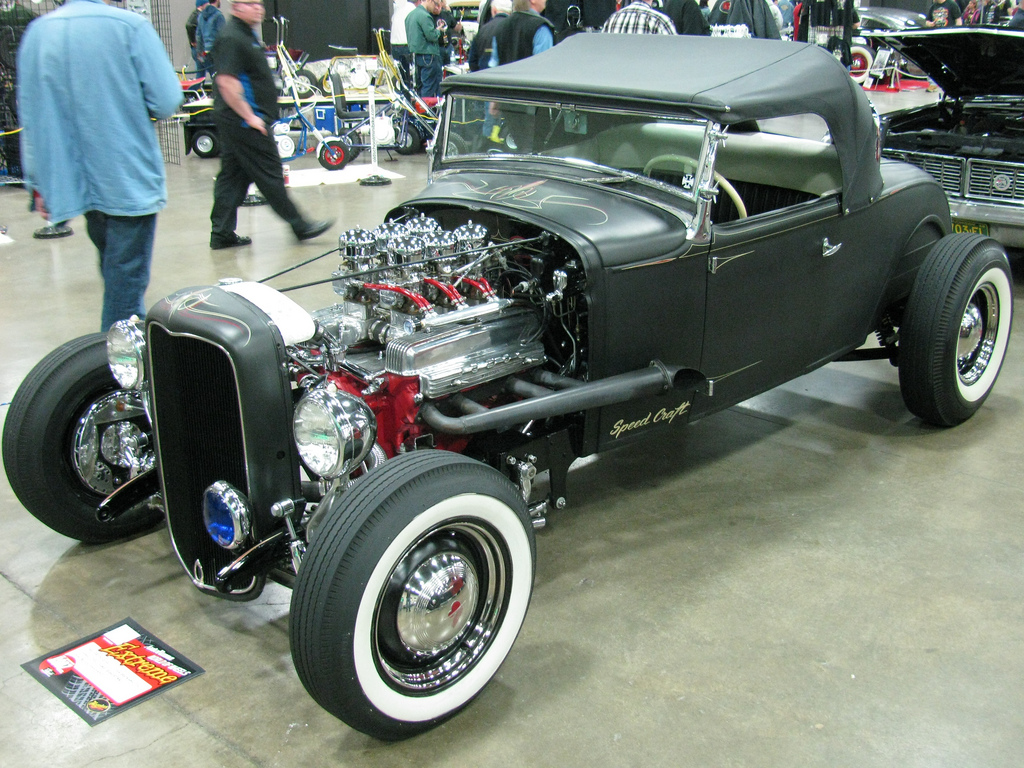

    After the ooo's and ahhh's.... It was time to get dirty. I've looked at every picture that I could find of these cars for a few years now trying to decide what to do with the top. These cars are WAY to tall in stock form to look like a Hot Rod. So these pictures were what I decided it needed to look like.
    2-3" chop, no more.... I decided on 2"
