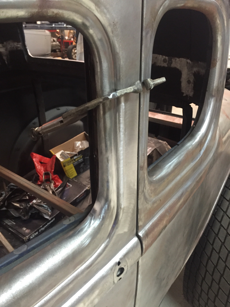

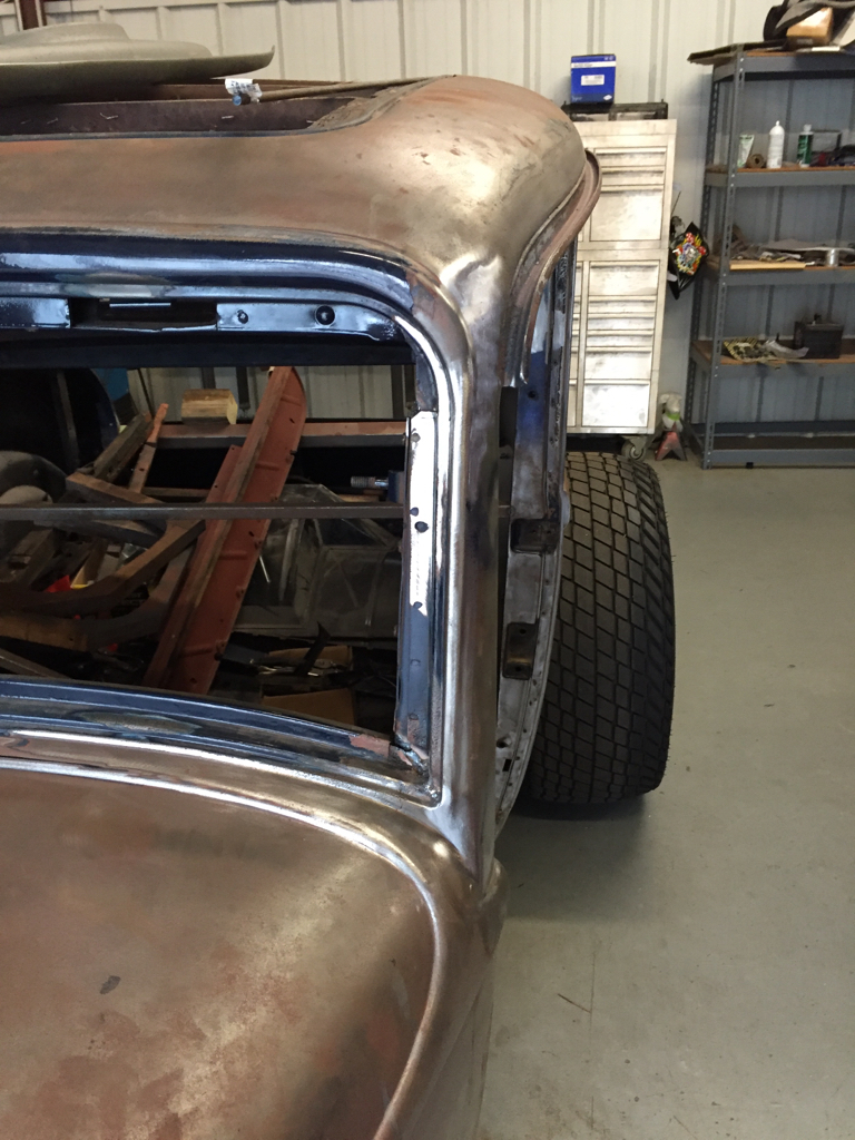

    Progress on the top chop. P***enger A pillar almost finished. Just needs some clean up in the corners.

    Progress on the top chop. Drivers side A pillar almost finished. Just needs some clean up in the corners. #brucesrodshop #32mafia ImageUploadedByH.A.M.B.1446993692.847639.jpg ImageUploadedByH.A.M.B.1446993710.655314.jpg ImageUploadedByH.A.M.B.1446993722.144332.jpg

    P***enger door almost finished. #brucesrodshop #32mafia ImageUploadedByH.A.M.B.1447088899.460116.jpg ImageUploadedByH.A.M.B.1447088912.931337.jpg ImageUploadedByH.A.M.B.1447088925.287176.jpg

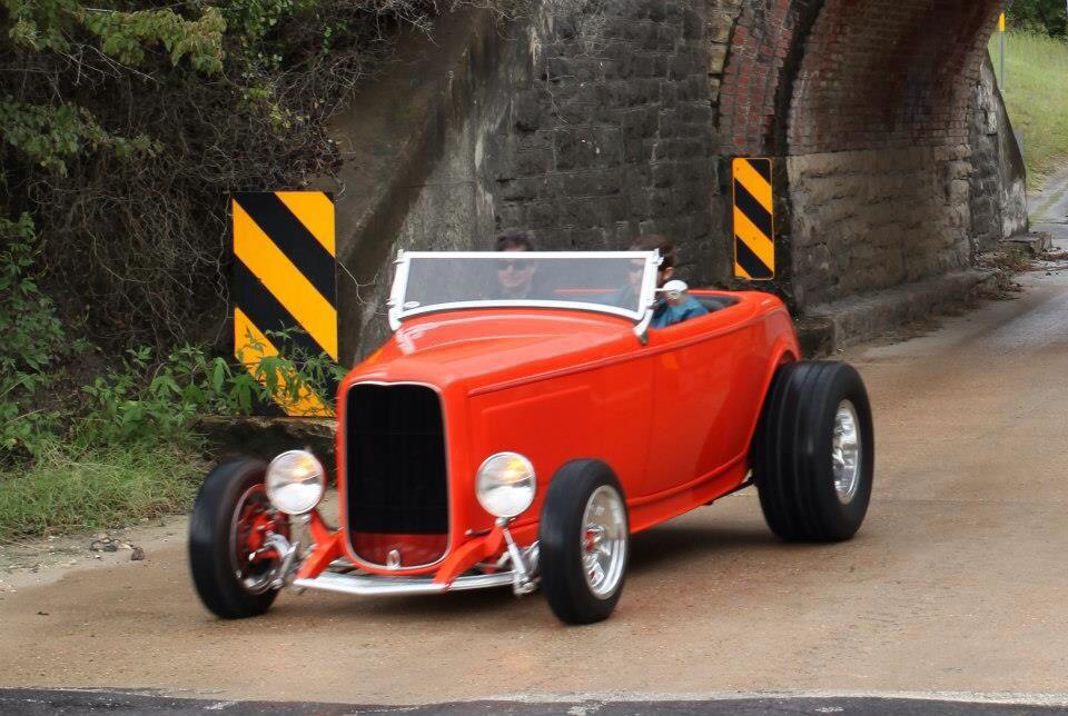

    My old roadster. Hugger orange. I built it back in '98. ImageUploadedByH.A.M.B.1447099516.520302.jpg

    Looks like you knew a thing or two about tire sizes even way back then.

    Thanks. I strive to hit the perfect stance and tire combination on every build.

    Did you lean the a pillars back?
    If so did you slice the cowl and lean that back as well?
    Thanks
  18. hot rod pro
    Joined: Jun 1, 2005
    Posts: 2,710
    hot rod pro
    from spring tx.
    Yes. I leaned the post back. Here is where I cut it ImageUploadedByH.A.M.B.1447261018.316756.jpg ImageUploadedByH.A.M.B.1447261033.437086.jpg ImageUploadedByH.A.M.B.1447261046.559799.jpg ImageUploadedByH.A.M.B.1447261057.996516.jpg

    So you left the bottom of the window trough alone? I've seen it leaned back as well
  20. hot rod pro
    Joined: Jun 1, 2005
    Posts: 2,710
    hot rod pro
    from spring tx.
    No. It stayed the same. The little amount I leaned the posts back, it didn't need it.

    Are the hinges twisted, or adjusted to keep both axis in-line?
  24. hot rod pro
    Joined: Jun 1, 2005
    Posts: 2,710
    hot rod pro
    from spring tx.
    The upper hinge is slightly out of alignment with the bottom hinge, but the door swings just fine. I plan to leave it.

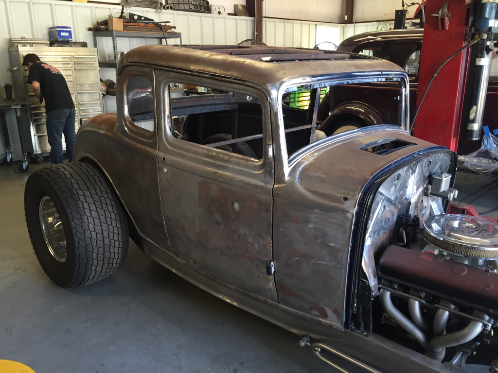

    A few new shots. ImageUploadedByH.A.M.B.1447841928.561839.jpg ImageUploadedByH.A.M.B.1447841941.133759.jpg ImageUploadedByH.A.M.B.1447841954.239535.jpg ImageUploadedByH.A.M.B.1447841965.062151.jpg

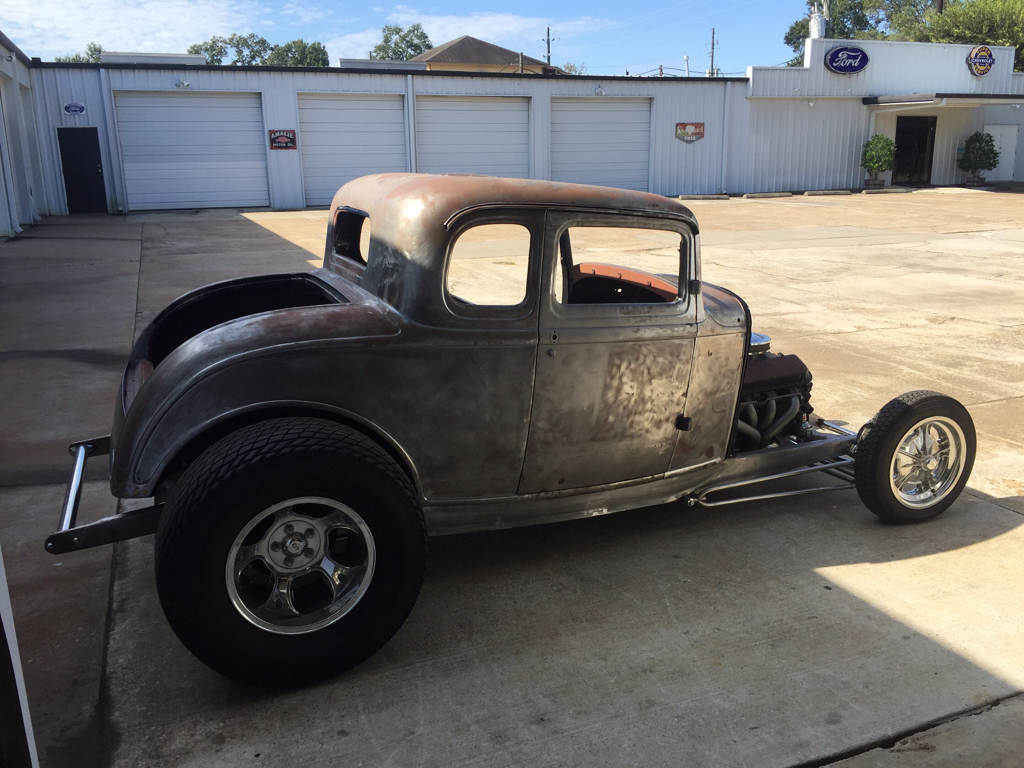

    Just a few new pictures. ImageUploadedByH.A.M.B.1448198027.325359.jpg ImageUploadedByH.A.M.B.1448198037.229715.jpg ImageUploadedByH.A.M.B.1448198049.018302.jpg
