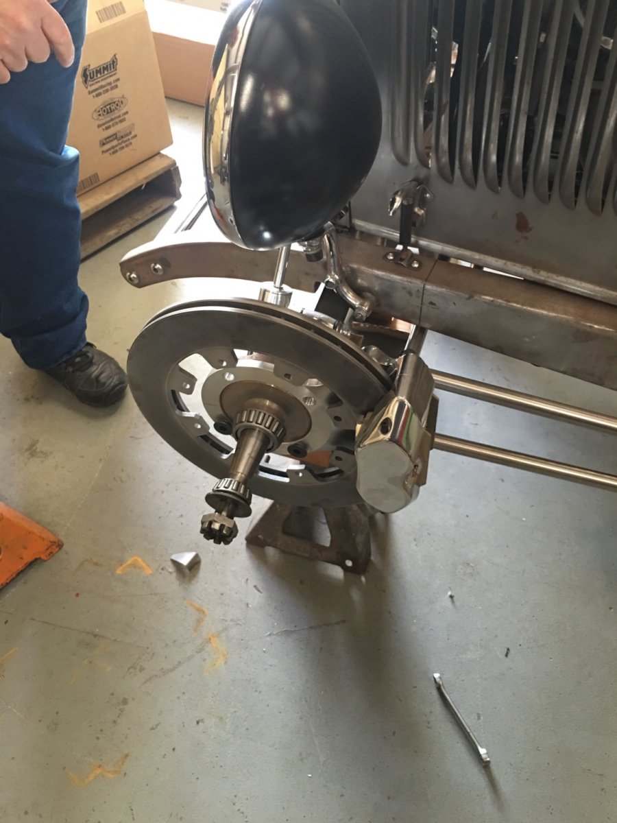

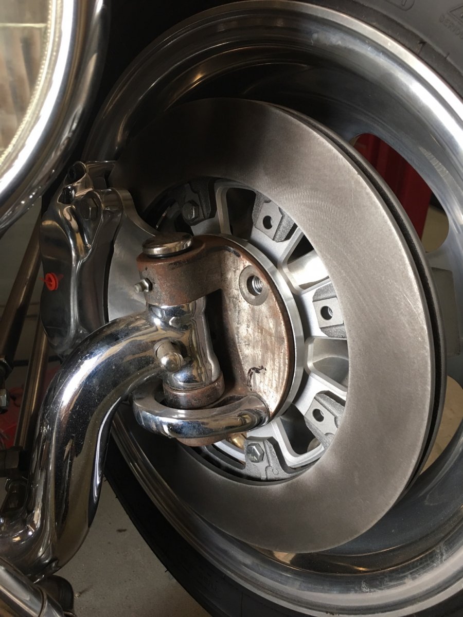

    Machined me a custom front brake kit for my spindle mount wheels. #brucesrodshop #32mafia ImageUploadedByH.A.M.B.1462496069.553120.jpg ImageUploadedByH.A.M.B.1462496081.333731.jpg ImageUploadedByH.A.M.B.1462496094.820435.jpg ImageUploadedByH.A.M.B.1462496107.618214.jpg ImageUploadedByH.A.M.B.1462496120.254323.jpg ImageUploadedByH.A.M.B.1462496134.355402.jpg ImageUploadedByH.A.M.B.1462496144.890194.jpg

  19. That's a neat bit of engineering right there.
  20. deucetruck
    Joined: Jan 8, 2010
    Posts: 763
    deucetruck
    from Missouri
    True art on wheels ( no pun intended - well maybe a little!) :) Very neat.
  21. Just Gary
    Joined: Oct 9, 2002
    Posts: 5,814
    Just Gary
    Beautiful work.
    A few questions:
    1) Did you consider using stock Ford spindles with the arms still attached?
    2) How much are your steering arms dropped to fit through the hairpins?
    3) Are those Wilwood brake calipers... with the logo ground off?
    Thanks!!!
  22. hot rod pro
    Joined: Jun 1, 2005
    Posts: 2,710
    hot rod pro
    from spring tx.
    This is a 5" drop axle. Had I used a 4" drop I could have used stock spindles.
    Super Bell sells the arms flat for going over wish bones, for 4" drop axles, for 5" drop axles, and deep drop for going under wish bones. I used the ones for 5" drop axles.
    These are older Wilwood calipers, before they started putting their logo on them.
    Thank you for the questions. Glad you like the progress.
