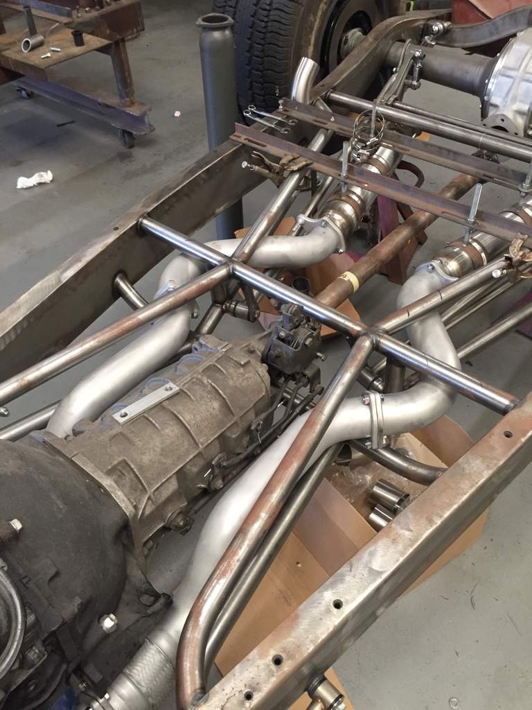

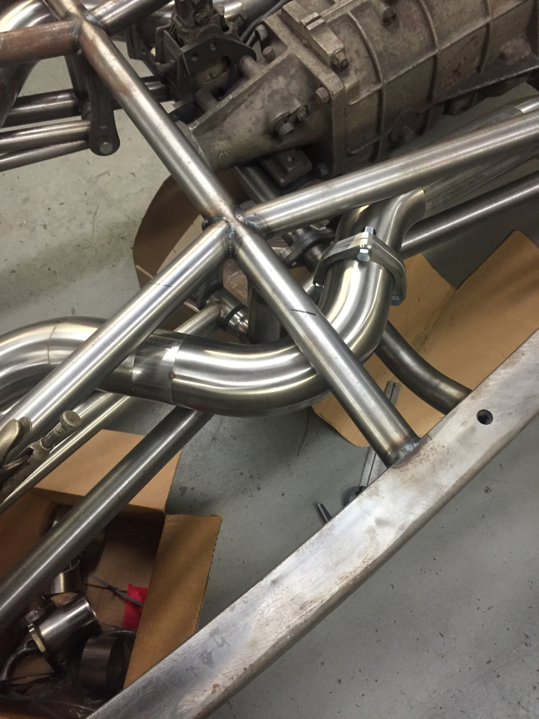

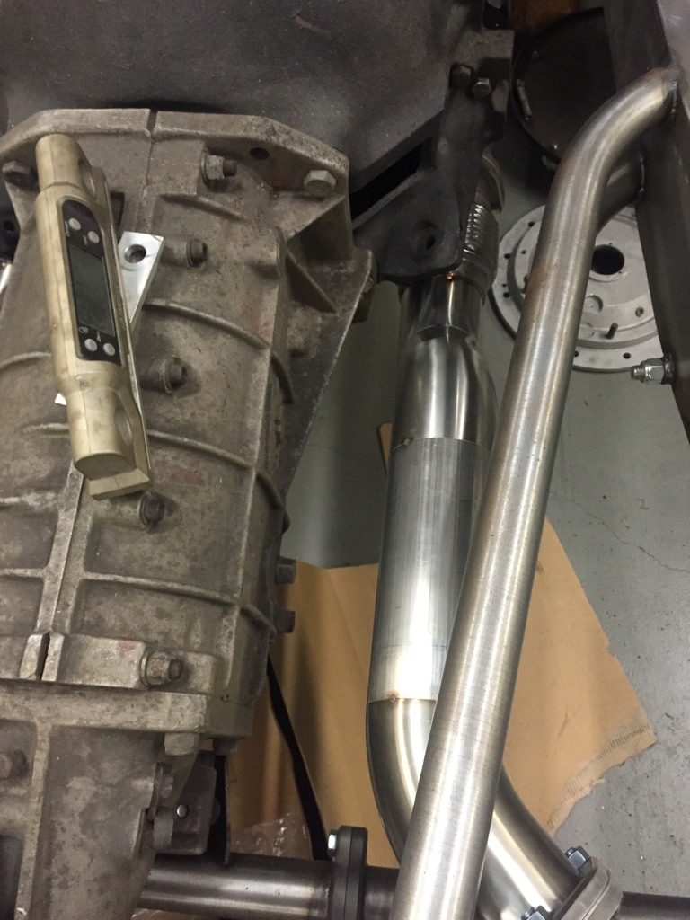

    Progress on the 3" exhaust. Finished the mockup on the p***enger side. I'm planning the crossover tube next. Stay tuned. ImageUploadedByH.A.M.B.1438868062.720924.jpg ImageUploadedByH.A.M.B.1438868075.313490.jpg ImageUploadedByH.A.M.B.1438868089.533691.jpg

    Those forged look brackets and mounts are INCREDIBLE. I want a set for my Ionia ch***is where the boxing plates are inset and dimpled. We need to figure out what info you need and such so I can run my Y-block on mounts you create.

    I love how everything is so completely thought out and detailed. This, fellas, is pure craftsmanship.

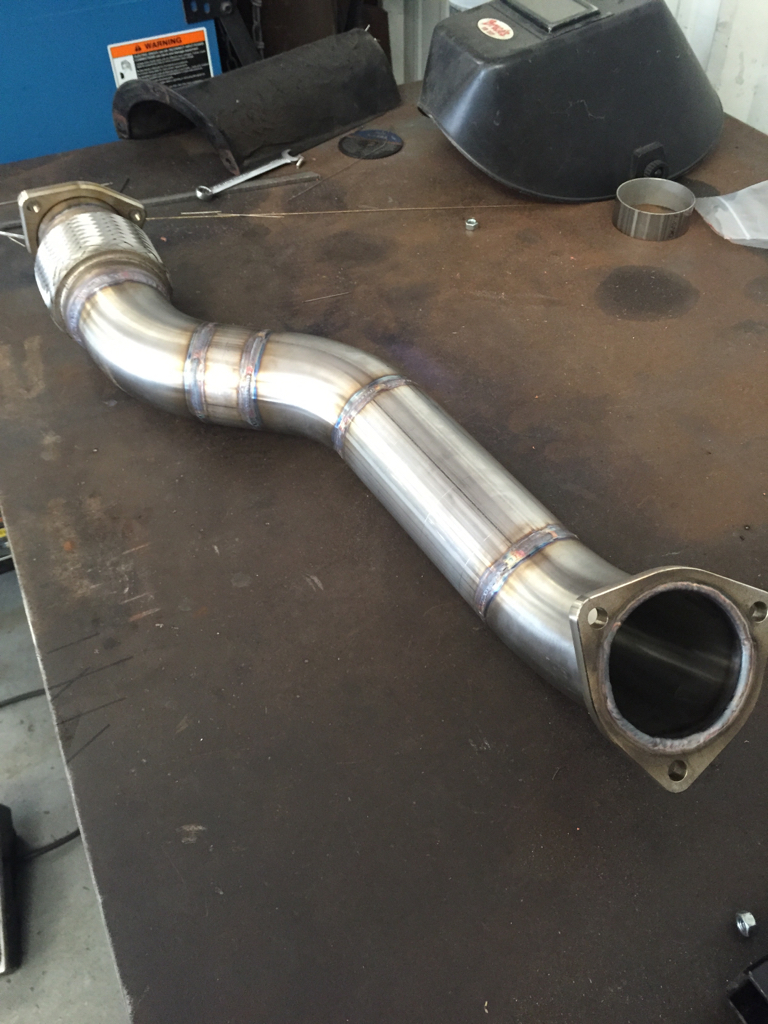

    Started welding the pipes up. I'm not too worried about how the welds look, they will be ground smooth. ImageUploadedByH.A.M.B.1438906293.296508.jpg ImageUploadedByH.A.M.B.1438906310.604138.jpg ImageUploadedByH.A.M.B.1438906324.410644.jpg

    Headers welded up. Cut the ugly tag off. ImageUploadedByH.A.M.B.1438953620.663491.jpg ImageUploadedByH.A.M.B.1438953631.018489.jpg ImageUploadedByH.A.M.B.1438953641.341186.jpg

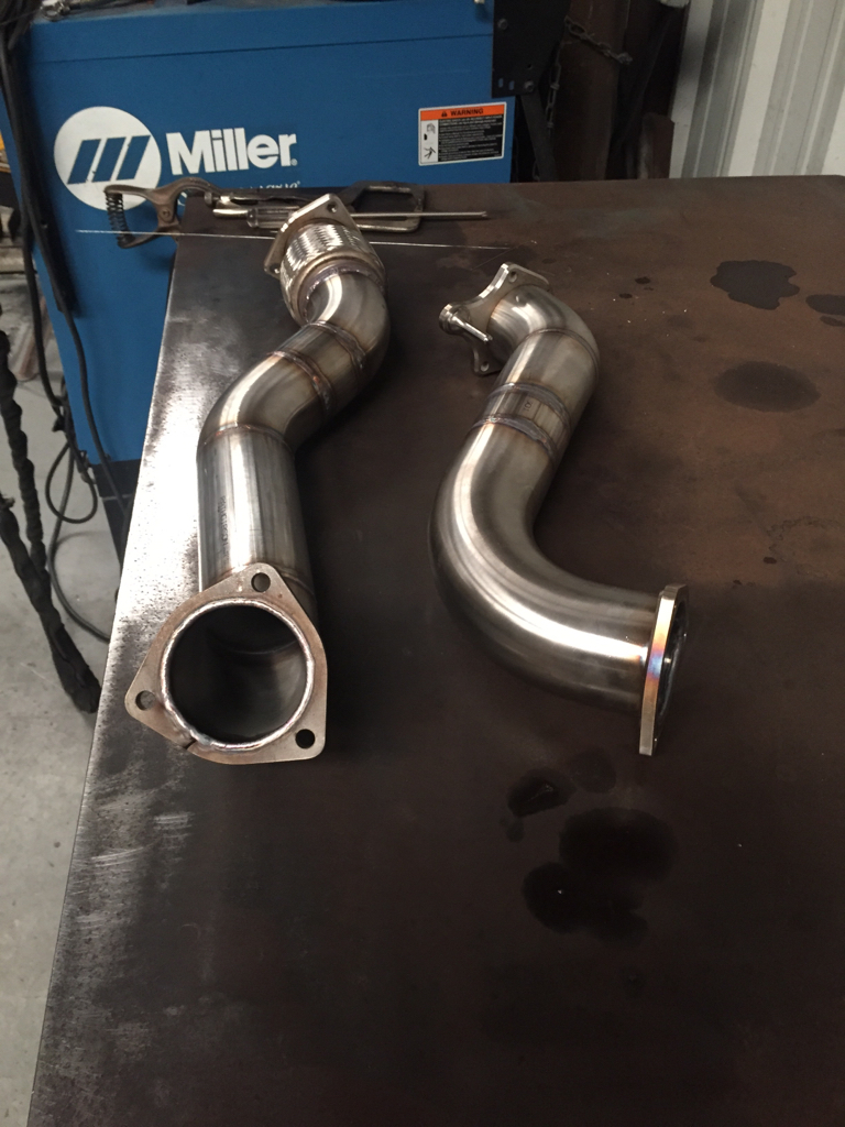

    P***enger side welded up. ImageUploadedByH.A.M.B.1438994108.825384.jpg ImageUploadedByH.A.M.B.1438994120.630730.jpg

    Can you give us the reason for the large diameter exhaust. Don't get me wrong love your work just wondering why the move to 3".

    On 427" and above motors, I use 3". On smaller motors I use 2.5".
    This motor is a 468" BBC
