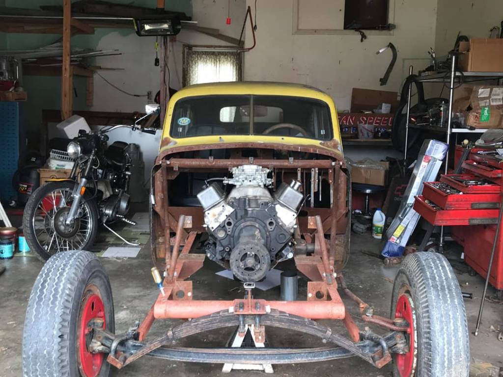

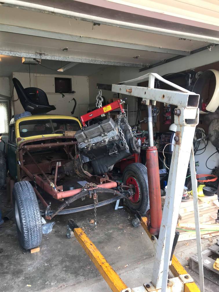

  7. OK fans finally a little progress. Not much but well I'm slow OK? @Austin kays came over to play yesterday. I had this old motor just hangin' on this old engine stand and it seemed like it may just fit real well in the Crosley. First the mundane.
    Never ceases to amaze me how much **** you got to do to hang a motor on a hoist. Especially when you are "super organized" like I am. Fortunately for him I think that Austin caught his organizational skills from @Tim and his patience from me. LOL
    Finally after some ***embly and moving things around we got the engine on the hoist and ready for the moment of truth.
    That cheap swap meet tilter ( I think that the missus gave 7 bucks for it :) ) is handier than pockets in a T shirt.
    Didn't take long to get it stabbed in the hole and basically set so that I can start building my frame mounts. It fits I am amazed.
    It isn't real easy to tell so just for chits n giggles we ended up with a 26" setback (give or take a fraction) and about 20" crank center. On a 111 inch (and change) wheel base that works out to about 23% (someone could get a calculator out and correct my numbers if they wanted to). It is almost an altered after all. ;)

    If you can’t sit a bucket seat in front of the motor it’s not shoved back enough. ****** school of engineering lol

  10. If you ask @raven he'll tell you that you can tell one that I built because you can stand between the frame horns and work on the motor. :D
    Yep, outta the Pusher I think this is the 5th or 6th car its been in. That old motor out of the Pusher is a Timex motor. I got lucky when I screwed that one together. ;)
    And absolutely correct, anyone with much sense take a young man under his wing and p***es the tradition on. Its does two things the skill doesn't die and it takes a lot of the load off of his old bones. ;)
    The down side to all this is that @Austin kays thinks that even an old 21 stud needs a little setback. :D

    Looks like it fits great. HRP
  14. I think I could have fit a V10 in there.LOL
    I saved your motor mount too.;)
  15. Well not to bounce my own thread (because it doesn't really need to be bounced) but I think I failed to mention that with the engine setting where it should be the GM side mounts land on the original flat caddy mounts. Makes building frame mounts a lot easier.

    Noticed that in your pictures porkn******. Should make that part a bit easier. I just figured that you planned it that way.;)
    chryslerfan55, loudbang and enloe like this.
  17. Nope just lucky. I have always been lucky when it comes to things with wheels. :D
    It amazes me how well my parts of choice are fitting, very little modification to make them go where the flat cad and the '39 transmission once was. The Kid was actually telling me as we were setting it in place that he recently read somewhere that the best replacement for a Caddy flathead was the SBC. As fitment goes I guess that they were right.
    We actually ran the tape on it a couple of weeks ago when we were seeing if the Sag was going to fit and the engine pretty much landed on our chalk marks. I was a little off on my setback calcs. I had figured 22-24" and we ended up with 26. If I can get to a set, I would like to scale my wheels when the build is done just to see my bias. I am thinking about 60/40 (front to back) but that is just a guestimation on my part.
