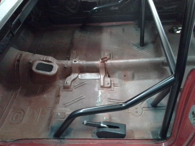

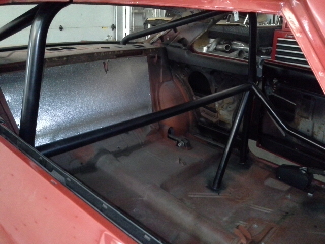

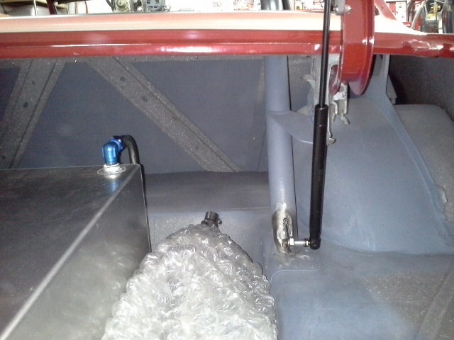

    My Nova is purely a street car but the upgrades I did on it are about the closest thing to a full tube ch***is while still retaining its full original floorpan.
    I built a 2x3" "backhalf" ch***is based on custom rails bent by Art Morrison from templates that I furnished, the thin original rear frame stubs were removed without altering the trunk pan, the new rails hug the stock floorpan kickup perfectly.
    I built the crossmembers as well as the subframe connectors, and tied it all together with an eight point roll bar based on Morrison components, the diagonal tubes off the main hoop run through the floor and tie into the subframe connectors, also tied it to the floor through the two floor drain plugs.
    By the way, those diagonal tubes are required when drag racing a unibody car, I don't believe the two forward (side) roll bar tubes are considered legal for drag racing but that was never part of my plan anyway.
    The original forward floorpan and front subframe are also tied in to the custom front crossmember and as with the rear suspension the front is not mentioned due to being a bit taboo here.

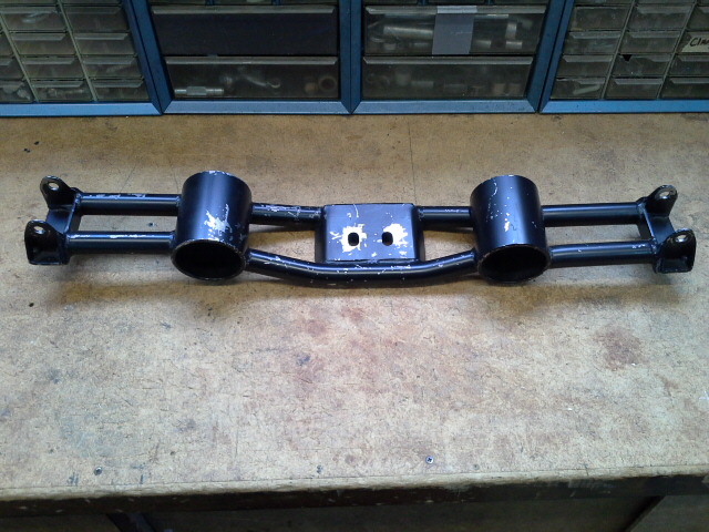

    Sorry, never took photos of the ch***is build but here are a couple topside shots, also a shot of the tubular trans (Muncie) crossmember which should also add some rigidity, the car is very low so the exhaust p***es through those two big tube sections.

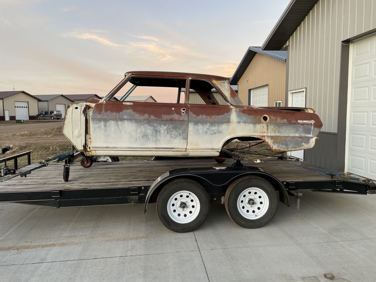

    Well, tomorrow I start moving 8lb of **** into a 15lb bag. The extra space will be nice, though it’s going to take some work to get the inside tinned out, a few more outlets, airlines etc.
    Shop that I sold to a good friend. It will have some nice equipment going in.

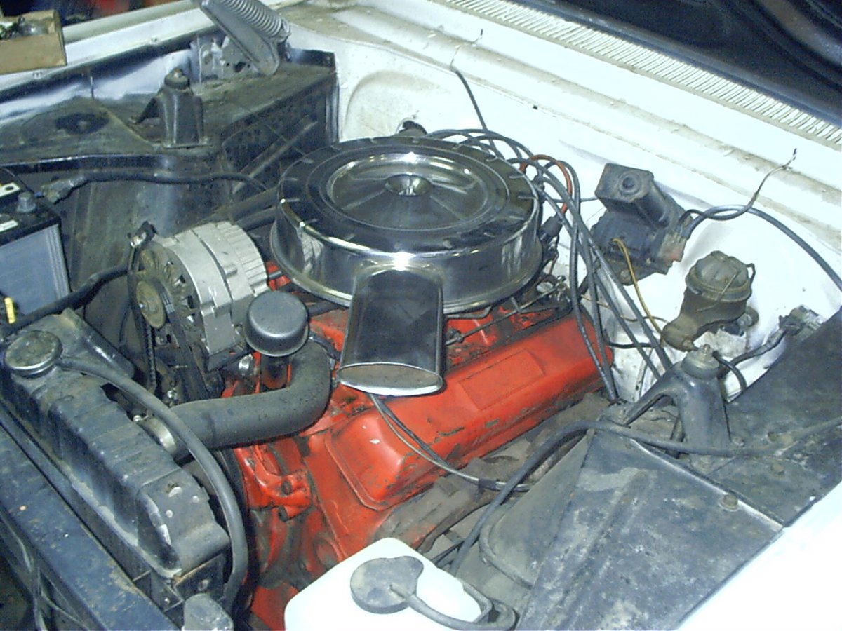

    Those are great hot rods. Here is an interior, before and after, of what I brought home. Have a great time with it! nova 18.JPG nova 12.JPG

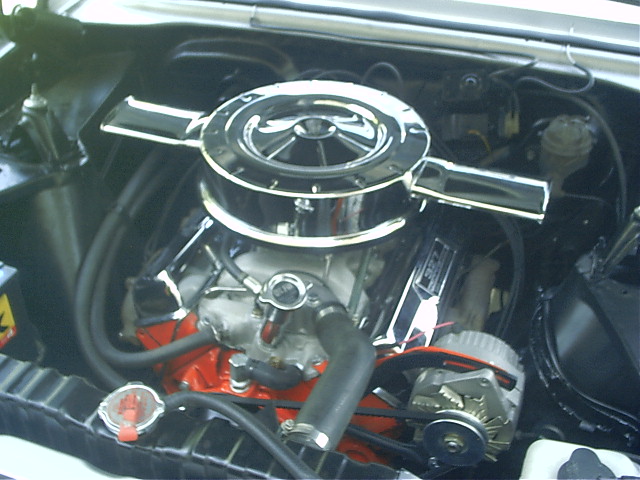

    Engine compartment, before and after, kept it simple..... nova 15.JPG nova 9.JPG
  25. DDDenny
    Posts: 22,554
    Bob, curious if that's an original Nova dual snorkel air cleaner?
