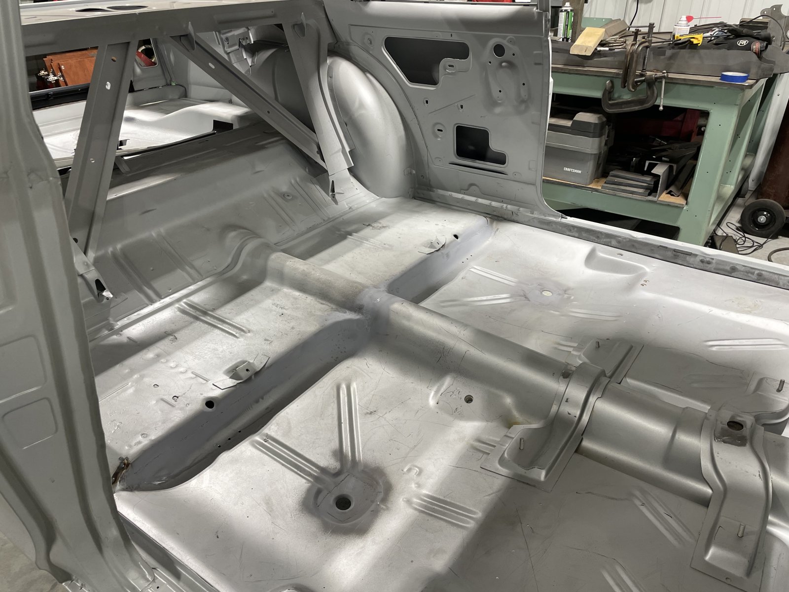

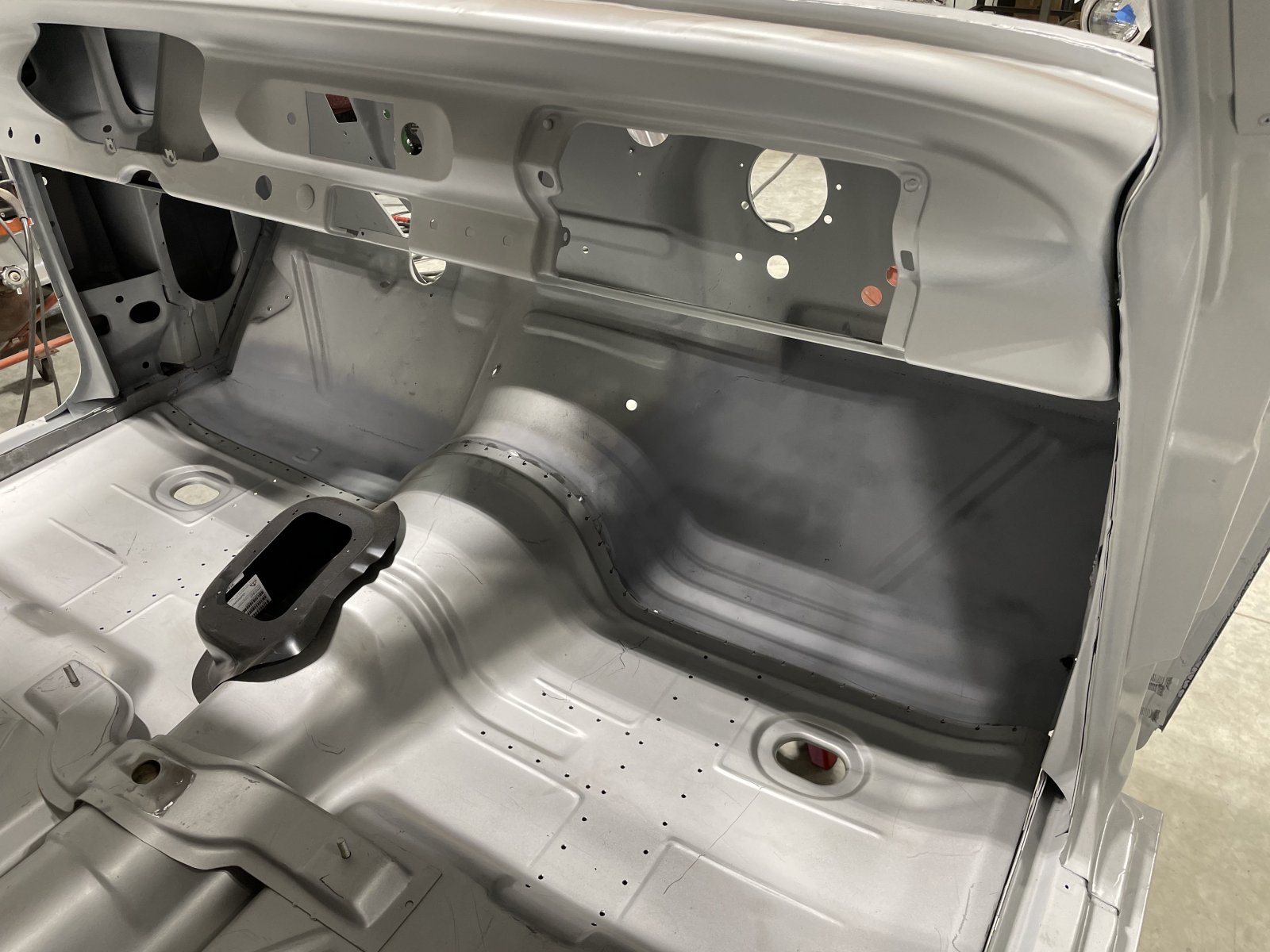

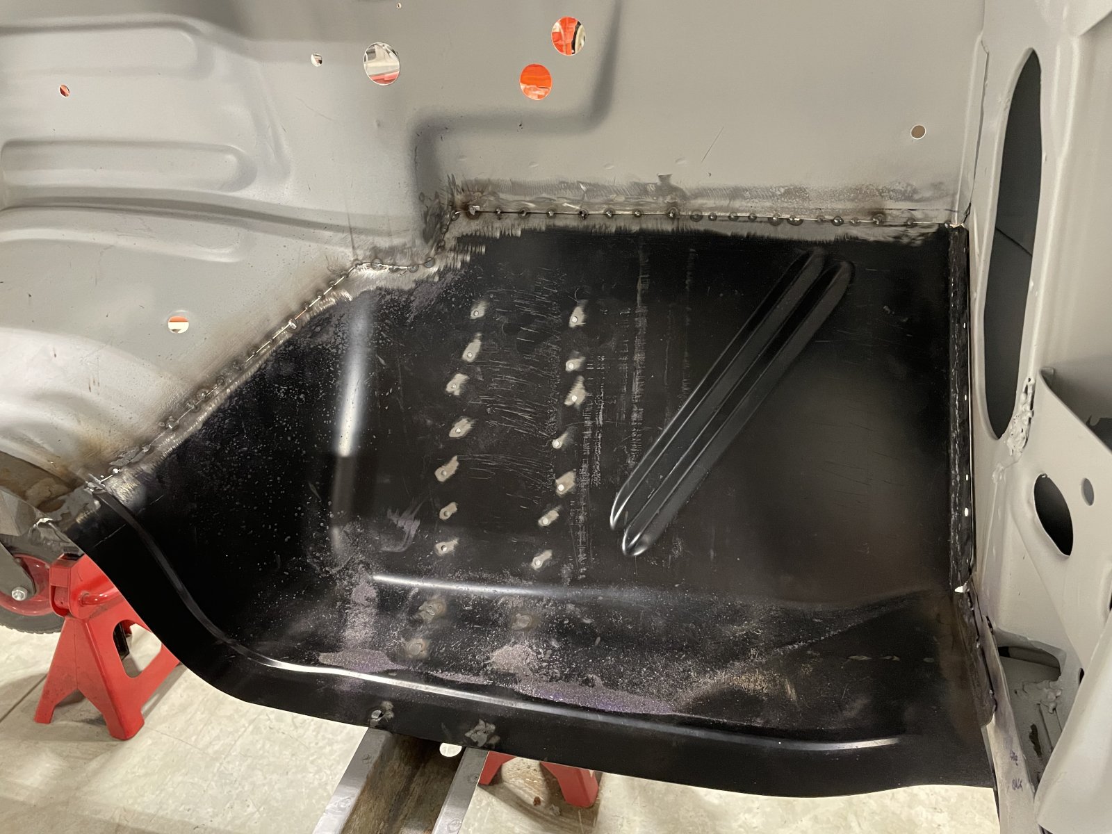

    Thanks for prodding me.....A few updates:

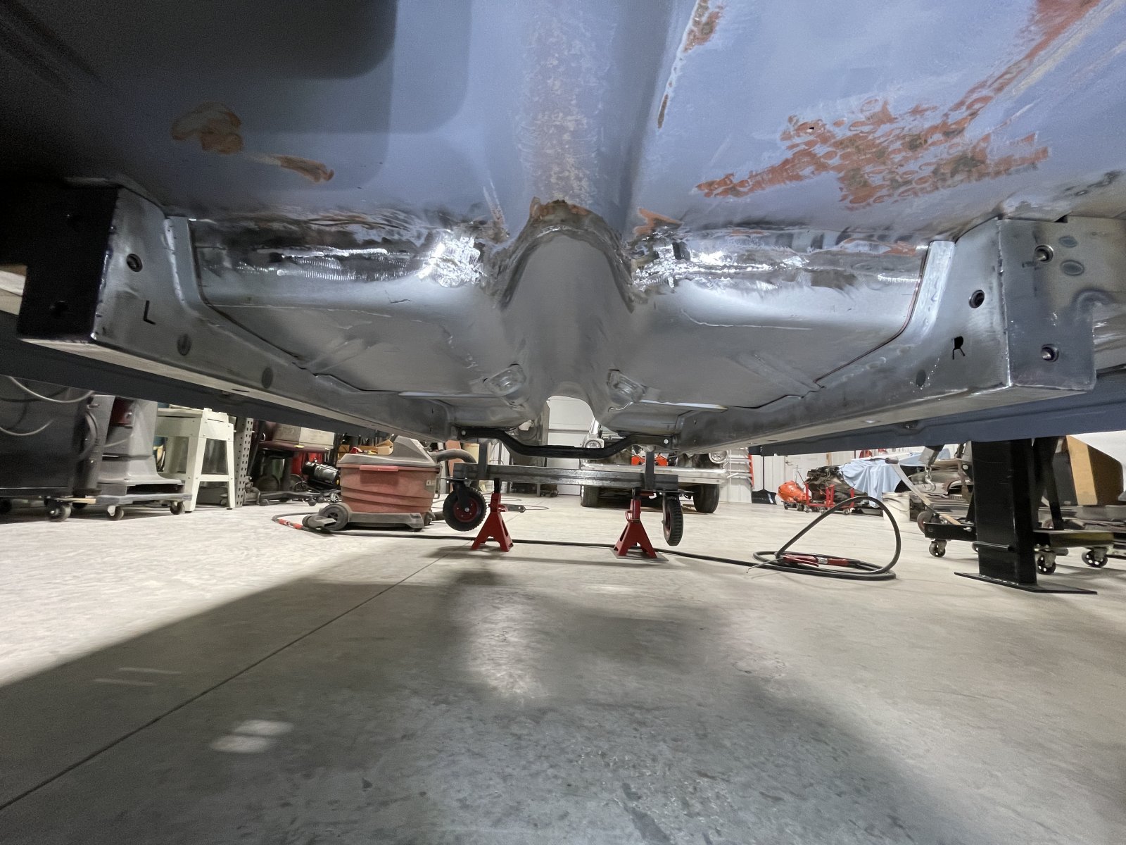

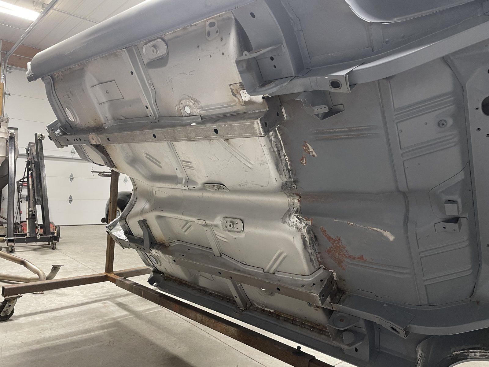

    I used a laser level to get the car straight and level while I finished up the toe boards, and finished the floor pan plug-welding, and seam across the back. I have a bit of work to fit the the sub-frame subframe connectors, and add some inner plates that would support and inner roll bar brace. I’ve got some plates coming in the mail.
    A lot of little holes appeared during blasting mainly where the seam sealer resided. Some of this could have been fixed with duragl*** or panel adhesive but I have replaced the rear trunk panel and one brace, and the bottoms of the taillight housings, and a few other pin-holes in the rear pan.
    Next up a little patches in one wheelhouse, lower rear quarter,
    I hope to have all the body and all the panels done this month if possible.

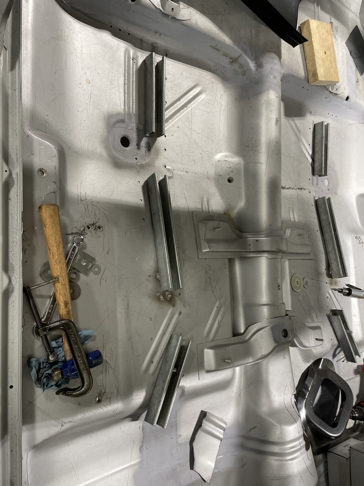

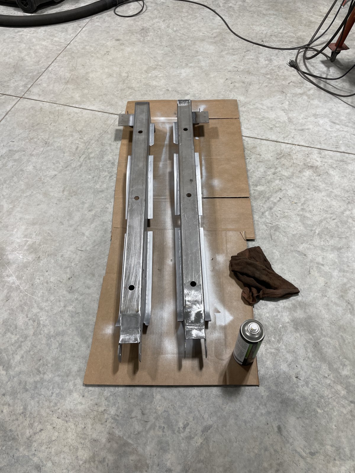

    Still plugging away …. Literally haha, here’s
    progress pics on the 63 post.
    I used the USCT Motorsports sub rail and modified them by:
    Extended the front sides 3” so I could get two big plug welds into the front rails.
    Added 3/4”flanges so I could plug weld them to the floor pan for what I think will be a cleaner and a little stronger means, than a corner tack.
    Modified the drain hole in the floor to move it outboard of the sub rail. Also added sub-belt nut plate that is concealed by the sub rail.
    Capped or boxed the rear section so I can use that to pick up a future diagonal bar for an 8 point roll bar.
    Added a few threaded nuts for future crossmembers or exhaust mounting, and added at the rear.
    Heavy coat of zinc rich primer on the inside.
    Making some simple plates to mount some leaf spring sliders too.
    ] 0FD417D8-C44F-48F1-90D5-36E7FDC5BE20.jpeg E929AFF9-F349-4EBF-B8F1-A4607C5360EF.jpeg 78923758-378B-4906-A65F-F40B2285E8FE.jpeg 82A01A39-2573-45C7-BBF8-BE2864AB5849.jpeg D6BD375F-6328-4071-ABF5-95BE1C4BCA6C.jpeg FBC3FFCE-2DE1-46F9-82F6-5489A7A9B1E5.jpeg 9B15B55E-42D3-42E6-8CC6-C12E30D24023.jpeg

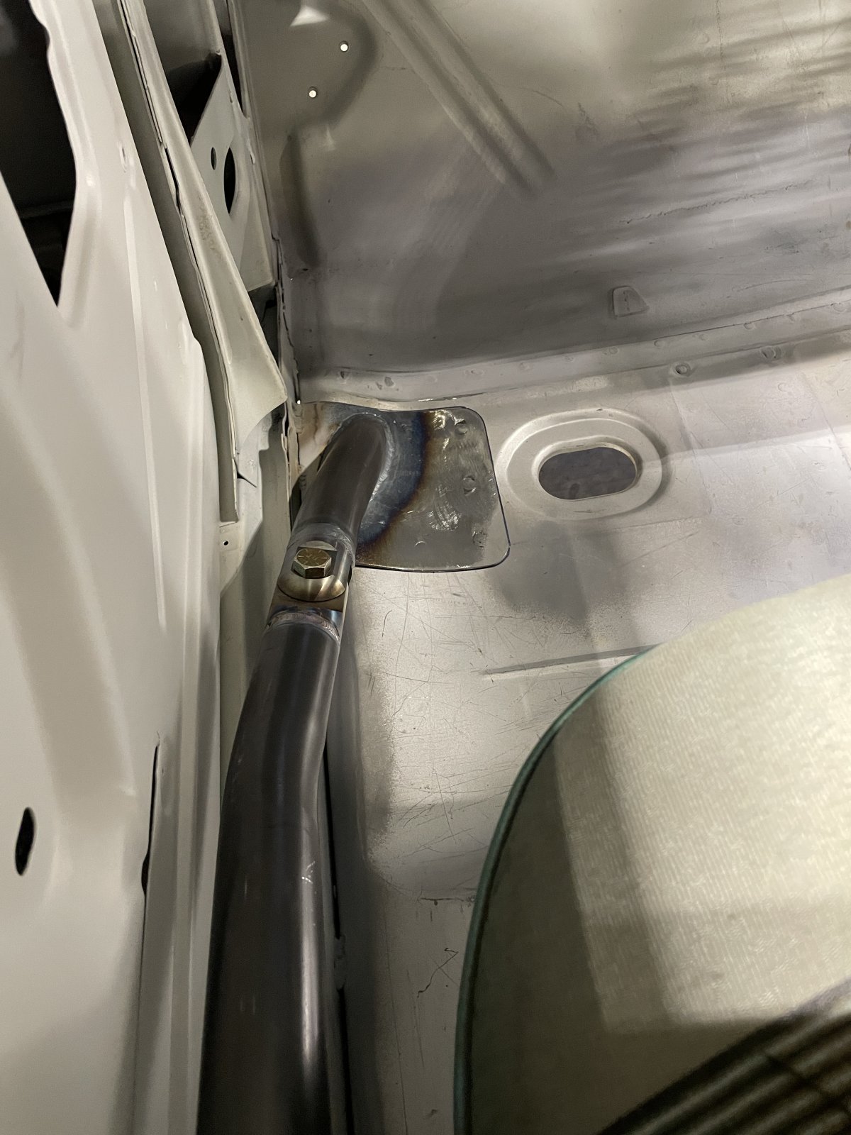

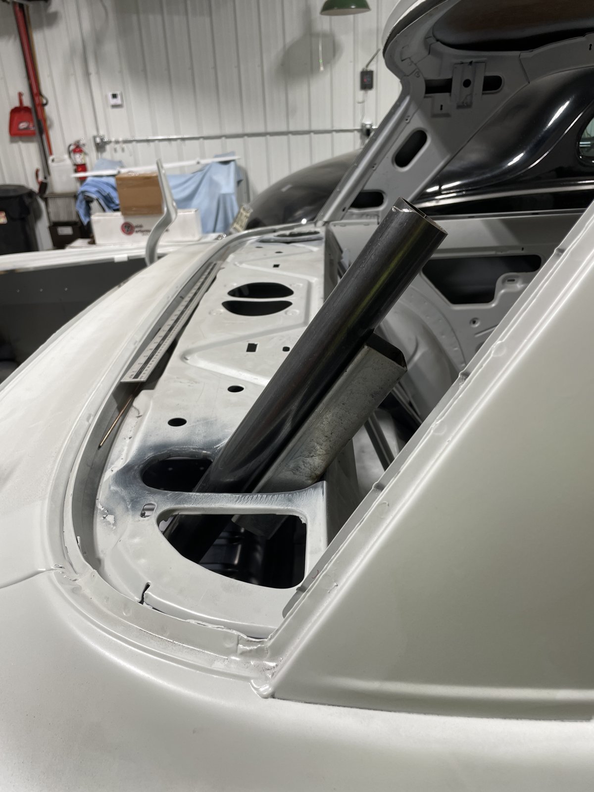

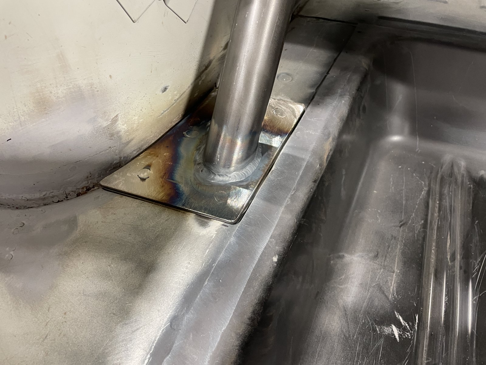

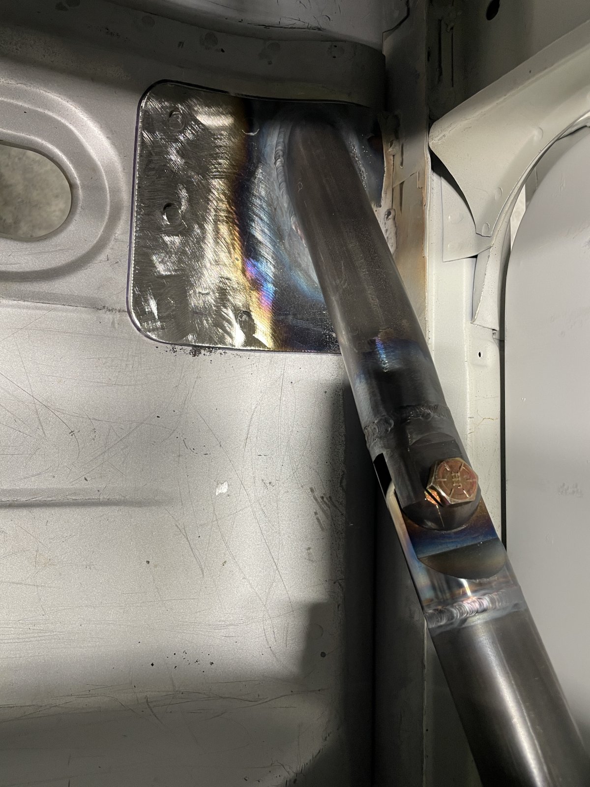

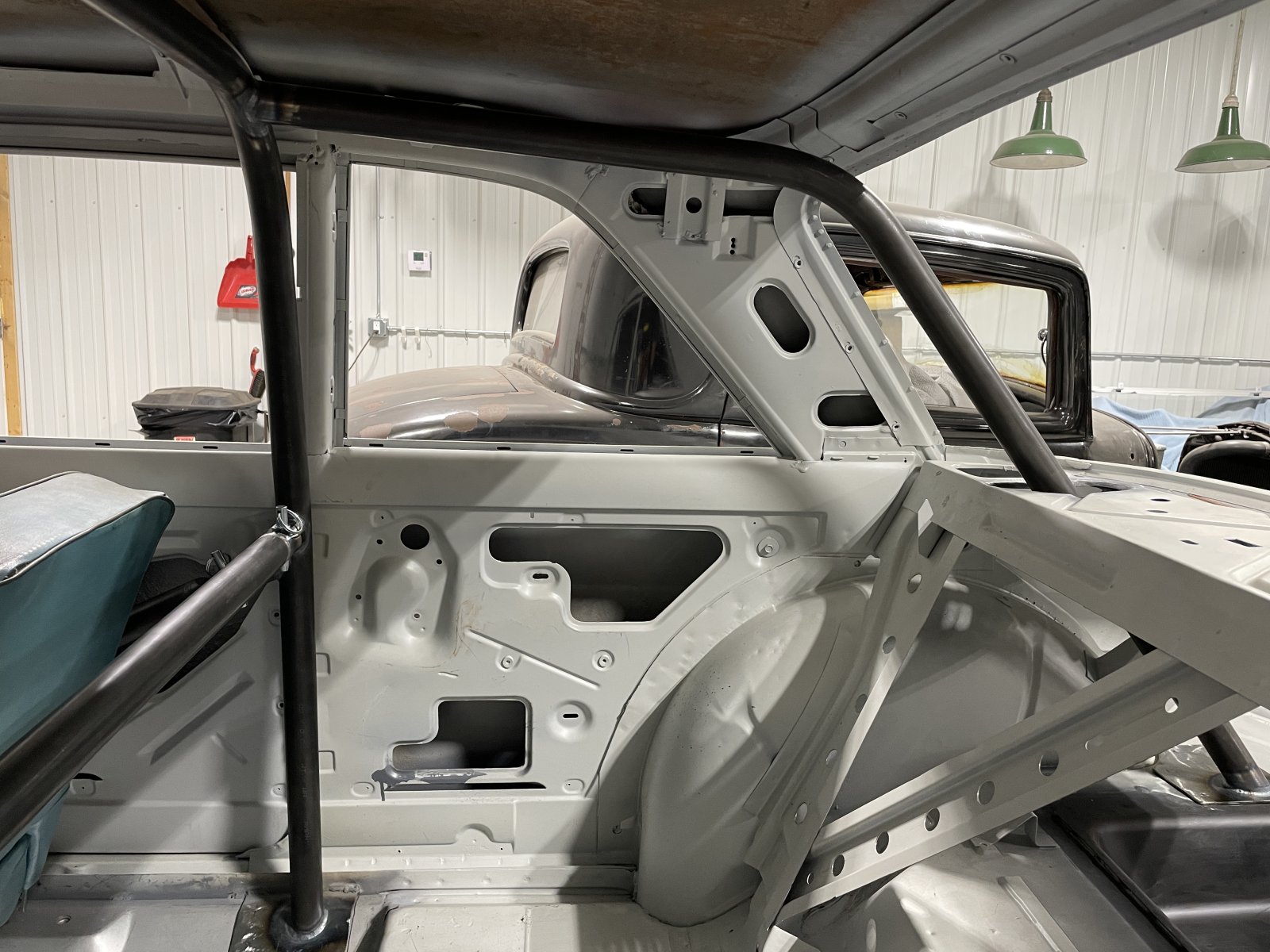

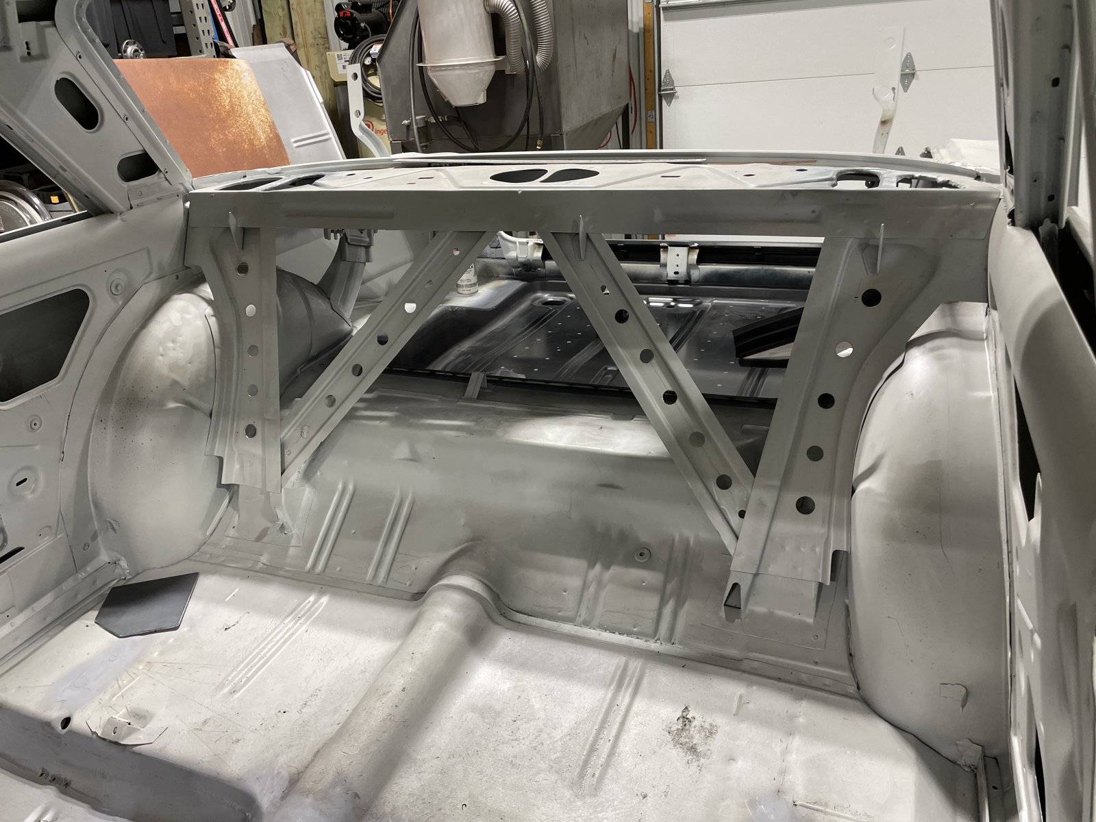

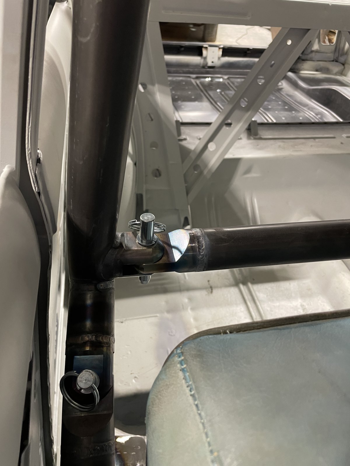

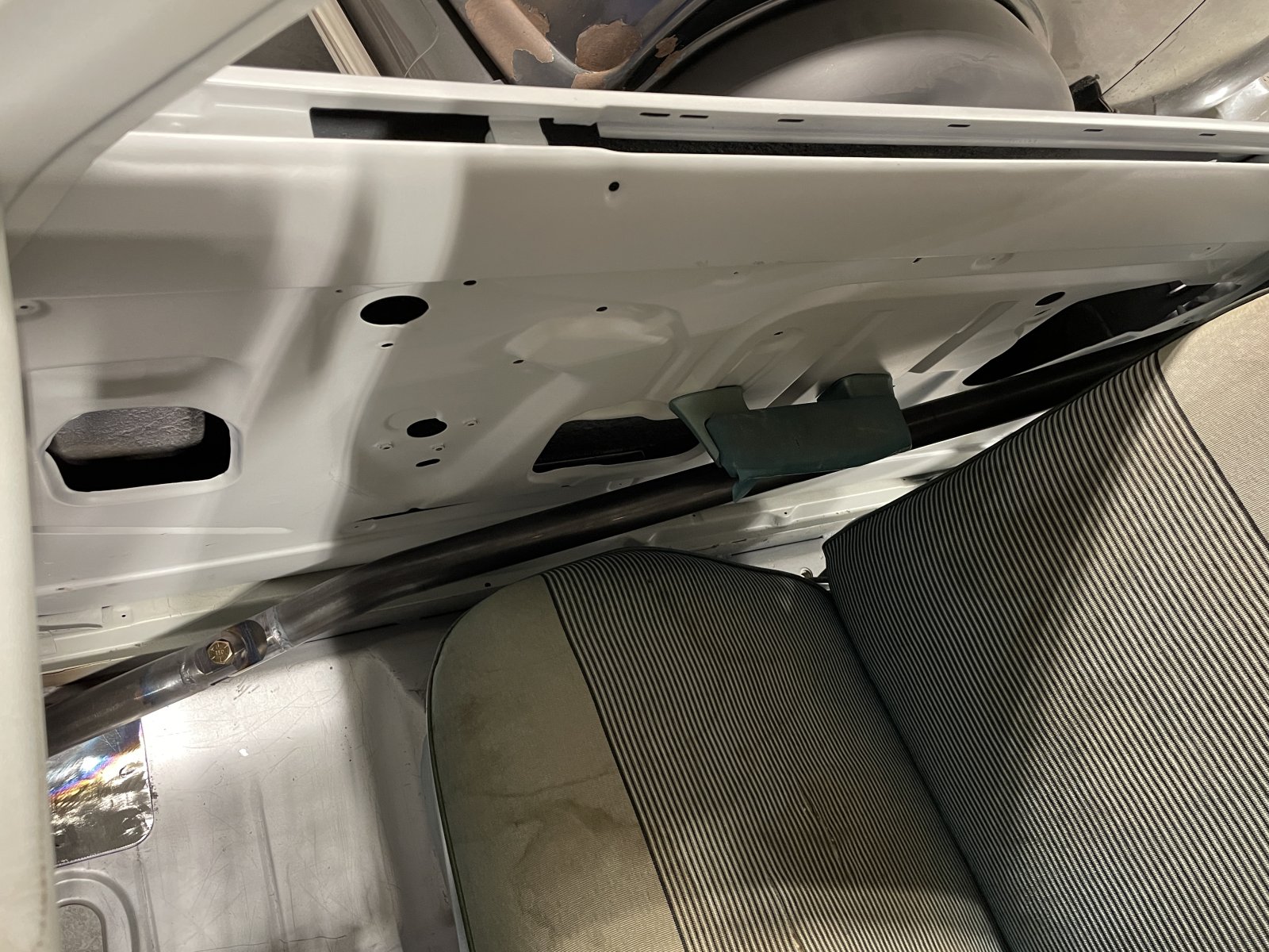

    Still plugging away( literally) . I made some plates for the cage mounts and plug welded them in places, and then had Innovative Metalworks bend the tubes and tig up a 6pt roll bar. He asked me how bad I wanted the armrests and that was a must have so made it work. I really like how it came out! I borrowed a rotisserie to finish up some work on the underside.

    Posts: 59,938
    squirrel
    I didn't know you could make the cross bar removeable....????
  22. Roadsir
    Joined: Jun 3, 2006
    Posts: 4,045
    Roadsir
    You're right and that was my choice, I don't think it will cert., but most the places I'll be running won't be NHRA.
    If the car dips into the 10's and I get warned I may need to change it....
    slug likes this.

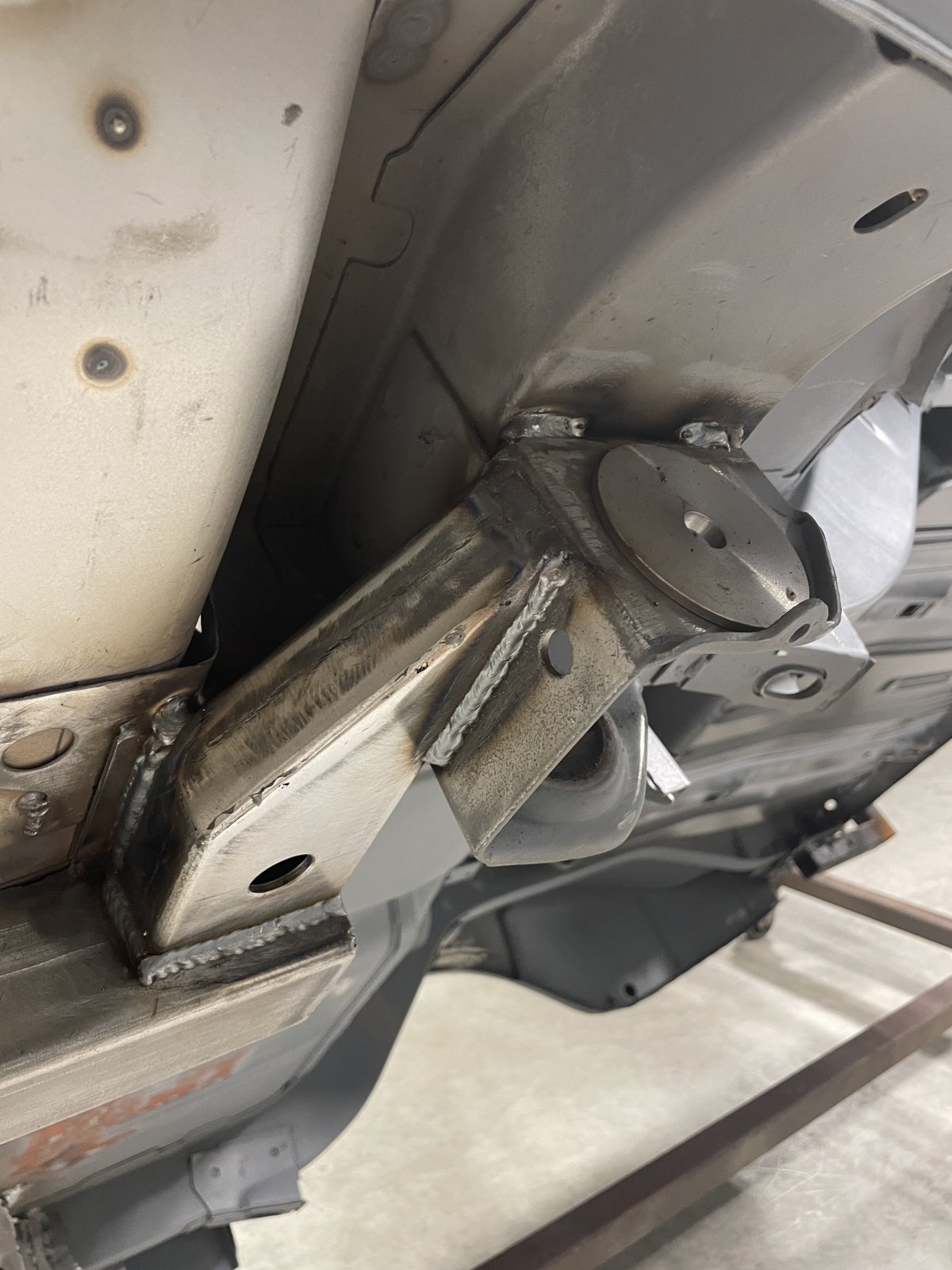

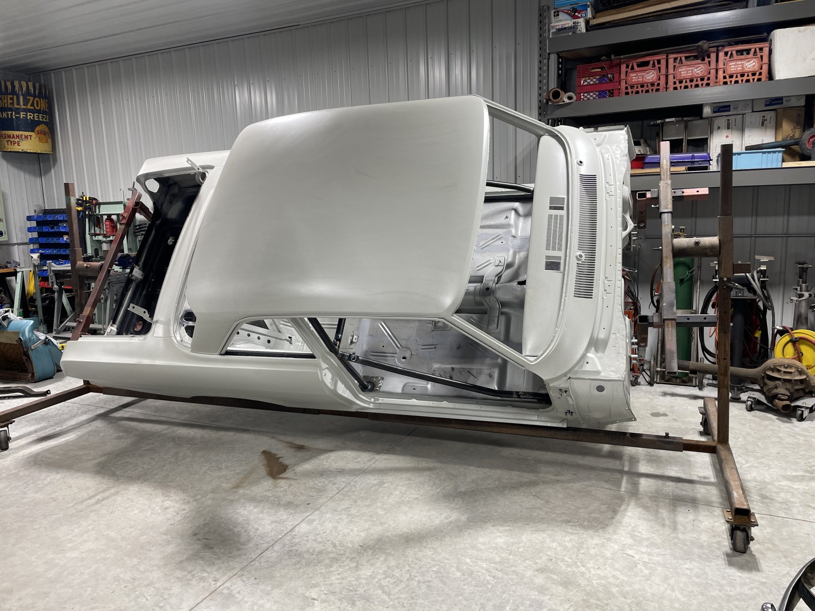

    Happy new year again…. A few updates on the Chevy II. I did have washers machined to to replace the front spring eye cups, and I tied the spring mount to the sub rail.
    Also did a lot of minor work to the doors, fenders, and hood. The paint and body guy should be ready next week!

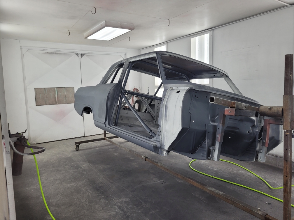

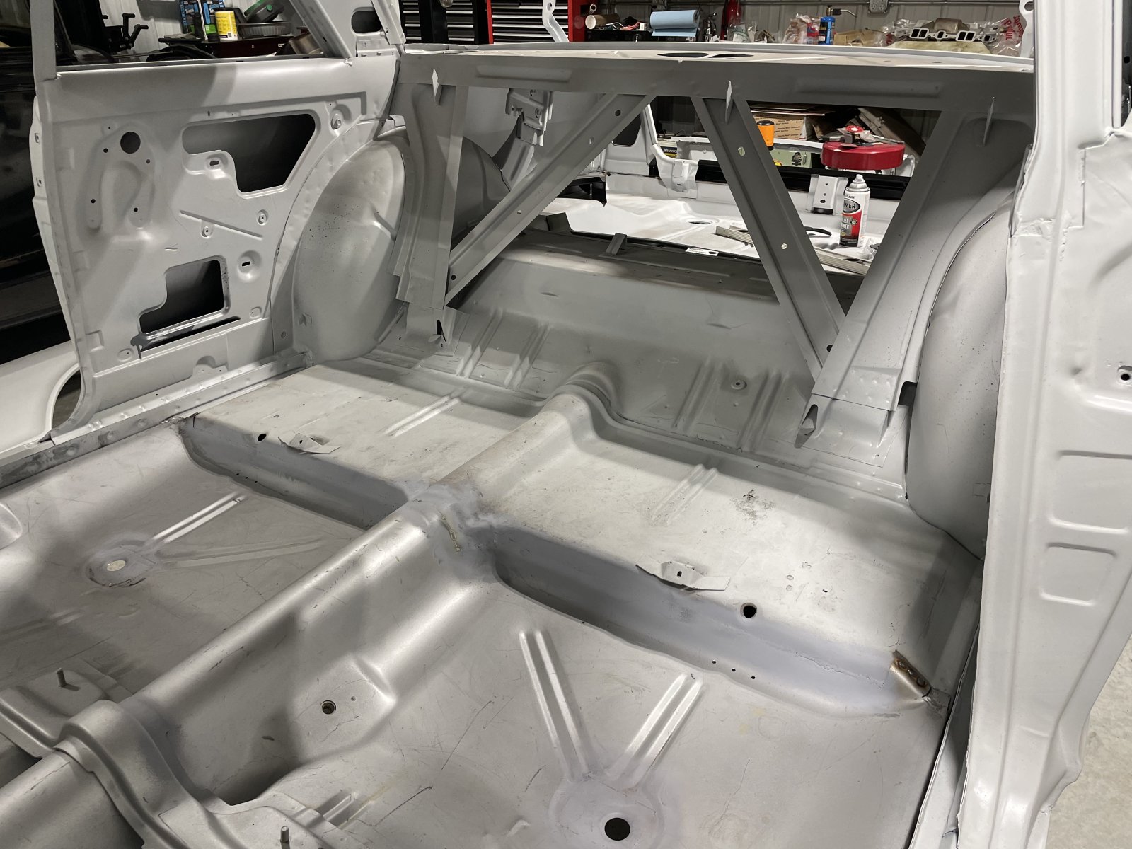

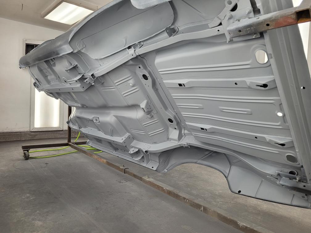

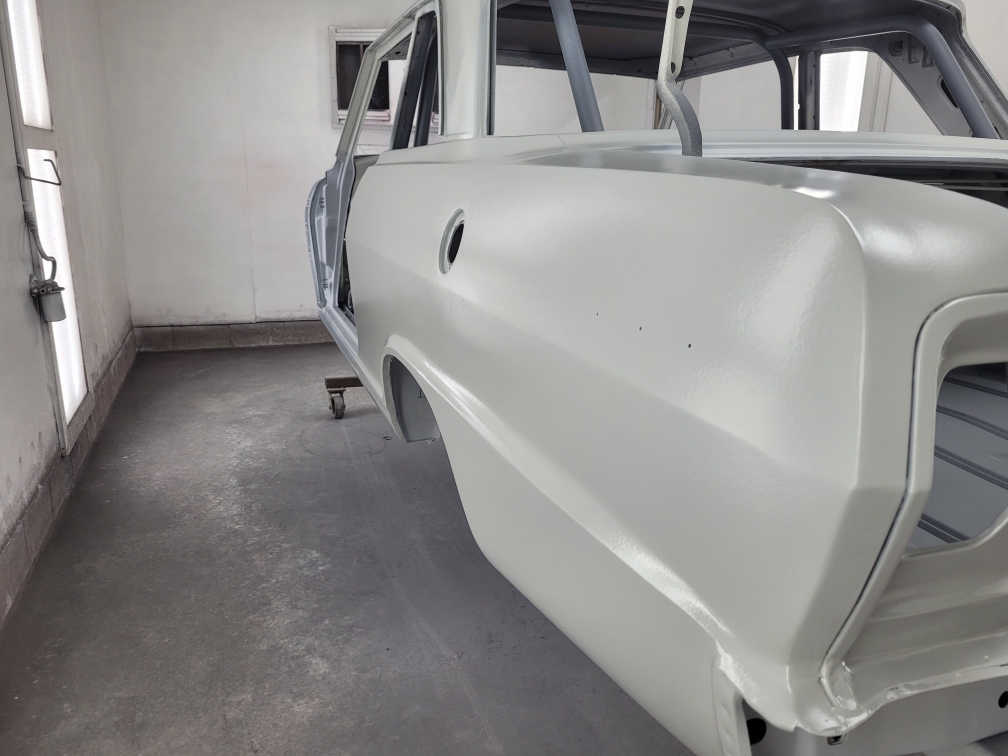

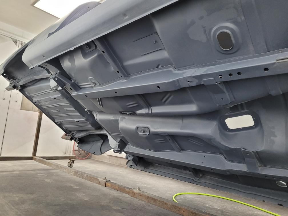

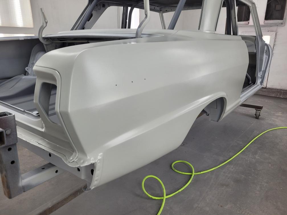

    Getting close to having some color. Dash and cage will be original dark turquoise, interior trim turquoise like original. Underside will be red oxide, and outside Ermine white.
    Resized_20240222_092429.jpeg Resized_20240222_093236.jpeg Resized_20240222_114721.jpeg Resized_20240222_114713.jpeg Resized_20240222_105915.jpeg Resized_20240222_092429.jpeg Resized_20240222_093236.jpeg Resized_20240222_114721.jpeg Resized_20240222_114713.jpeg Resized_20240222_105915.jpeg
  30. squirrel
    Joined: Sep 23, 2004
    Posts: 59,938
    squirrel
    nice!
    but you forgot to move the rear floor forward?
