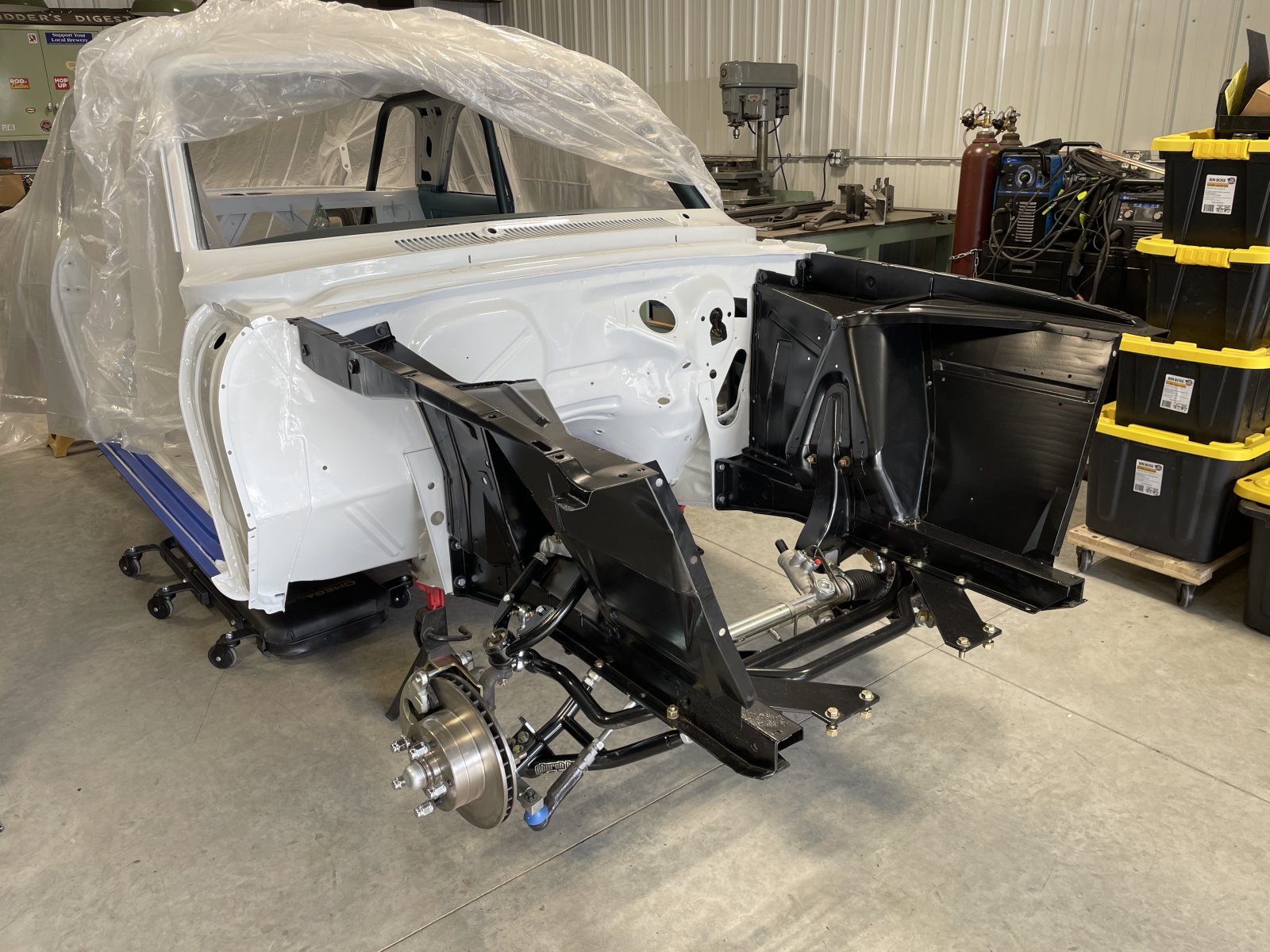

  3. Roadsir
    Joined: Jun 3, 2006
    Posts: 4,054
    Roadsir
    Big step I have a body in white! Matched the original dark turquoise for the dash and cage, and light turquoise elsewhere. Replicated red oxide on the underside, and have the trunk splattered. I’ll be able to start ***embly soon.

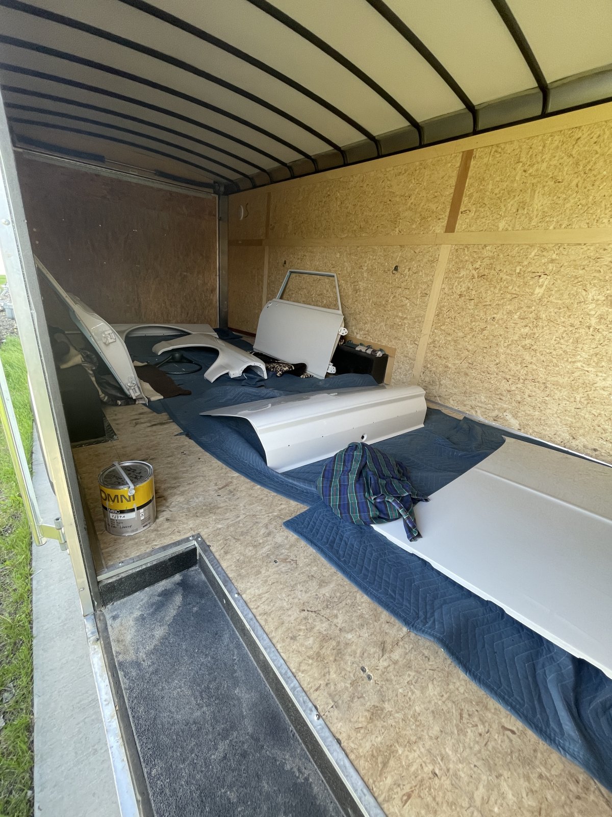

  8. Roadsir
    Joined: Jun 3, 2006
    Posts: 4,054
    Roadsir
    Brought the Chevy II body back last weekend. It’s cut and buffed. The doors and deck lid are next followed by the hood and front fenders.
    I’ve been using Evaporust to de rust all the small stuff…not sure why I waited so long to use it. Works great. I’ve got a lot of small stuff to paint
    also decided on a Autogear M23W 4 speed (2.56 first gear) instead of a Tremec TKX. Should be bulletproof! Also looking at RAM clutches.
    Still pondering a rear gear. 3.70, 3.90, 4.10? Leaning towards a 4.10 to keep drivetrain stresses down

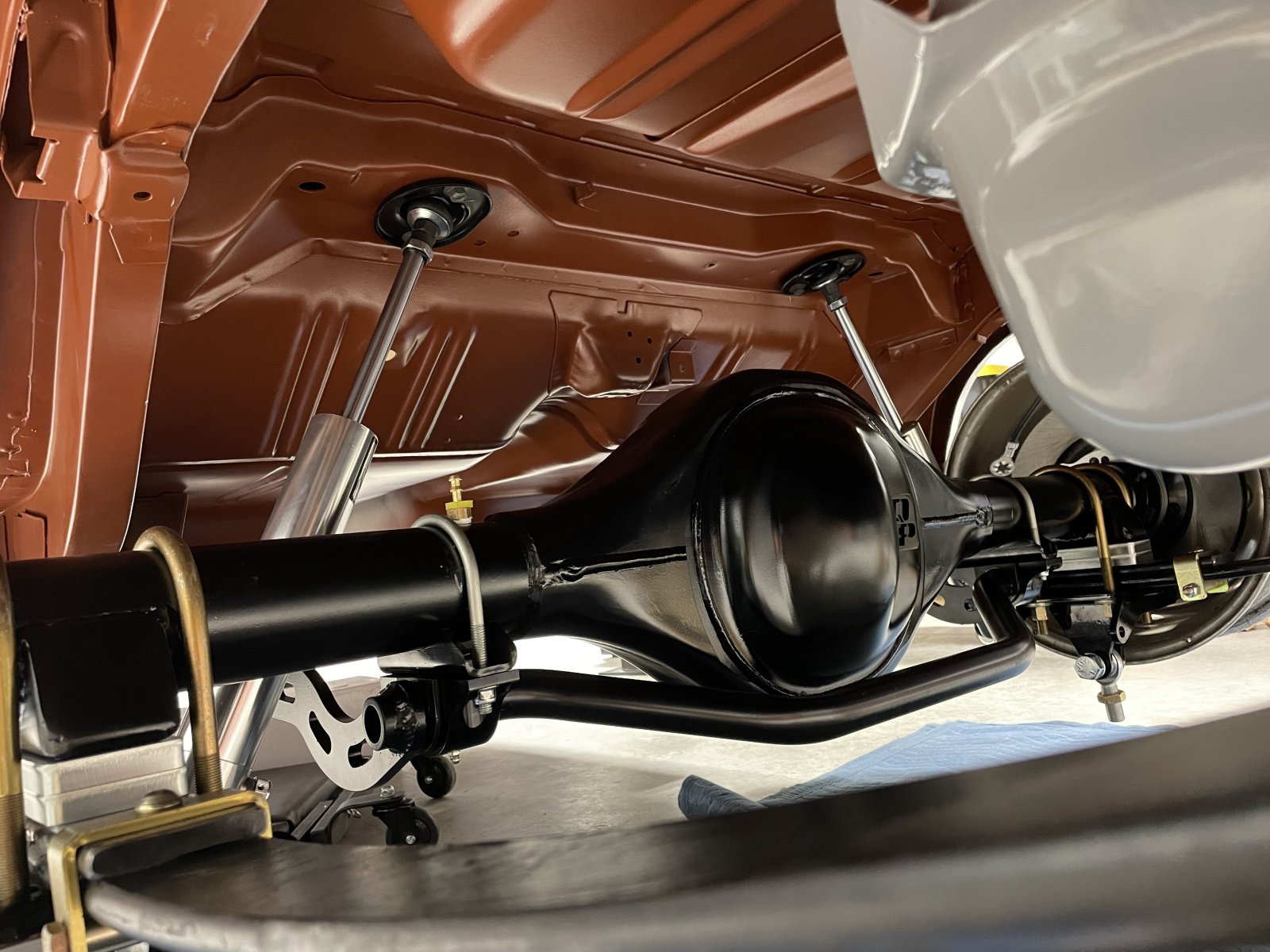

  11. Roadsir
    Joined: Jun 3, 2006
    Posts: 4,054
    Roadsir
    Still plugging away. This is the fun part for sure!! IMG_5705.jpeg IMG_5704.jpeg IMG_5689.jpeg IMG_5564.jpeg .
