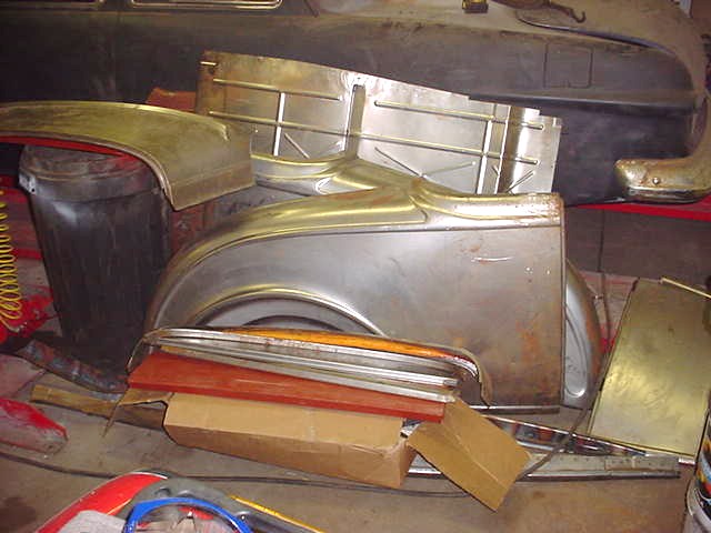

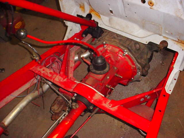

    Like i need another project, but ive wanted a 32 roadster for a while, and have been planning on picking up a brookville body for a while but have never been able to save up enough $$ to buy one, well i finally got one, Bobbleed had the unassembled one in the class adds, and he out interested in 32 tudor trades, well i had one to trade, so we worked out the details and a deal was struck. he was gonna be up in Milwaukee in a couple of weeks so we figured id meet him there and make the trade, and we did.

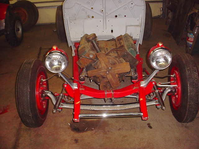

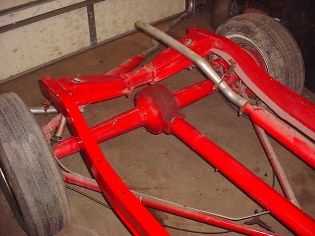

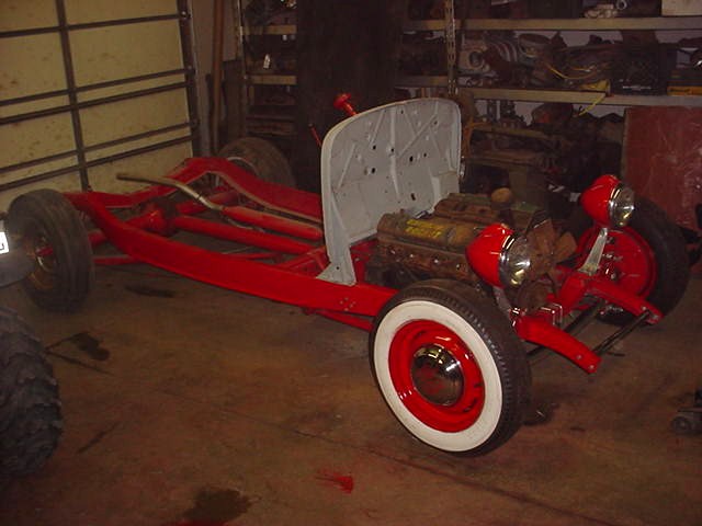

    I had also known about a 32 chassis that was under a five window coupe that was updated with a new chassis, its been sitting in a barn for a few years but its still in pretty good shape, with a little bit of cleaning and going throu things i should have a pretty good base to build the roadster from.

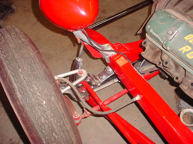

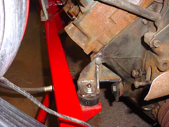

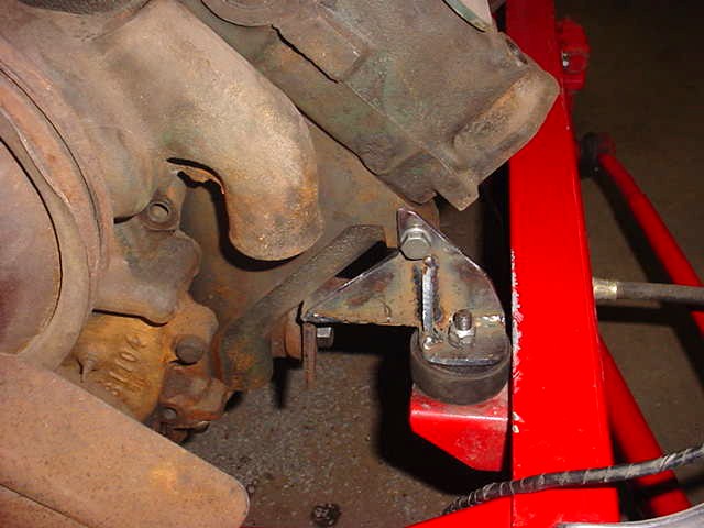

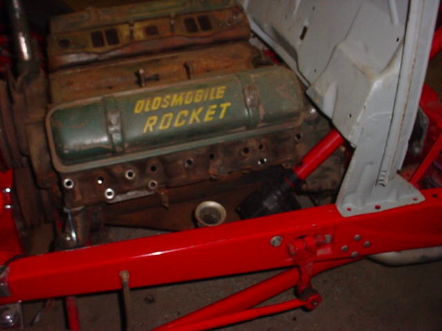

    the chassis has a chrome chassis engineering beam axle in it, 40 spindles and brakes, f100 steering box, reversed eye spring, split bones, tube shocks, the trans is a 39 unit that is supose to have lincoln gears in it, it also has a 40 ford banjo rear. it had an olds rocket in it when it was running around, but that was long gone, so i decided to go olds. so i hun g the motor in its respective place and proceeded to make some motor mounts that mimic some posted here on the hamb.
