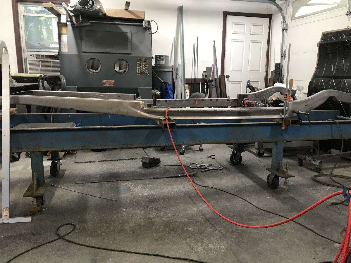

    Well I have been thinking about building a channeled roadster for quite some time now and the opportunity to get a body finally happened a few weeks ago.
    It’s an older brookville body that I was able to purchase with an original firewall and grill shell setup, and some other parts for a great deal.
    My buddy @Mikel50 let me borrow his frame table, and even delivered it! Thanks Mike. So got the rails just resting there and braced the body in preparation to cut the floors out.
    Was way overthinking the cuts for about a week and finally pulled the trigger yesterday and cut it up.
    A friend of mine had this 57 Cadillac and while it was rotted to death, it had a great running 365 that will be the new heart for the Roadster.
    Since this caddy engine was the planned bullet all along, I was always on the lookout for some neat speed parts for it. Scored this killer vertex magneto a while ago and more recently the 4x2 intake.
    I’ve been going through my “to cheap to p*** up“ parts and have quite a bit of stuff that will be put to use on this project.
    I know it doesn’t look like much yet but this gets the ball rolling!

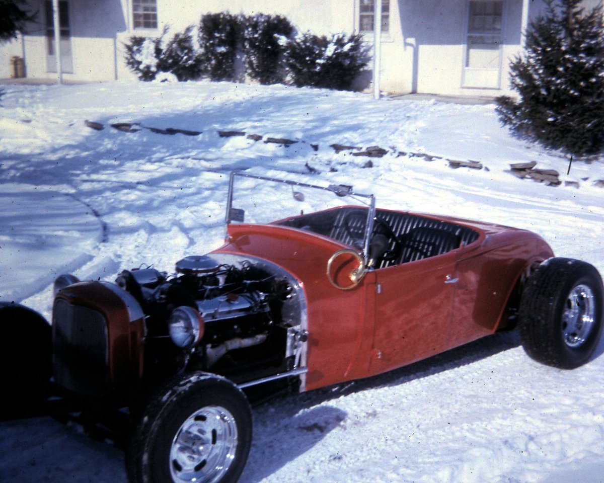

    Nothing better than a channeled New England Roadster ( photo 1956}

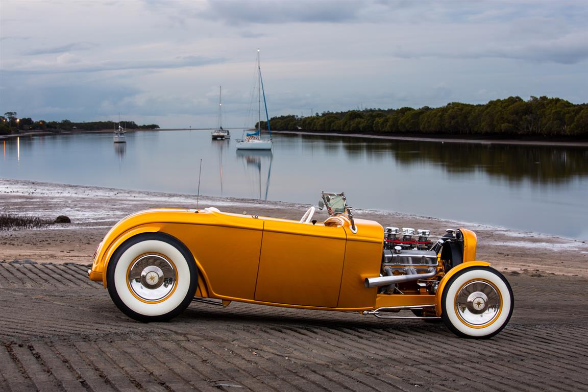

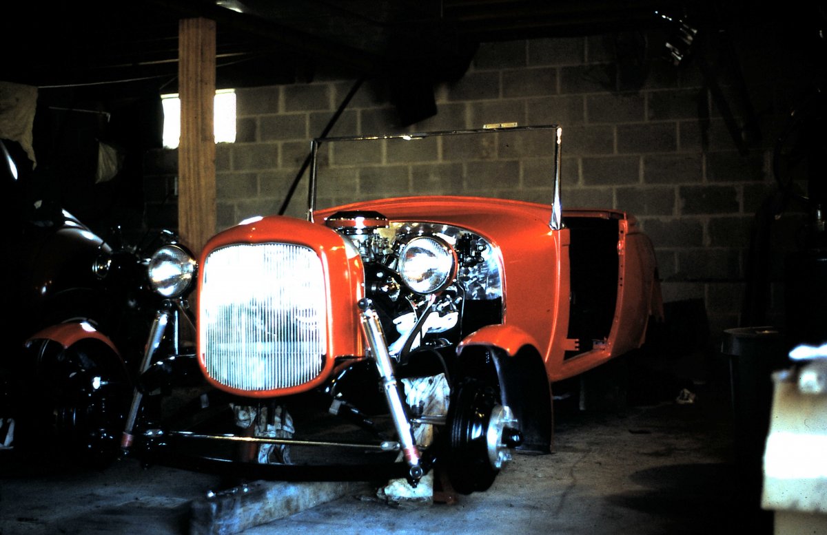

    Love channeled cars and roadsters especially but maybe biased. Roadster 3 (Medium).jpg
    rod1, WC145, lo c dan and 31 others like this.

    Working on sectioning the cabin area of the rails to get some more room inside. Interestingly enough the 32 body measured very close to my model A from top of the sub rail to the top of the door.
    Brought the rails down from 6” to 4” and added some 1/4” internal gussets on either end for support.
