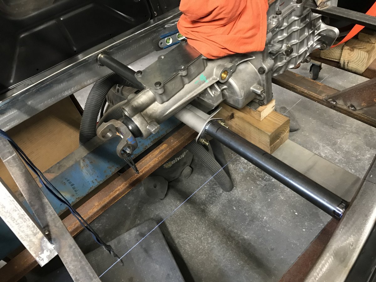

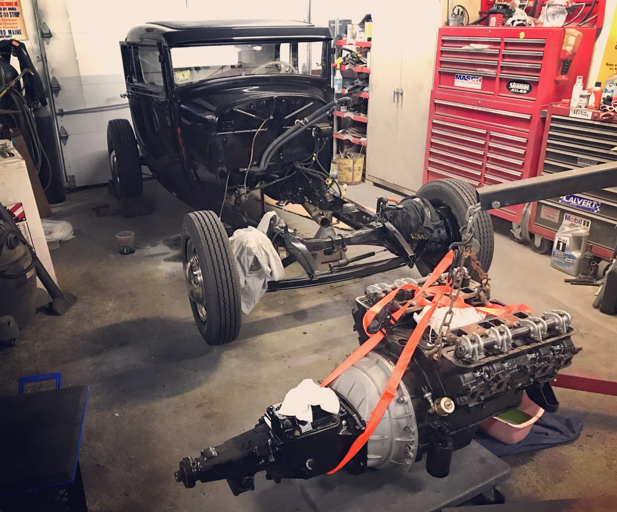

    Had some issues with the nailhead in my coupe so the roadster project has been on hold. 91BC023A-E6CF-48A9-B3C6-DE655371F45F.jpeg

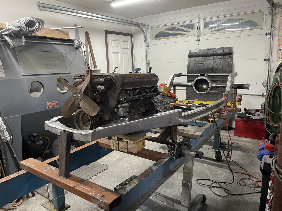

    The car is running again now so roadster progress will be coming. Engine and trans is mounted, setting up the rear suspension next.

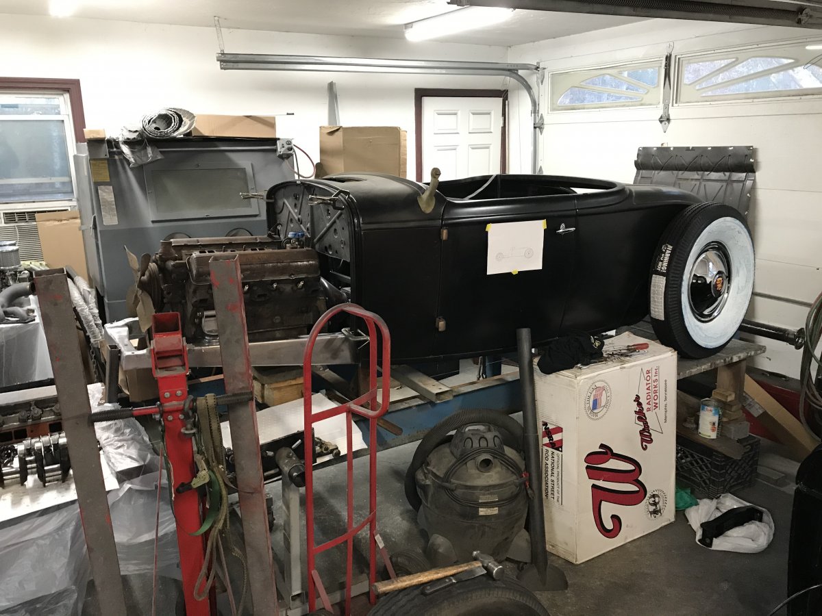

    1521A46C-519D-4358-8C34-0BE37AA3D287.jpeg 853ACB2F-9E3F-4C92-9FBB-7D7BC7E65DFB.jpeg 8377C6E8-69D5-4B85-945E-4FA1AA09D150.jpeg

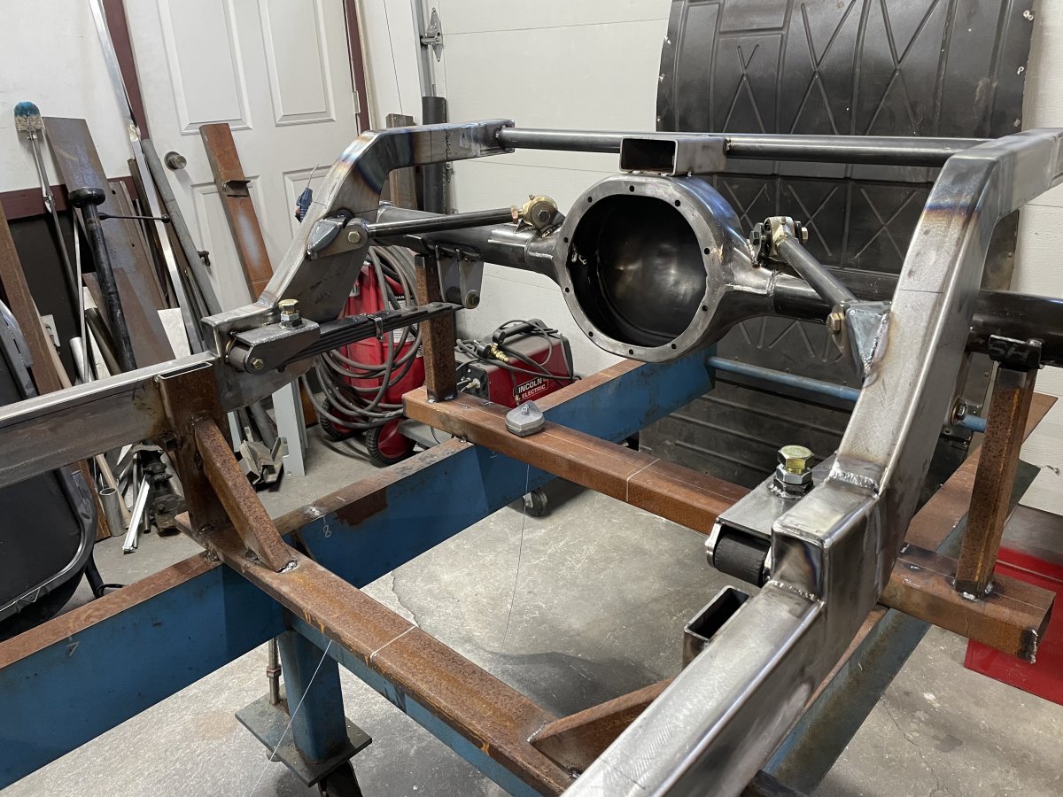

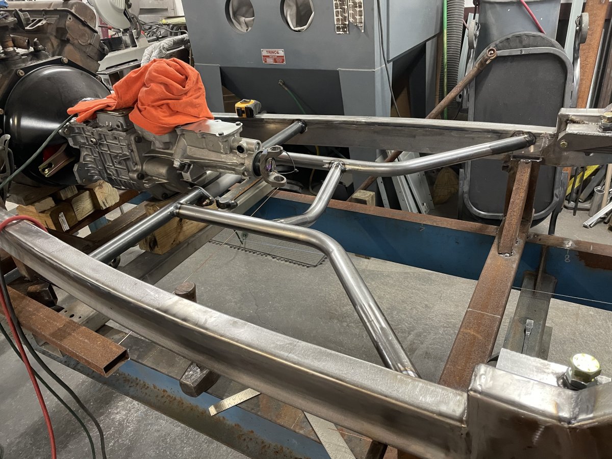

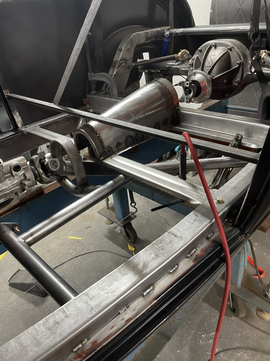

    I’ve been working on getting the rear suspension setup the last couple weeks and finally got it figured out. First step was to secure the rear axle at ride height and then sweep the rear of the ch***is up for axle clearance.
    I picked a suspension setup that was very compact to keep from getting into the cabin area of the floor. This is all new to me so I asked many peoples advice and did as much research as I could on lengths, angles etc. There are some sacrifices due to space but it has excellent articulation. I used a Johnny joint on the axle and regular heavy bushing on the frame side for vibration. F3E59648-317B-4814-A258-BAEAB3ADB718.jpeg
    Next up was to build a K member off the trans mount with some pre bent tubing I picked up. AFB188F1-A0A3-4E33-936E-AC7F2D908DCB.jpeg

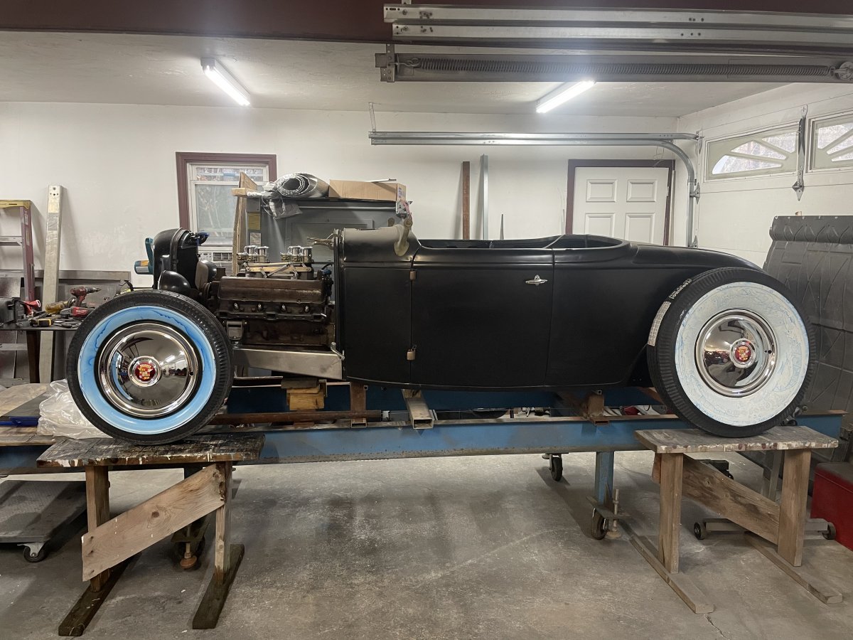

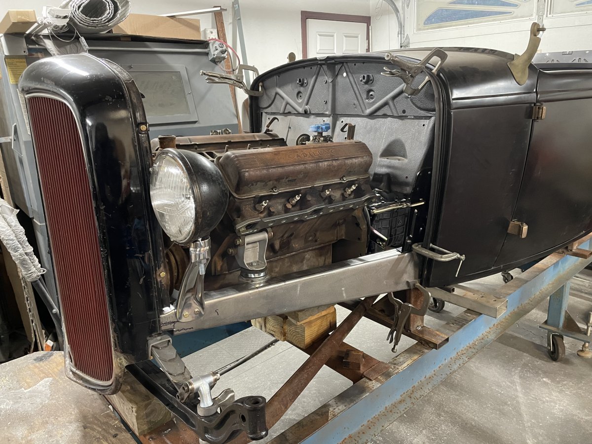

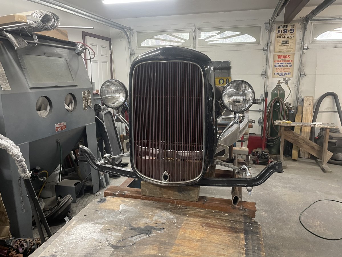

    Then moved on to the front end, I had this old dropped axle for a while and used it with a nice original spring and shackles. Offy headlight stands with nice set of king bees I picked up off the HAMB. 346673D1-9D55-4AA9-8CDF-A8C8C63BA4FA.jpeg
    Had to do a mock up for a good stare session today.
    That’s where she stands as of now, I need to make some sub rails and get the body mounted securely soon.

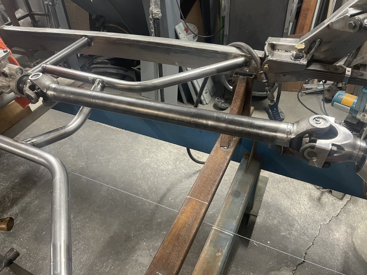

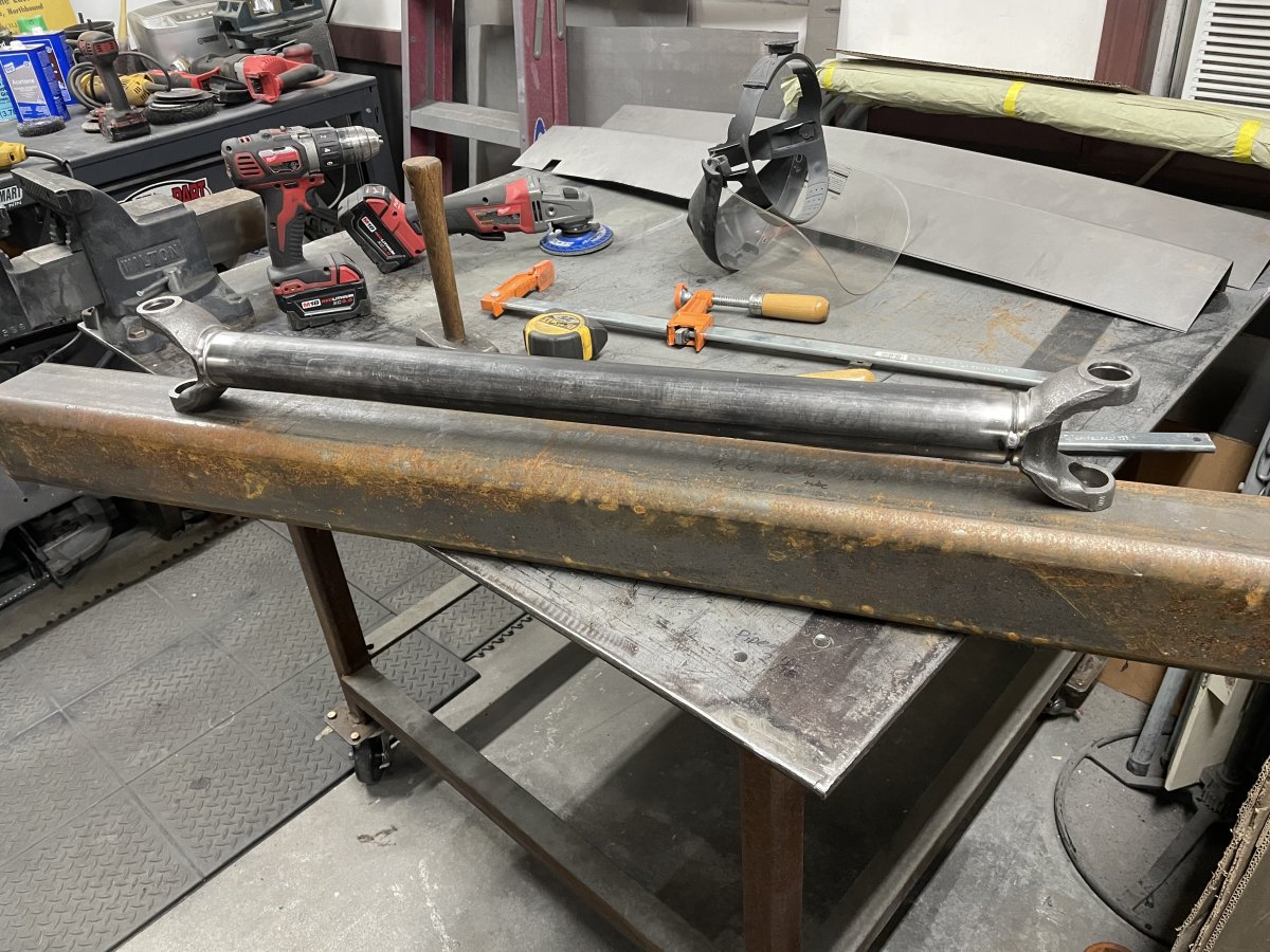

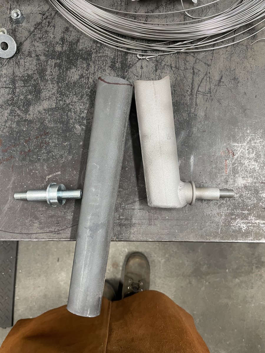

    I decided to try and make my own driveshaft after talking with a friend of mine that has done it a few times. Ordered up some ****er weld yokes and a piece of 2” .120 DOM. First it is critical to have the yokes in line so I clamped them down to this heavy box tube and put one tack weld on each end. ABF7EB64-73BC-49E7-B8BF-DBB3D0AD421F.jpeg
    Next up installed the u-joints and bolted it in. I got both ends to within .002 with 4 tack welds on each. Then welded it all the way around in one p***, allowing to cool on its own. I was out a little bit after welding and did a couple heat shrinks with the torch to bring it back down to .001-.002 . We’ll see how it feels but I don’t think getting it balanced will be necessary.

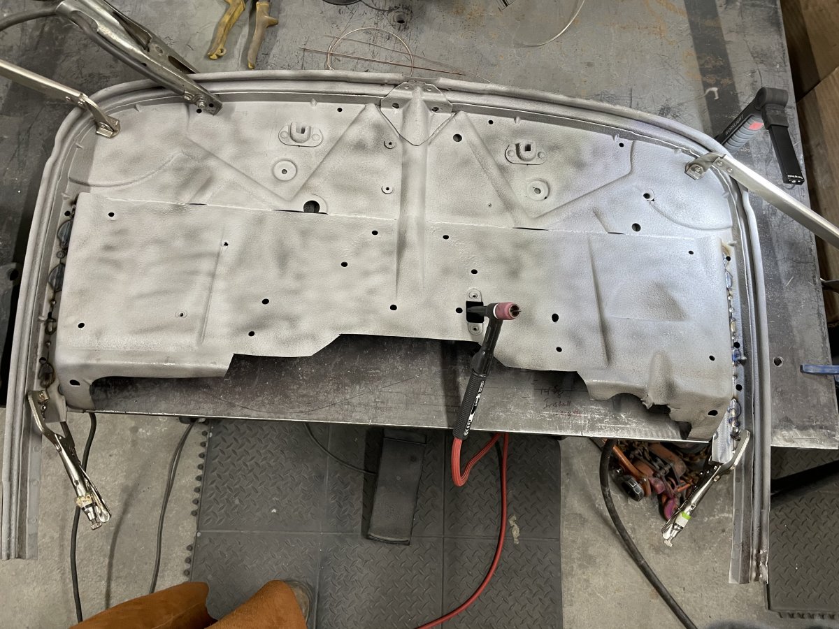

    Firewall was a bit of a challenge, after sectioning it 6”s I had to fix a bunch of cracks, fill holes and transition the beads into the lower portion. 232B0D6B-2984-40C9-9CEB-22E40066F6EB.jpeg

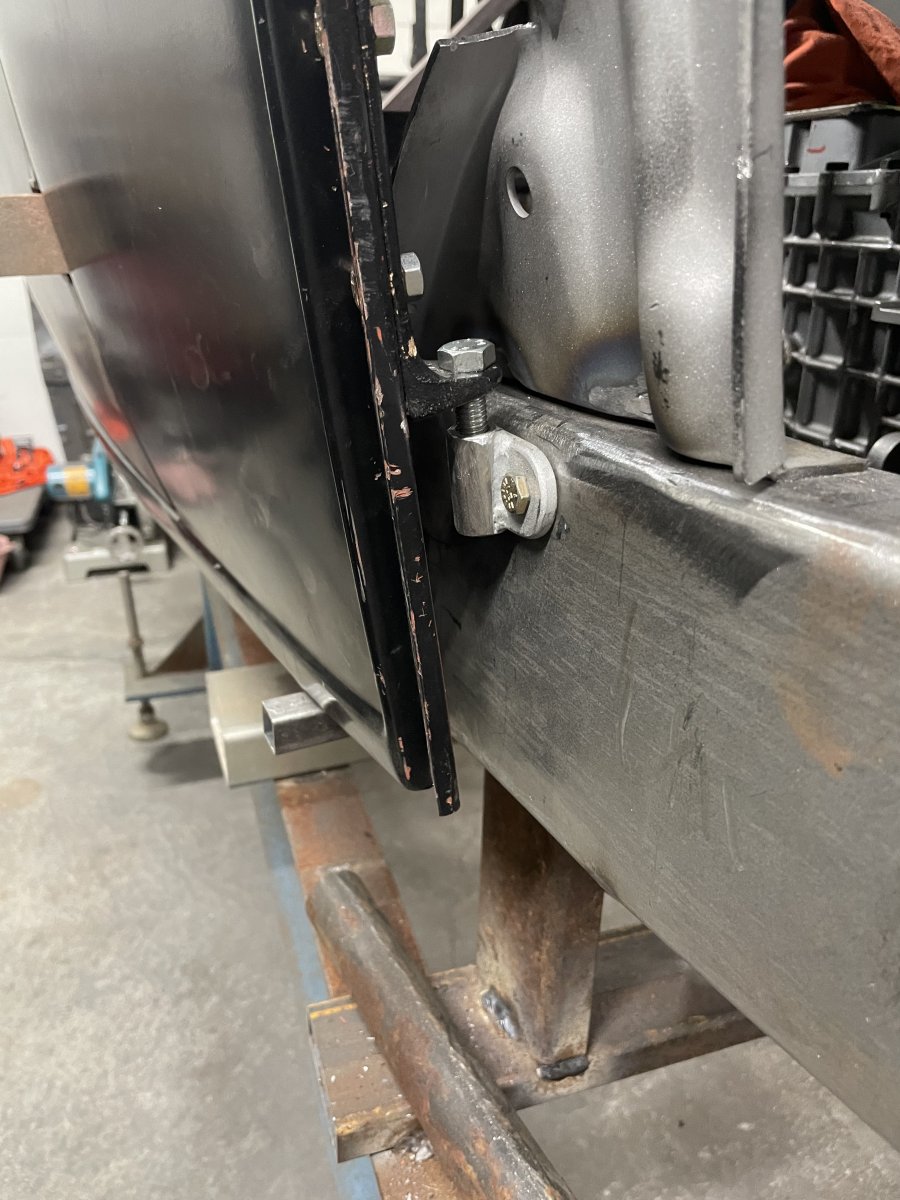

    Once it started to take shape, I swapped the firewall feet side to side. Now the bolts are on the inside because it just lined up better with the narrowed frame.
    I had contemplated making the firewall bolt in to save some h***le, but really wanted it to come together with the body like it was supposed to. Came up with these simple mounts on the ch***is to utilize the original style mounting.
