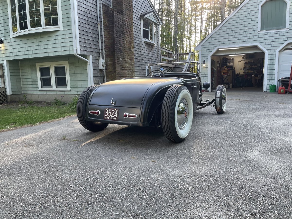

    Great side view, rear tire covers the wheel well just about perfectly.

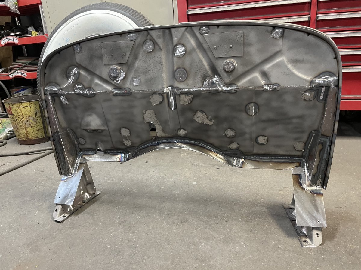

    I would love to have a chrome firewall in this! Unfortunately it is pitted from end to end and my sheetmetal work always requires a bit of polyester leveling enhancer.

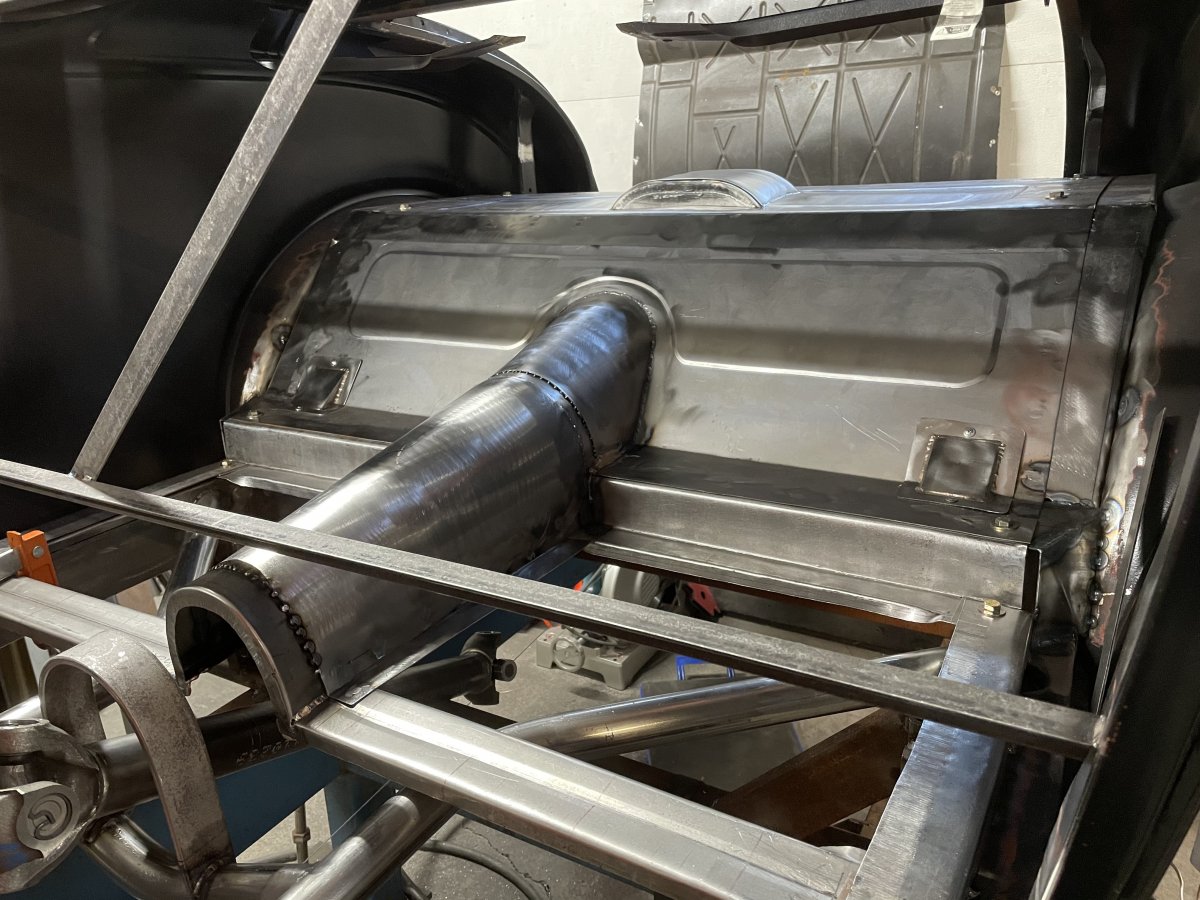

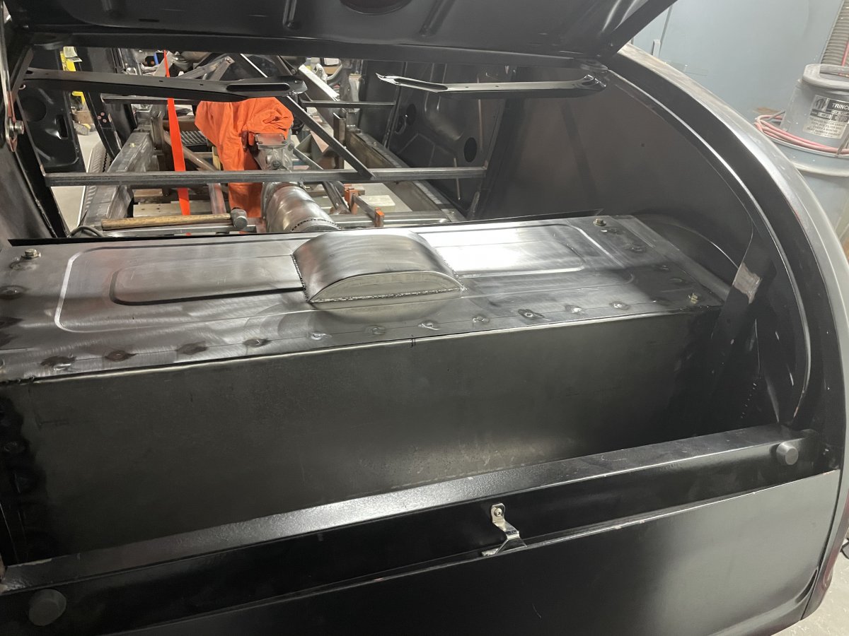

    Made up the rear sub rails out and of some 1/16” plate bent 90 degrees and plug welded them to the inner wheel wells. Skinned the floor with 18 gauge and made a small bump over the rear end to finish out the trunk area. C14F0F0D-4180-4CC9-9B99-7794E3B0CFF6.jpeg
    Working my way forward skinned the rest of the kickup and connected the tunnel to the floor. The pinion is off center 1 1/2” and didn’t want the tunnel to look too crooked in the car so I just made it a little wider then it needed to be. Also made up those two small bumped out covers for access to the spring adjusters.

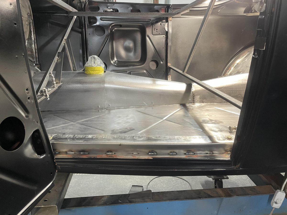

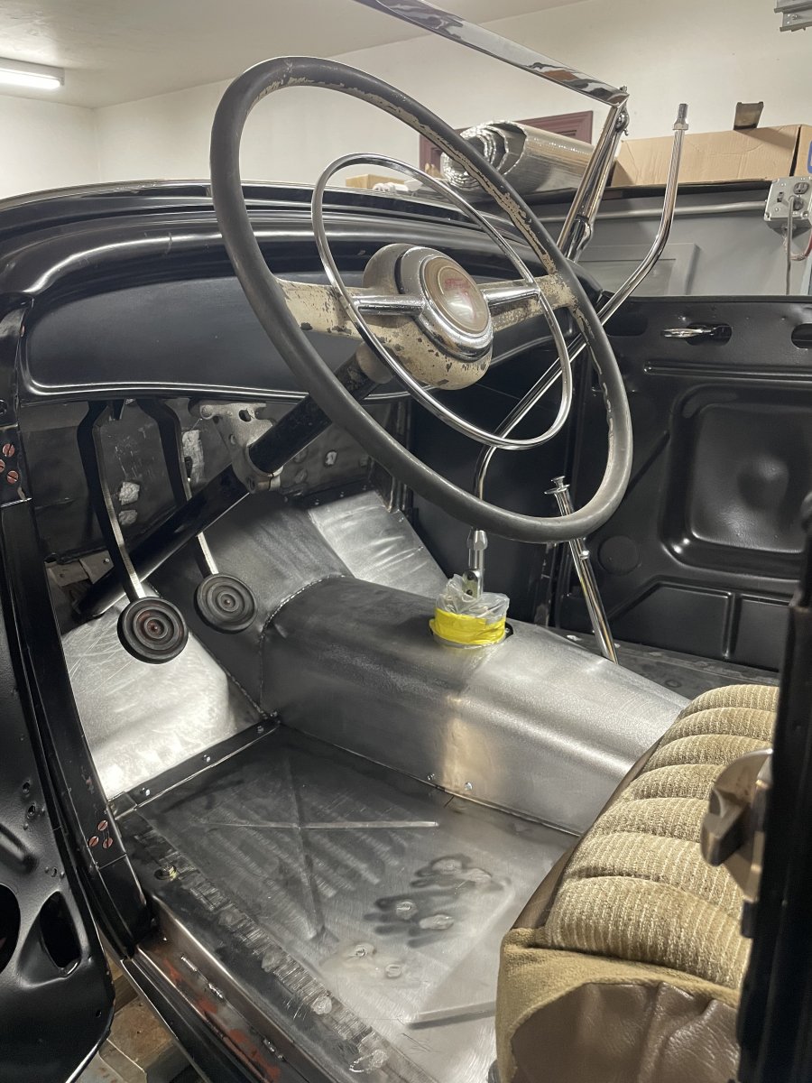

    Had a nice productive day, made up some more floor bracing and skinned both sides up to the toe board area. 63F408A3-31D2-4966-A319-5334E1FF1004.jpeg

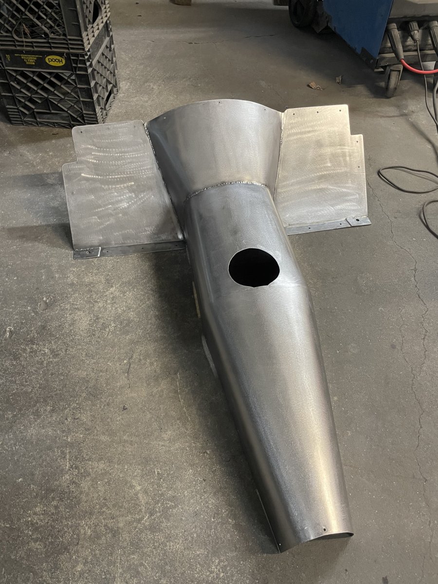

    Picking away at the tunnel this week, with the transmission pretty much inside the car it was definitely a challenge to keep it fitting tight without looking like a square box. These tunnel pieces were formed by hand over a 4” piece of pipe and then welded together behind the shifter. 29C31720-69AB-4E4C-86DB-90A163078FD5.jpeg

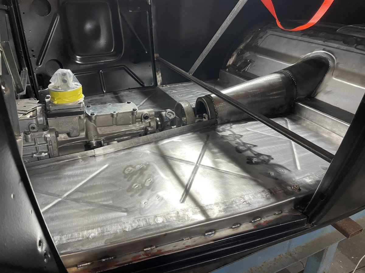

    First I needed to build a new flange along the bottom of the firewall to give myself a target for the trans tunnel to land on. This was made from 1/16” plate and shaped with a torch.
    I decided to weld the trans tunnel and toe boards together to keep it simple. The tunnel is 18 gauge and the toe boards are 1/16” plate.
    Here it is bolted in the car, it adds a tremendous amount of strength to the floor as you would imagine.
    With that project done I cut out the temporary bracing and laid some seat cushions in to make sure I fit before moving on. So far so good!

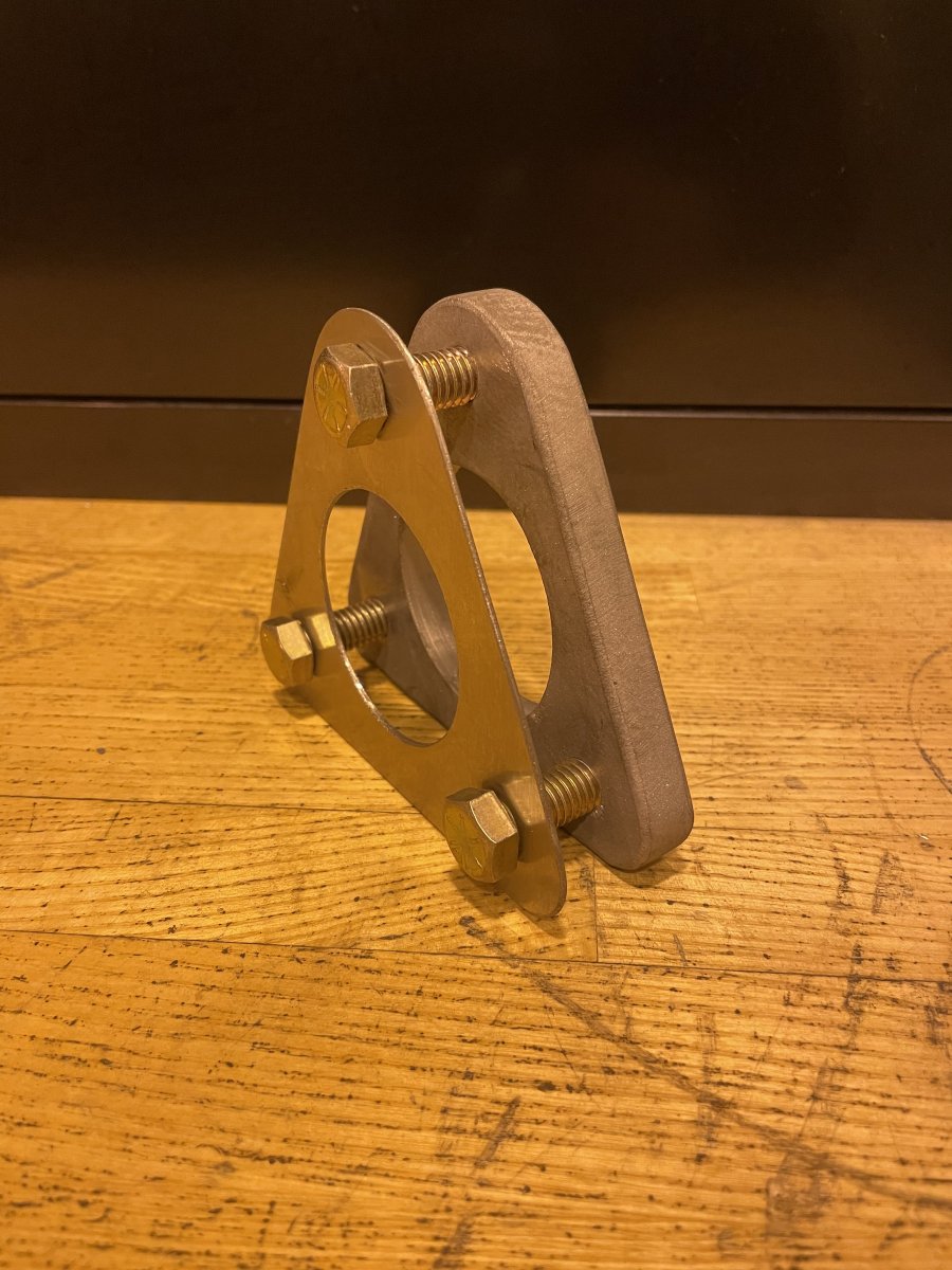

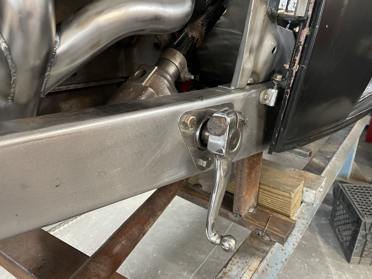

    Here’s what has been going since finishing the floor up.
    Due to the angle of the rails being pinched so hard the F100 steering box needed the flange cut off and a new piece made up. I used a piece of 1/2” thick plate and made a washer out of 16 gauge stainless. 1CB94D81-35E2-4331-AB12-0F5A1648A9CB.jpeg
    This works nice because you can drill your holes, bolt it to the frame and then set the position exactly where you want it before tacking. 2B5CF7F7-AB58-4408-995C-2141AA124BF8.jpeg
    I used silicon bronze filler to attach the flange to the cast steering box.

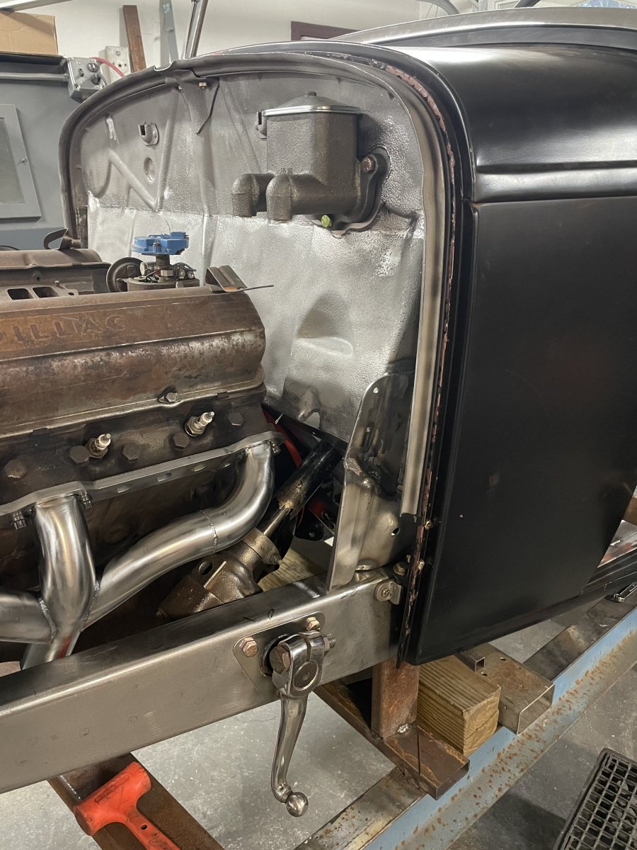

    Now that the steering column was in I made this reinforcement plate 1/4” thick and welded it in to the firewall for the swing pedal / master cyl setup.
    A shot inside the car with how it all lays out. Somehow an original 32 column drop worked out with no modifications. B70426B3-85F2-4851-A40C-C725977E9348.jpeg

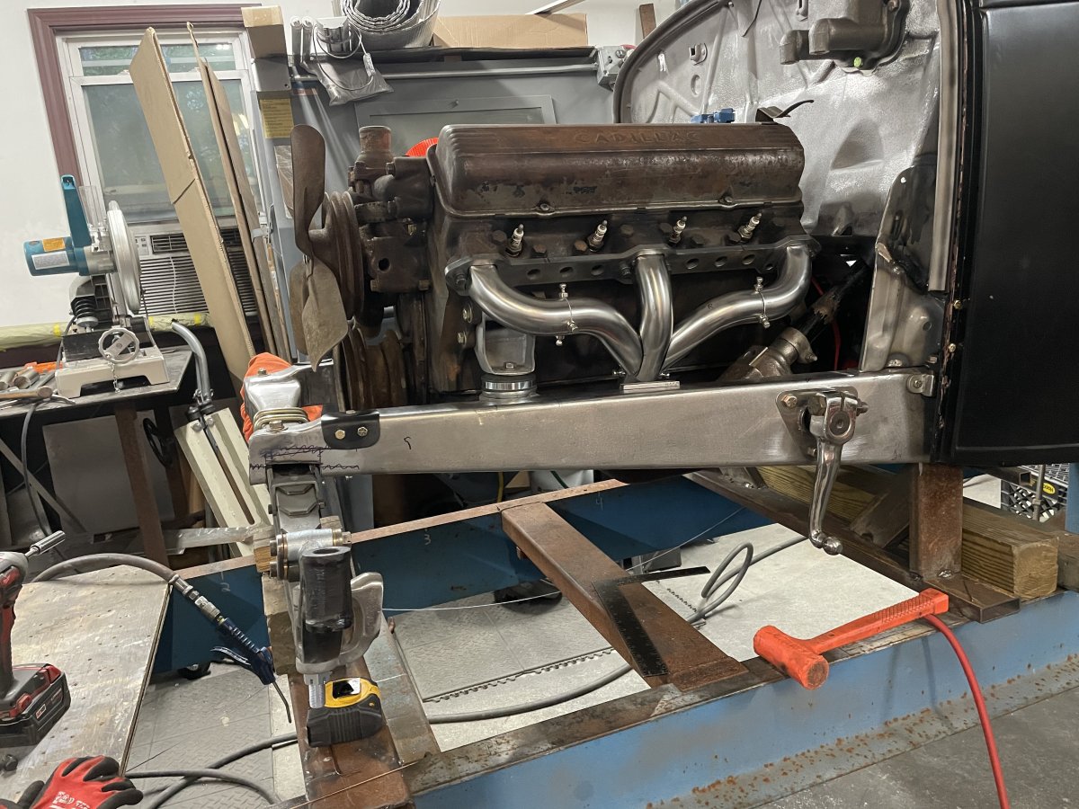

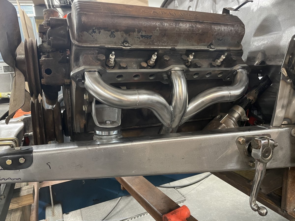

    With those pieces situated I ordered up some mandrel bends and built a set of headers. They probably aren’t the best design for performance but I think they look pretty neat. E41A993E-2FC3-4F43-98AD-2F0A5DF55301.jpeg

  20. TFoch
    Joined: Mar 31, 2010
    Posts: 2,391
    TFoch
    Nice work! Headers look great!

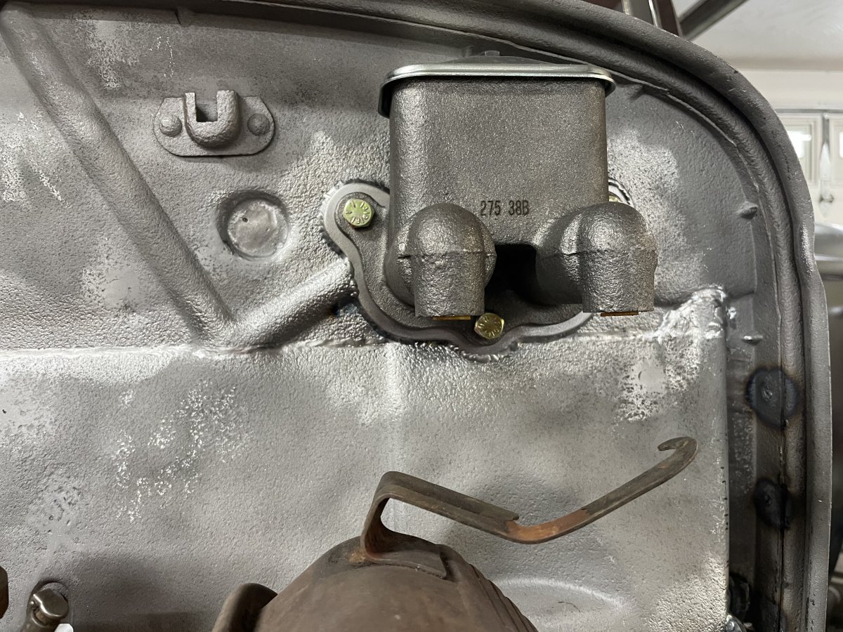

    The pedal setup is from Rjays speed shop, very nice unit. I purchased the master cylinder and slave cylinder from Rockauto. They are early 60’s chevy truck items.

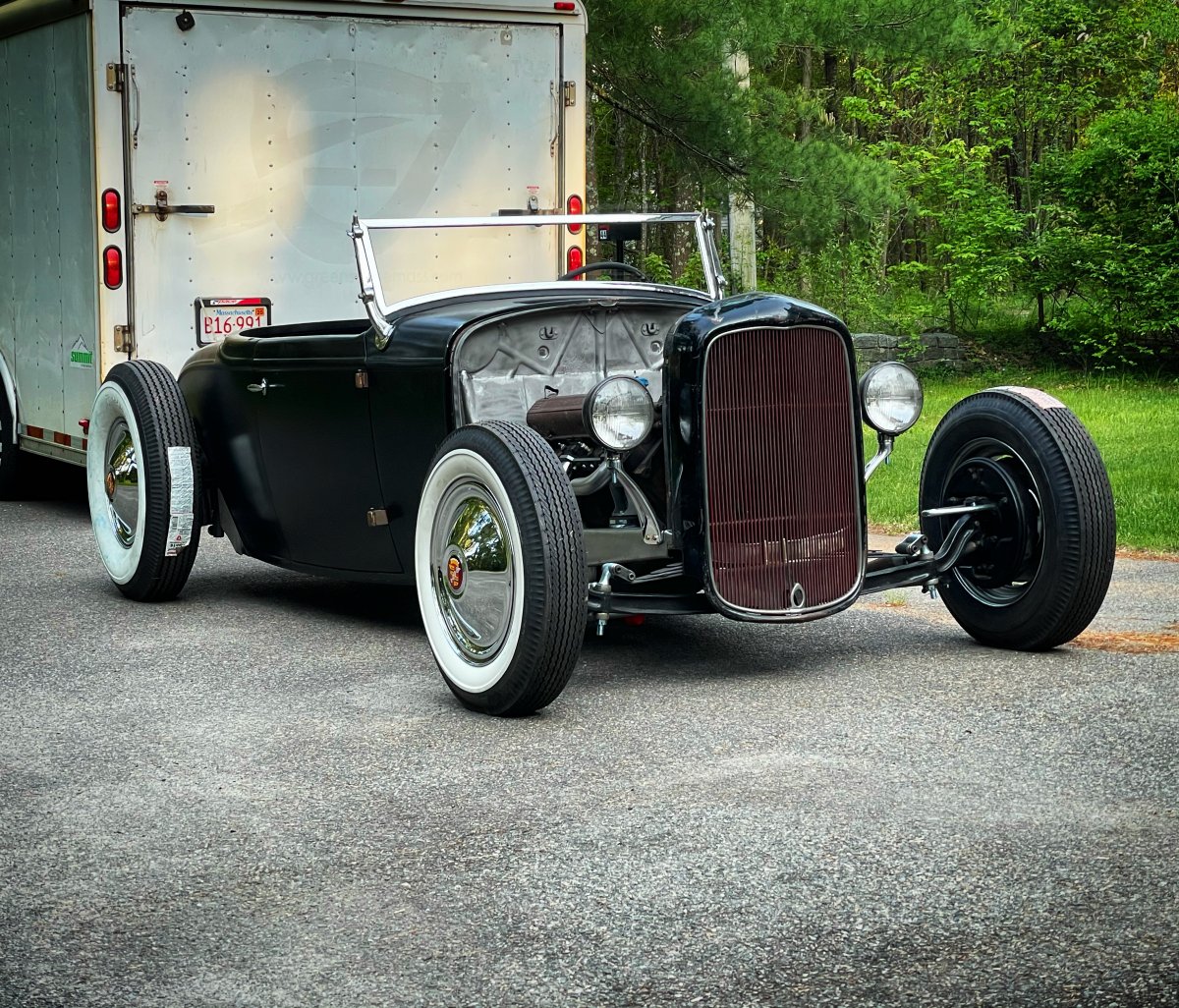

    Man that looks fine! You nailed the east coast look.

    Great "Stance" :)
