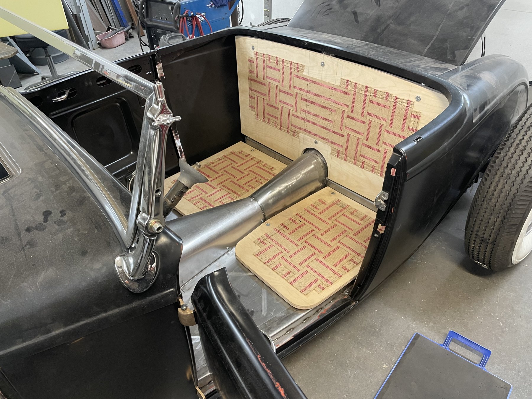

    Decided to take a short break from the metal work and build a seat for the roadster. I used 3/4” ply with some T nuts glued into the wood for mounting. 59FF5A6E-48C8-4A62-95E2-7A7EDD1BD35F.jpeg
    Built a simple bolt in frame to help stiffen the body and mount the seat back to.
    Used some T nuts also to mount the seat bottoms to the floor bracing. Then cut out some windows and added webbing to finish them out. All of the wedge for the seat bottom will be shaped in foam.

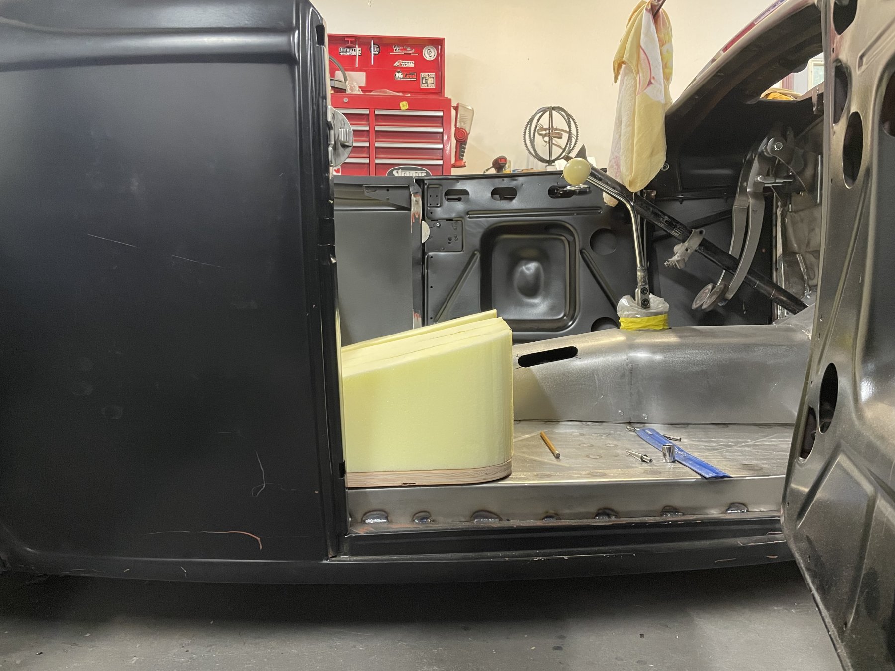

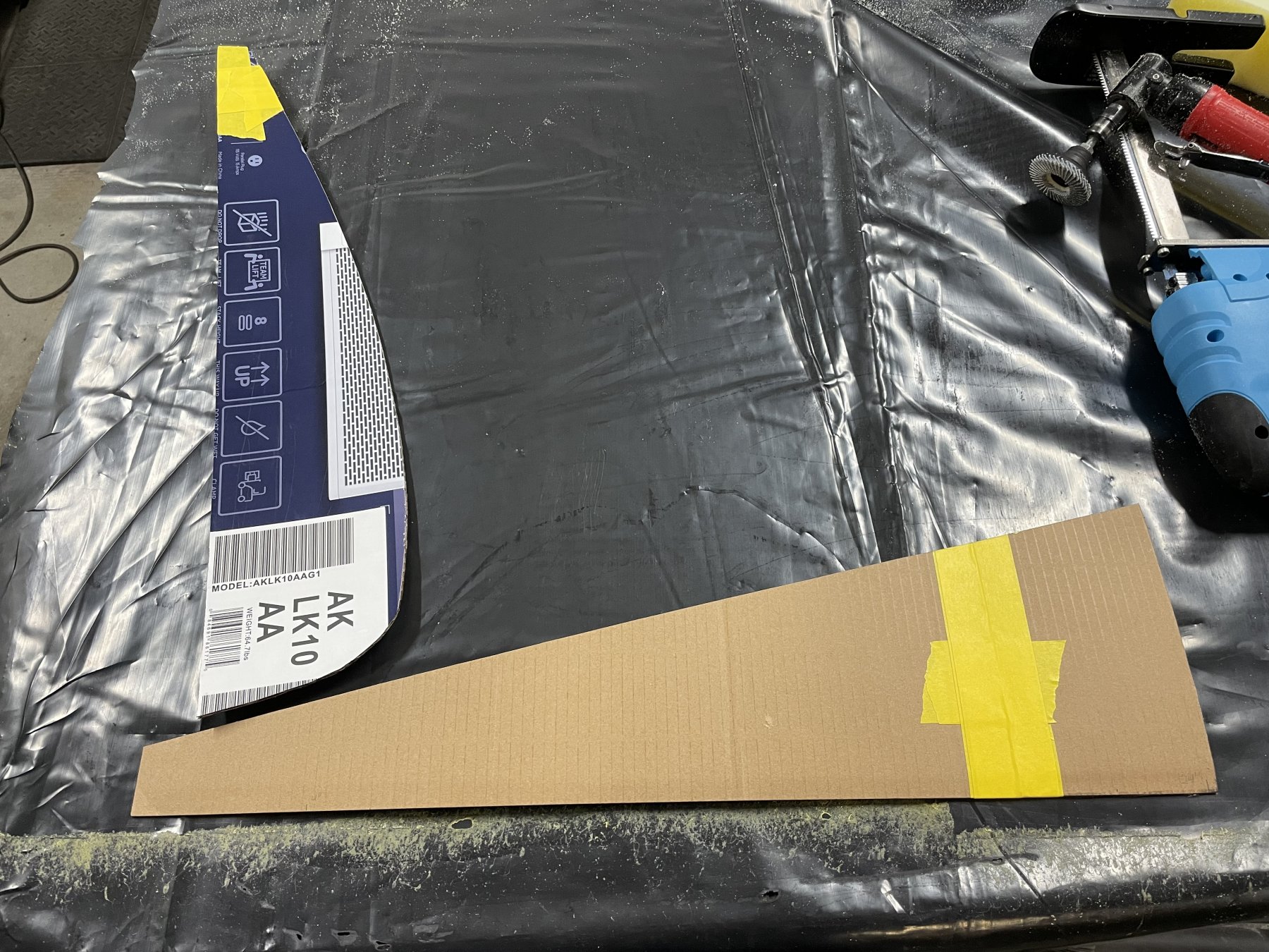

    Here’s how I did the seat foam. First I take some measurements and how much lean back I have in the seat of my truck. I drive 90 miles a day just to and from work so I know it’s comfortable in that setting. Make some cardboard templates and trace it onto the 6” thick foam. 6533B2D1-AF6D-4DB4-8F9B-5EB7219277A3.jpeg
    I used 53lb foam for the seat bottom and 35lb foam for the back rest. To do it this way you must use good glue, I use Weldwood Landau contact adhesive. Cut out the pieces with a foam saw or band saw and glue together.
    Here’s a side shot showing how much support there is under the legs.
    This has more wedge to the seat bottom then my daily driver truck but it’s needed because when you sit lower your legs rise up also.

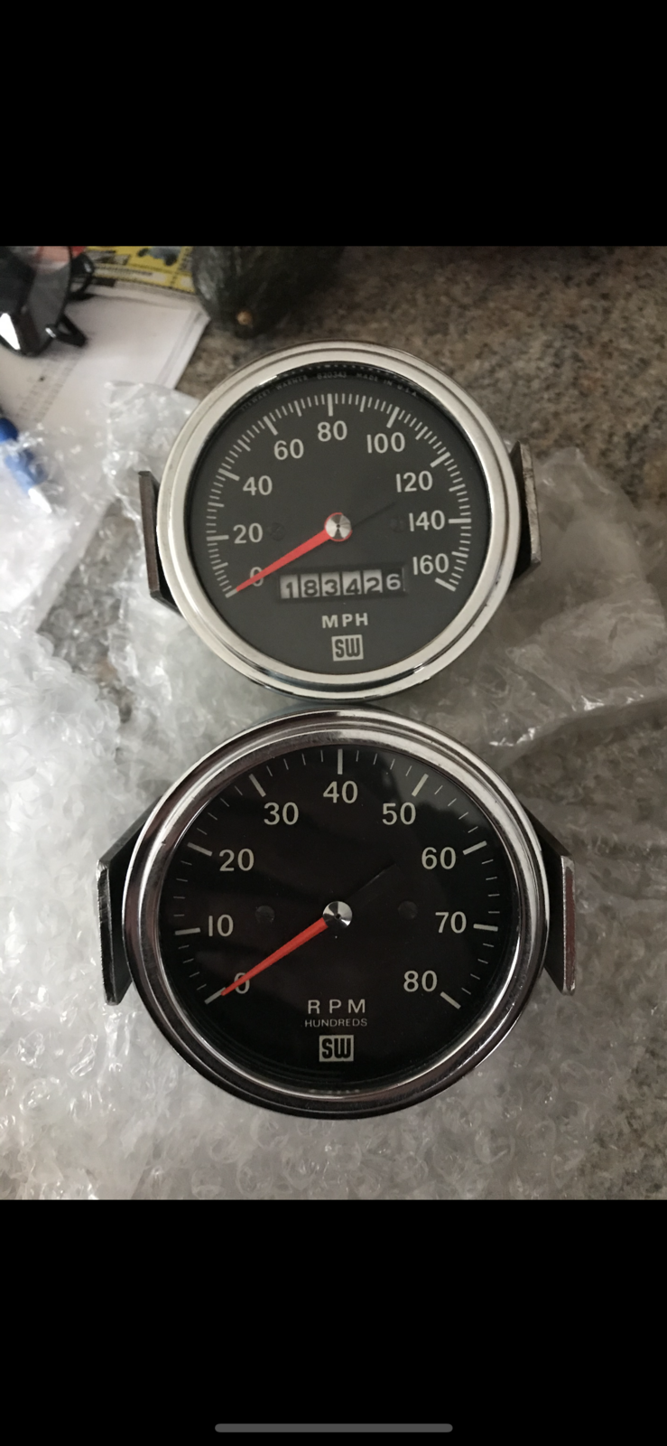

    I bought this speedometer and Tach from the Hamb cl***ifieds a while ago now because they were clean and a great price. My plan was to open them up and paint the needles white so they would match the other gauges.
    Instead of trying to get the chrome bezels off and risk damaging them, I used a pipe cutter down near the back and cut through the body itself. This allowed me to paint the needles and then just used a little bit of epoxy and glued it back together.

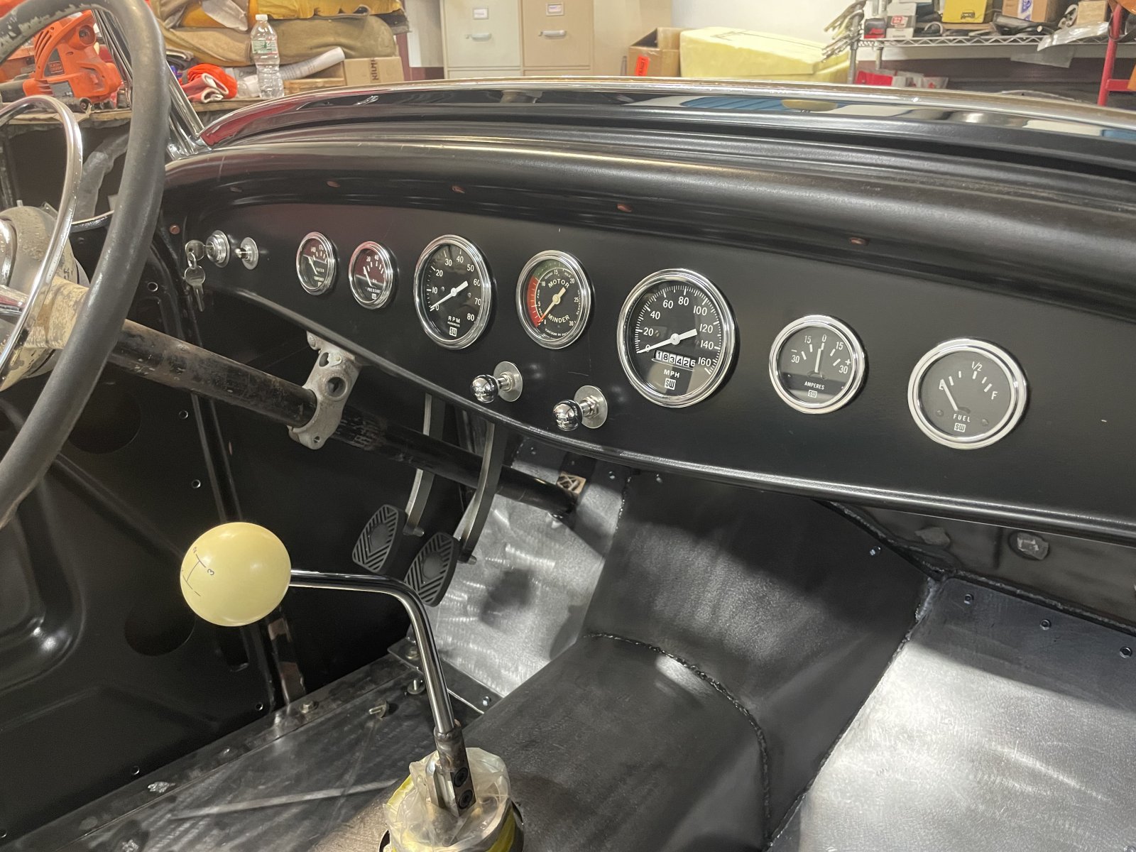

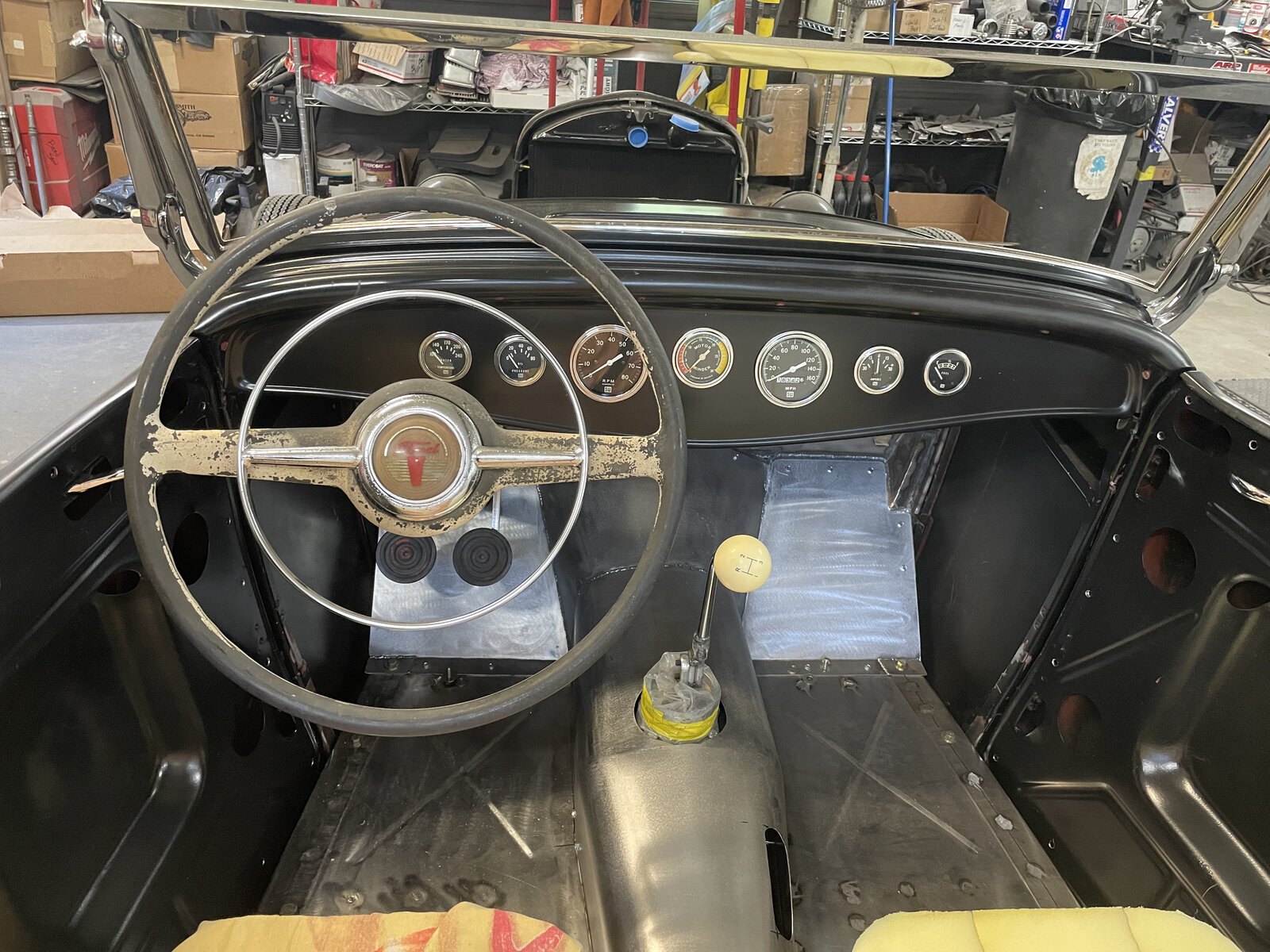

    It worked out great and I wouldn’t hesitate to do it again! With those situated, the dash was laid out and drilled. There’s more to come with it but it was great to see it start to take shape.

    I was cringing at taking a pipe cutter to vintage gauges, but they turned out great!
    I may try that on a vacuum gauge that I have been trying to get apart.

    It was a bit of a gamble but I figured there was no way I’d get the bezel off and on without distorting it or damaging the chrome.

  12. scoop that seat base foam, you need a leg bolster to keep you from sliding forward. Doesn't need much, your legs and back will than you.

    I did add some foam around the horse shoe but it has enough wedge and lean back that you feel pretty planted in the seat as is.

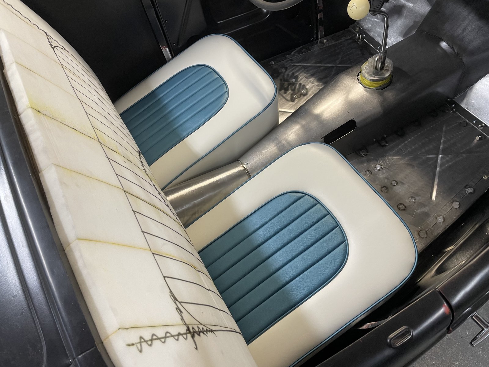

    I started by patterning and doing the upholstery on the seat bottoms first.
    Once those are bolted in, I then match mark the seat back foam to the base so I know the pattern will line up. This seat back was pretty complicated to sew together, although it’s far from perfect I learned a lot doing it and think it looks really neat.
