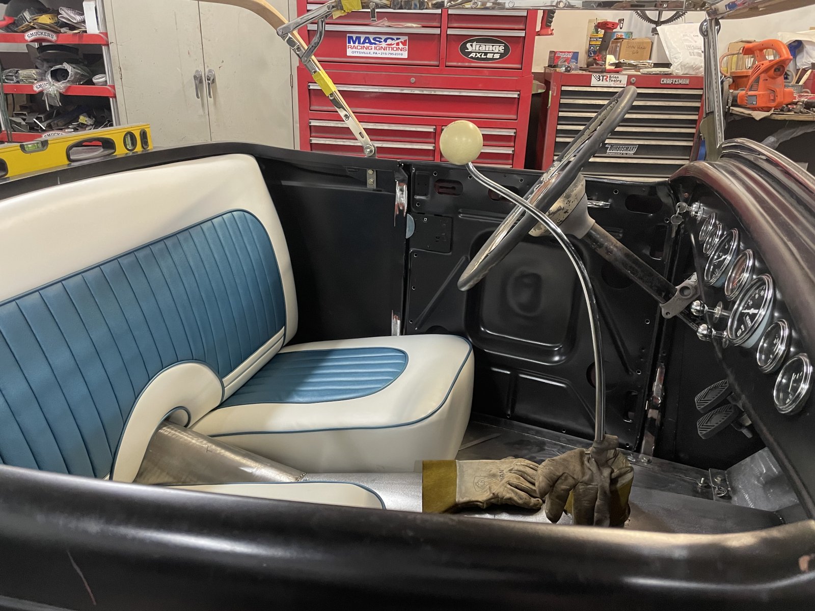

    The @Angry Frenchman hooked me up with this nice old swan shifter. The bottom was bent and twisted so it was the perfect candidate to cut up and fit to this car. 8953FA13-DB30-47BD-86B0-E11EEA7E45DC.jpeg

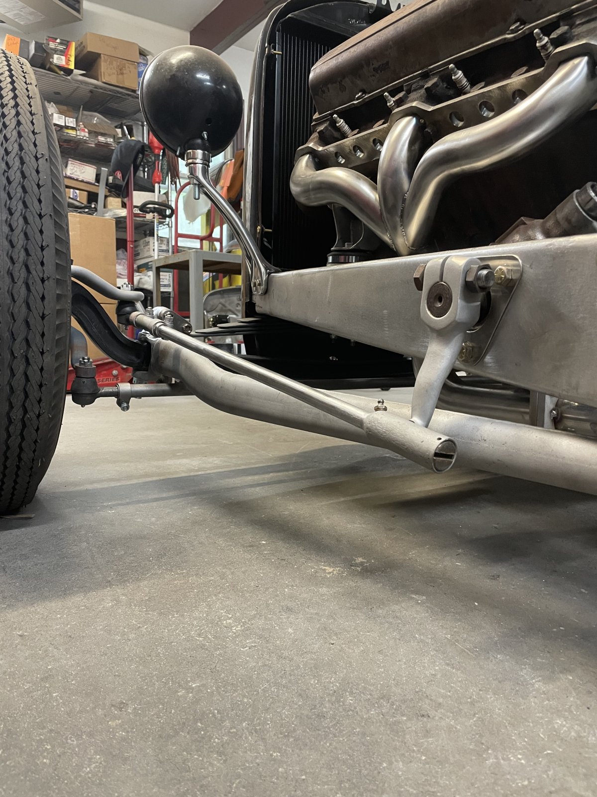

    Nothing too exciting for updates the last month, pulled the body off a little while back and got the floors all welded and finished up.
    Before it came off the gas tank was mounted and made a through the body fill neck using a early style cap. 4F0AB96D-5774-442C-8496-570B3C04079D.jpeg

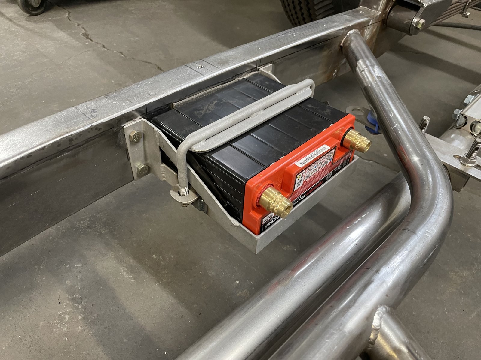

    I really like the PC680 battery that’s in my coupe so I decided to use one on this car but mount it under the floor. Made up this simple mount that can be unbolted and dropped if I need to change the battery.

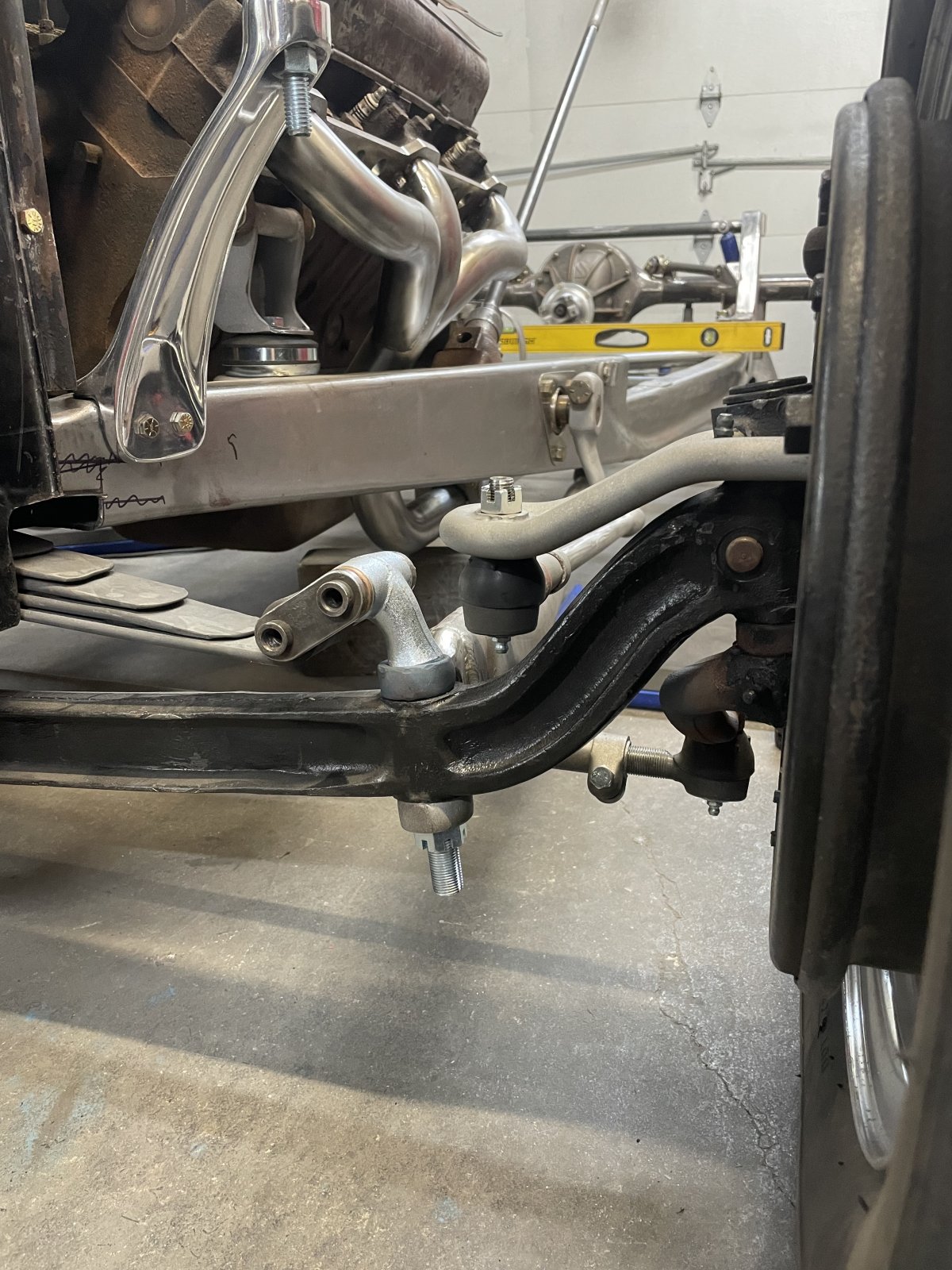

    47 wishbone split with flipped 32-4 axle yokes and some tie rod tube ends, a little funky but works well for what I needed.
    With the bones mounted, the steering hoop got some heat and a drop to reduce the drag link angle.

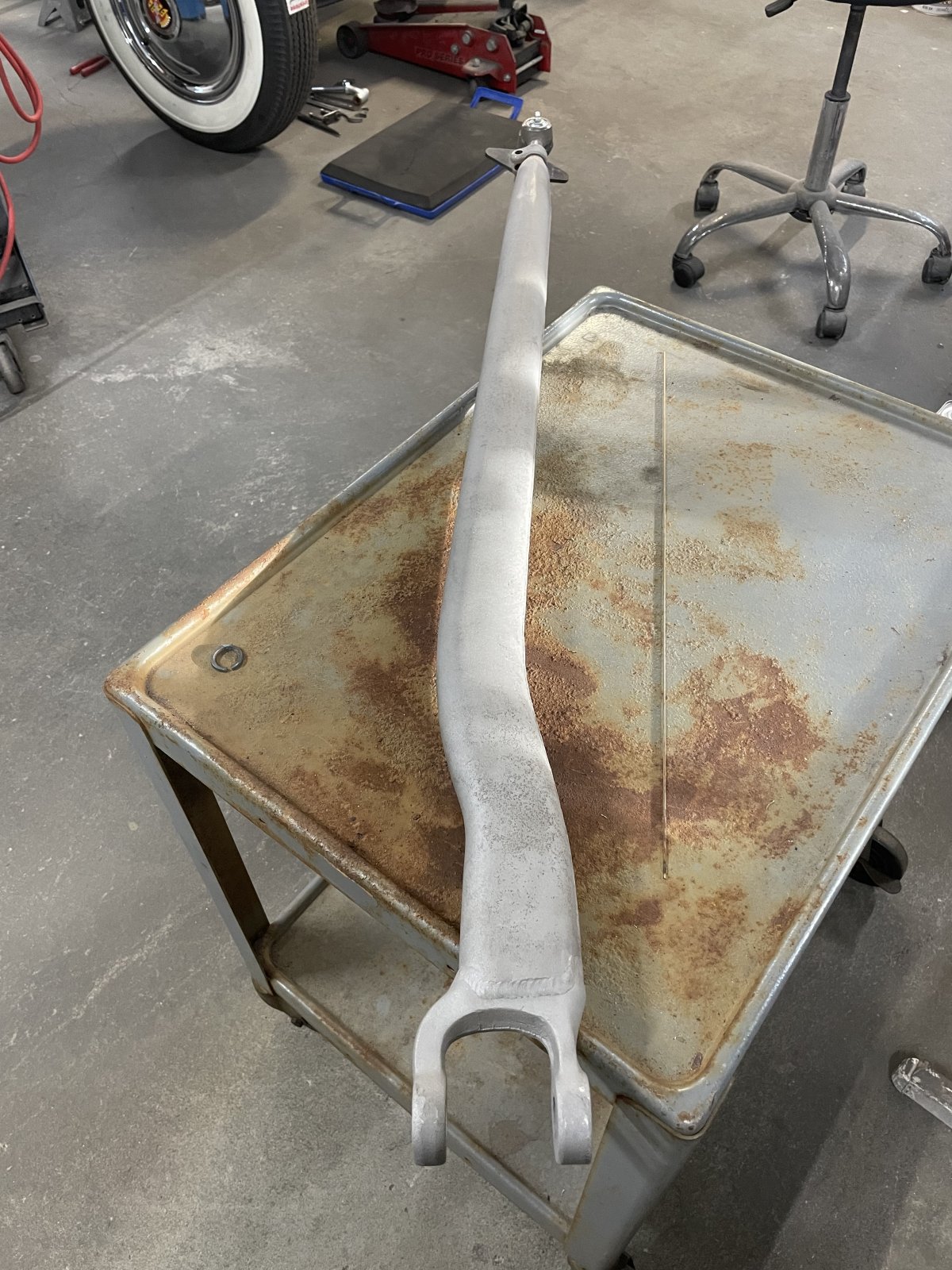

    The pitman arm is shortened 1” and the drag link is F100 spliced into what I think is a 40’s Ford adjuster.
    Long ways to go but making progress.

    Nice to see the update! But sorry to say your neat under-frame battery mount is the first feature I find too cool for it's own good. I had a hidden battery box once, but never again.
  10. Remote charging posts can make it a lot more practical.

    Thanks guys, yes it will have remote charging posts and a latching relay for a battery shut off.

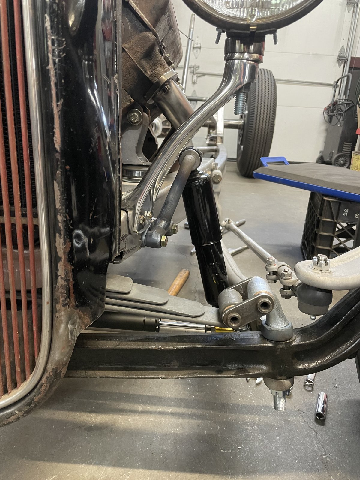

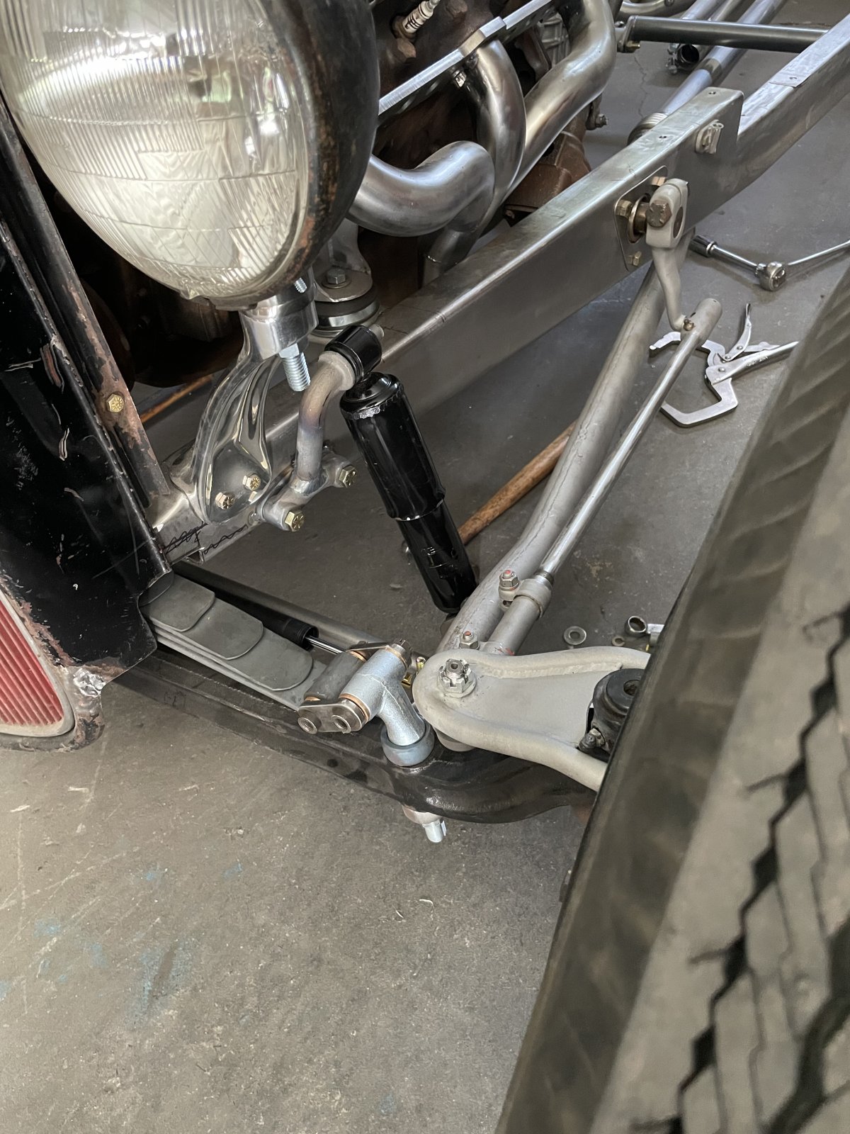

    Next up was modifying some F1 mounts to get the shocks located. They are cut up quite a bit but the picture tells it best.
    There’s a 3/16” doubler plate with threaded bungs welded in that the mounts bolt to.
    You can also see the steering stabilizer is mounted. It just uses a tie Rod clamp on one end and two small tabs to mount to the wishbone.

    Great build, dont know how I missed it before. Love this battery idea, curios as to how the one youre allready running is doing? Looks really small, and a race battery , how does that work for a street car, lights, radio etc. This would sort out my battery location issue if its up to being used in a driver. Thanks
  16. Curious about that 680 as well since I am on the hunt for a battery for my Olds powered 31. Rated at 170CCA's seems a bit light to me.
    alanp561, Stogy, 51box and 1 other person like this.
  17. While we are talking about the battery; will you be able to remove the battery hold down bracket when the body is sitting on the frame? And wiggle the battery out of the tray?
    Just thought I should ask before the body goes on.
    Love the build.
  18. Looks to me like remove all 4 bolts and drop the total unit down, then remove the tray.

    From the hunting around I did before, the PC 680 is the same battery that comes in “booster packs” . I let the car sit all last winter without a charger and it started right up. It works great in my coupe and will crank the 425 nailhead no problem.

    I made it so you just take the 4 bolts out of the chassis and lower the whole assembly straight down to get the battery out.

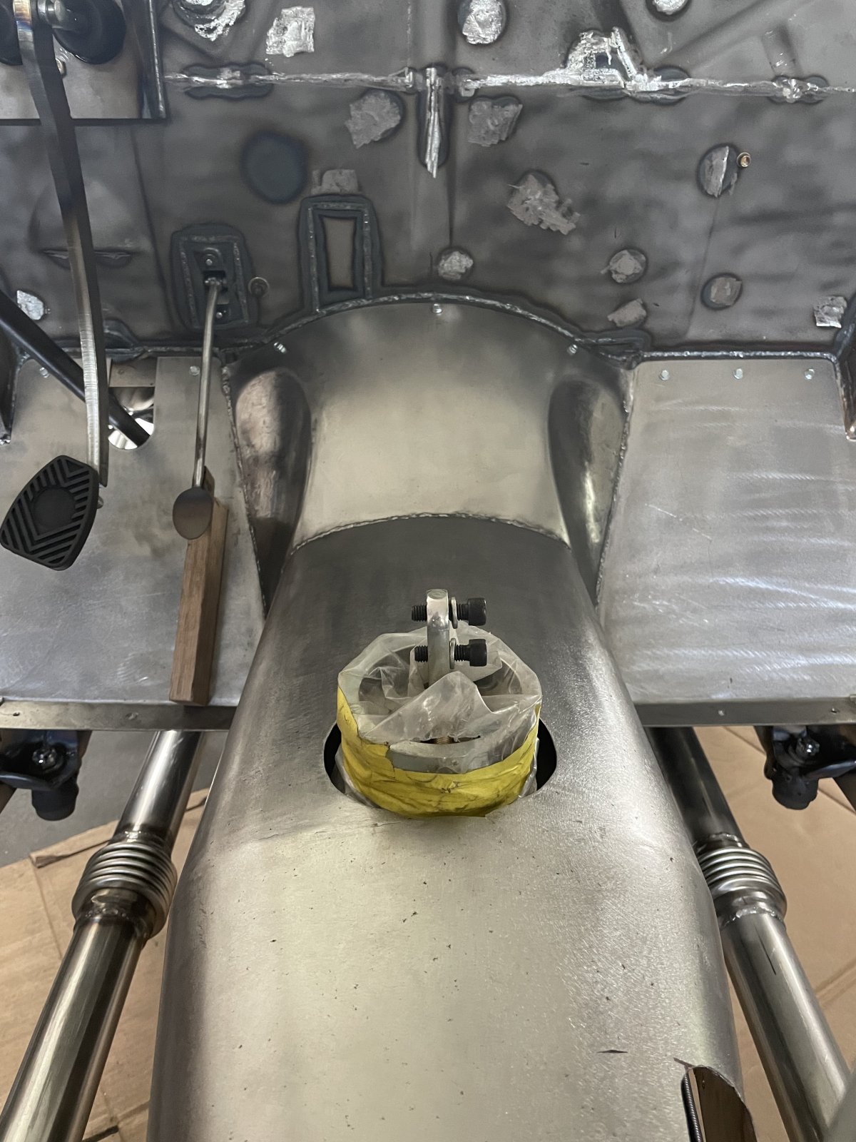

    Most of what’s been going on is small jobs to get everything finished up before blowing apart for paint. Cut up a stock throttle pedal to work around what’s been done. You can see where the mount use to be I cut it out and moved it over a few inches.
    Also formed some pockets in the tunnel because my foot didn’t fit between the brake pedal and tunnel very well. 2535538A-4478-4A11-A114-2B8B7D9CA30B.jpeg
    Put it all back together after doing brake lines and some small things with the body off.

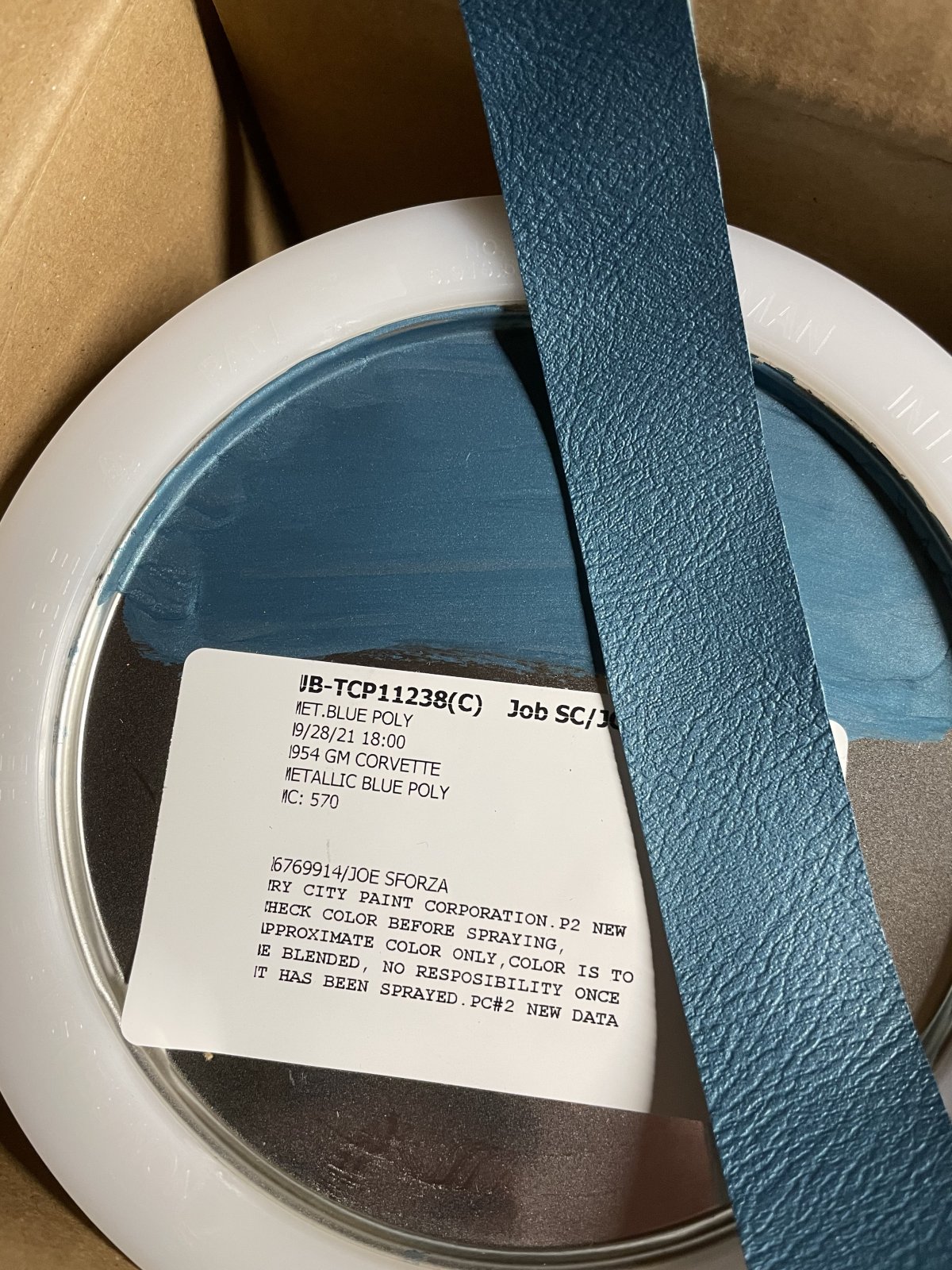

    Here is the paint color it’s supposed to be 1954 corvette pennant blue but it’s a little off. Just so happens to match the upholstery pretty dang close so I’m going to use it. 25AFBEF6-9CB8-4C02-B93B-860E40B70122.jpeg

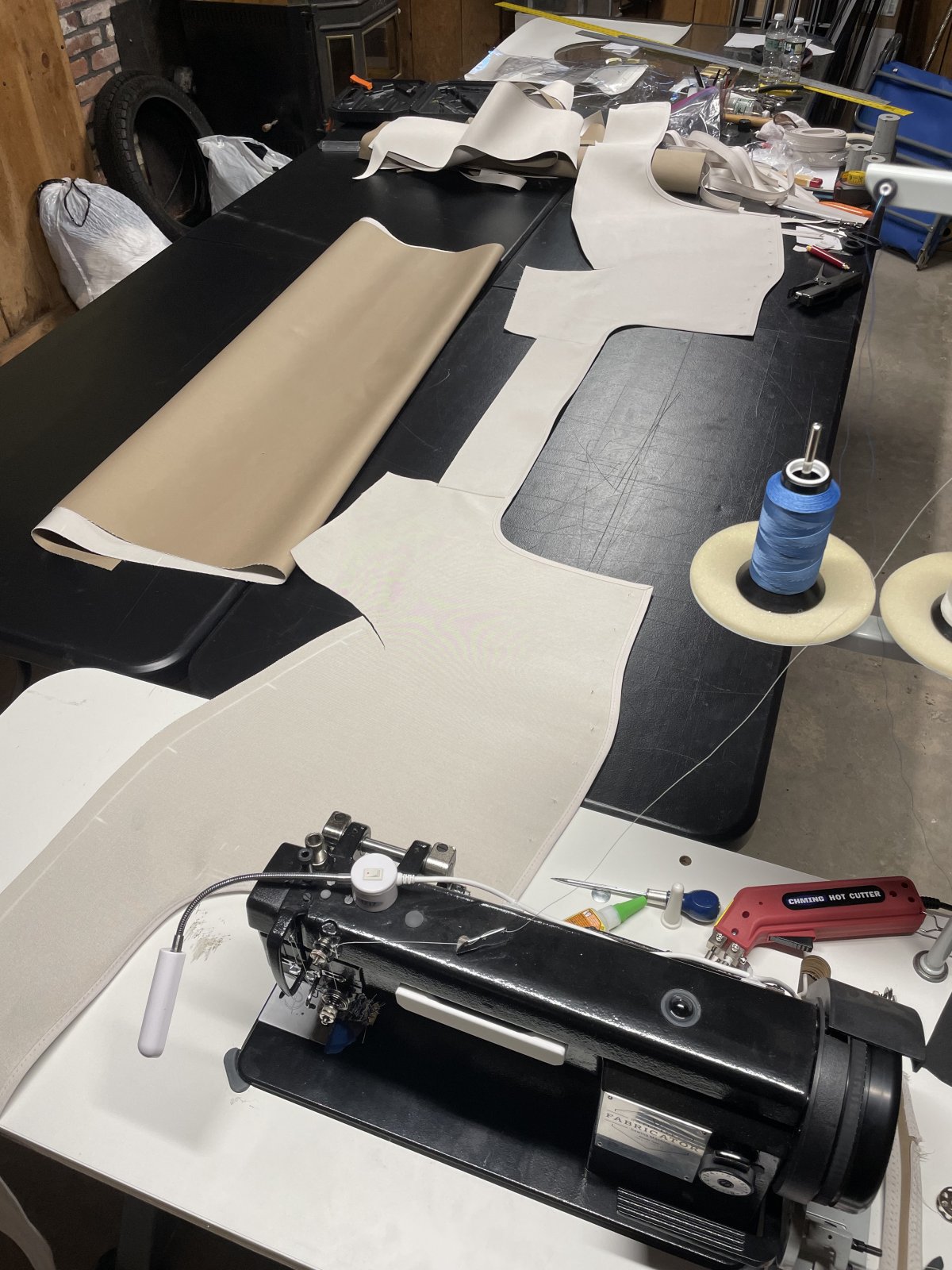

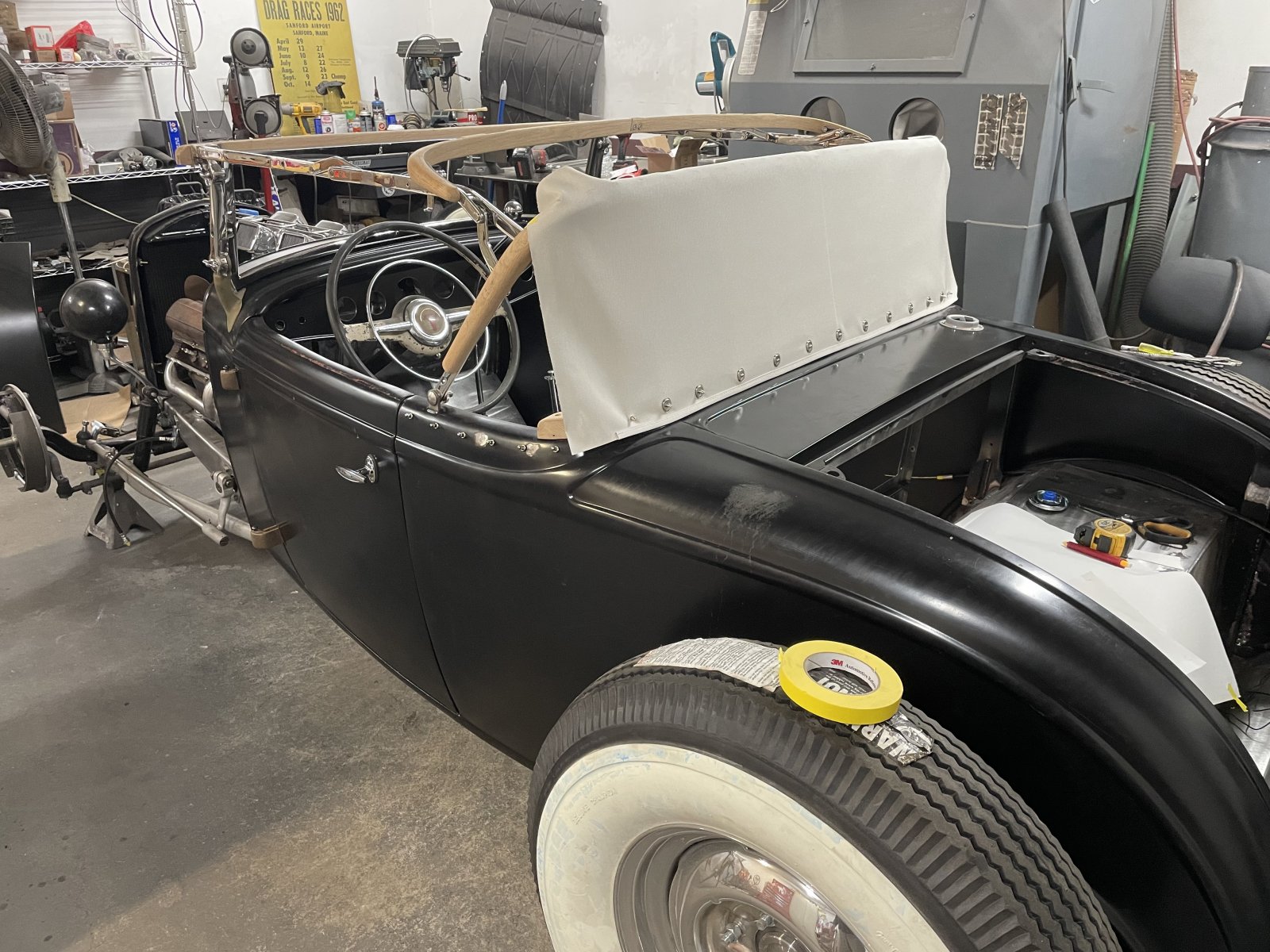

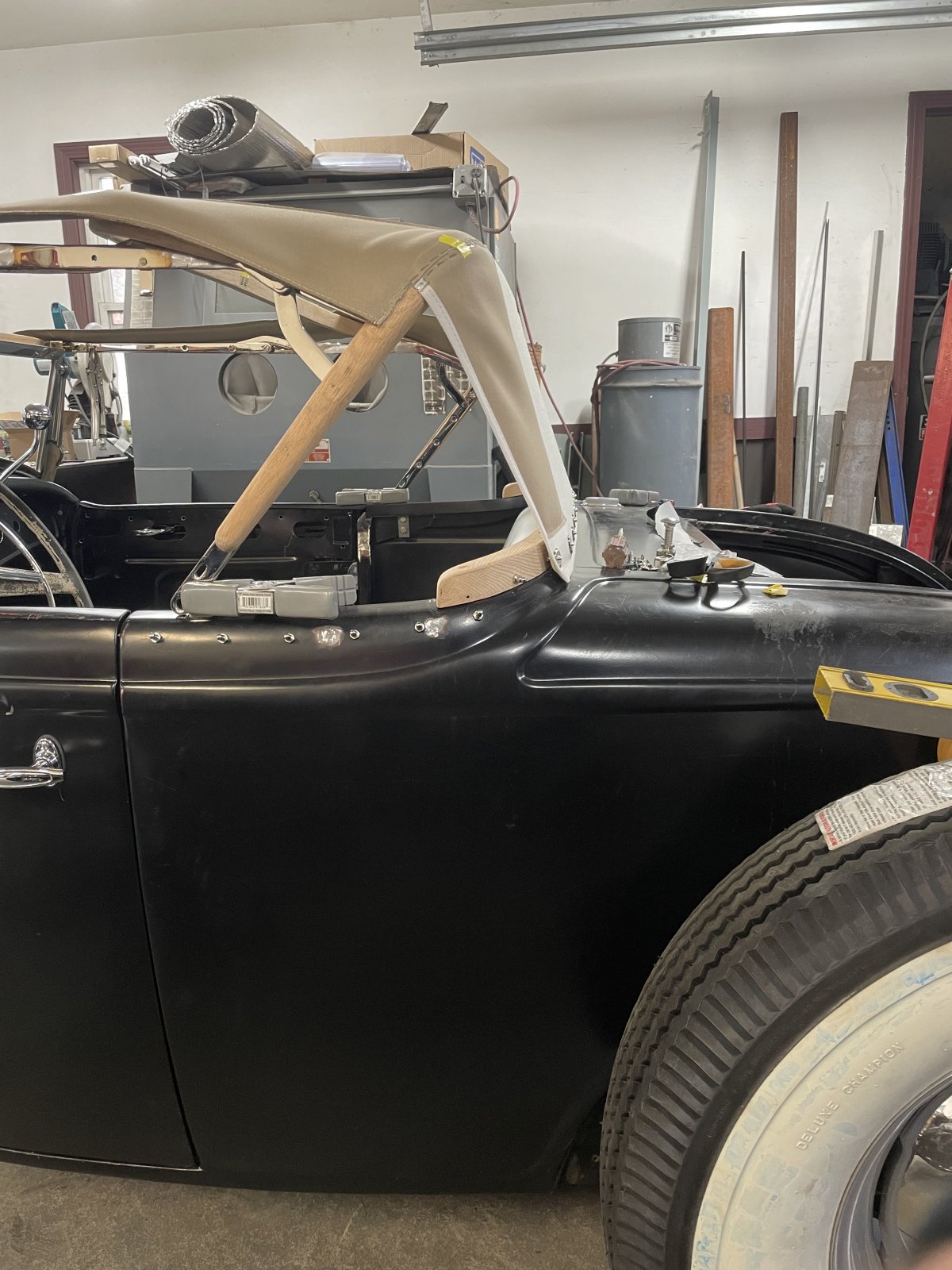

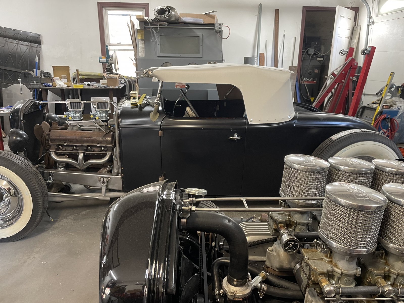

    FIrst up was to fit this wood tack strip sold by brookville. It takes a lot of slow sanding and fitting to get it to match the body. 14C2DA7E-5E7D-471B-9581-1A0E7B52F137.jpeg

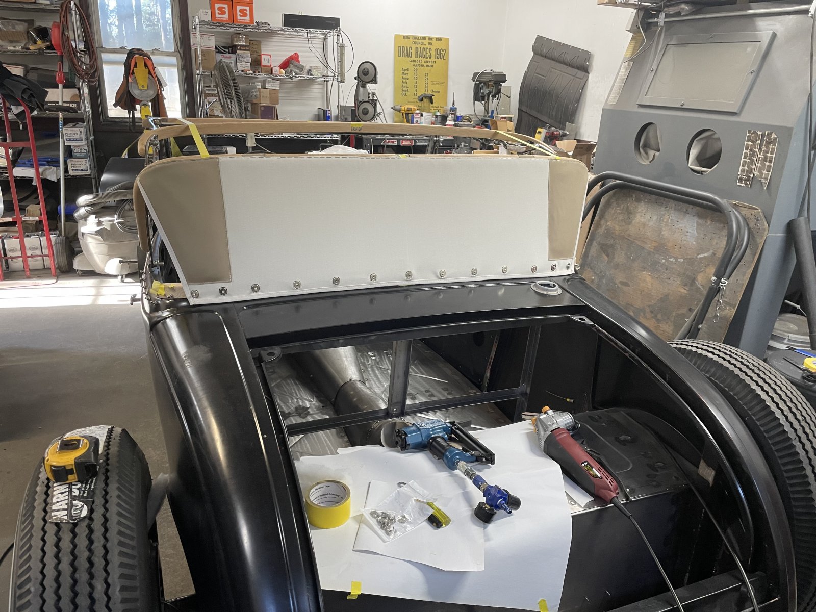

    After that is bolted down the “lift the dot” studs are installed. They sell them both in machine screw and wood screw. Rear window panel was fit up first. C30F6732-C42D-45B7-A0E5-71010D0A7A62.jpeg
    I decided to sew on some padded ends to help keep the top from sinking in when it’s stretched. EC0CFF18-1032-4C70-86F1-C27E7931BBFE.jpeg
    At this point I decided the rear bow needed to come forward another inch. Had to remove what had been done and cut up the top irons to do it.
    Once I was happy with the bow, the rear panel was stapled in and started to lay up the sides. I wasted 2 pieces doing this. All I can say is leave it way over size and stretch every way possible to get it tight before cutting the window shape in.
    Once I was happy with those the top piece was laid with a couple staples and match marked all my seams and cut lines.
    Here I have the edging sewn on and the sides sewn to the rear over window panel.
    That’s about where it stands, need to sew the top piece on and set the fasteners in the material next.
