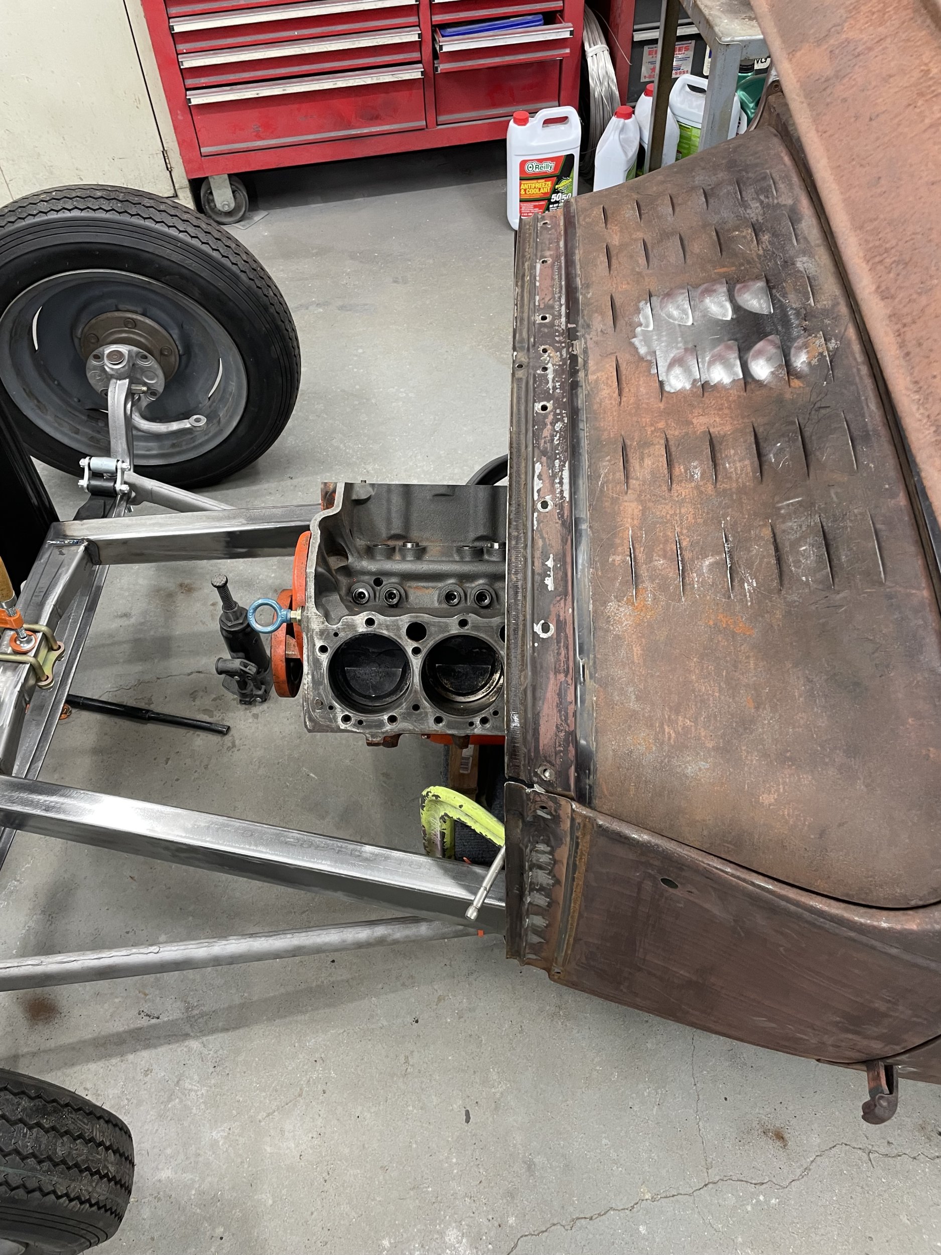

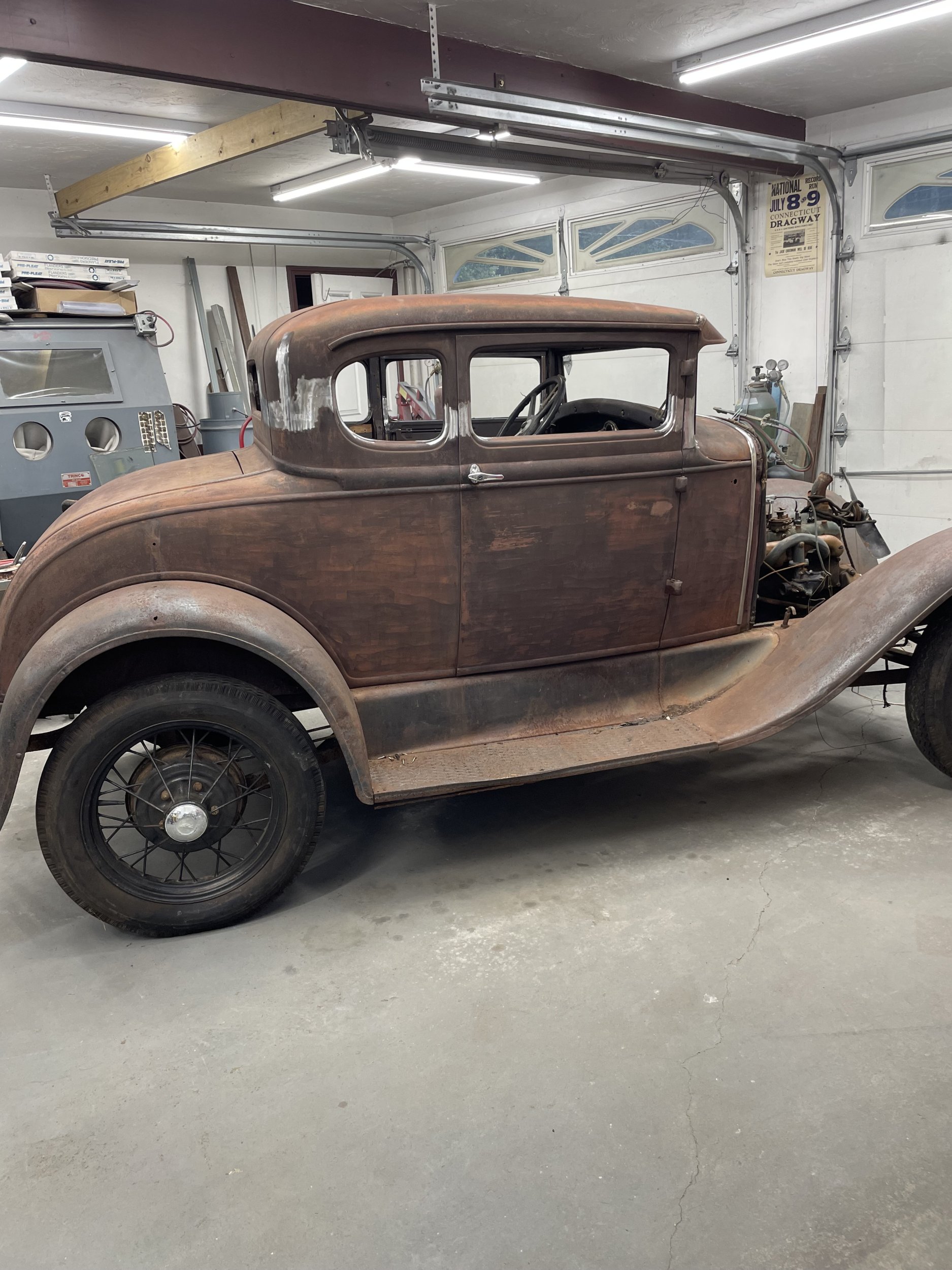

    So I’ve been daydreaming about an early style drag coupe for a while now and finally pulled the trigger on a 30 coupe to get the ball rolling
    First order of business was to chop it before removing it from the stock ch***is. It came out to about 4.5”s
    Because the engine will be set back to the A pillar, I decided to put louvers in the cowl top to help get rid of some heat.

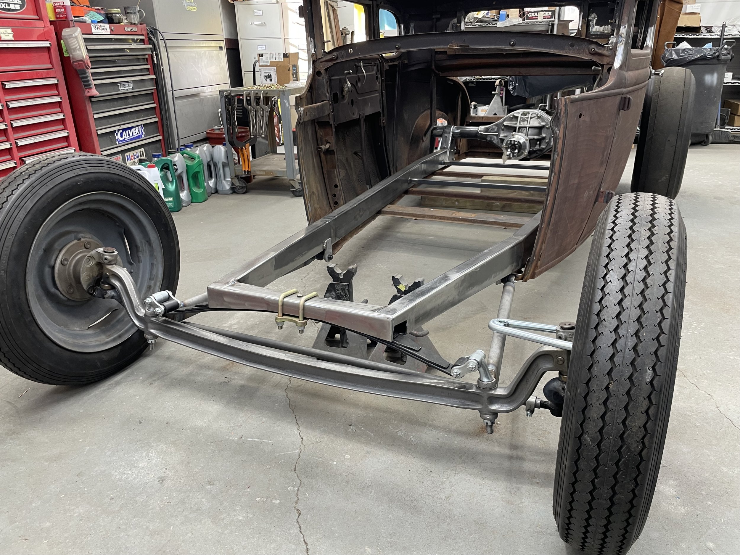

    I built a really simple 4x2 frame tapered and swept up 2”s in the front and pinched to fit a 32 shell.

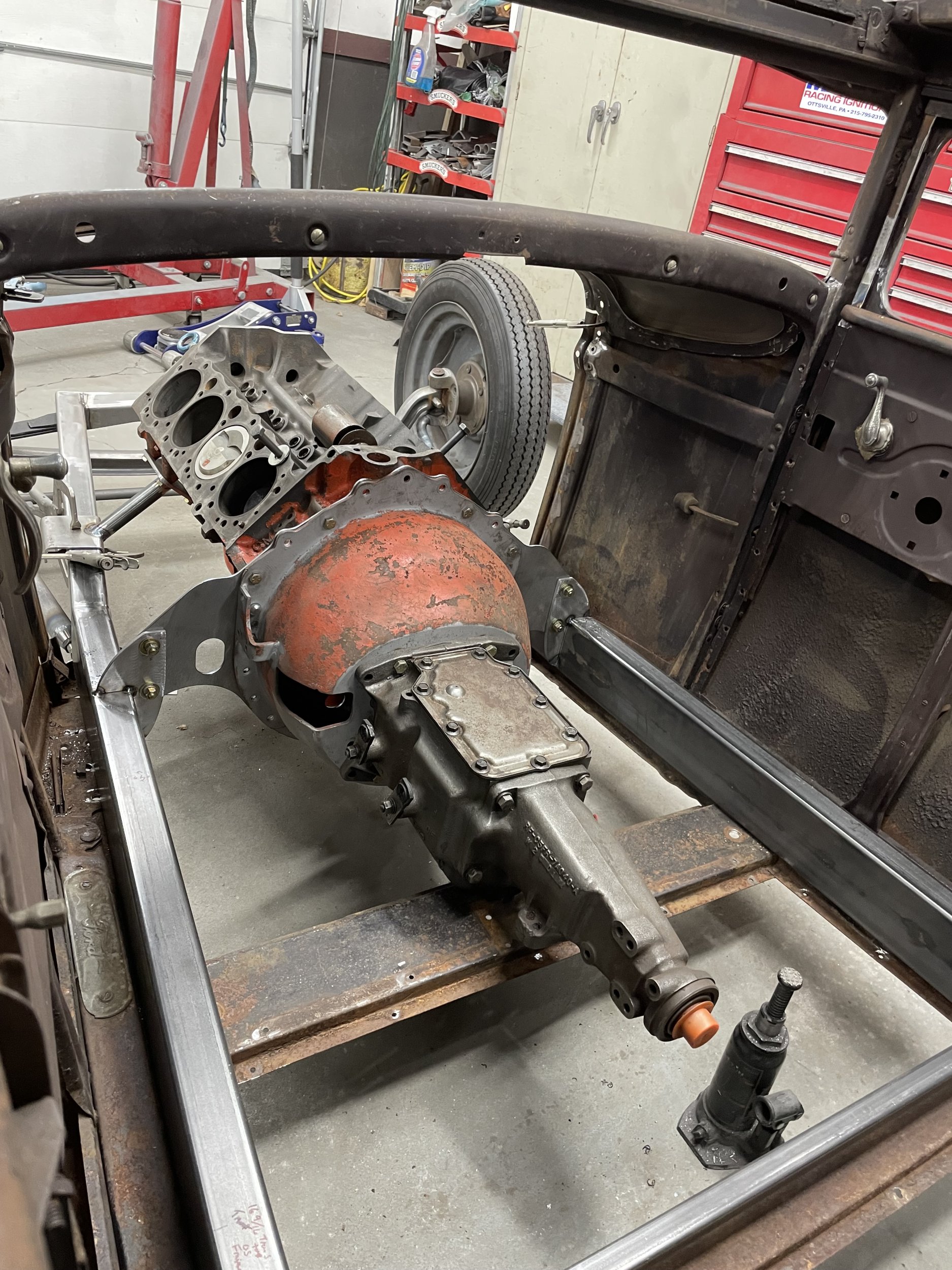

    With the 283 set back as far as I could go and still fit in the car.
    Trans is a Dearborn toploader 3spd with a Ram slipper clutch. 9” rear solid mounted with spool and 5.29 gears.
    Steering box is a mid 50’s f100 with a mix of original ford and aftermarket parts to complete the suspension.

    Really like the chop. For some reason it looks like you made the cuts in different locations than others. Nice that you started with a solid body.
