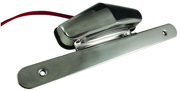

    Need to mount the rear license plate, I definately want it centered. Was able to find a license plate light / bracket from Bob Drake for $50.00.
    Item Number: HR-13550. Decided to use this one since it looked like it would work fine with little modifications.

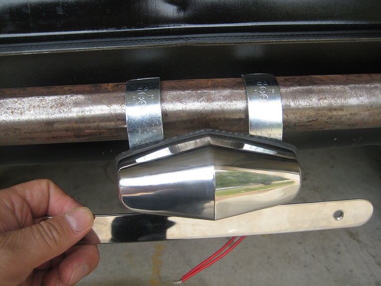

    Made a trip to the local Home Depot to see if I could figure out how to mount the bracket without welding since I dont want to have to remove the gas tank. I was able to find some clamps in the electrical section that were about an 1 1/2" in diameter which would fit the rear spreader bar.
    I cut the clamps in half thinking I could use them like tabs and atatch to the back of the plate where there are two screws for mounting.

    I really did'nt like the way the tabs looked on top so I turned them around thinking if I drilled and tapped the spreader bar that would look cleaner. Seems like it will work making the tabs non visible and a much cooler look.

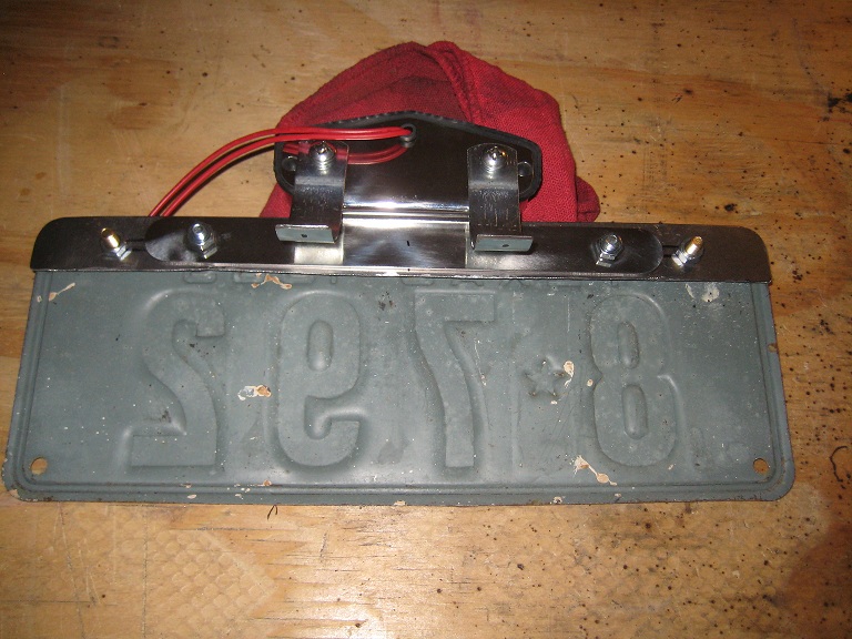

    Now to attach the metal plate that I cut to the bracket, that will allow me to get the right spread so the 1933 plates can get bolted on.

    Now to mount the license plate to the bracket. I had to add a nut to each side to help fill the gap the bolt attaching the bracket to the extra metal plate, this also helped make sure the license plate would be straight when bolted on.

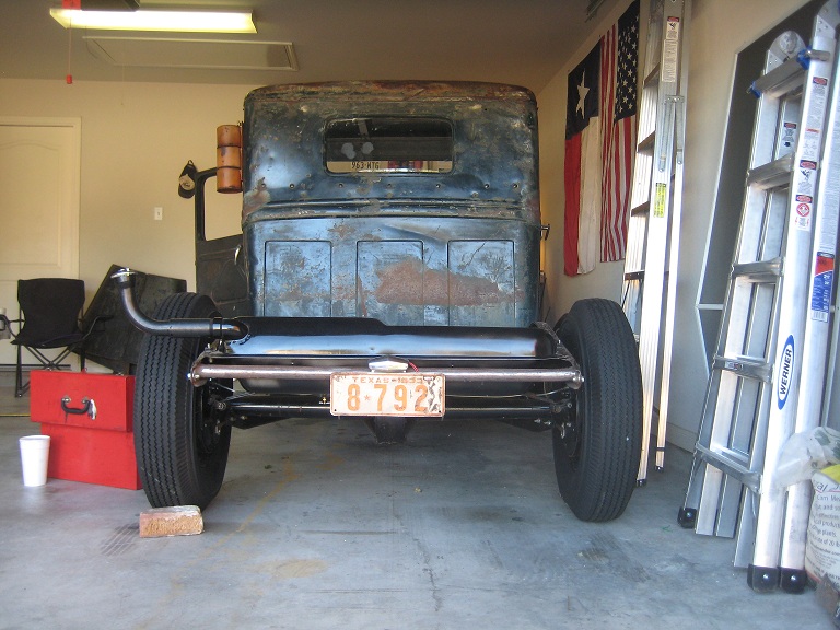

    Drilled and tapped a few holes on the spreader bar and monuted the license plate bracket.
