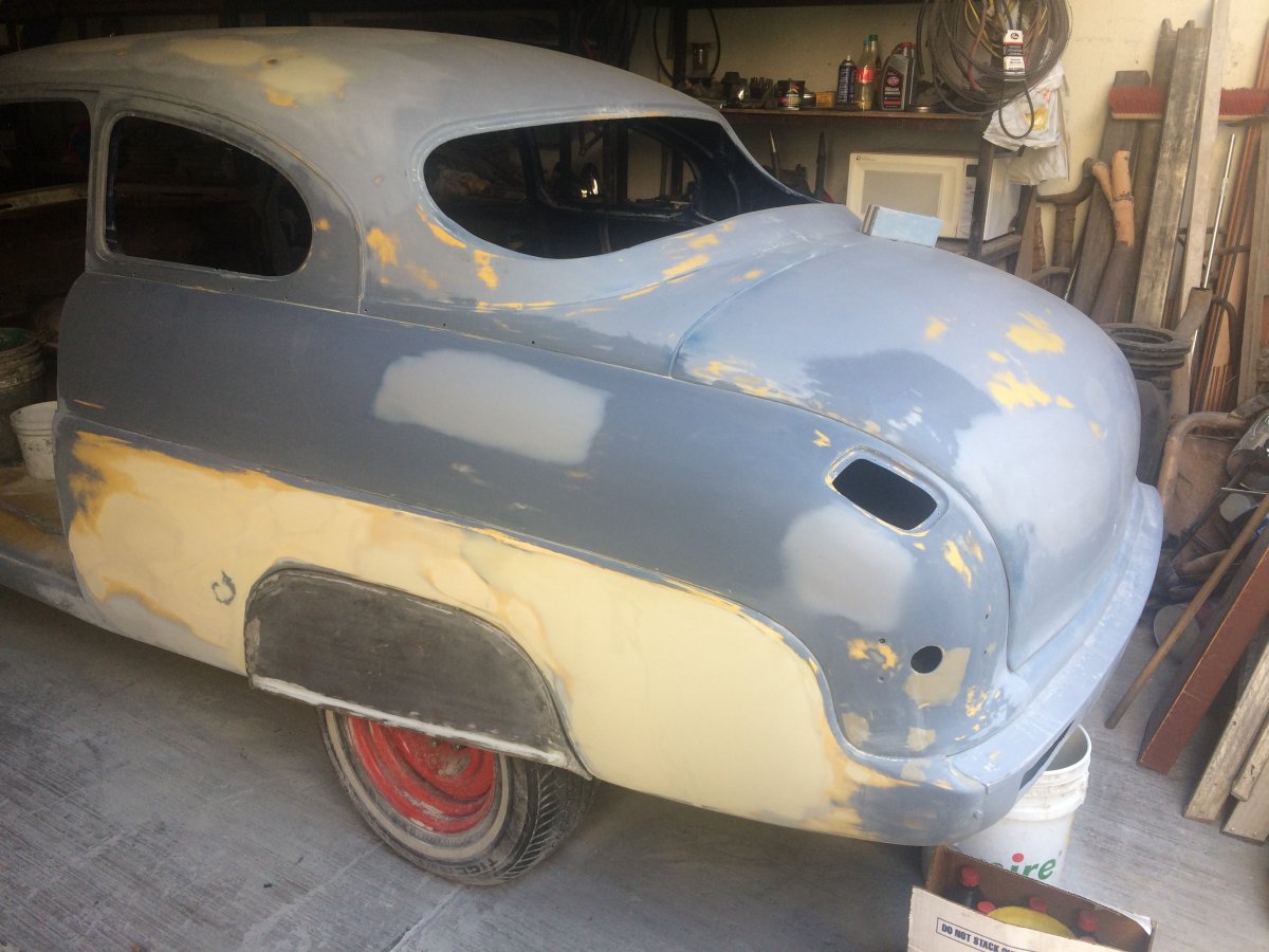

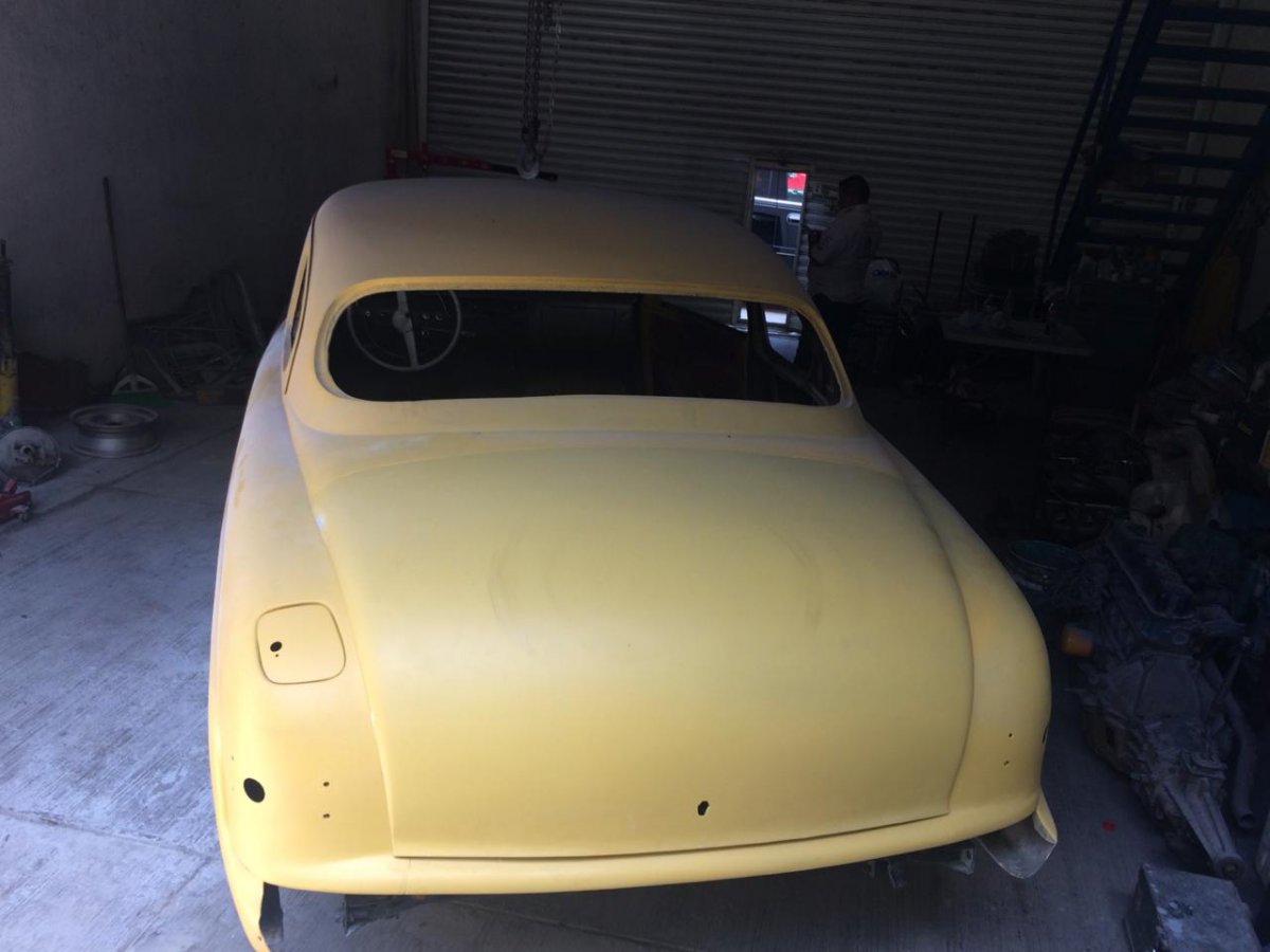

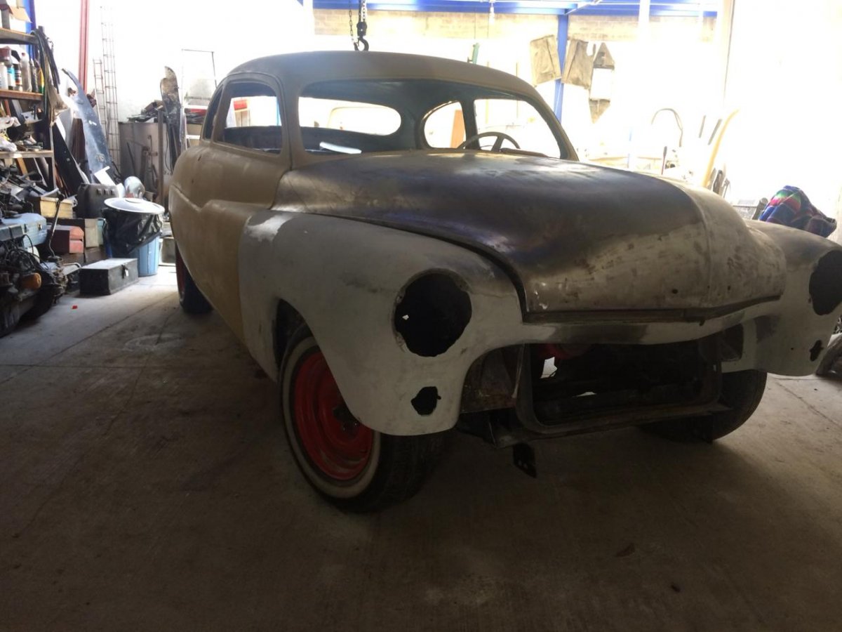

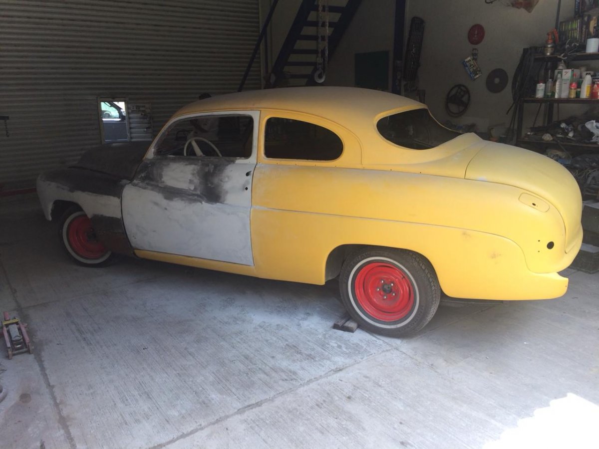

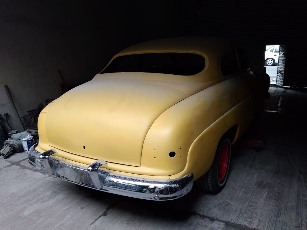

    More body restoration
    71a0be25-363e-4d12-8a67-5eb2c8488766.jpg 257b0dea-acf2-41cd-8733-2b8c04f8e228.jpg ab9aab29-6f3c-4d2f-876d-46ac669ee47a.jpg 8d708d0b-e254-4ffd-986b-7d238ec9241c.jpg 374940b0-03d3-4486-b68d-da3718fc88c7.jpg 9d469a9d-6443-4295-878f-15eaaa231a30.jpg b9ff9d7d-6963-484c-b68d-f46a01e2283d.jpg 03bb709c-5f87-445b-bd60-e0d063dc3af5.jpg 17c3f70d-1d8c-4d85-a1c7-0bd116528624 - copia.jpg 65069889-34c2-45e6-9a29-3f5d6f47a818 - copia.jpg a3e2a146-50f6-43d7-99c5-a69e7c77c3a0 - copia.jpg ac7911b2-1555-41db-ba15-1c67e60315f2 - copia.jpg

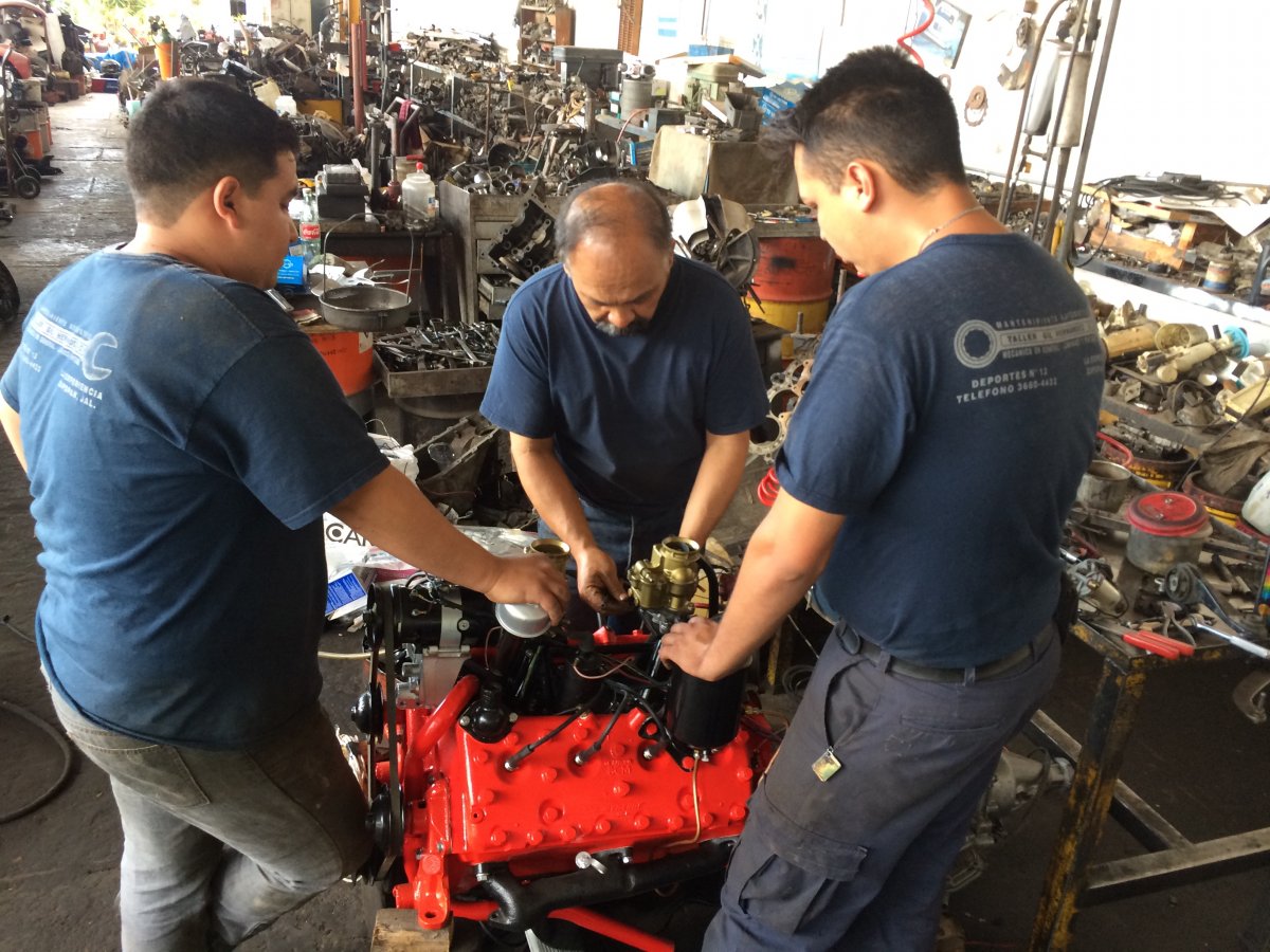

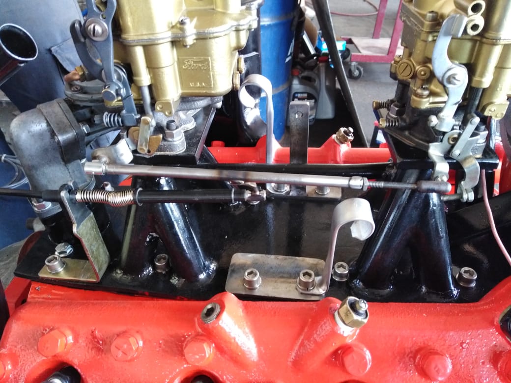

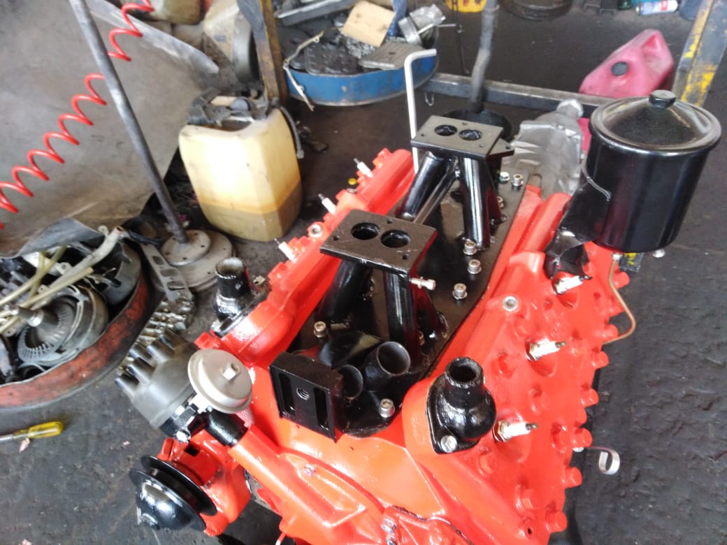

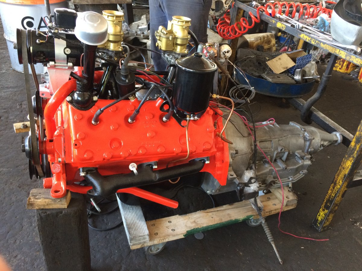

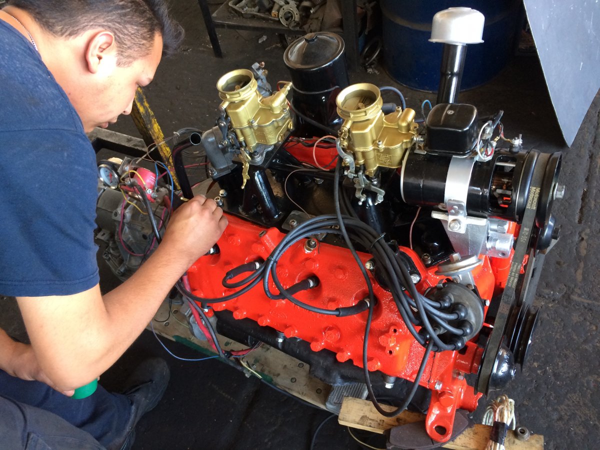

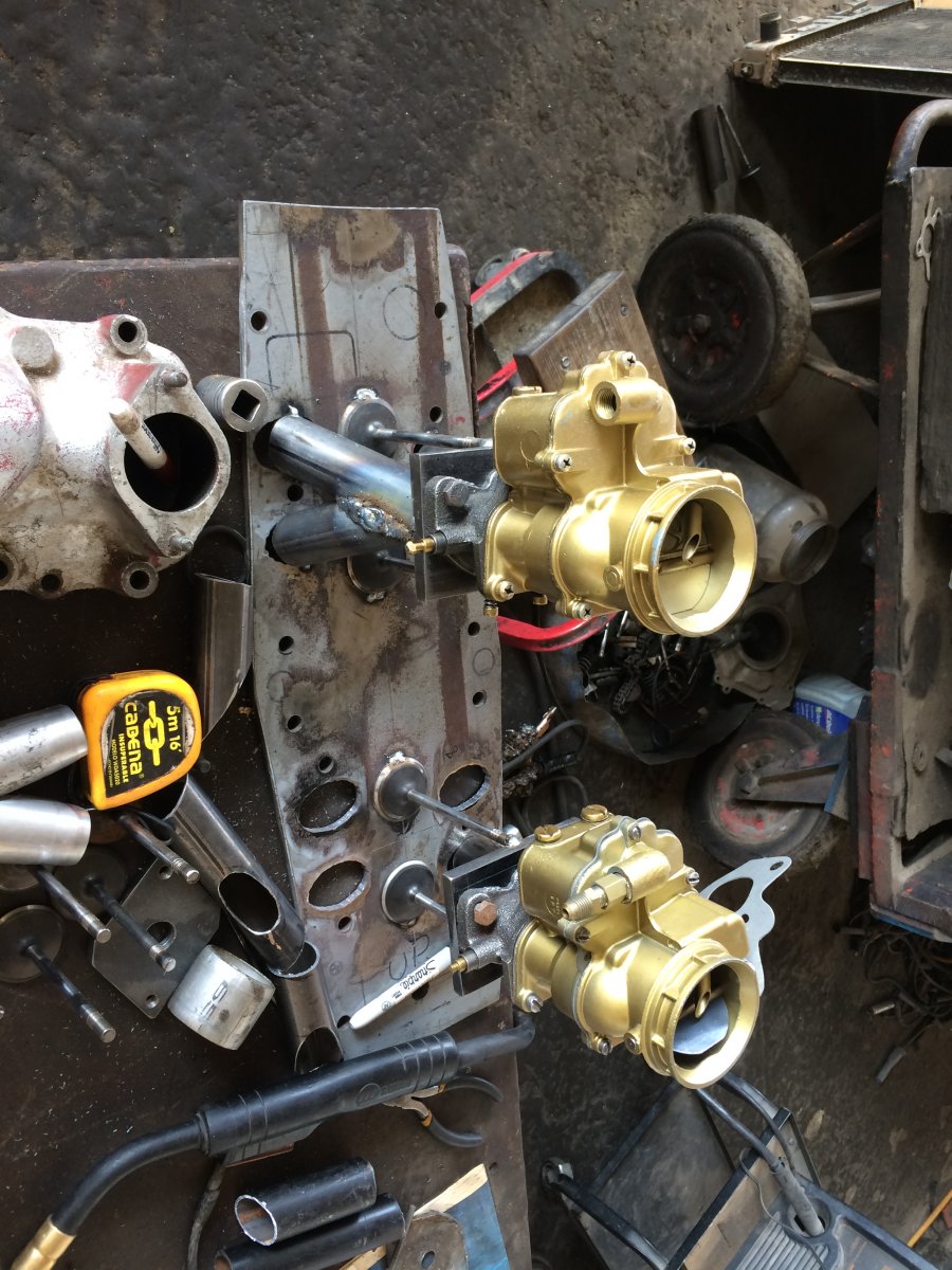

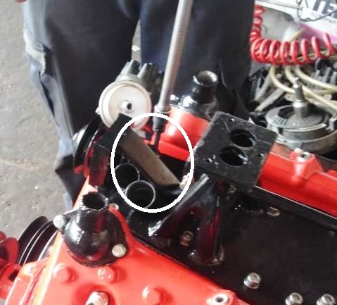

    With pleasure, I share more pics of the custom manifold¡

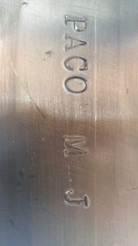

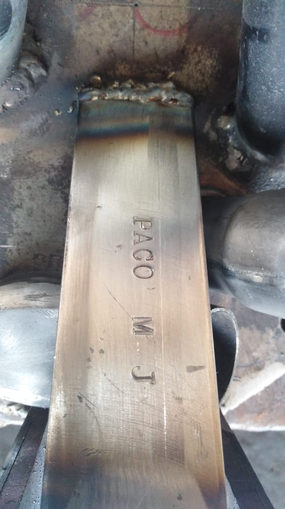

    Did you notice this personalized detail that makes it unique?
    397cf535-784a-49af-ad69-273a1db183ca.jpg fee64020-1774-47eb-b36b-1aa82c58598c.jpg Paco MJ.jpg

    Very impressive engine and intake, Pacorro! I was unable to listen to the engine, though. When I click on the links (I tried them all), Vimeo sends to me this message......
    "Sorry, we couldn’t find that page
    Make sure you’ve typed the URL correctly, or try searching Vimeo. You could also watch one of the videos below instead."
    Do you have another link? I would love to hear your engine with your dual carburettors.
    Thoughts......
    Beautiful job on the engine and intake! Very well thought out design and high quality workmanship throughout. I am sure you are very happy with her!
    Fuel pressure...... Your carburettors look to be the Holley 94? Holley 94 and Stromberg 97 are similar to Weber carburettors in that they need between 3.0 and 3.5 PSI fuel pressure. New needle valves will often hold 4.5 PSI until they are older and will begin leaking by later.
    The Ford flathead mechanical fuel pumps would typically make between 4 and 5 PSI. The old way of adjusting fuel pressure on those engines involved stacking several gaskets under the mechanical fuel pump to act as a spacer. In this way, fuel pressure could be adjusted to 3.5 PSI. An adjustable fuel pressure regulator can also be used for this.
    A caution...... Correct adjustment of the float level in fuel bowl is very important. I am not sure what formulation of gasoline you have in Mexico at present. Except for when our ship anchored off the coast of Mexico and we went ashore by boat at Mazatlan and Acapulco in the 1970's...... My last visit whilst driving was in Feb. of 1968. My wife and I were married in a small town about 75 miles South of Laredo. I was home from military service but even so, we were not old enough to marry here without parents signing for us. I was 20 and my wife was 17. So we drove down to Mexico and were married there in a place called Vallecillo in Nuevo Leon. It was a very small town in those days.
    Here in Texas near the large cities, we are forced to use ethanol and the gasoline now of days is a lighter, more volatile formulation than in the old days. So typically, we must lower float level between 1mm and 2mm and with ethanol and increase jet size by 5 steps (say from 40 to 45 for instance).
    The old way of setting float level on the flathead motors involved pulling the top cover off the carburettor and adjusting float level with carburettor on the engine. As you may imagine, with dual carburettors and your front carburettor so close to the generator, all it would take is one spark from the generator to ignite fuel or fuel vapours. So I would recommend setting float level with carburettors off the car. Or at least with engine cold and not running. Much safer that way.
    Not having the specifications of your engine, but noting that you have a large, heavy car and an automatic transmission, I will assume that the engine was left mostly stock internally with possibly a modest increase in compression ratio and corresponding mild camshaft upgrade. That being the case, with dual 94 carbs you might consider size 50 jets and 4.5 power valves as your starting point. I believe the modern Holley power valves will fit the 94 carbs, but they have a wider sealing surface where they screw in and the seating/sealing surface must be modified a bit. Charlie Price at Vintage Speed used to have these available for the Holley 94 as well as jets if you need them. If he hasn't retired yet, you can contact him here.....
    http://vintagespeed.com/
    I always used Strombergs in multiple carburettor setups on these engines because they had a mechanical enrichening device instead of a vacuum actuated power valve and it was much easier to tune them (when you run multiple carbs on a plenum style manifold, manifold vacuum and carb 'signal' are usually less and that affects the power valves unless you measure manifold vacuum and change them for valves that work with lower vacuum level). The unknown factor with your intake is that the excellent design should minimize carb 'signal' loss, so you may have much better carb 'signal' than other manifolds having a larger, common plenum fed by both carburettors. A definite advantage for you.
    One suggestion...... The old oil filled ignition coils use the oil to cool the internal windings. It is safer to mount them with the top (where coil wire plugs in) upright. This prevents the oil from partially uncovering the windings, overheating and eventually ruining the coil. It doesn't always happen. Sometimes you can be lucky and they will work well for many years laying on their side. But its safer to mount them upright if you can.
    Hope this helps,
    Harry

    Harry and friends who follow this thread, I did tests with a whip and it seems to work. Please verify
    chryslerfan55 and hammer-time like this.
  29. enigma57
    Joined: Apr 12, 2007
    Posts: 246
    enigma57
    :D The new links work very well, Pacorro! Thank you!
    Engine sounds strong. Solid and smooth running.
    A bit of standoff vapour or reversion from front carburettor, but that should resolve as piston rings and valves seat during run in period and carburettors are fine tuned.
    Double check ignition timing, as well. With dual carburettors on the type manifold you have there, your engine will need a bit more initial advance than if it had a single carburettor or if your dual carburettors were feeding a single, large plenum. Try 12 degrees advance and work from there. Be sure to limit total advance so you won't have too much when distributor reaches full advance, though.
    Congratulations are in order for all who have worked on this engine. Well done!
