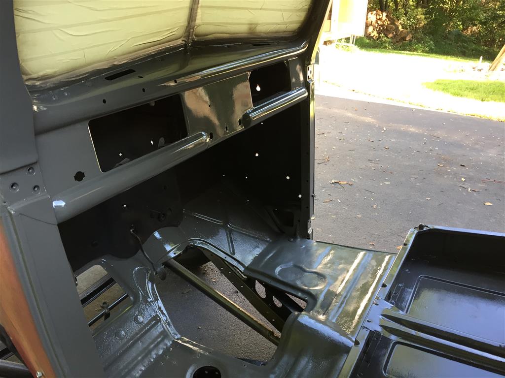

    the-rodster

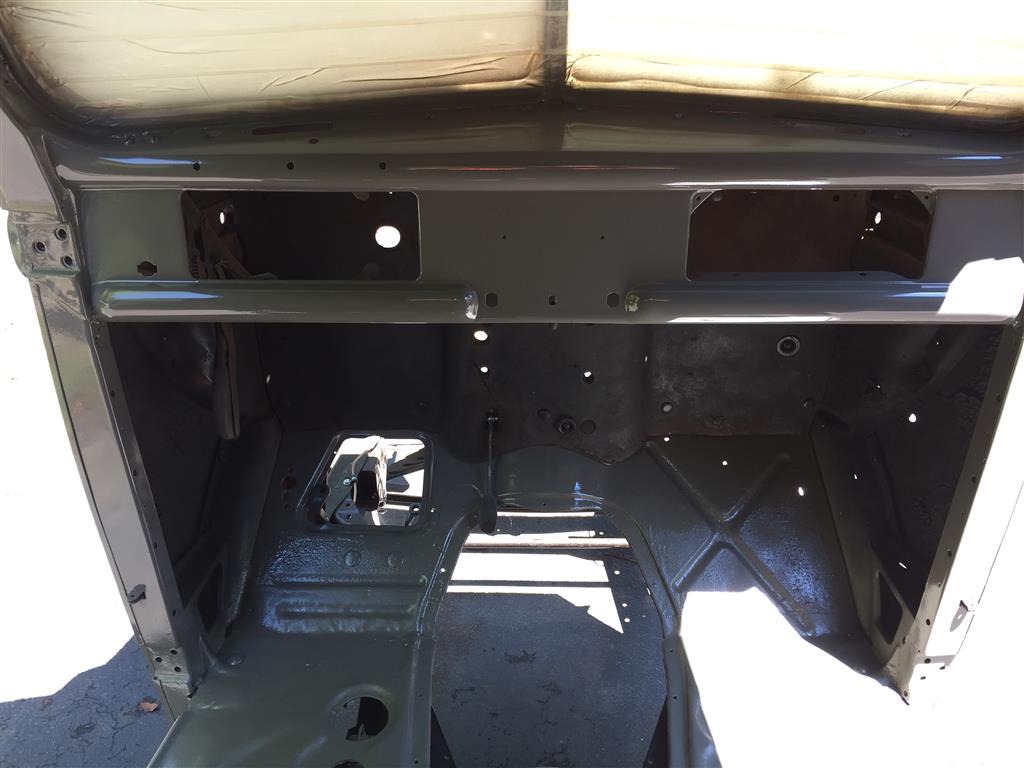

    The cab is mounted and I painted the innards this weekend.....

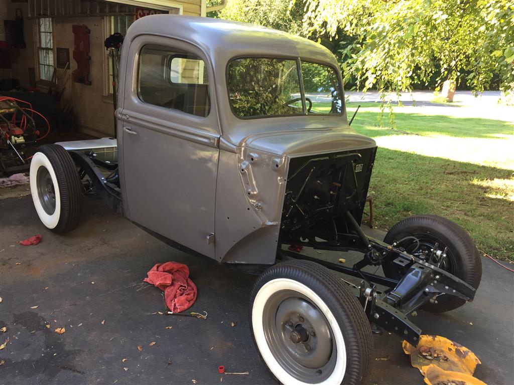

    The truck will get the same massey ferguson gray paint job that the RPU has..

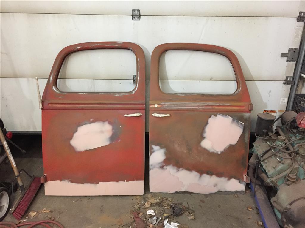

    Doors getting some work, there is no rust, but the bottom flanges were a little bent up.

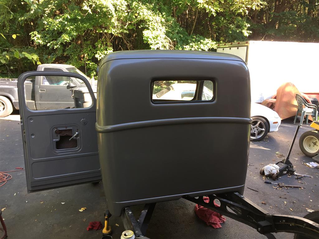

    Doors painted, hung, adjusted.
    Window regulators and all glass installed.

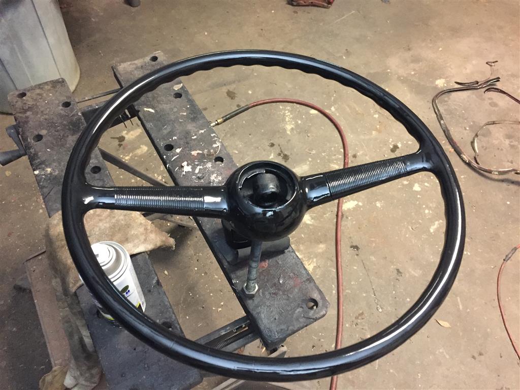

    Steering wheel and heater installed.

    Rear glass installed.
    robber grin and PONTNAK123 like this.
