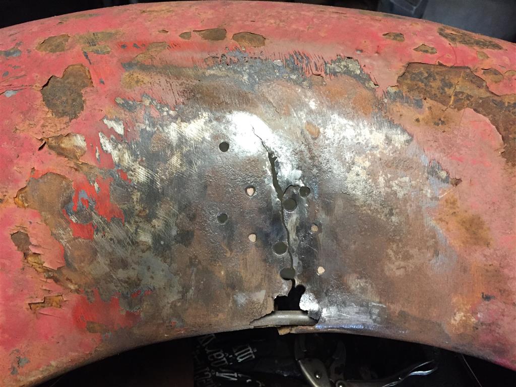

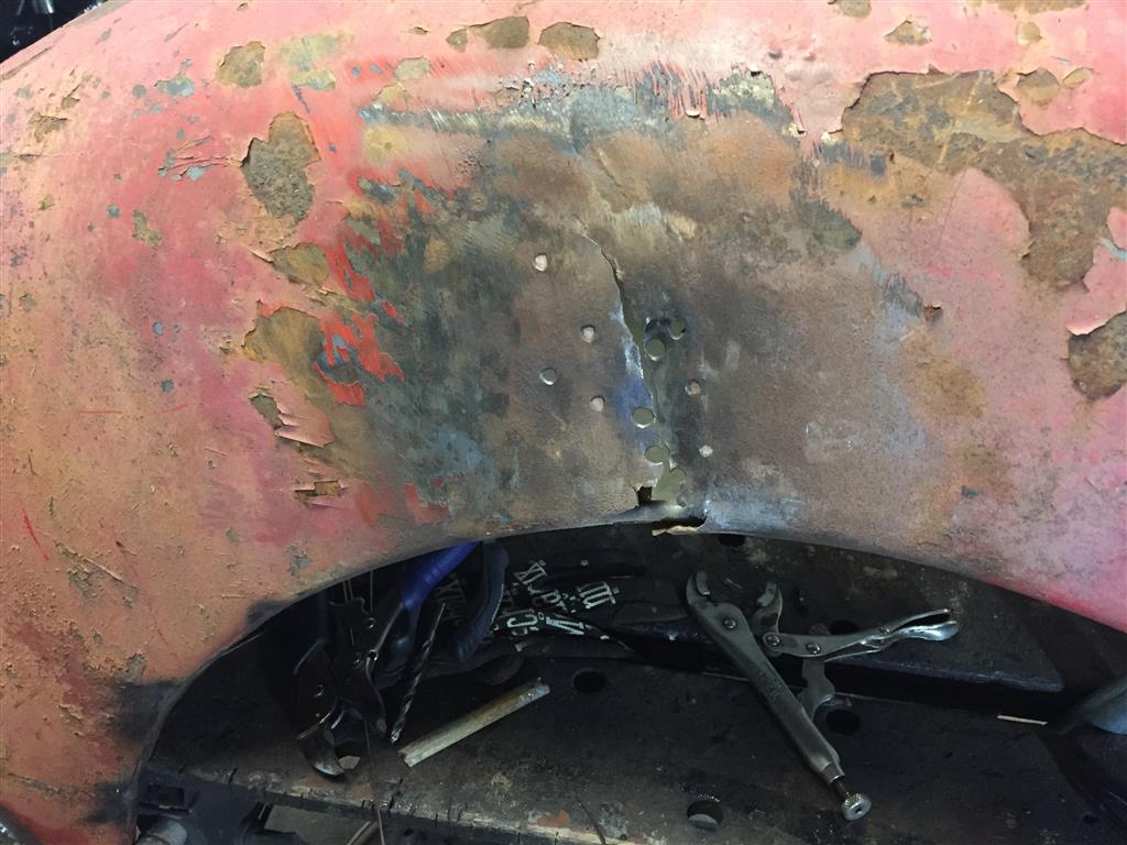

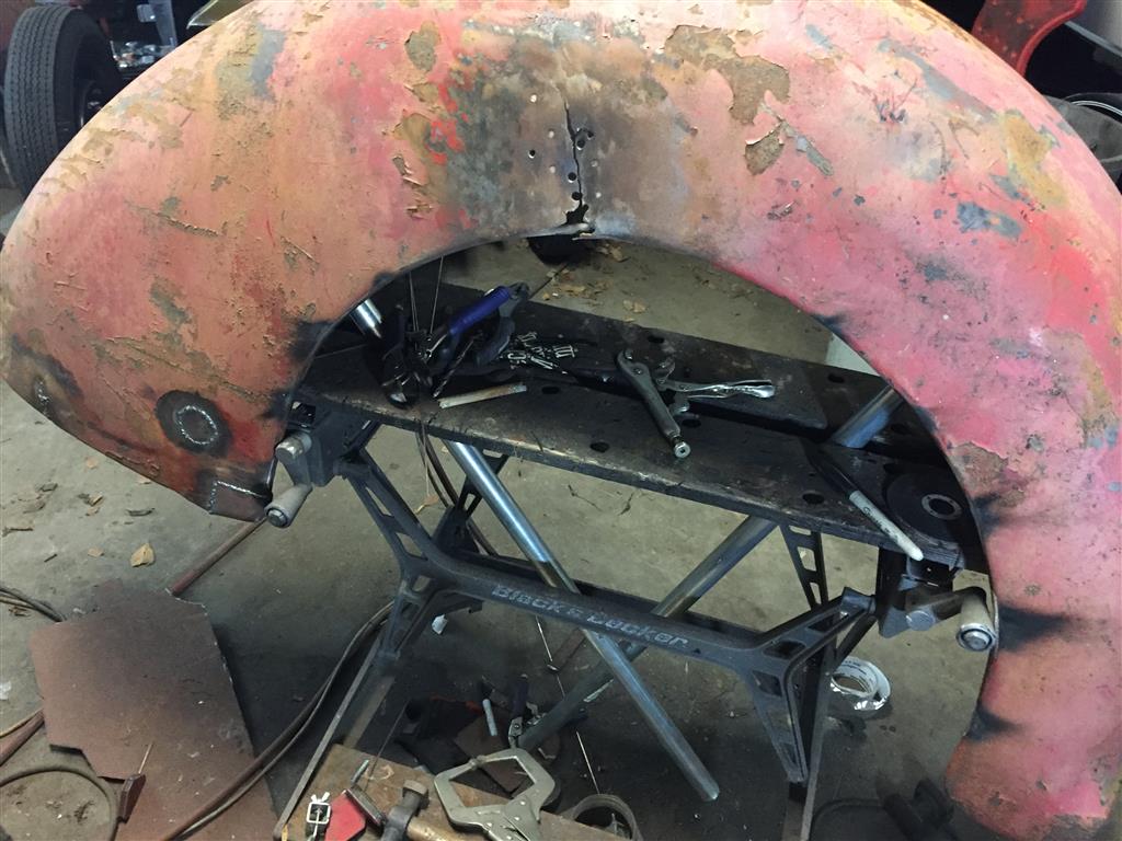

    I wasn't looking forward to working on the rear fenders.
    They are ROUGH.
    But, I am determined to fix them.
    Driver side..
    P***enger side...
  7. the-rodster
    Joined: Jul 2, 2003
    Posts: 6,960
    the-rodster

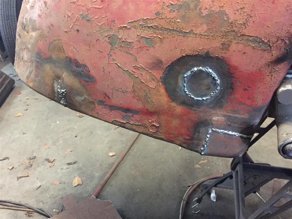

    Starting work on the driver side...
    70.jpg 71.jpg 75.jpg 77.jpg 78.jpg 79.jpg 80.jpg 81.jpg 82.jpg 83.jpg 84.jpg 114.jpg

  9. joel
    Joined: Oct 10, 2009
    Posts: 2,742
    joel
    Looks like your getting them fixed. After a little grinding and some blasting, you can bolt them on and straighten them out. Good job.

    Nice work. Going to run a spare with the fender dimple or no?
  11. the-rodster
    Joined: Jul 2, 2003
    Posts: 6,960
    the-rodster
    That's the plan, hammer/dolly, maybe some shrinking disc.

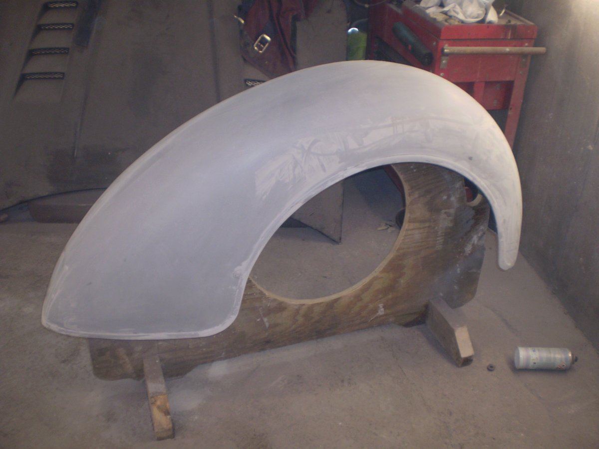

    looking good I recommend a stand to hold the shape while you work on them fenders in primer 002.JPG my fenders were rough before we started on them getting hard to tell now.

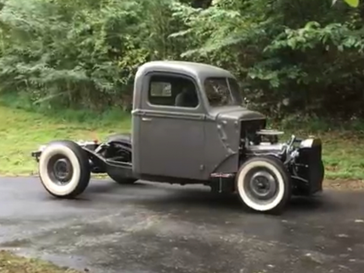

    delighted with how mine turned out persevere fenders home in blackrear 003.JPG took a few weeks start to finish

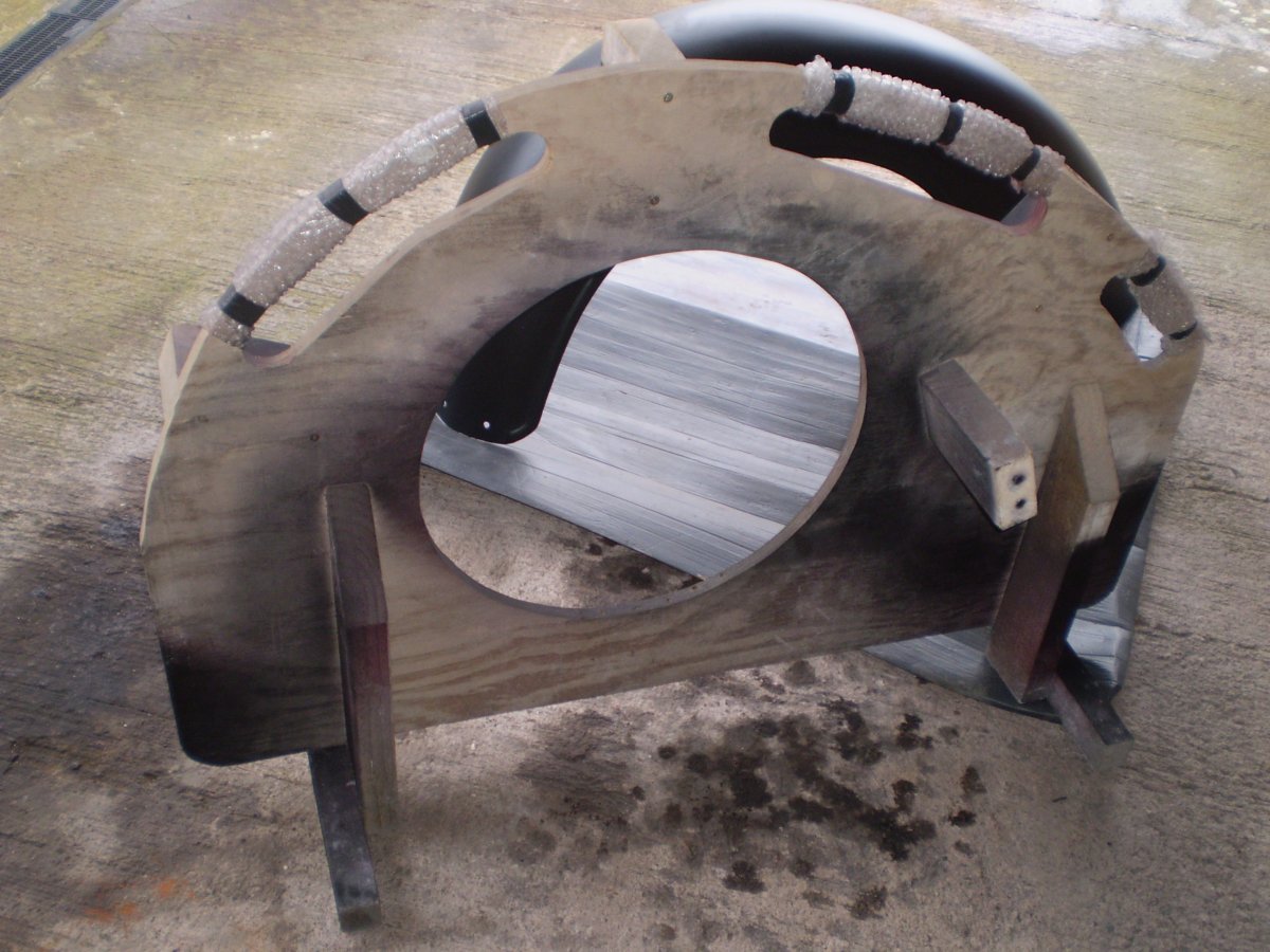

    I would like to see a pic of your fender jig you have there
  16. nunattax
    Joined: Jan 10, 2011
    Posts: 3,390
    nunattax
    you got it,3/4 ply and 4x2.large hole to get the dolly through fender stands bare 002.JPG fender stands bare 003.JPG
    mounted them with wood screws and body washers.all repairs were done on the stands,welding filling,sanding etc.made them a comfortable height to work on sitting on a stool but put the stand on a table as well.

    Very simple, cheap and handy. Consider it stolen. Thanks!

    glad to help.keep the 3/4 ply centre in the width of the fender so it will be balanced when you work on it and move it about.you will need two a left and a right .good luck
