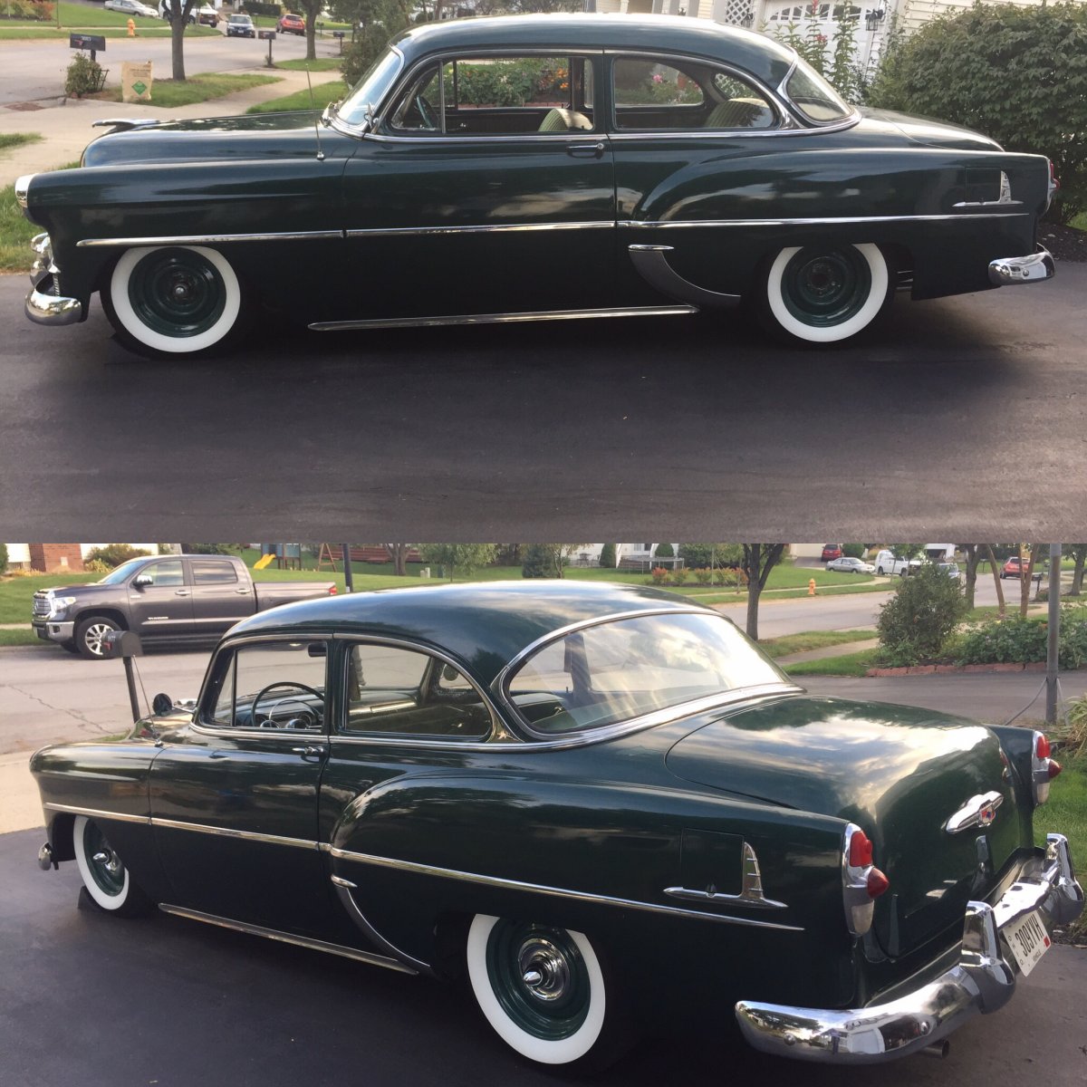

  19. 50blackbird
    Joined: Apr 7, 2013
    Posts: 12
    50blackbird
    As it sits today.

  20. Very nice car, keep us posted!
    50blackbird likes this.
