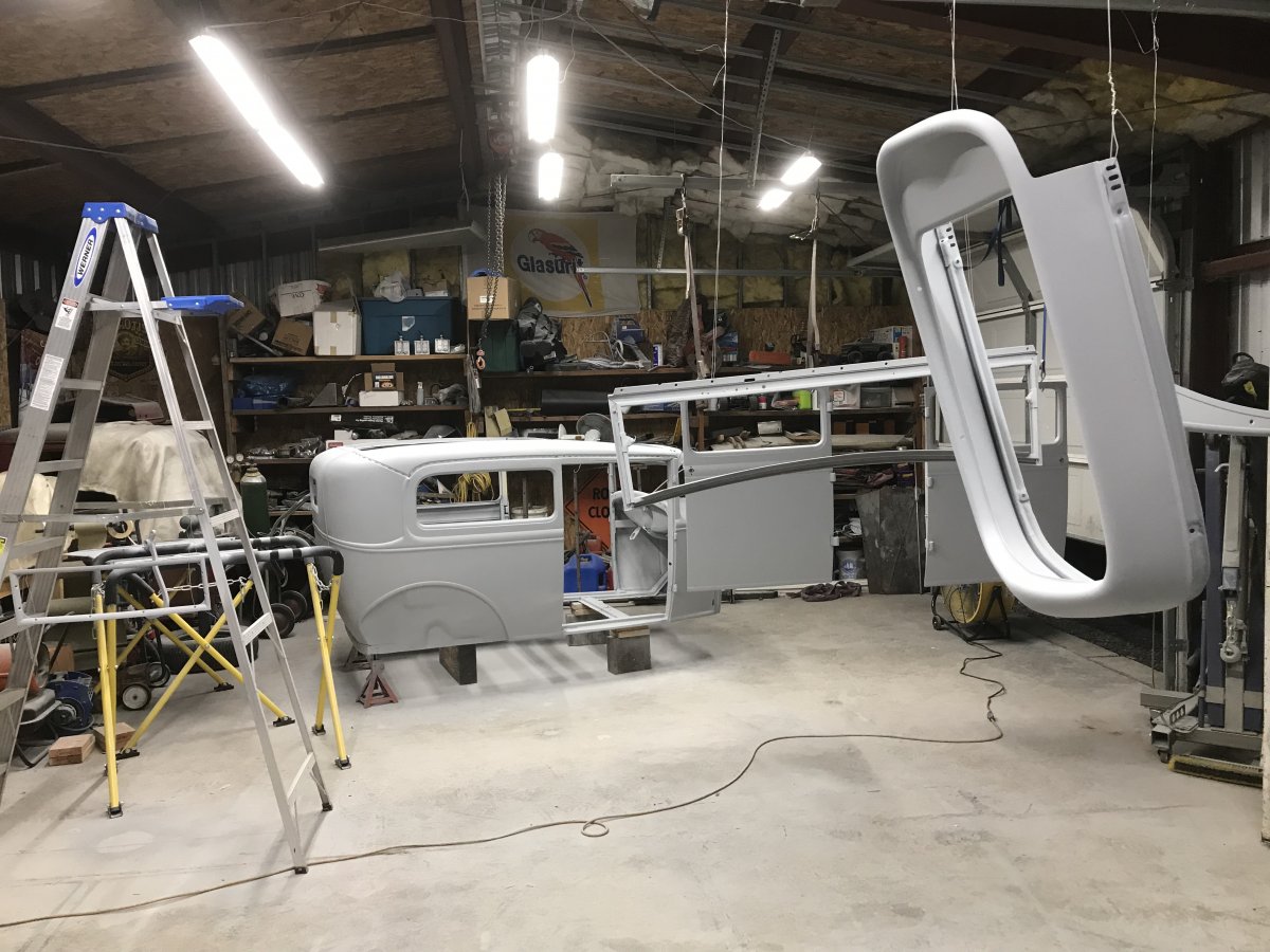

    Looking good. Your saw horses are making me nervous though

    Ditto on the saw horses. They look scared to me, have had them collapse while doing wood work.

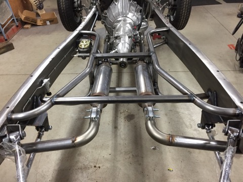

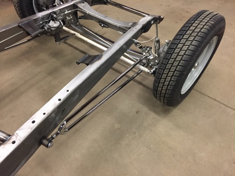

    Like the write up, keep it coming! One question (as I'm no expert)...... why the front and rear panhard bars on opposite sides? Heard years ago it's best on the same side.
  5. Thanks, while on horses if you look close you'll see I still have chain fall hooked up . Too much work to risk a fall.
    bigheadbaxter likes this.
  6. Hmmmm , I'm obviously no expert either . No reason , Hope it works out ok . Where were you with that question a year ago ?

    Only found the thread yesterday! I think the reasoning is if they're both on the same side, the arcs through the suspension travel will move the axles the same direction. If they're opposite, the front may move to the left and the rear to the right "turning" the car. Hopefully the more knowledgeable can set me straight.
  8. Got home from work , ran out to barn to check other car (27 t touring with A frame ) it also has driver side front panhard and p***enger rear panhard and that thing handles like a dream ! May matter if a guy has more than the 3/4-1" travel that I have. Think I'll be ok . Thanks for the good input, I'll do same side on next one .

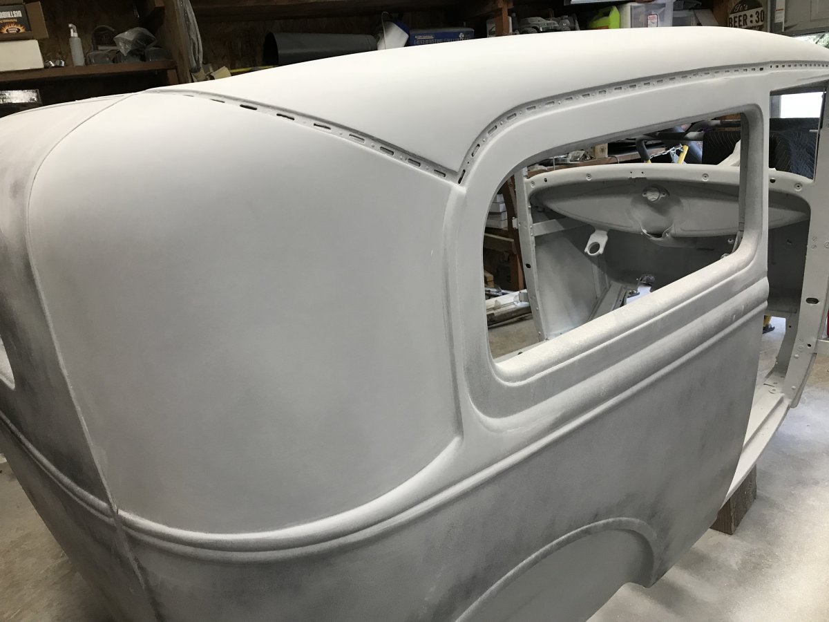

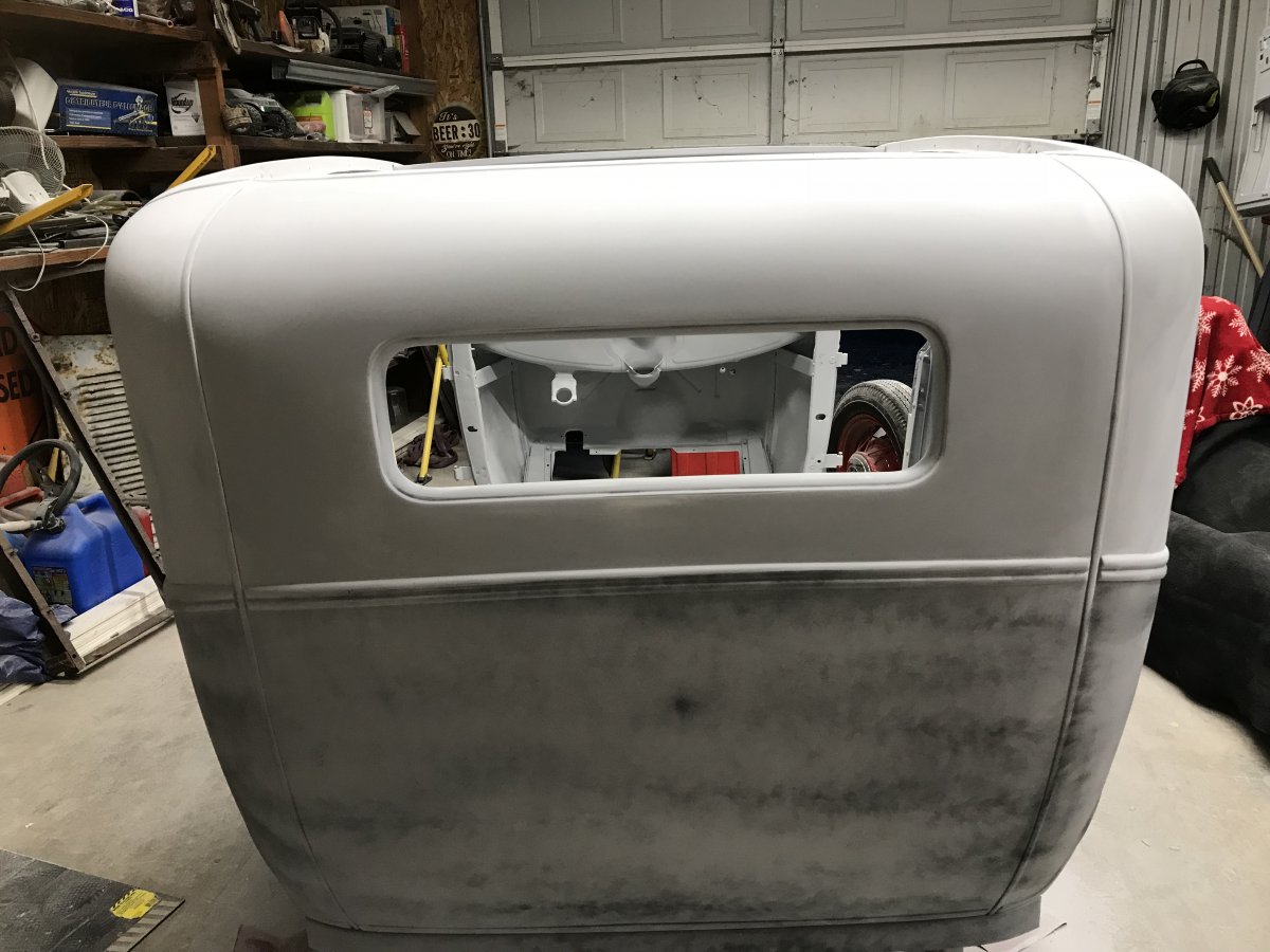

    Well,finally got off my *** and the thing is all primed and ready to block then paint. I think it turned out looking pretty good! Just took way longer then it ever should have.
    bigheadbaxter and embyman68 like this.

  14. Getting ready for Spring! Seeing you get to this stage is helping me get inspired and motivated as well. :)
    Dustan likes this.

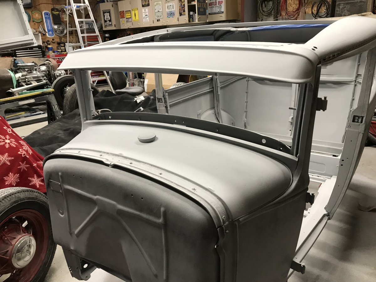

  16. In primer, shouldn’t be long till it’s painted & sitting in place [​IMG][​IMG]

    More block sanding...Of co**** block sanding cannot be done without proper lubricant
    Jet96 and wackdaddy like this.

    Haha yeah I retired it for the night after that last one. It does feel pretty damn good though. A few minor spots to touch up then it will be wet sanded. Looking forward to getting that done and shooting sealer and paint

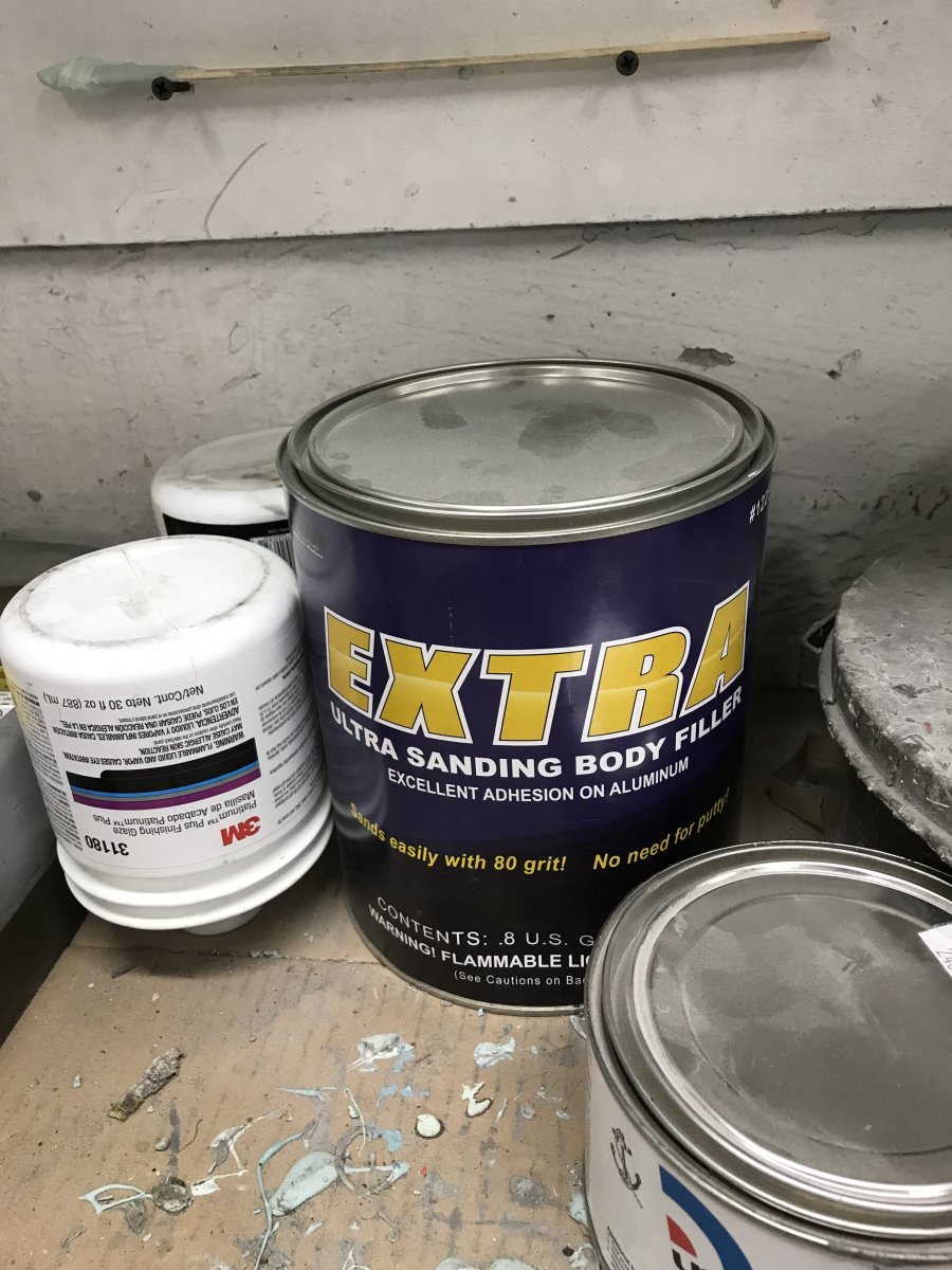

    Just have to get on the mud before it gets hard ;) I really like this filler in the picture and the 3m glaze is great too. This stuff sands pretty damn good. Wish I was stuck at this place less so I could go home and work on the A!

    Both those products work great.
