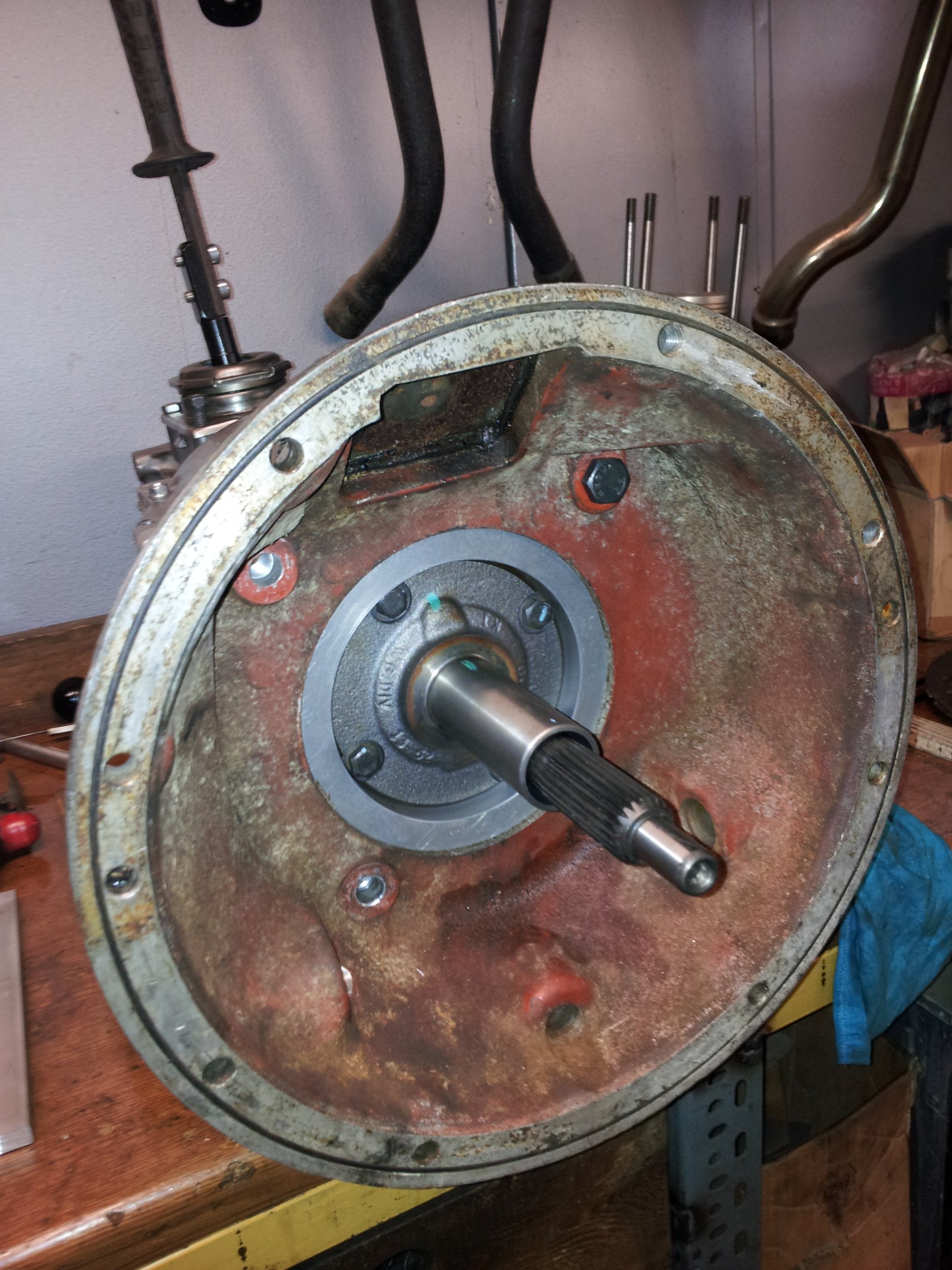

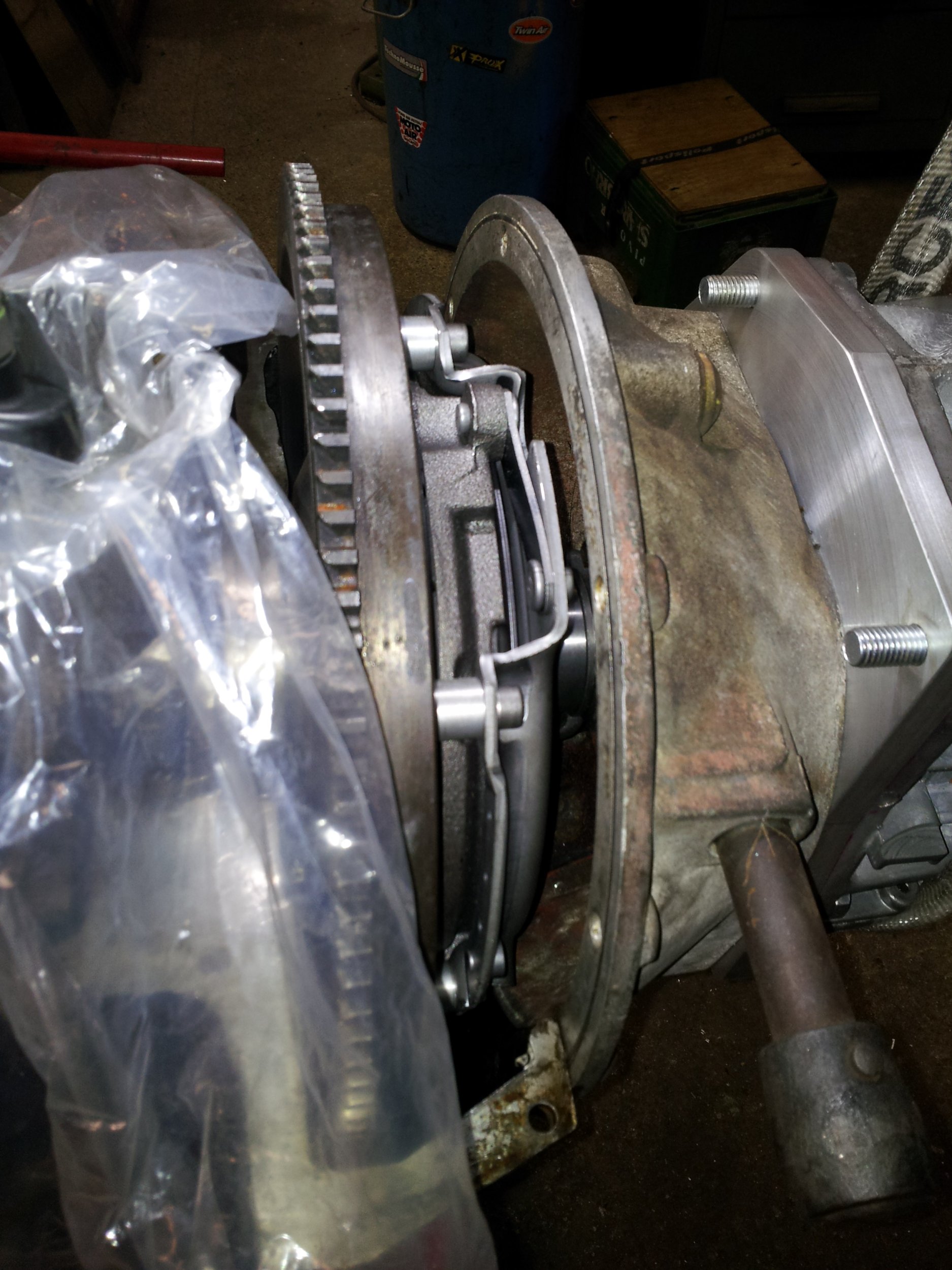

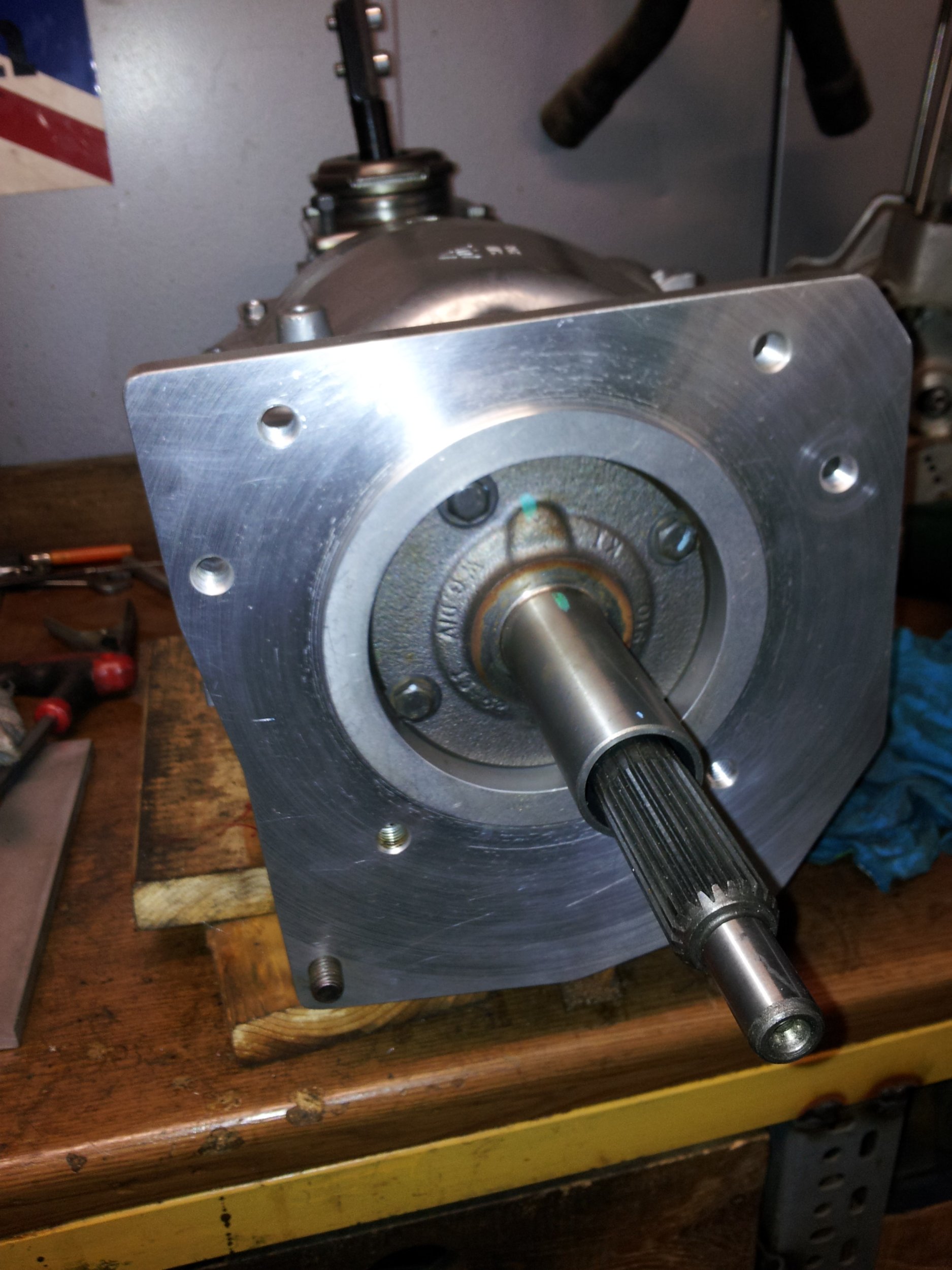

  17. shorrock
    Joined: Oct 23, 2020
    Posts: 189
    shorrock
    I´ll take a couple pics tomorrow and send your way. I made just a plate between SYbox and french clutch bellhousing. Put an S10 chevy rear housing on the box for relocating the shifter and made a bronze bush for the output yoke. The splines are different on the in- and output shafts so I used a SY clutch and a Nissan RX yoke as it has the same splines for the now open driveshaft . Rear axle is a Chevy with 3,03 ratio. Have to look for the box gearing, could be found on the net as well. OD is 0,82 if I recall correctly. When I added a blower the SY clutch at 9,5" could not hold above 3500 so I converted the french 11" clutch to the SY splines.

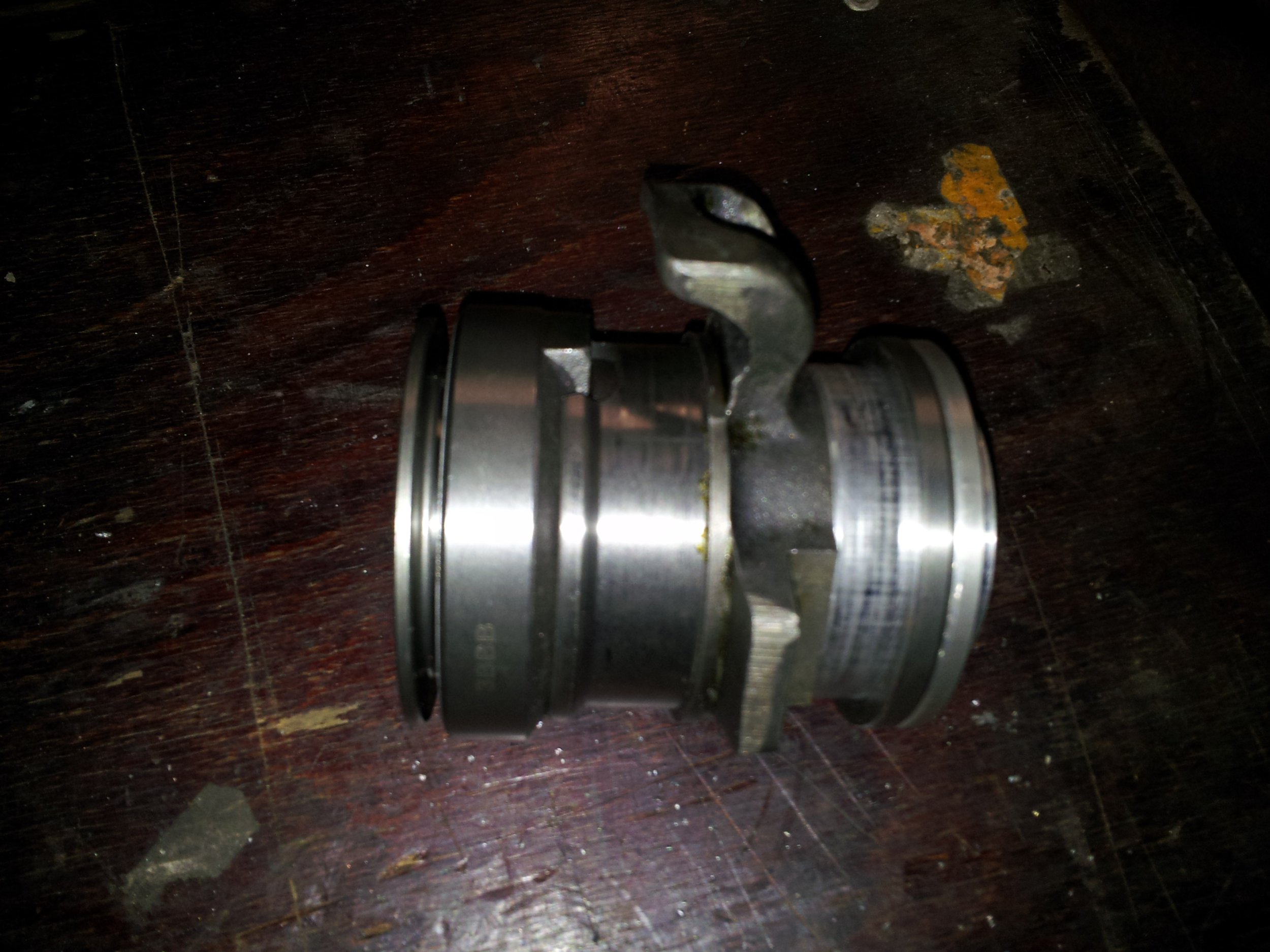

  18. shorrock
    Posts: 189
    shorrock
    PM did not work:
    Here are pics of the SY gearbox. The french bellhousing is aluminium, tranny end housing is Chevy.
  19. shorrock
    Posts: 189
    shorrock
    SY clutch needs a spacer ring with 18mm height to get correct tension on the spring. No problems as the splines on mainshaft are long enough to accomodate. Clutch did hold my normally aspirated flathead, was easy to use and absolutely no chatter. It is used in the 2.9 ltr Diesel engine so can stand some torque. Made a spacer for the SY Throwout bearing and checked function when assembled without oilpan.
