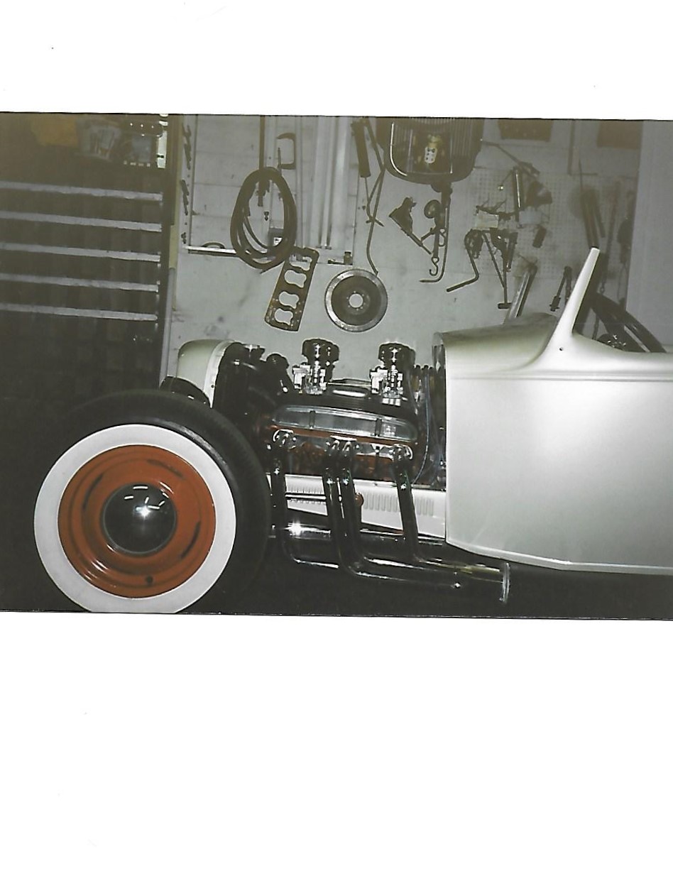

    Model A with Vega box mounted under frame and original side steer...
    Drove like a dream for thousands of miles.
    My '34 Ford pickup had a '56 Ford PU steering box and drove OK...
    But when it goes back together it will have a Vega box also.
