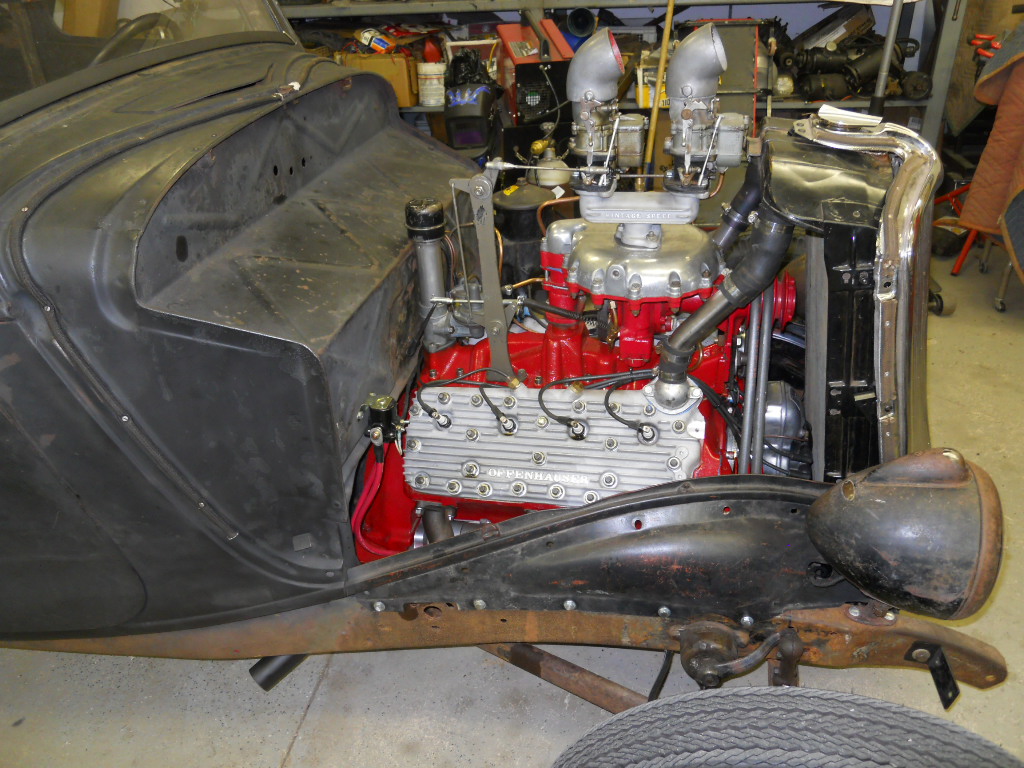

  23. Fordgasser1
    Joined: Jan 20, 2009
    Posts: 1,333
    Fordgasser1
    from Jersey
    here's a few shots of my 8ba motor in my 33 coupe..Stock rad and grille,stock firewall..I used a 59ab style cam,front cover and distributor..The McCulloch supercharger top pulley is longer than a stock generator otherwise it would have room for stock 33- 34 fan.Also,the rad is in the original location and the hood fits.

  24. I wanna see the hood on it.
    In that picture, That radiator doesn't look like its leaning back near enough and it looks like the top tank comes thru the line of the hood. Bottom may be in correct factory location but it appears to be parallel with the cowl wings and nearly vertical. It should be parallel with the line of the hood seal at the cowl. The radiator should lean back about 3" from plumb. That's why the top tank is not square.

  25. millersgarage
    Joined: Jun 23, 2009
    Posts: 2,322
    millersgarage
    If only it was that simple......
    cam and lifter change to 59AB style, oh ya, can't use my fuel pump either, new timing cover, so there goes the distributer, need a clam style one, new crank pulley, then new water pumps. Can't run the alternator/generator in the stock location, need to drop it off to one side, so now I can't run a fan, or maybe just change the intake to a single carb........
    If all it took was a water pump change, we wouldn't be talking.

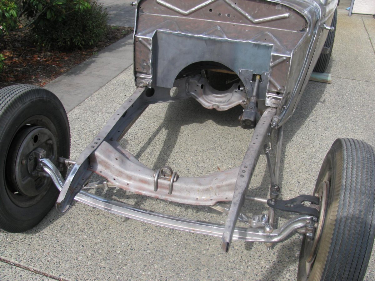

  26. Before you start hacking things up take a look at what I did to my 34.
    A little while back I messaged the firewall to fit my Caddy motor. But yet I didn't want to cut the firewall to make it obvious, wanted to retain the factory look of the stock firewall. So here is what I did, I apologize I did noi take pictures during this process so I will try to explain. I separated the spot welds that held the firewall to the cowl sides. Scribed vertical lines from the cowl side to the top of the firewall on the tray portion to the crotch where it makes the bend to the vertical. Now I scribe a line in the crotch connecting the previous lines. Cut along those lines and separated the firewall from the cowl. Now measure from the top cut down 1" or so; and remove that material. Save the strip that was just removed. Cut it in half and attach to the vertical sides where the cowl side spot welds were removed, extending the legs. You have just recessed the cowl about 1 inch return the firewall back to the cowl. Here are some after the fact pictures, hope you can understand what I did. Here is a shot, this firewall has been recessed about 1 1/4". following pictures show details of how to do.
    hipster and akoutlaw like this.
  27. here is a couple pics of the motor in place
    BradinNC, TERPU, thirtytwo and 5 others like this.

  29. you could always do this
    this is what it looked like when I got the body. I added back the factory fire wall and the did the work above.
