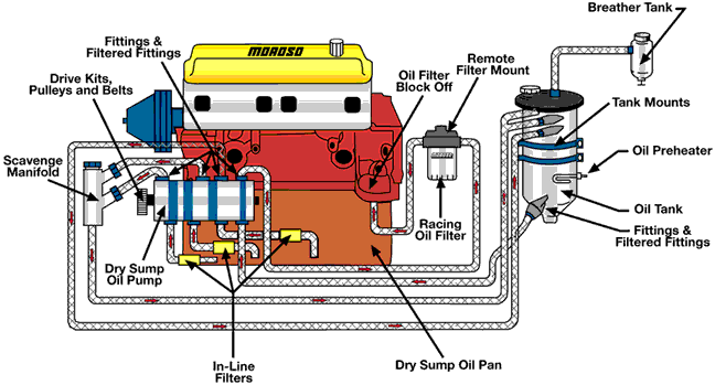

  19. iagsxr
    Joined: Aug 26, 2008
    Posts: 282
    iagsxr
    Barnes 4-stage; one stage pressure, three stages scavenge=massive vacuum
    The engine has to be vented to atmosphere or it will suck main seals in<-IN.
    Then don't forget the tank has to also be vented to atmosphere;

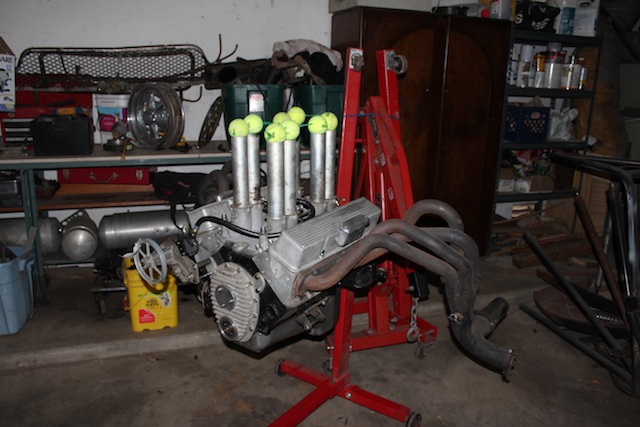

  21. drumyn29
    Joined: Feb 16, 2006
    Posts: 2,251
    drumyn29
    my motor

    What type of CAR are you building this engine for?
    This is the way I am veiwing it
    You are taking this engine and puting it into a dragster/altered to run Nostalgia. The only classes this engine will fit into are ther NE based on index ET's of 7.60-8.60-9.60 (whereas the most common for an Injected is NE-2, 8.60) If that motor can run like it is an 8.50, there is know reason to spend money to go faster. If you plan on running zoomies, there is not enough exhaust signal to open the valve, If there was, you would see the valve on one pipe instead of after the collector as they do. Zoomies are lighter that collector headers thus negating hp gain by the evac system do to weight.If you are not willing to totaly examine your engine combo to utilize the evac and change it then it is a waste of money. I could make 2000HP buying parts out of Summit/Jegs if I listened to all the claims--we all know it isnt true. K&N filters claim 15HP just by useing their filter, and by their dyno, the claim is true @ 6500 rpm, but the rpm one runs it on the street, it does nothing but filter the air.
    Take the engine as you have it now, run the pump off the cam, switch to zoomies, vent the top(middle) of the valve covers to a puke tank--put it into a dragster/altered and go have fun racing it.
  28. drumyn29
    Posts: 2,251
    drumyn29
    It's going in a full blown drag car
