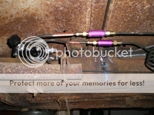

    Finally the weekend. I got on the brakes today we are useing the old master cyl as an actuater for a power brake boster and dual master cyl. This way we still have the old pedals in place with new brakes. I hope this works out I will have to incorporate an offset because the booster will be lower than the old master cyl was. Now lets do some brake line plumbing:rolleyes: old master cyl [​IMG] new piece I made [​IMG] old spring from the orignal master cyl used as a return spring [​IMG] all ***embled and ready to install [​IMG] more later:) now installed and hooked up [​IMG] [​IMG] [​IMG] [​IMG] now PS pump mounted I mounted it low to try and hide it I plan to put a generator over it to help cover it [​IMG] [​IMG] Woo Woo hot rod parts [​IMG] [​IMG]

    Back at it this afternoon got a little done almost done with the rear brakes. Brake line Plumbing is nearing an end. power steering plumbing is done. I had to machine the axle hubs down because they were to big for the holes in the wheels I plan to use. Front sheet metal goes back on tomorrow I hope. Coming right along. Thanks for looking Buddy [​IMG] [​IMG] [​IMG] [​IMG] [​IMG] [​IMG] now that fits like it was made for it [​IMG] [​IMG]
