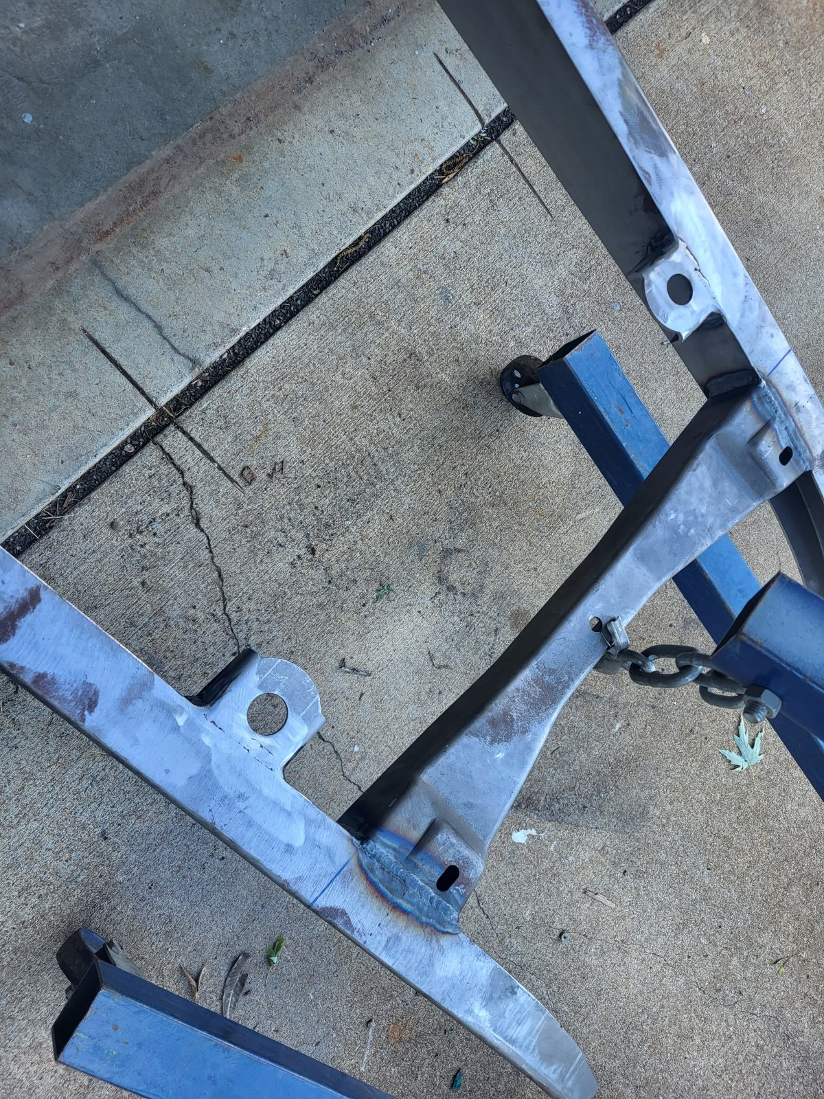

    Well I decided today if we are going to mock this thing up for the party there are a couple of things we need to get solid right quick. Number one are the motor mounts.
    Last night before dark and before we melted into a total puddle of sweat and hot rod adrenaline we put the flat head on the engine hoist and slid it in place. I had to make a quick adjustment to the trans crossmember but got it back in place a bit further back and we had our first good look. I liked it.
    With the body in place we put the radiator on and adjusted the motor forward until we could hook the hoses up. I figure since this entire package came out of a Model A on the same style chassis we had to be close.
    This morning we double checked placement and measured and marked the chassis for the flat head mounts.
    We took a piece of wood, cut it for a tight fit the tapped it into place centered side to side on or chassis marks.
    It was 20" from center of waterpump engine mount to waterpump engine mount. So after the wood was wedged tight we measured the inside of the chassis rails down the middle of the wood: 22.25" So we came in on the wood 1.125" on both sides and marked it.
    We took our mounts that had multiple applications; measured them and cut them to size. I ground a nice angle across the top to take a nice weld. We test fitted them making sure our "x" was in the center, then welded them solid.
    I then did a little clean up across the top and bing...we are ready set a flatty here!

    We also measured, cut down to fit and welded the rear cross member. More on that later.
