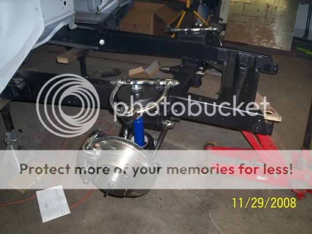

    I went through the same thought, I got a M2 front end from a junkyard, I installed a new aftermarket crossmember in my 53, then bolted on all the M2 stuff from the junkyard, I needed to replace every bushing and ball joint, the rack was cracked ect. ect., with in the first few months I replaced ever part from the junkyard with tubular control arms new bushings, new ball joints , new rack ect.ect.
    I would buy a complete kit and be done with it. After it was all said and done I saved just a few hundred dollars, but it was not worth it.
    Buy a good kit with tubular control arms and disc brakes, if you dont do it now, you will before long.
