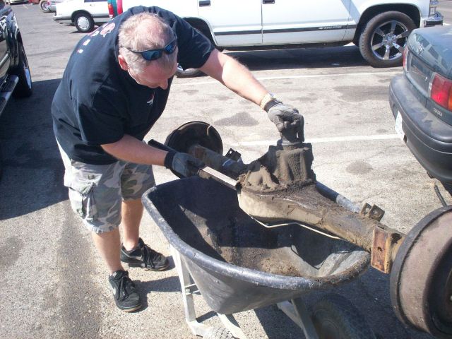

    well, it looks like it's been confirmed I need a rear end that's at least 65" WMS to WMS. I was mocking up with a 55' chevy 10B ( 60" ), so I'm headed to PNP today to find a 65" ford 9... I got a quote from currie yesterday for a new 9"... 2500.00 bones:eek: I can find something and have a locker installed on the cheap.
    More to come
  13. The '73 and up Ford pickup is the right width for you then. It comes in at about a shade over 65". Nice project I enjoy following it.

    we be wide now !!!! 68" WMS to WMS before adapters. might just have the axles re-drilled from 5x5.5 to 5x4.5 to avoid using the adapters and getting out there anymore. Did some more research and it looks like people are using 65-68", So I am pretty comfy with this.
    I've got a line an a 65" I'm going to pick up now. Can never have too many 9"s laying around right ?

    turns out the 9" was junk. third member housing was all busted up inside. Always a gamble with PNP.
    Going to try and hang the front end today

    That's a shame about the 9".
