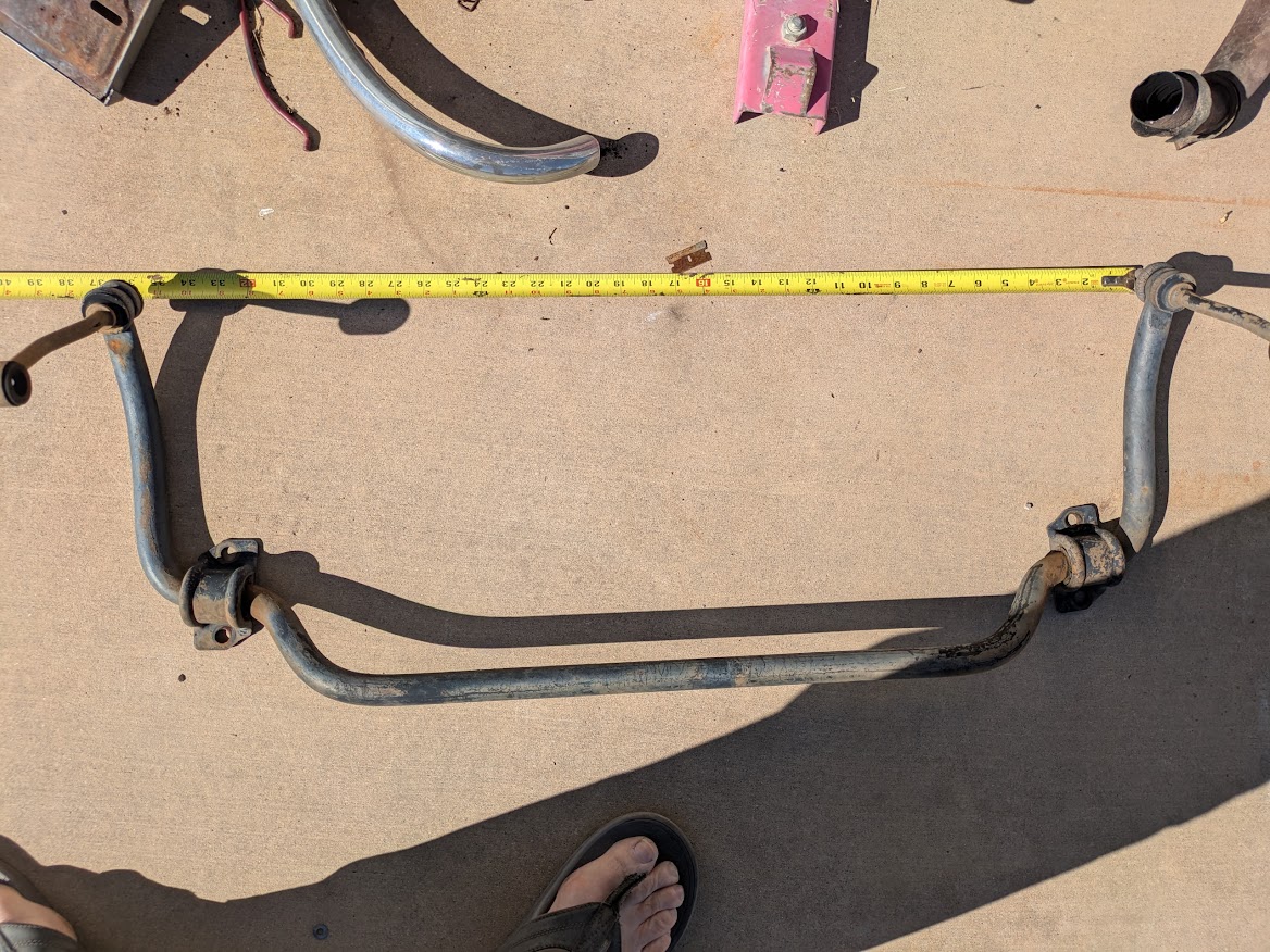

    What diameter is that sway bar? And what is the width eye to eye?

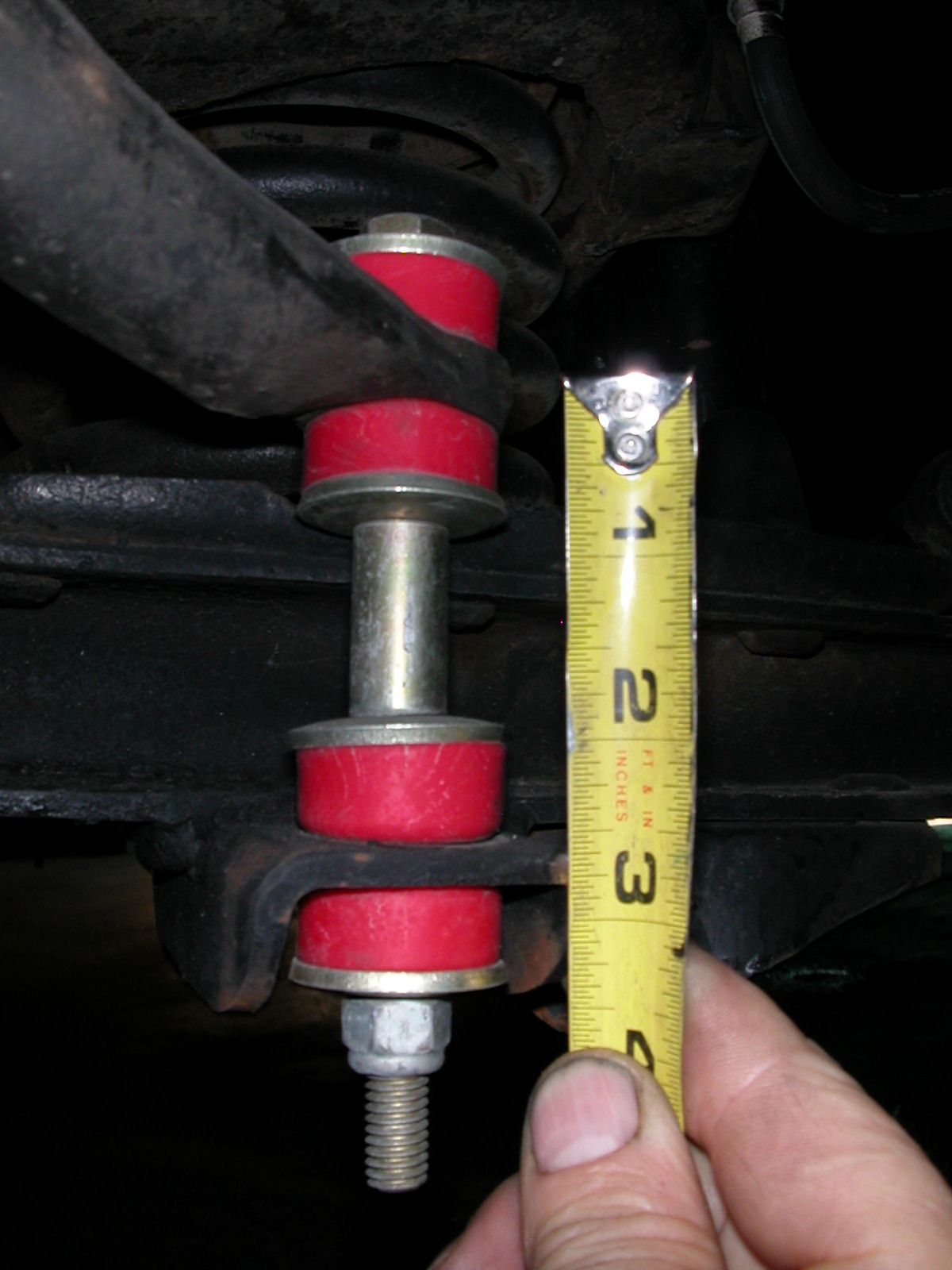

    This sway bar is an inch. I can get you the specs when I get back to work tomorrow I had to step out for the day. The end mounts on the A arm side need to be fabricated. Here is a picture of the ends on another person's car. DSCN3015.JPG 262793_218964304803192_4178916_n.jpg

    I forgot to measure the diameter, but it's about one inch.
    this is off my 95 xj.

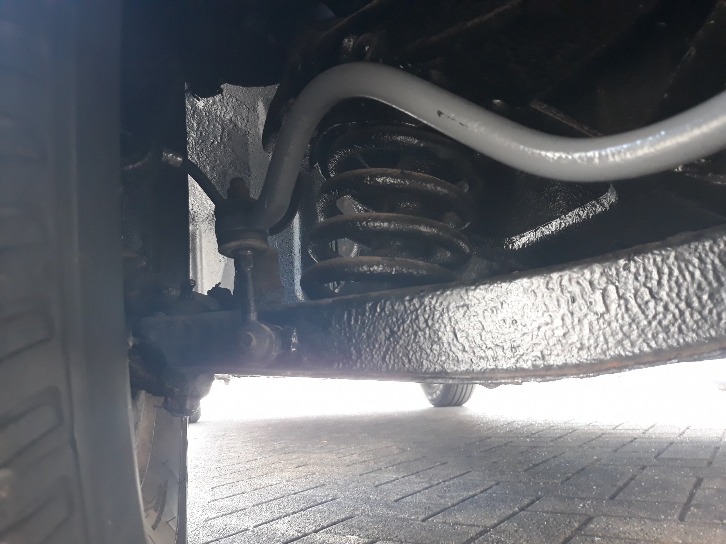

    You can use Nissan Patrol/Sentra/Skyline/ Bluebird end uprights [end-links] on these types of swaybars.
    One end is a balljoint and the other end has conventional bushings .
    This cir***vents the need for a bracket on the A-Arm, just drill a hole and use a washer.
    This is an Aussie Holden K-Mac bar [basically F-Body Camaro] on our 57.
    showing the Nissan uprights [end-links]

  11. Mimilan
    Joined: Jun 13, 2019
    Posts: 1,251
    Mimilan
    U13 Bluebird [mid 90's]
    N16 Sentra [2000-06] try Delphi TC2882
    GU patrol use the same type but a lot taller
    We used U13 Bluebird because the swaybar was lowered on blocks [red] for front X-member clearance[green]
    This is considered a suspension mod in NZ so it required certification ,therefore the blocks needed to be welded to the frame.
    The holden bar was great, it cleared the tyres on full lock.
    Your car should be different [so happy hunting]
