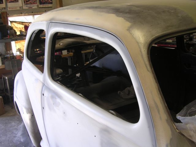

    Thought I would ressurect this post and give an update on my 47. We finally got around to blending the p***. side rail. We are working on the drivers side.
    It's been a slow and tedious process with all that has had to be done to get this thing finished, but I am really pleased with the results. It's obvious that I have come a long way since the last time I posted in this thread. We had to take a big detour from the drip rails to get the drive train wrapped up, and to put the body back on the ch***is. The car is running, and driving and stopping all on its own now, so we are just now finally getting back to the drip rails. Once again, thanks HRP for all the input you gave me through this post, it really helped make things go much quicker, cuz I didn't have to re-invent the wheel.
    Here are a few photos.

    I took one more shot today so I thought I would post it...

    Looks great Mike,,,,The 40 ford I posted is now painted and and will be in Daves shop in a couple of weeks for upholstry,,,I will post a photo of the end result soon,,,HRP

    I was able to take a few photos of the 40 that we made the drip rails to replace the shaved rain gutters ,,,If you didn't know you would have thought Henry himself built them this way,,,
    I think they turned out nice,,,,,HRP

    Very informative post. Now everyone will be cutting off the drip rails and building custom round rod body lines. Seriously, the work looks nice.

    Did the same deal on my '39 Coupe. I was worried about rust blowing out of the factory panel seam so I welded that fully before I welded on the rod. As my dad said "shaving the drip rails on a '40 coupe is like shaving off your eyebrows, makes ya look like a giant mellon" Nuff said.

    Nice work on the drip rails guys. I have been thinking about doing this to mine but did not know how it would look(46 sedan 4 dr). I also need to use this to adjust the gap at the top of the doors. I have a 3 inch chop and the gap at the top is much larger then at the sides. Will I be able to fill the gap under the rod or will I need to fill it with steel to prevent it from popping back out in a year or two.

    I used tiger hair to fill it on mine. IMHO, as long as the metal is good and clean, and you are not trying to use it for any kind of structural integrity, it should be fine. In other words, bondo over metal is fine, bondo over a hole is a no-no. HRP has done this more than I have, so I would be curious for his input.

    47 Tudor Guy, I'm just trying to get it to look good again and keep the rain out. I have the seem welded up and I will grind the duragl*** back to weld it on. Like I said the 1/8" +/- of gl*** was my main worry. We formed up a "Z" shaped channel on Tue. and my buddy took it to work to see if he could make up a longer piece in a lighter gauge to use as another option. The other side of the car does not have any duragl*** on it. I was checking to see how bad it looked without the rail and gl***ed in.

    Dyno gl*** and tiger hair/kitty hair is the same thing it's strong and I believe it will last for many years,,,HRP

    I actually use 3 different fibergl*** products. Bondo gl*** is LONG strand stuff, hard to work with, but VERY strong. Tigerhair is a medium strand product that is a little easier to work with, and Evergl*** is a very fine strand product that is very easy to work with. I try to use the strongest stuff possible, while still keeping the application as easy as possible. In other words, I did NOT use Bondo gl*** under my drip rails because it is like trying to spread a hairball the cat puked up . The Tigerhair (like Dyno gl***) worked well under the drip rail because it spread in to the groove easier. I will sometimes go over the Tigerhair with evergl*** to fill in the "rough spots" as a second coat.
    I'm not saying this is "right" the way to do it, I'm just saying this is how I have used these products with success over the years.
    Thanks for the input HRP.
    Hope that helps 416Ford. The method that HRP described here looks nearly factory when it is done. My buddies 35 Chevy has this style drip rail from the factory, and I believe the 37 Ford did also, so it really fits the era as far as I am concerned. As far as keeping out the rain... well, so far so good, but that's only because my car has not been out of the shop since we installed them! :) But from a practical stand point, the round drip rail should accomplish that because it makes the roof line wider than the door top. If you come up with a different solution, I'd like to see what you did. I am always filing things away for future reference in my mind.

    I will report in that Steves 40 sedan has weathered the rain very well....
    It is a thousand times better at keepin' the rain out than no rail at all,,,,remember ,,,the original gutters were shaved off for some unknown reason before Steve got the car.
    This was the easiest way of making a repair and 99% of the people that have seen the car never noticed the difference until pointed out.
    Hopefully you can see the amount of over hang in this photo,,,HRP
