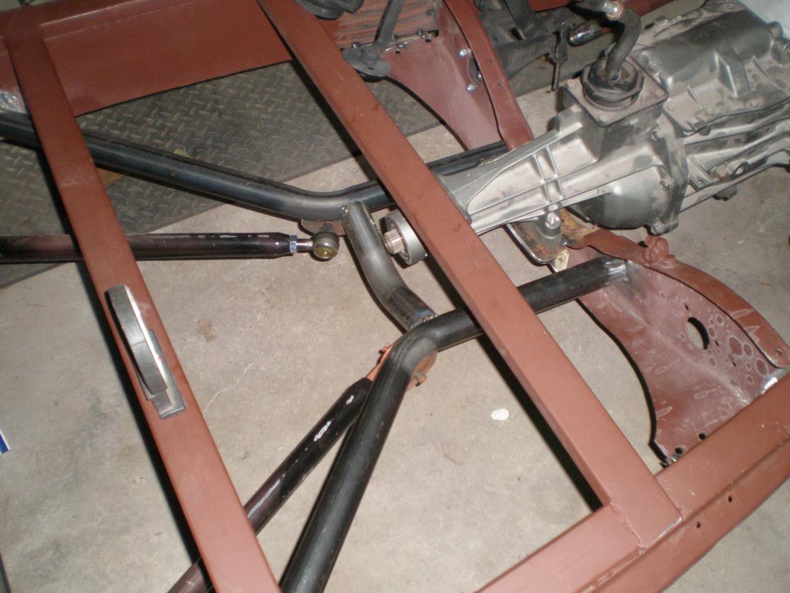

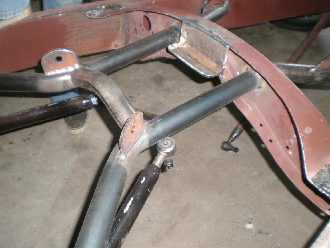

    Original 32 frame, flattend 40 rear cross member, with 32 ends. Model A front cross member, frame pinched, F-1 center cross member and pedals. T-5 trans, boxed frame.
    Owner wanted the flattie look, but with a little more gusto. T-5 and 411 gears work nice. Car has a lot of pep, smokes tires in three gears.

  11. I originally was going to use this frame for my 32. I was setting up two ch***is, one low, one tall. That really was not a good idea with the cars I own already, and the little room I have to store them.
    So when the opt. came to build a car for someone, I had all the parts I needed. I had already pancaked a 40 rear crossmember center, and then spliced it into the 32 ends. Did all that with the body over my head. Gets them down pretty low, and still looks kinda factory.
    K-member got saved for a future project as we used a T-5 in the sedan. F-1 truck crossmembers fit so nice in 32 frames. Worked real well with the T-5 too.

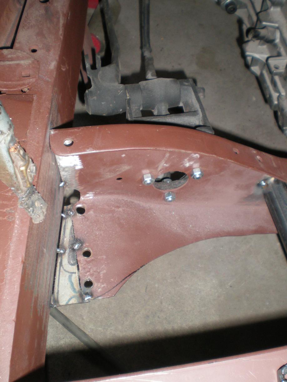

  17. Only these small pieces were added to the F-1 member, fit like a glove. Pedal ***embly worked real nice too. I only added a right angle to the middle of crossmember to mount the T-5. Done.
    I had bought the F-1 for an A frame, but this worked so nice with the 32 frame and T-5. Plus I get to keep the K-member for one of my personal builds.
    This app. worked perfect for the customer, not really my style. But the all together package worked out real nice. This car flies, runs straight, and a real solid ride.
    I think I made up my mind that I'll never build anything not on a 32 frame that week. The end result is just so clean and gives a basic "A" body so much cl*** and flow.

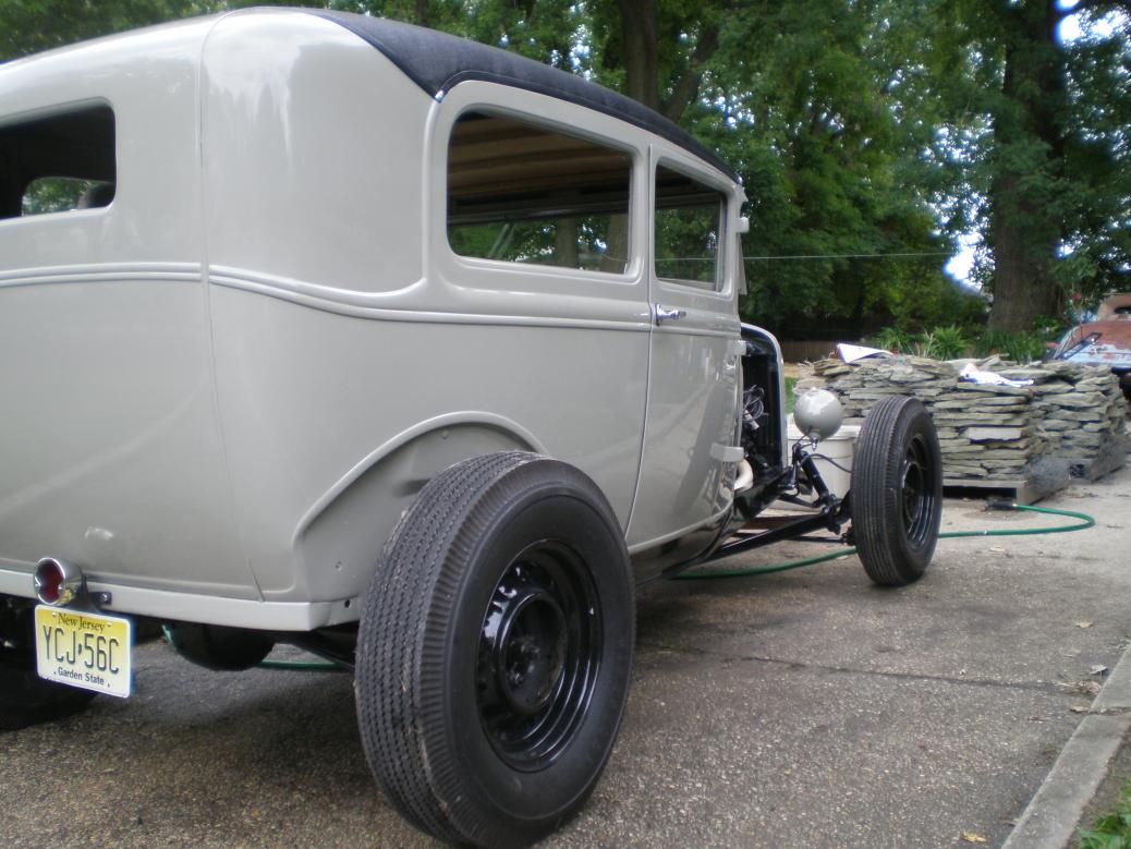

  23. Oh, color is Folkstone Grey. Original 39 or 40 Ford I think.

    DD, What wheels and tire size are you running on it. Also what headlights are those. The A looks very nice.
  27. Not sure what these headlights are... but I may sell them. Too small for me.

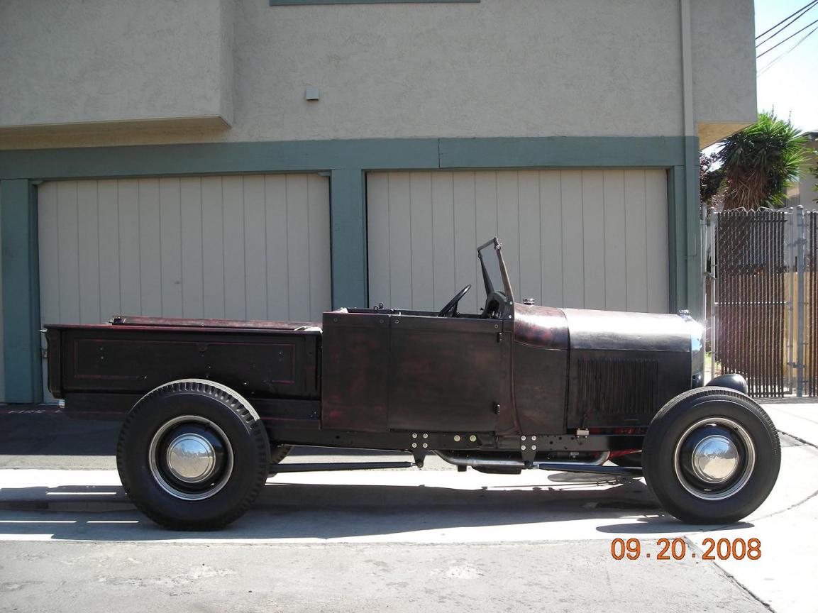

    Here is a pic of the P/U I traded him... Dave Martinez put a sick Oxblood interior in too.
    Love Dave!
