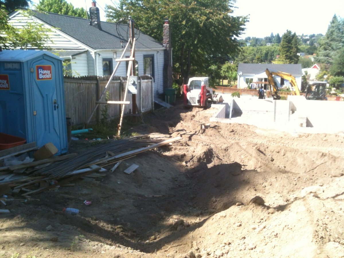

    Merry Christmas everyone! I started this thread a year ago today, and in that time I’ve really enjoyed sharing the story of this car with all of you. Your collective enthusiasm and advice have been a serious motivator.
    I’m currently working on the dash and instruments, and will post some pics of my progress later today. Meanwhile, here’s something I’ve been meaning to share for a while.
    Some time after I pulled the speedster from out of the weeds, the property was sold. I suspect the upcoming sale may have been a contributing factor to the former owner’s change of heart in agreeing to let it go. Shortly thereafter, my wife and I were walking by and this is what we saw:
    The whole place had been s****ed clean by a commercial developer for construction of an apartment building. The Porta John in the picture is sitting right about where the speedster was—one “toilet seat” replacing another (if that doesn’t make any sense, refer way back to Post #8).
    There’s no doubt in my mind that if I hadn’t gotten the car when I did, it would have been bulldozed along with the old house. Rescue ‘em if you can, guys!
  12. loudbang
    Posts: 40,346
    WOW Great karma to get it bought and out of there before the dozers got at it. Bet the guy on the other side of the fence is "Thrilled" that his long term view will be the side of an apartment block a few feet away.

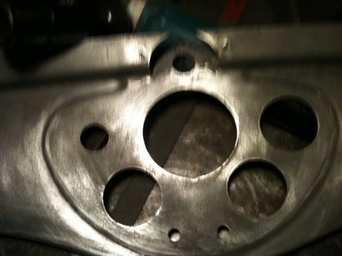

    Now flash forward about 8 months to when I cut my dash out from that old International cowl.
    The dash fit great, looked great, but had one flaw: it had 2-inch holes, and they were very close together, preventing me from enlarging them. This meant the set of late ‘50s SW gauges I’d already set aside were not going to work. Bummer. Then I remembered the free pile gauge. Sure enough, it fit perfect. And the more I looked at it, the more I realized it actually had a better look for this car than what I’d originally planned.
    Over time, I scouted up its two brothers, Oil and Amp. Yes, I realize that a 50 lb. oil pressure needle isn’t going to move much on a banger, but it will do until I find a low pressure one.

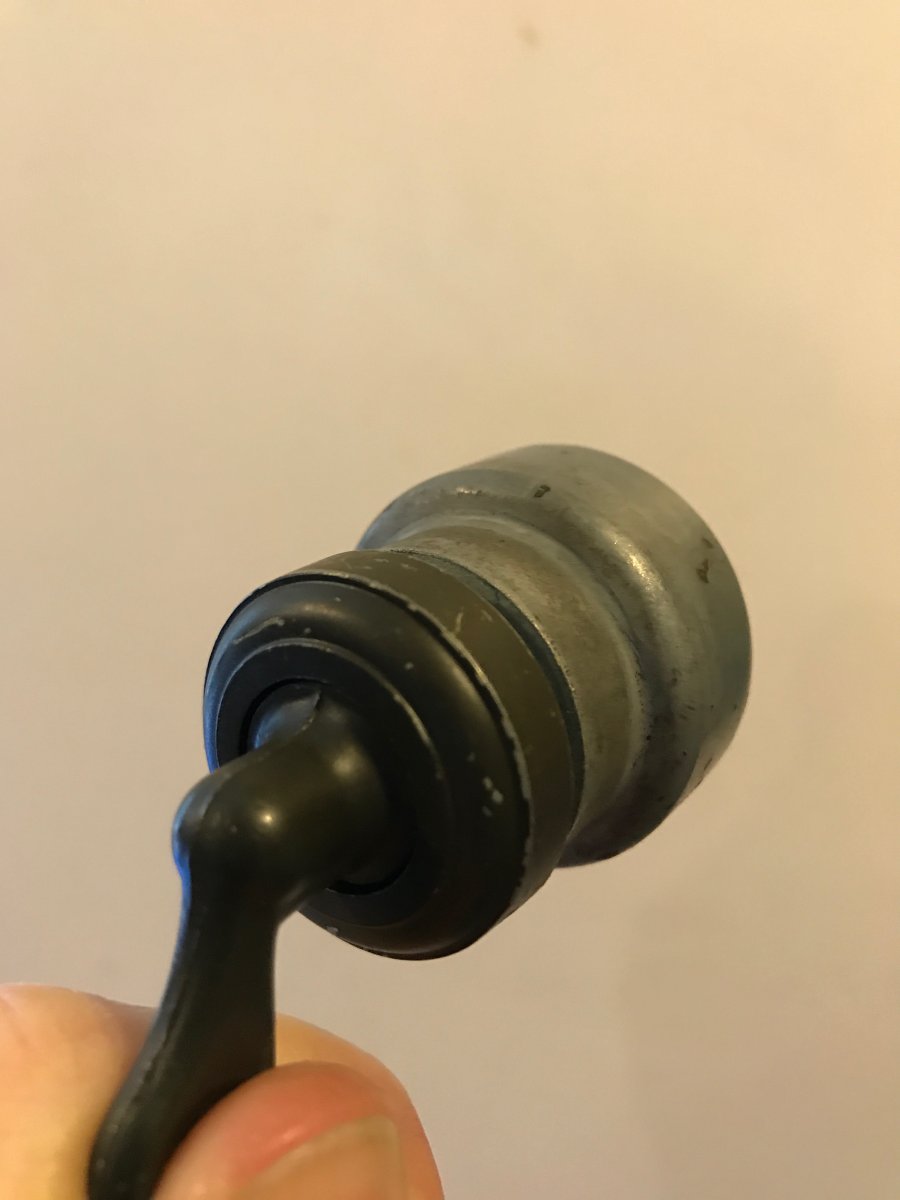

    I did encounter one final problem. I’d originally planned to have the keyed ignition to the left of the steering column and the light switch on the right with the gauges. But I got my measurements wrong, and the switch wouldn’t fit—it interferes with the square tube support I built. Swapping it with the push-pull headlight switch did no good, because that switch is even longer.
    The solution was this lower-profile toggle switch I got at a military estate sale just a few blocks from our house.
    It was an amazing sale, by the way, the estate of a serious collector. There were 2 Jeeps, a transporter, a half-track and an MK 1 tank that was bought by Paul Allen’s museum. I didn’t get any of that, but did come away with a visible pump! It’s a mid-‘20s Wayne, perfect companion to the car. (And no, I paid nowhere near that insane listed price on the tag.)
    Back to the switch: It is seriously heavy duty, and actually looks more period than the push-pull I’d planned to use. So now my light toggle is on the left and the keyed ignition is on the right.

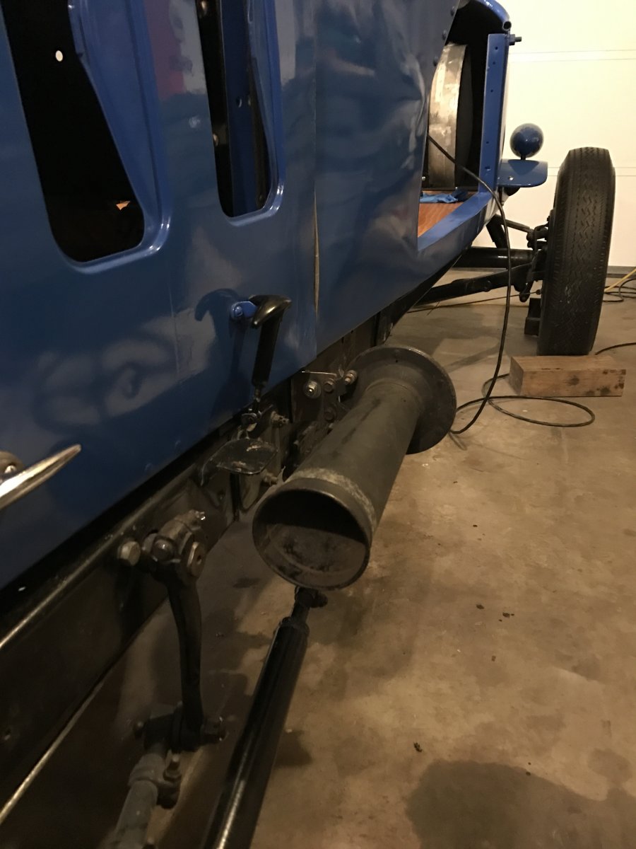

  24. ClarkH
    Joined: Jul 21, 2010
    Posts: 1,570
    ClarkH
    Just installed the horn. Ouboard, just ahead of the cowl. Most guys would hide that ugly thing, but I like it there, for some reason.
  25. Clark, you're going to want to put some kind of cover on the front of the horn, or it will fill up/go bad fast!
    danmacc, loudbang and ClarkH like this.
  26. ClarkH
    Posts: 1,570
    ClarkH
    Thanks very much for that. Hadn't occured to me. Still debating underhood location.
