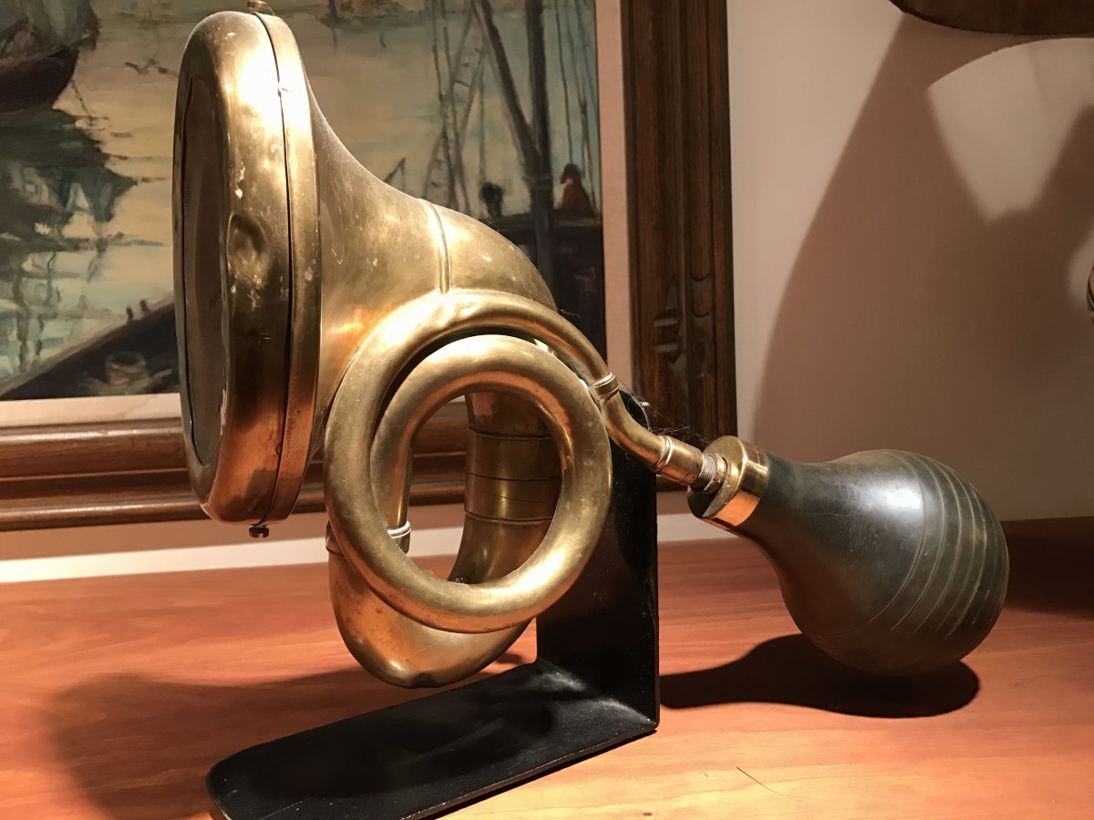

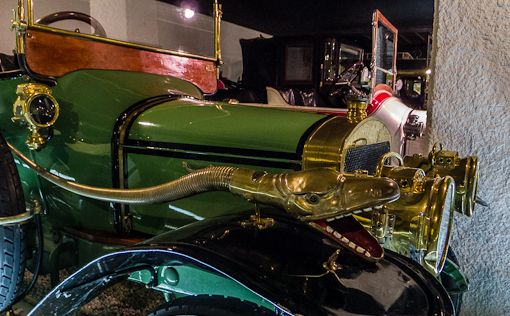

    Good to know this horn's pedigree, and that it's of the era. And yes, "sick cow" is a fair description.
    I've seen those Python horns in museums. They are the cat's pajamas, to use terminology of their day. Here's the closest ever I've come across at a sale:
    It's a basic brass-era horn, but my wife deemed it worthy of a place on our mantle. Sometimes when I'm working upstairs she honks it to let me know dinner's ready. It's surprisingly loud.

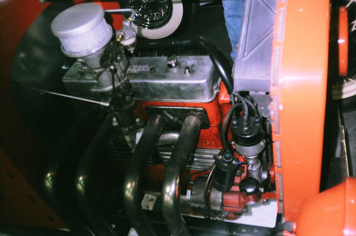

    Here's another Mercury body.
    Look closely at the engine and read the placard

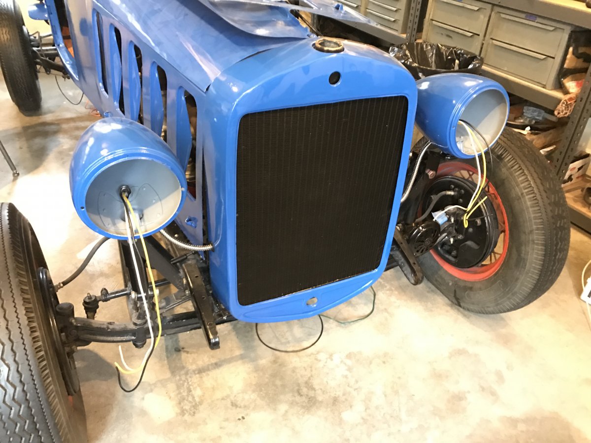

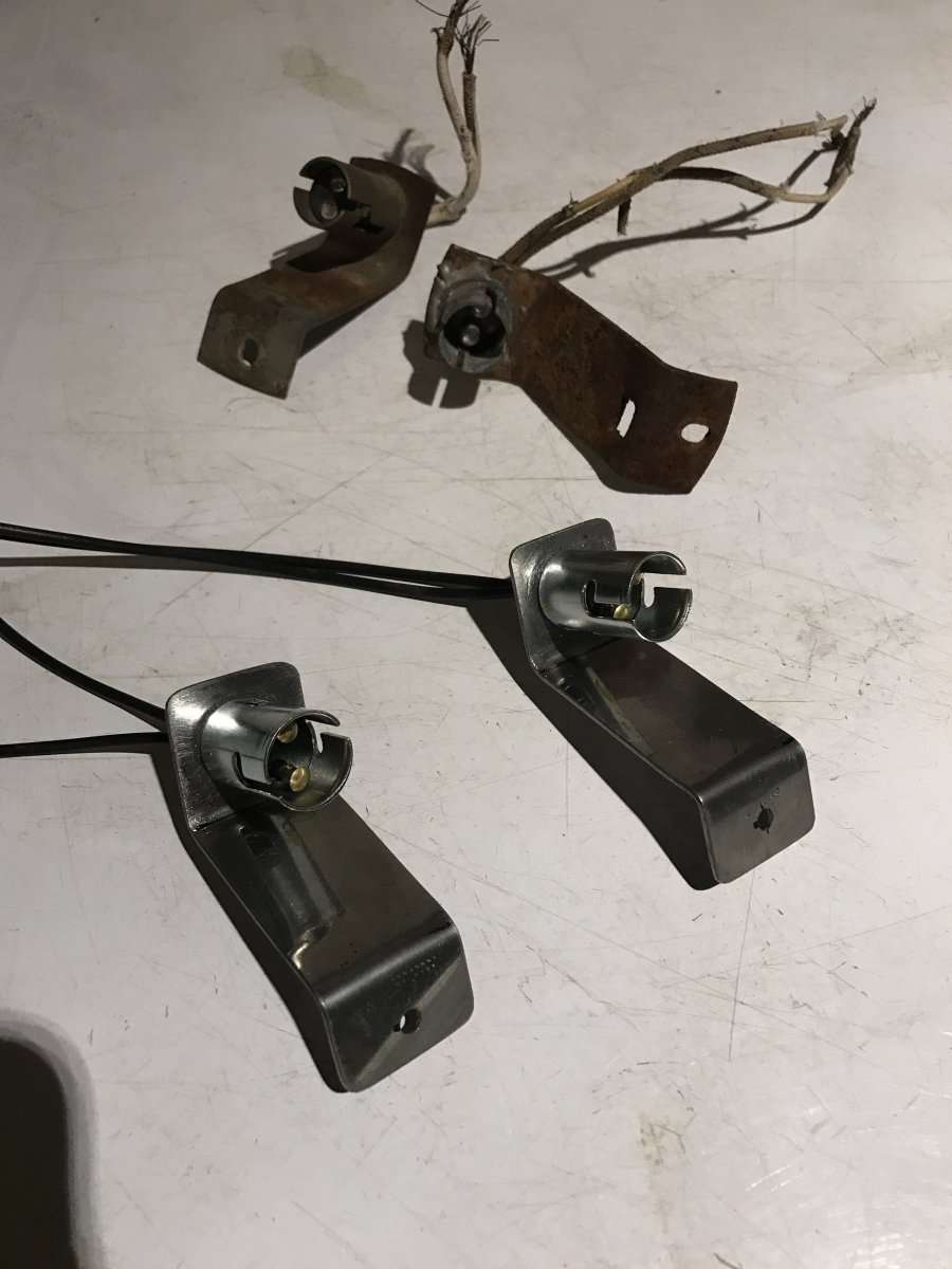

    Replaced the rotten taillight sockets with NOS Cole-Hersee units; made the brackets out of scrap stainless (an old kitchen*****e rack).

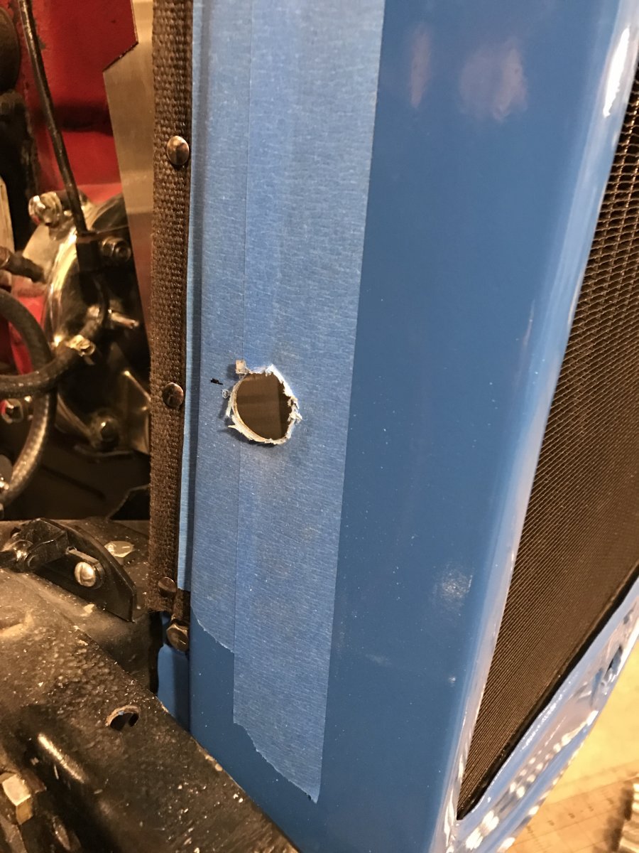

    Gritted my teeth and drilled a hole on each side of the freshly painted radiator shell for where the headlight wires exit the shell and enter the stainless conduit. Didn’t have a big enough drill bit, so finished with a die grinder. Fortunately, grommets cover all sins.

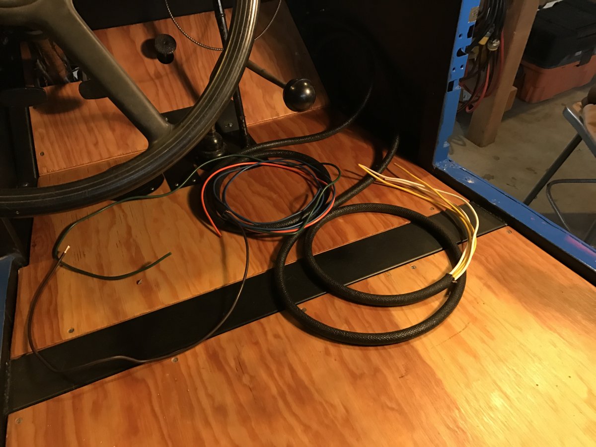

    Then it came time to make the wiring harnesses. Again, it’s six volt, so I used 10 and 12 gauge wire fished through asphalt coated loom (I was amazed they still stock that stuff at NAPA). Man, it took a lot of trial fitting to determine where the wires should exit the harnesses. Thankfully I have fish tape from when I rewired my first house (which, by the way, didn’t seem to take as long as this car has). The front harness is high and low beam only. The rear harness is tail, brake, fuel pump and horn.
    I’ve got everything roughed in now, as you can see from the extra wire hanging everywhere. After reading a number of HAMB troubleshooting threads, I kind of went crazy on grounds—there’s two straps body to frame, and two straps frame to engine. I ran a separate 10-gauge ground to each light and component. Man, I probably added 25 unnecessary pounds to the sprung weight of the car!
    At this point I still need to install the switches and get the under dash routed. Then I should be ready for my Big Day of Crimping.

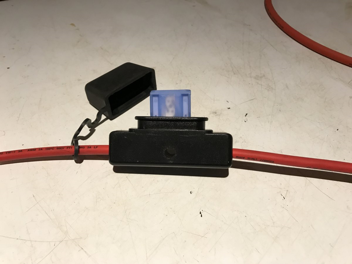

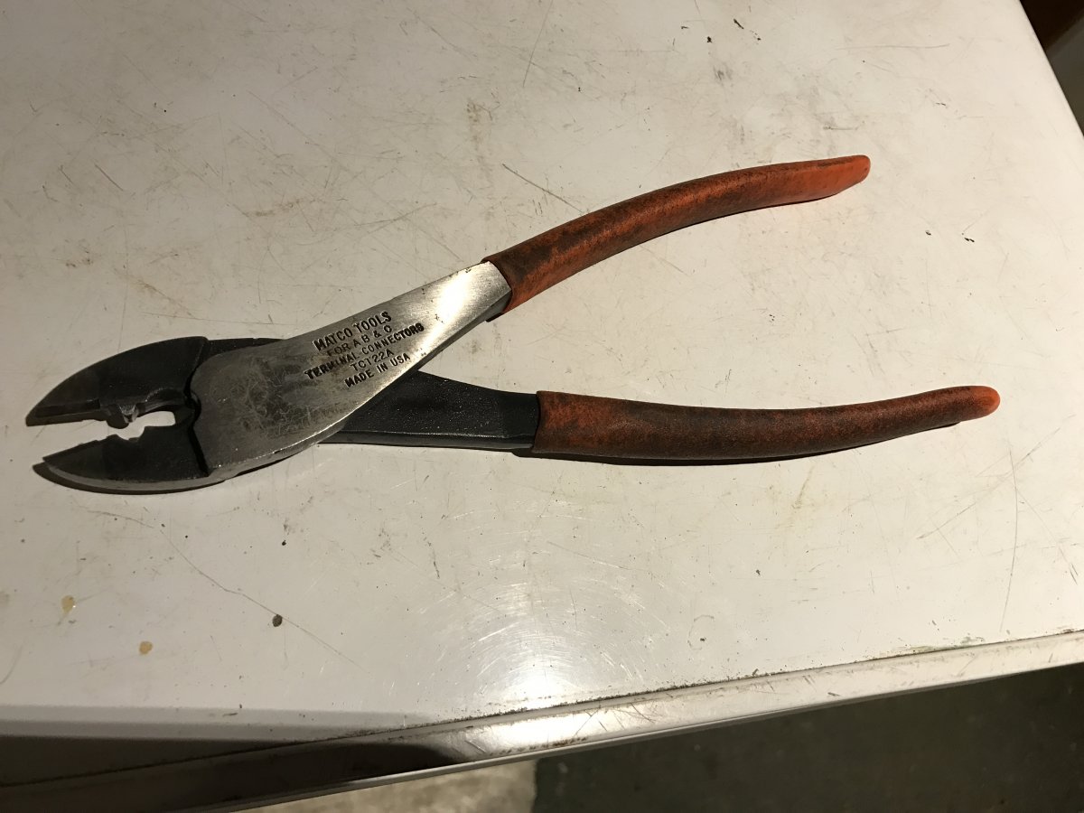

    Some will get soldersed some will get crimped, some will get both; depends on the application and stresses. All will get shrink wrapped. To be honest, I'm going to call in a favor and have my brother do that part--professional mechanic, he's been doing it for years. Trust me, I understand where you're coming from: When my brother came by to check out progress, he laughed at my old*****py crimpers and connectors with plastic covers and threw them all in the trash. Now I have heavy duty connectors and his set of backup crimpers...he thinks he's getting them back...ha! crimpers.JPG
    One step ahead of you, Bob. I've been trying to figure where in the*****pit to keep a fire extinguisher. And there's a heavy-duty cutoff for the battery, in case the worst happens. I'm not letting all this work go up in smoke. Even though this thing is 6 volt, I added a fuse block. And in one of my rare modern concessions, everything feeds through this: fuse.JPG

    Nothing stopping you! Fuses are good! Gary:)

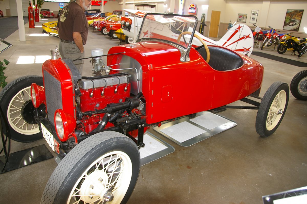

    Hey, Late to the Party, thanks for providing that link to the Mercury Sportster at the Detroit Autorama. (Also a shout-out to timwhit, who sent me an alert when it was first posted.)

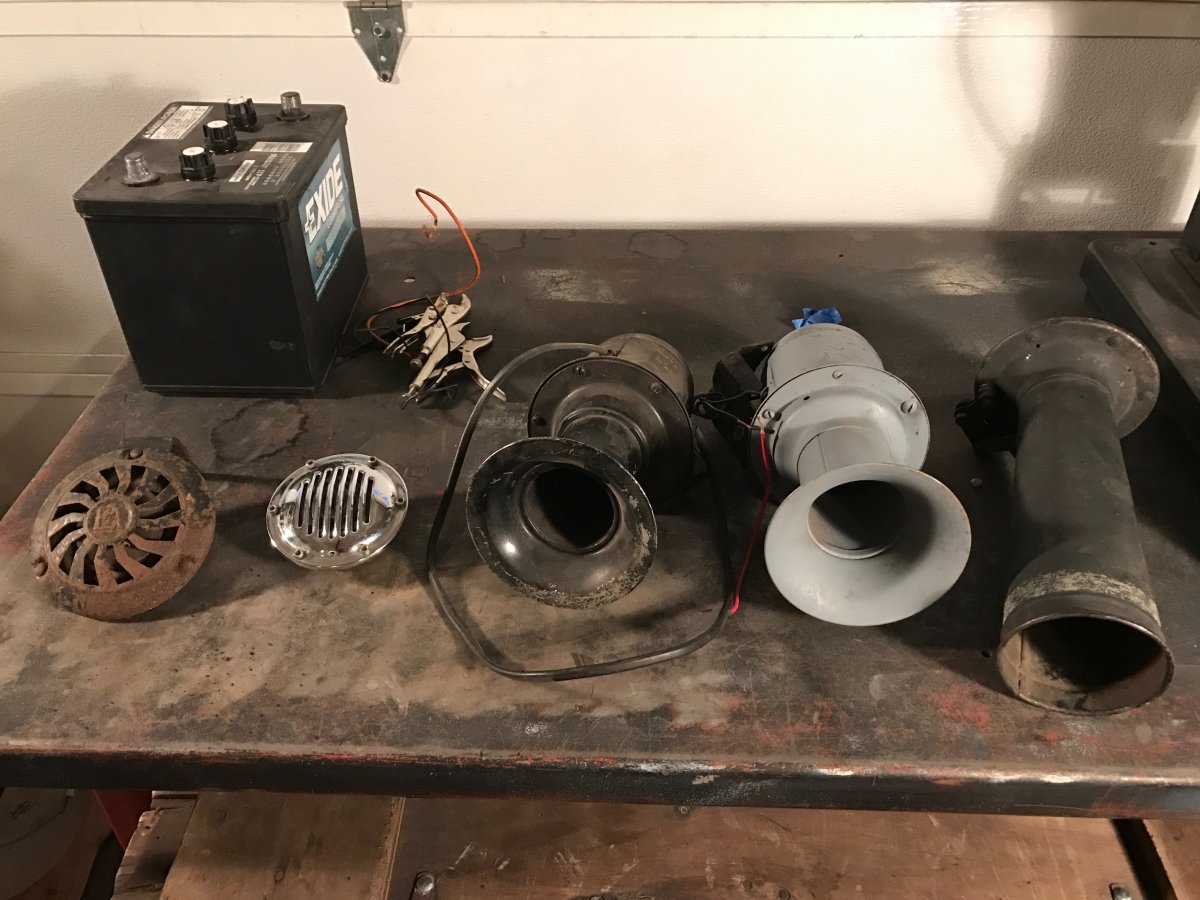

    That reminds me, I also have an update on my quest for the perfect horn. As seen in my January post, the cool old EA motorcycle horn I wanted to use turned out to be a dud, so I went with a big long trumpet style horn—the one Late to the Party very-accurately described as sounding like “a sick cow.” It wasn’t near a cool as the EA, but did the job.
    Flash forward a bit, and there I am having a beer in the garage watching a not-very-good football playoff game. It occurs to me I might as well pull the EA horn apart to see if it could be saved. As I suspected, not a hope—guts all crusty and rusted solid. But as I’m sitting there savoring my “thinking juice,” it dawns on me that these two horns were****embled with near-identical bolt patterns. It was one of those "well-I'll-be-danged" moments. I popped them apart, reamed out the holes a little at the back, switched faces, and problem solved.
    The end result looks cool mounted to the frame horn. Still sounds like a sick cow, but a it’s a really bad-ass sick cow.
