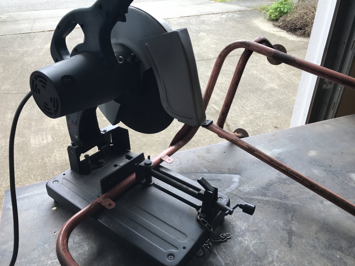

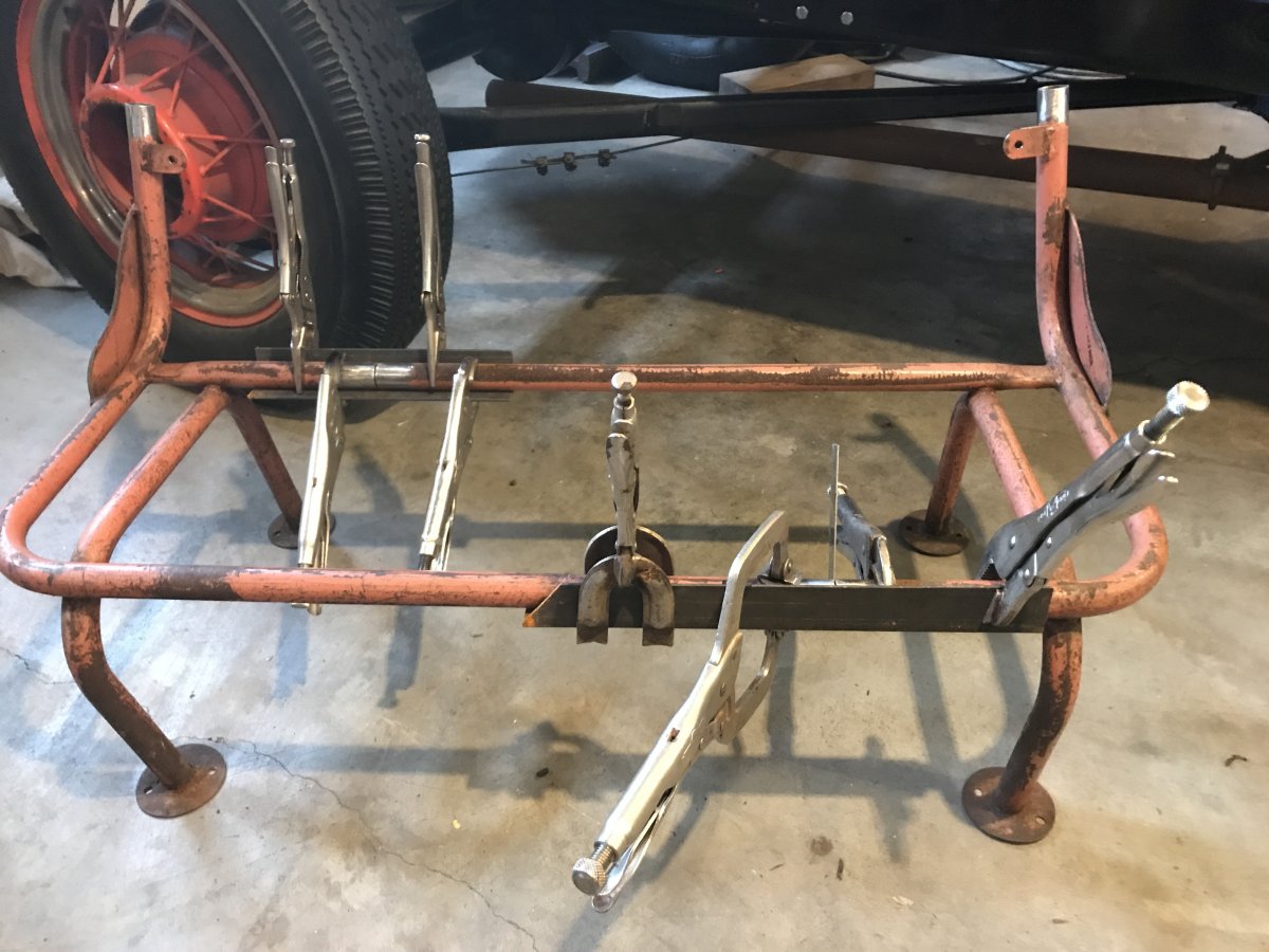

    So the only thing left to do before attaching the doors is to install seats. I’ve been putting this off for a while for a couple reasons—one, because, well, it’s seats, which everybody does last, don't they? The other reason was because I could not find a satisfactory solution.
    The ****pit of the Mercury is 35 inches wide at the back, tapering to 34 in the front. That’s like 6 or 7 inches narrower than a Model A. So, anybody got any stock seats lying around that would fit that? Didn’t think so. The best I managed to find over the years was this pair from an old Anglia:
    As you can see, they’ve been stripped of upholstery and pinched, giving them a faux bomber look. Even so, they’re too big, and only fit in an offset configuration with the driver’s seat ahead of the p***enger. You could argue there’s some historic precedent for that from the old racing days of riding mechanics. But it’s odd, and the seated-in-the-rear vibe was a little too “Driving Miss Daisy” for my dear and extremely patient wife.

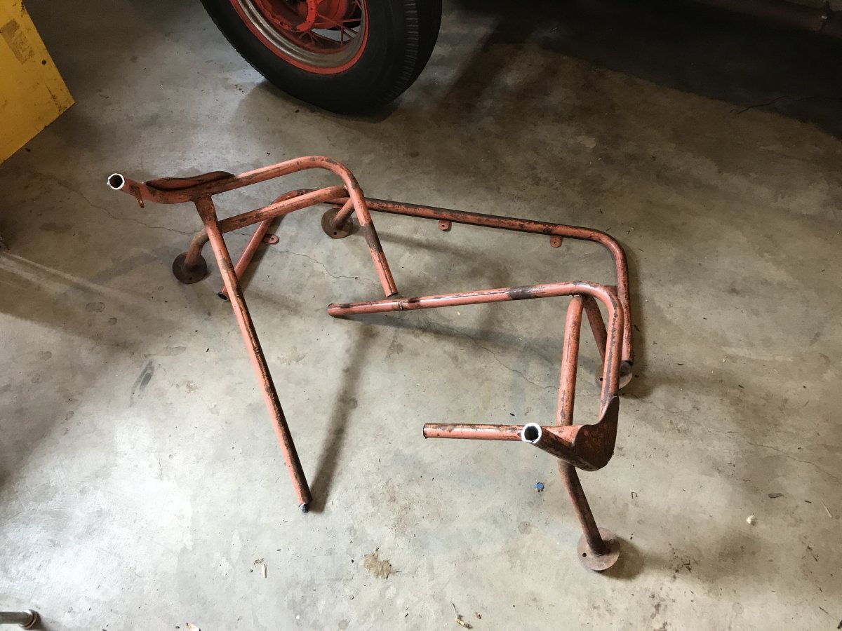

    Nevertheless, I was resigned to using these as placeholders until a few weeks ago, when Matt—known to most of you as Hitchhiker—showed up at my garage door with this:
    It’s a seat out of a ‘30s-40s school bus that he scored off of Craigslist. Smallest one either of us has ever seen (insert "short bus" joke here), and damn near perfect. So yesterday I declared an official end to wiring, wiped my hands, and went to work on something more gratifying.
    The patient is stripped and prepped for surgery:
    The patient goes under the knife:
    Oh god, do I have malpractice insurance!?!?
    No, we can rebuild him (cue Six Million Dollar Man theme)…stronger…faster…
    Or more accurately, shorter… narrower…
    DONE! Fits like a glove.
    Now I just need to make cushions and covers. I’m thinking distressed oxblood or burgundy would go good with the blue.

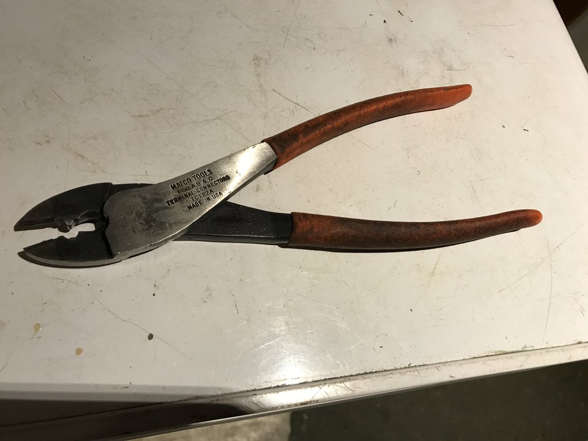

    Who makes heavy duty/quality connectors? I could use some myself.
  5. ClarkH
    Joined: Jul 21, 2010
    Posts: 1,570
    ClarkH
    I got a nice USA-made set off Amazon from www.connectorsupply.com. Something like $40 for a 450 piece set. Also, my local hardware store stocks Noble Wire & Terminal connectors, which are very high quality, especially the marine connectors. This which was a godsend whenever I got into a bind. A byproduct of living up the road from several shipyards and yacht buiders. I also recommend a search on threads by wiring guru Crazy Steve.

    upload_2017-5-2_1-36-35.png Not short bus, that is a Bugatti seat frame.:rolleyes: Bob

    Thomas and Bets crimping tool is one of the best. They look just like yours. I love mine.

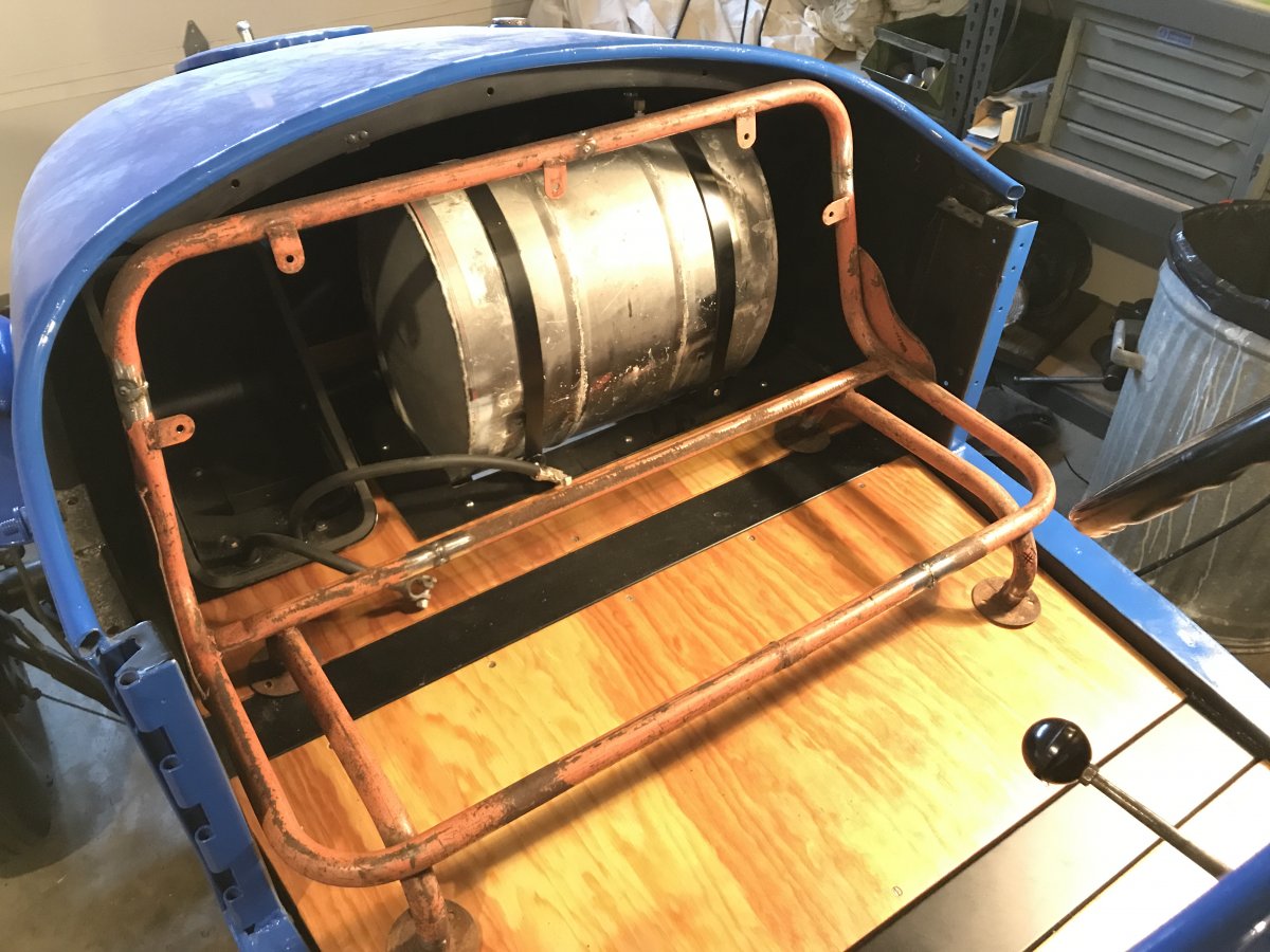

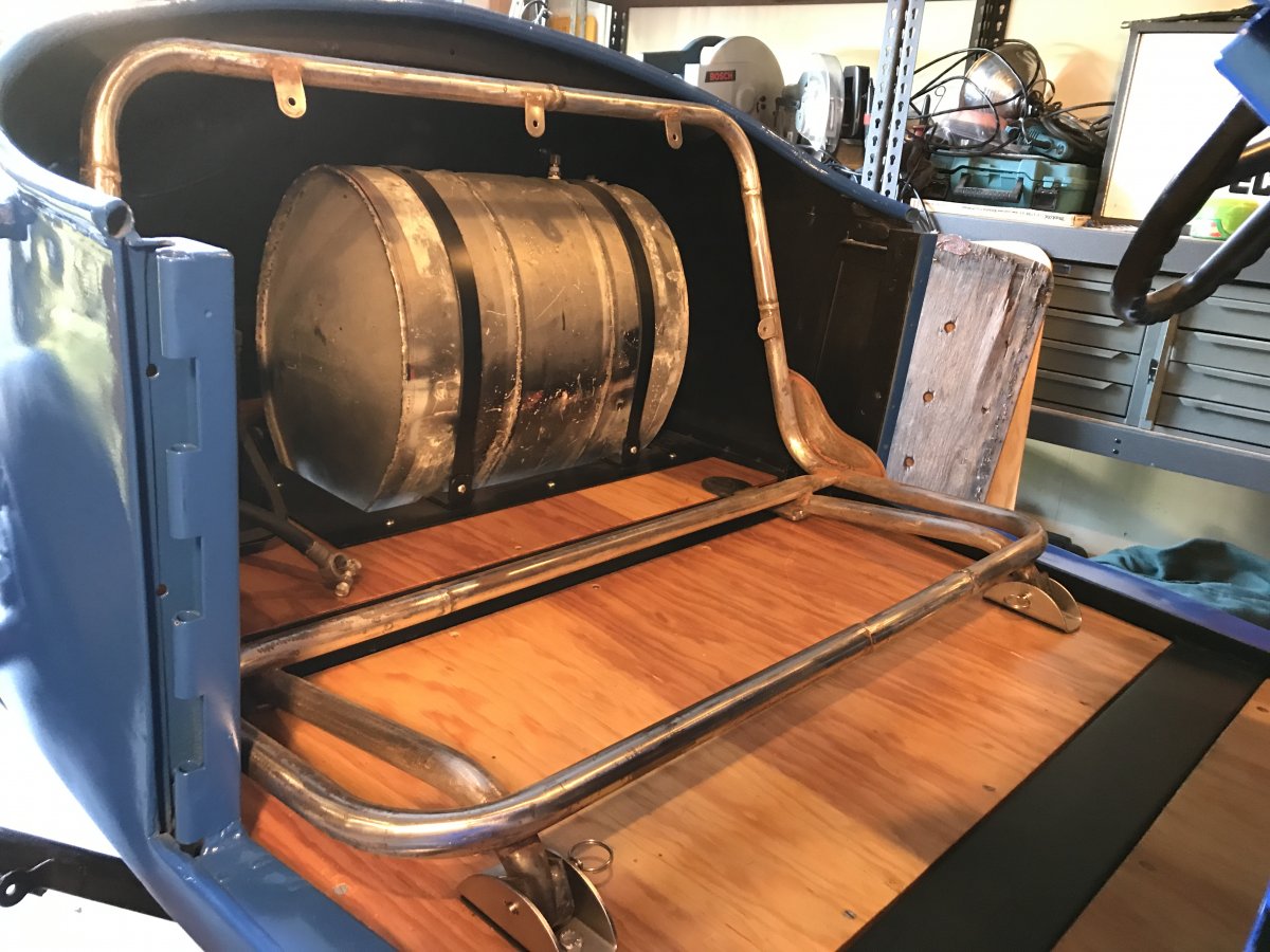

    Anyway, on to my updates. When we last left off, I had roughed in my school bus seat (kudos again to Hitchhiker on that little find). I then realized that while I had the width right, I had miscalculated height—needed to allow for cushions! So I cut it up again, shortening the legs and lengthening the back. I also canted the seat to put me in a more comfortable position. Here it is now:
    I designed the seat to fold forward for easy access to the battery:

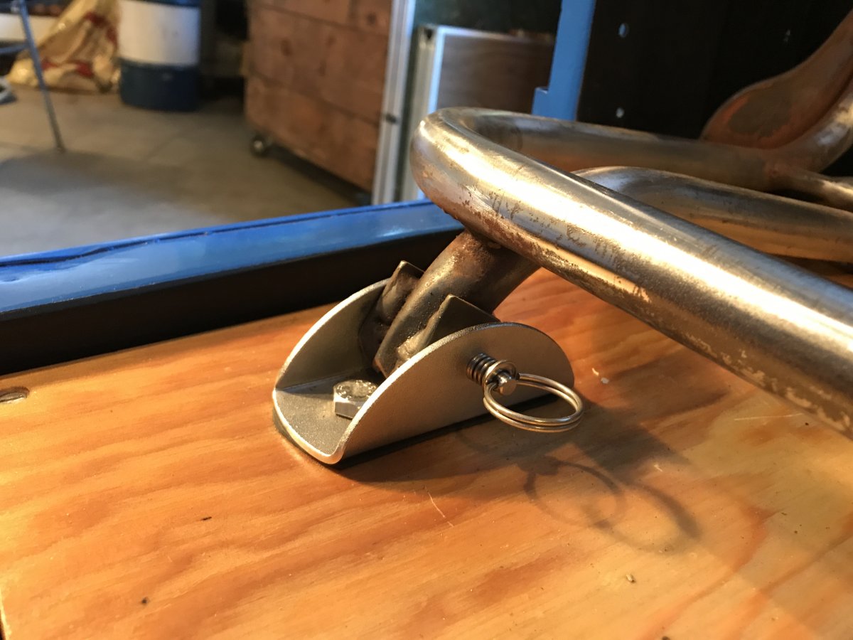

    The front legs pivot on marine anchor quick-releases. I beefed up the tubing where the legs pin into them.

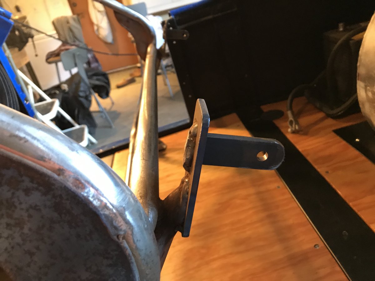

    Also made rear tabs that pin into a cross-member positioned under the floor. The cross-member is plenty stout because the seat belts will also bolt into it.
    To be honest, my original intent had been to have the tabs come up through the floor from the cross-member, so the pins could be up top. But after I shortened the seat legs, there was no easy access. I debated a remote actuator, but finally decided to Keep It Simple (Stupid). I've got too much on my plate to start messing around with that level of detail. Besides, I’m not going to access the battery very often—it will have a remote cut-off.

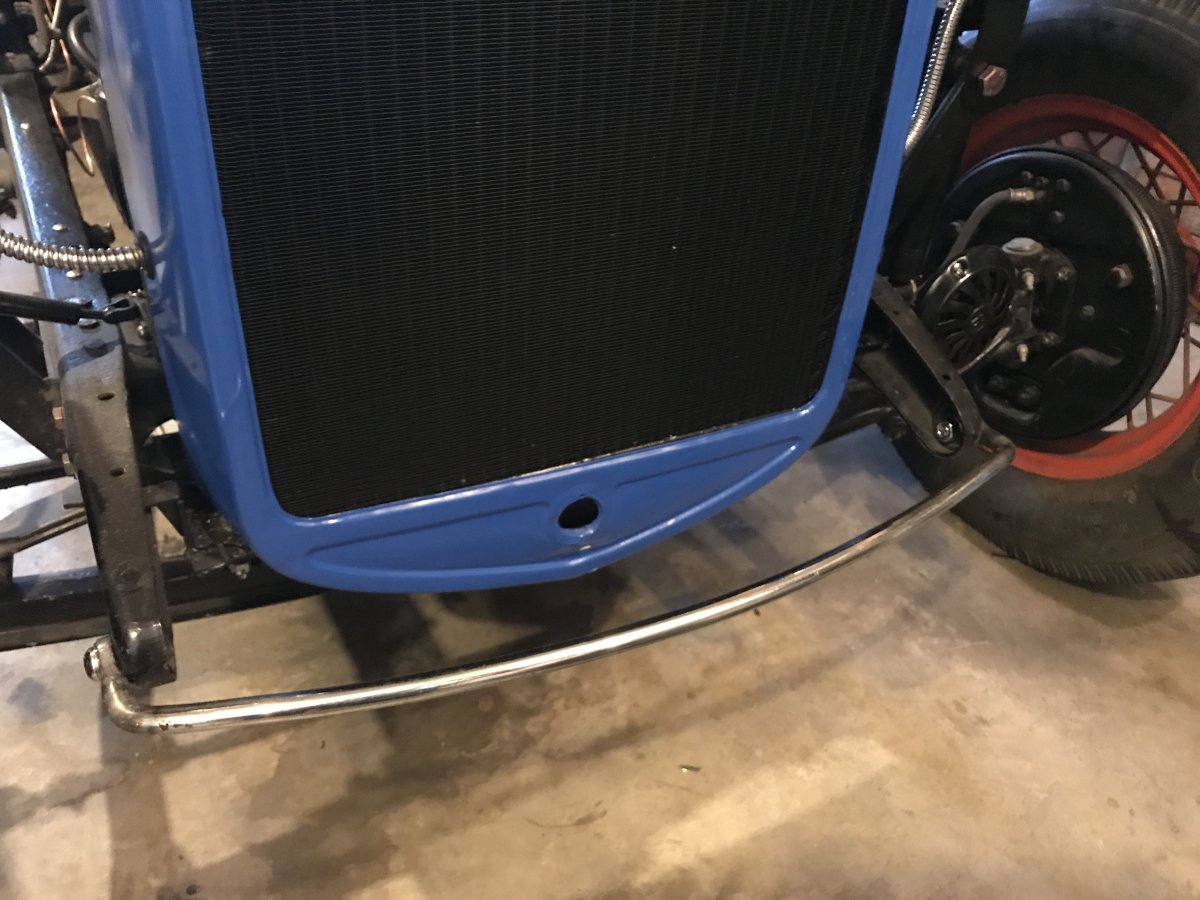

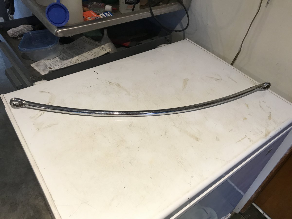

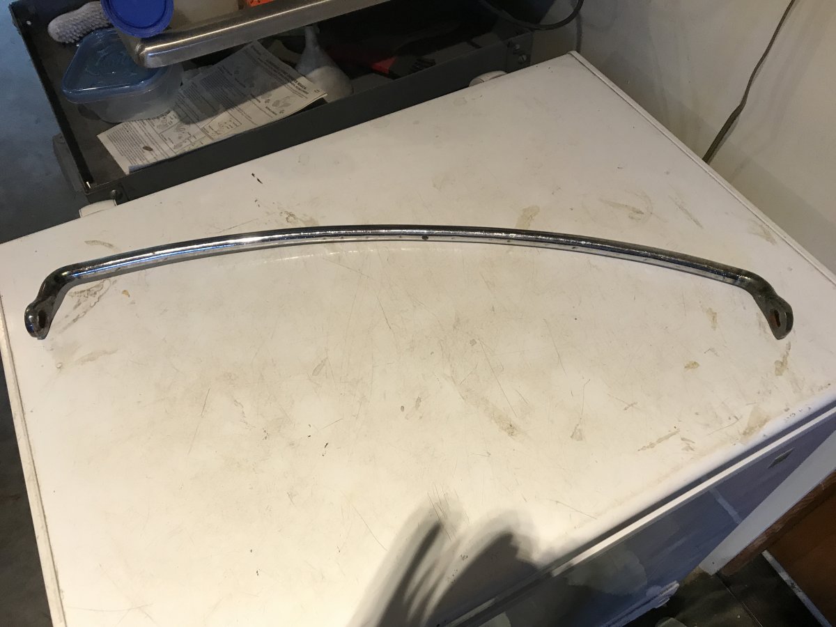

    Lastly, I’ve been scratching my head for a while about some kind of protection for the radiator and shell. I didn't want a full-on bumper, more of a spreader bar or hoop you'd find on a race car. I found my answer last month at the Monroe Swap Meet, in the form of this home-made chrome headlight bar:
    The thing is solid steel, not hollow. All I had to do was introduce it to Mr. Torch and Mr. Vise:
    And here’s the result:
