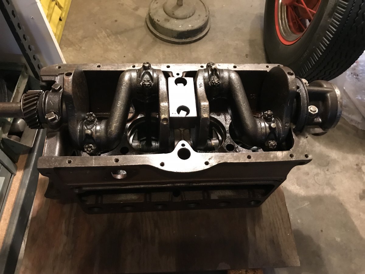

    B-block with C-crank. :eek: Lots of machine work already done, including beefed up main and cross-drilled crank.

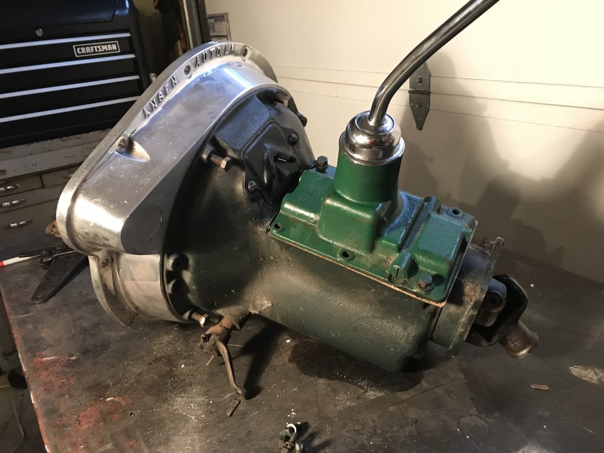

    ’39 trans with Zephyr gears and Ansen adaptor, ready to bolt in. :eek::eek:

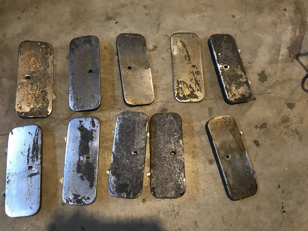

    Thanks Stogy! Oh man, those panels...
    So last week I dug them out and gave them a good look. The old chrome is hopeless and some have pretty severe pitting. Finally decided you know what, with all that shiney new paint, I really should bite the bullet and have the things chromed. So I took them into the plater. Very nice guy, he looked them over, thought about it a bit, and finally shot me a number: $225. My heart sang! And then he said, "Each." :eek::eek::eek: Uh, that's $2,500 out the door after taxes. Yikes! So long story short, it's back to Plan A: they're getting painted.

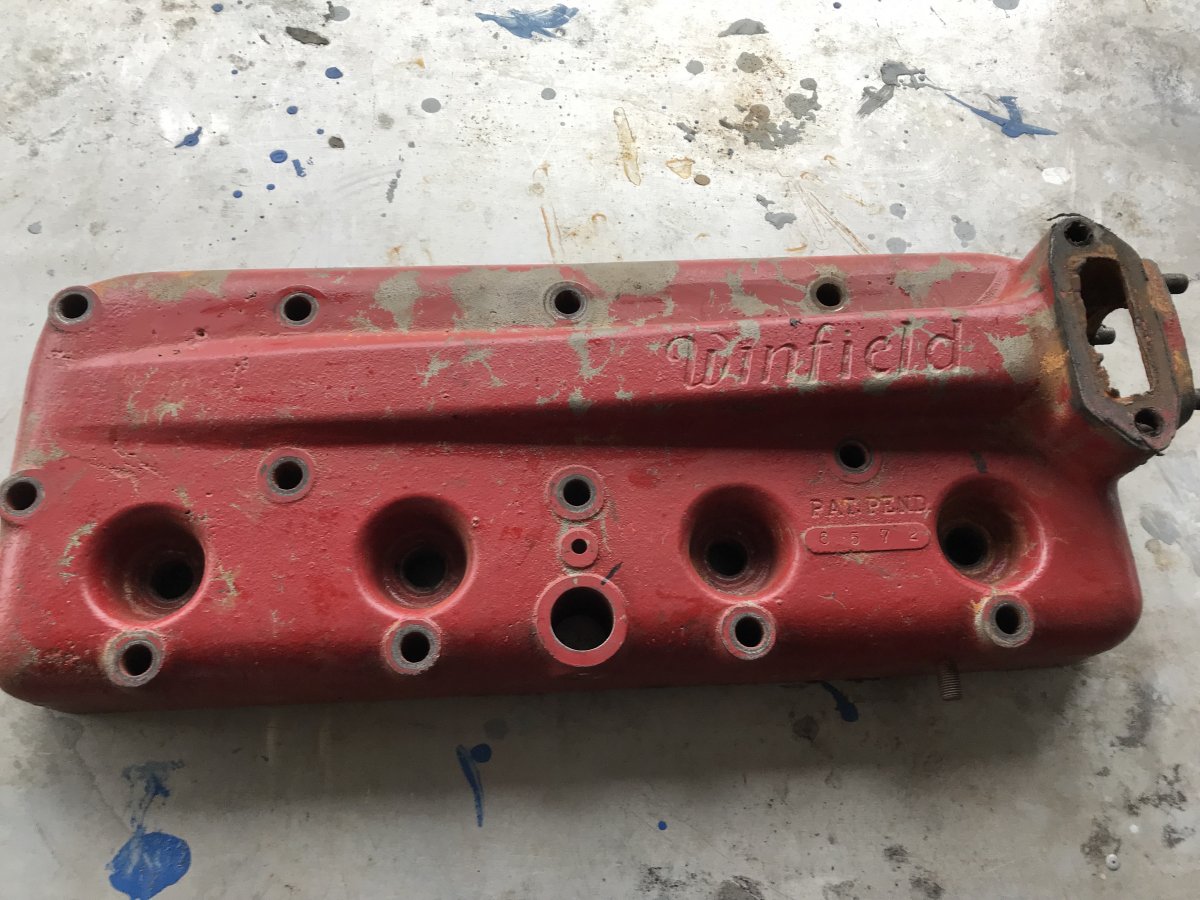

    Oh man, this kind of falls under the category of "embarr***ment of riches." Here's the "silly" head that Hitchiker convinced me to buy:
    It's an original cast iron unit. Don't let that rattle-can red paint fool you, it's a 6:1 yellow head. Hitch talked me into it right before the Riley came along. So plan now is to run the Winfield on my current A engine while the B gets built and fitted with the Riley. And sorry, don't bother to PM, because my brother and Hitchhiker are already elbowing each other in line hoping to get it when I'm done.

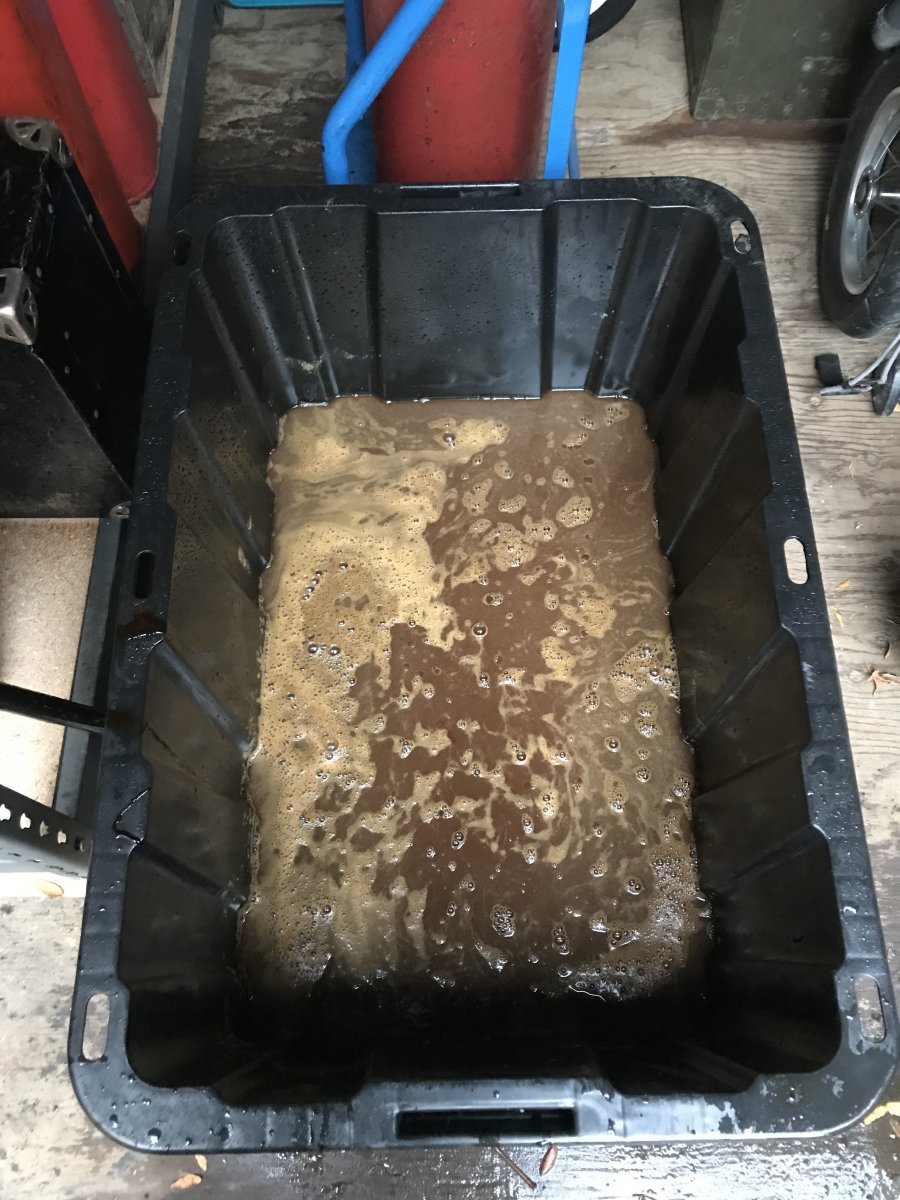

    One nice thing about rattle-can paint is that it strips off easy. The head is currently enjoying a mol***es bath, primarily to de-rust the water jacket.

    Almost don't want to ask but heck did you ever give that spray chrome a thought? Polished Copper Plate?

    You should ask your palter what it would cost to get the old chrome stripped, it will make priming & paint go a lot quicker with bare steel as a starting point. Merry Christmas! Bob

    I hear you, Stogy. Fact is, I suspected chroming would be out of range right now, but had to find out for sure. May still do it someday, but right now I can get a lot more bang for the buck elsewhere, like a new interior. And she still needs a windshield, aprons with louvers, fenders... chrome is somewhere over the rainbow...
    Meanwhile, just to show I'm making progress, here's pics from last night, which I spent making stainless brackets for the hood panels.
    Man ten panels is a LOT.
    Bob, that is an excellent suggestion. I'll call the guy today!

    As long as you're going paint ...... someone near you probably applies that paint that specifically mirrors chrome. Alta-chrome or similar. Good enough probably. Then again, blue may be good enough twice.

    Just went through the thread, Wow, don't forget about powder coating, they do a chrome like coating, could work.

    Also, you could Nickel them. I love the look of good, thick nickel plating. Not too shiny, but better than chrome paint. It can be done in your garage too... search YouTube for directions.

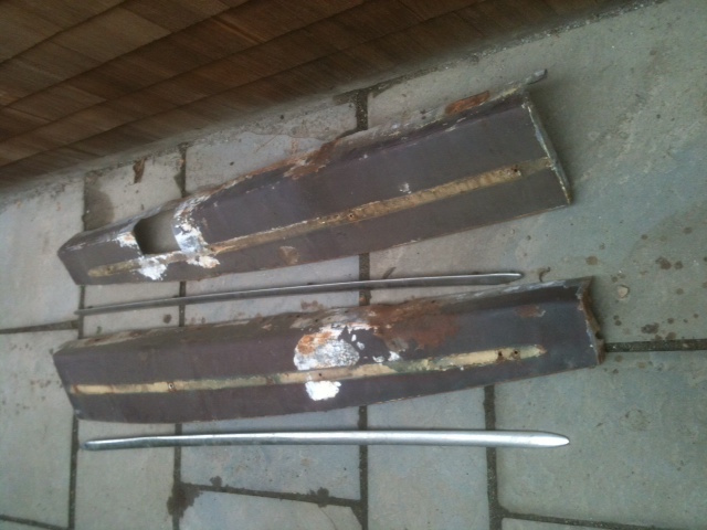

    We’re coming up on Christmas and the two-year anniversary of this thread. I’ve made a lot of progress in that time, and sure appreciate everyone’s advice and input as you’ve followed along.
    I’ve recently launched about half a dozen projects and upgrades that will be going concurrently over the next few months. Some have been “foreshadowed” already in this thread, but I figured I’d use the holiday to update everyone more fully on what’s going on.

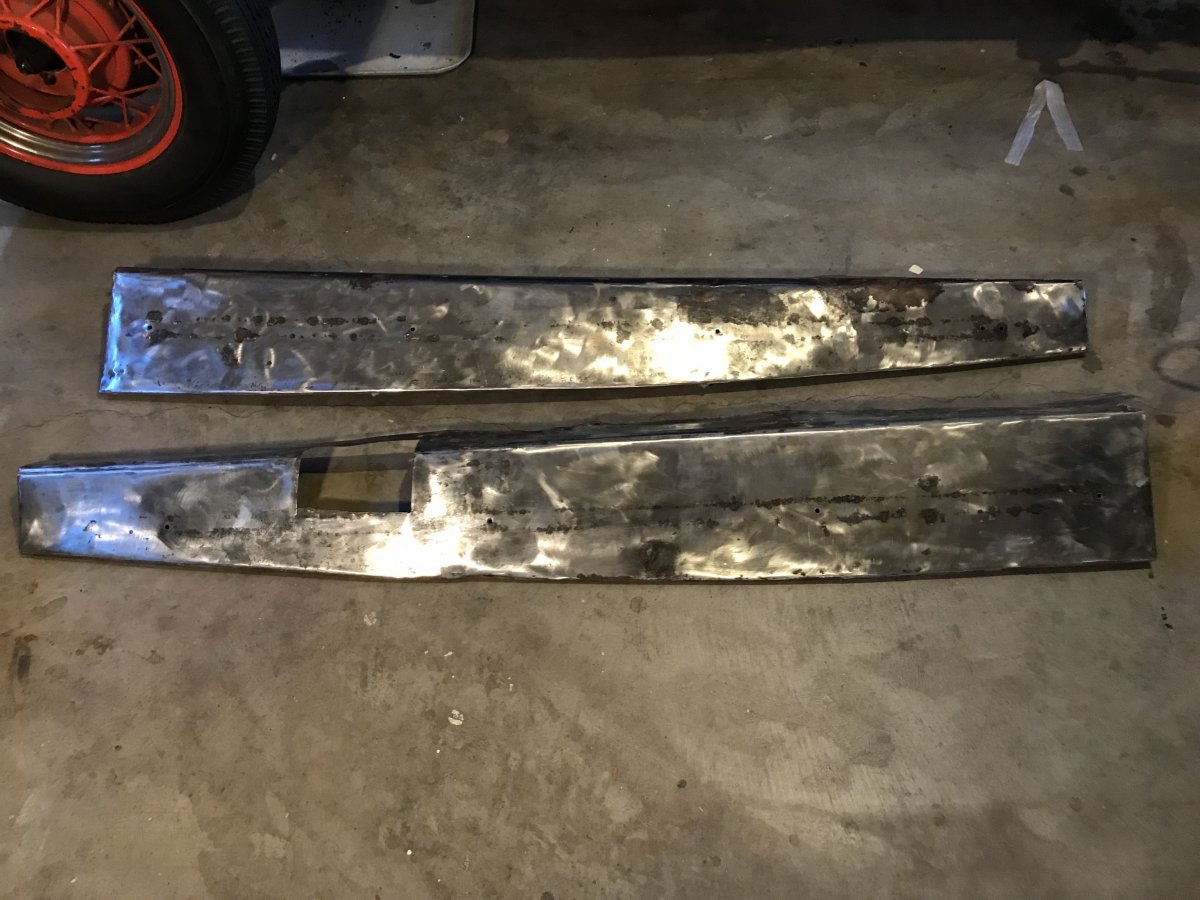

    I’ll start with the splash aprons. Here they are again, as found:
    They’re 50s-era homemade, but actually pretty well done. They have a rolled edge and a nice gentle taper along the bottom that appears to mimic the shape of the original Mercury aprons. (I won’t be re-using the chrome spears.)
    First step was to strip the many layers of old paint, then hammer-and-dolly them back to fairly straight.
    I now need to shrink one stretched area, and weld in a patch where somebody cut an access hole (project for this afternoon, hopefully). I originally thought these were made of galvanized steel, but after I stripped them I wasn’t so sure. One side looks galvanized, the other doesn’t. Turns out, it doesn’t really matter. I did some research, and despite some alarmist online comments, it turns out you can weld galvanized safely with good ventilation and a mask rated for zinc oxide—both of which I already have.
    The plan is to louver the aprons in the style of the old Bugatties, as seen again in this cl***ic shot of Bugatti Queen Helle Nice.
    There’s a twist, however. The louvers on the right side will end a foot early, leaving a blank space for a hole through which the exhaust will exit. I want to bring it out just ahead of the rear tire. I think it will look pretty cool.
    An aside on exhaust: I decided the straight pipe wouldn’t cut it, so I got this Porter muffler, which by an odd coincidence matches the car’s paint. But that’s temporary—think I’ll paint it high-temp black.
    I’m here to tell you, that Porter is a heavy ****er. Don't’ think it will rust through in my lifetime.
    More to come…
