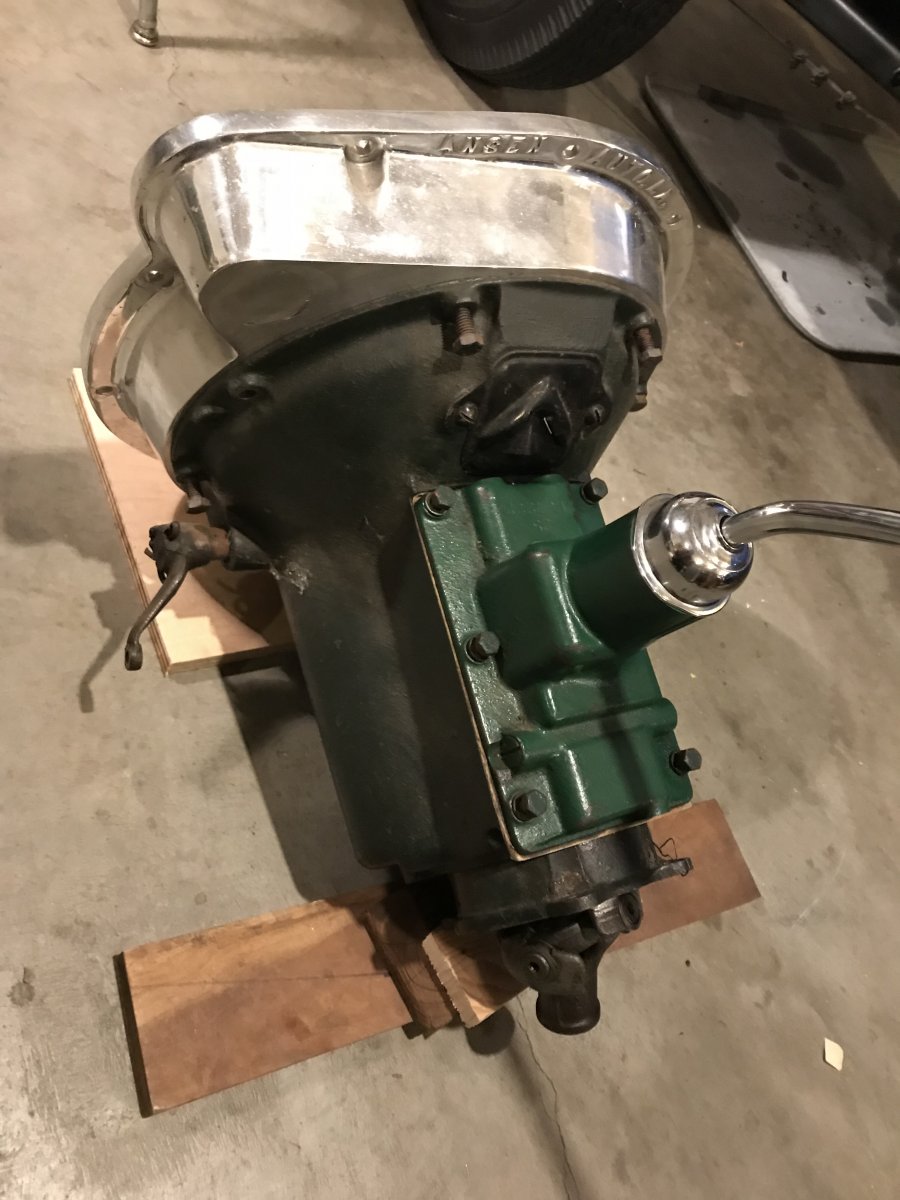

    Meanwhile, I’ve decided to go ahead and install the ’39 transmission I got from Hitchhiker. Zephyr gears and syncrhos! Came with this nice old Ansen adaptor.
    I also got a lightened flywheel from the Incredible Hitchhiker Parts Pile (tm). The flywheel and a new pressure plate are now out for surfacing and balancing.
    The unit came with a bracket for the stock brake and clutch pedals, seen here freshly emerged from mol***es.
    But there’s a problem, I think. The mount points for the bracket don’t look sufficiently rigid to me. I took a look at a modern Cling’s kit, and their pedal bracket also has a secondary extension that connects to the forward two bolts on the upper trans cover. Looks much more stable. It kind of goes where my hand is in this picture:
    Looks to me like it would be relatively simple to fabricate an extension from bracket to top of trans, so that’s next on the list after I finish grinding my welds on the splash aprons. Also need to make a bracket for the emergency brake lever, but that’s just a piece of angle iron.
    By the way, I’m pretty sure that nice chrome shifter is not going to fit under my dash:
    It would be a shame to mess up the finish bending it, although I’ll do it if necessary. But first, I have options:
    On the left, a swan shifter I got from Chris years ago. On the right, a funky thing sourced from the IHPP (tm). I’m sure one of these can be made to work, maybe with a little rosebud coaxing.
    More to come...

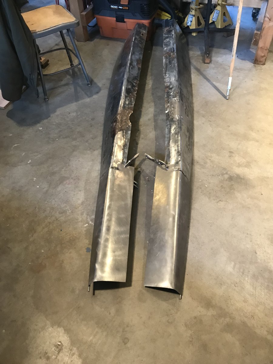

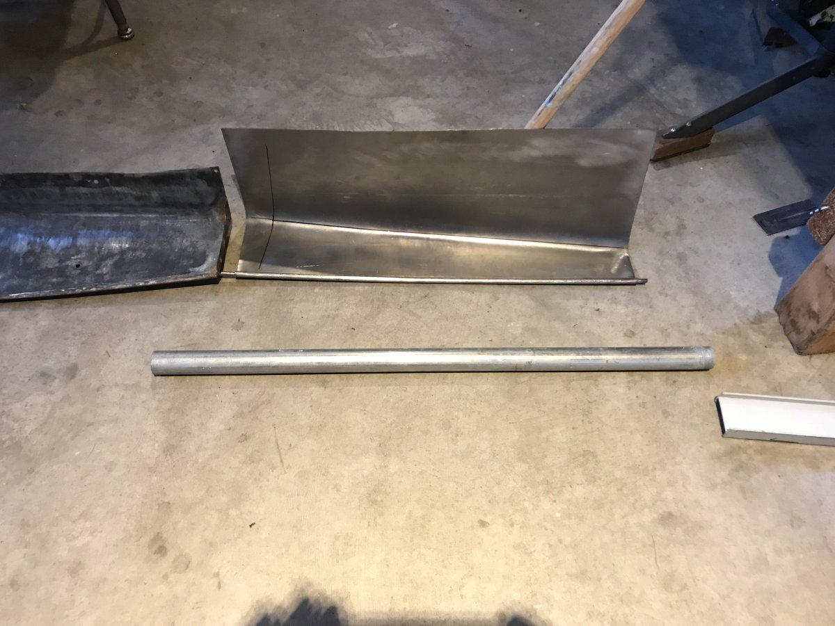

    Thanks for the comments, guys. Also went after the splash aprons. Hammered and dollied them into shape and patched the hole in the driver’s side panel.
    Incidentally, I hate mig-welding .22 gauge. Even going slow with lots of tacks and backing the area with a thick plate of copper, I’m still either blowing holes or warping the **** out of everything. And just when you think you’ve got it and let your concentration wander, the grinder cuts through everything. So one patch turned into two. Fortunately, I was able to stretch the welds back out with hammer and dolly to where everything looks OK. Not perfect, but good enough.
    Inspired, I decided to go ahead and fabricate forward extensions to cover the rest of the frame. Started by hammering a 1/4-inch wire edge. (Great videos on this on YouTube, and that homemade dolly in the picture is key).
    One amusing note—that tinner’s hammer in the third picture is something I made in my 7th grade metal shop cl***. Makes me smile to still find use for it.
    Next, I carefully lined everything up using “that most accurate of measuring devices, the human eye,” and bent it over a piece of pipe.
    Cut, bent and hammered the joint where it attaches to the apron.
    And there they are!
    Still a lot of tweaking and t******* to do, but I need a test fit to get that right. And that means unbolting the body. A project for early 2018!

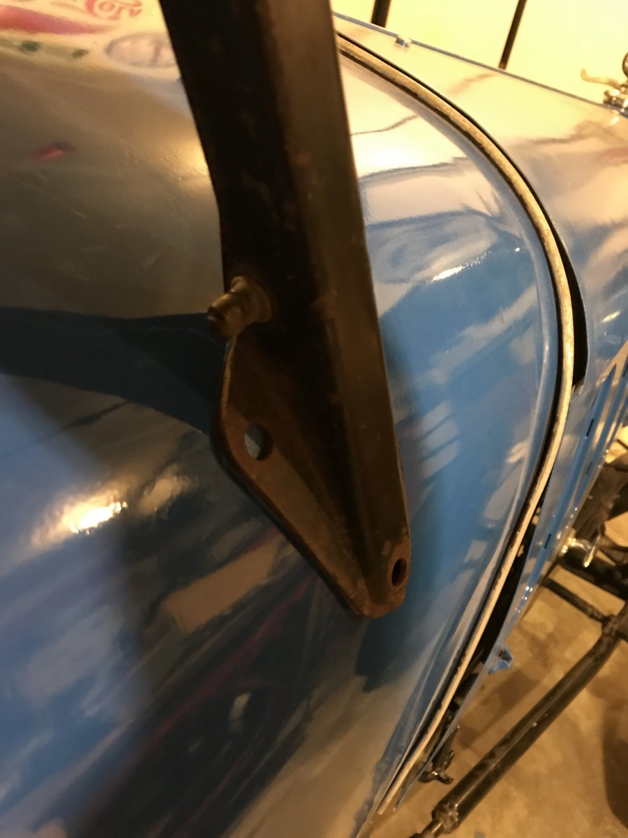

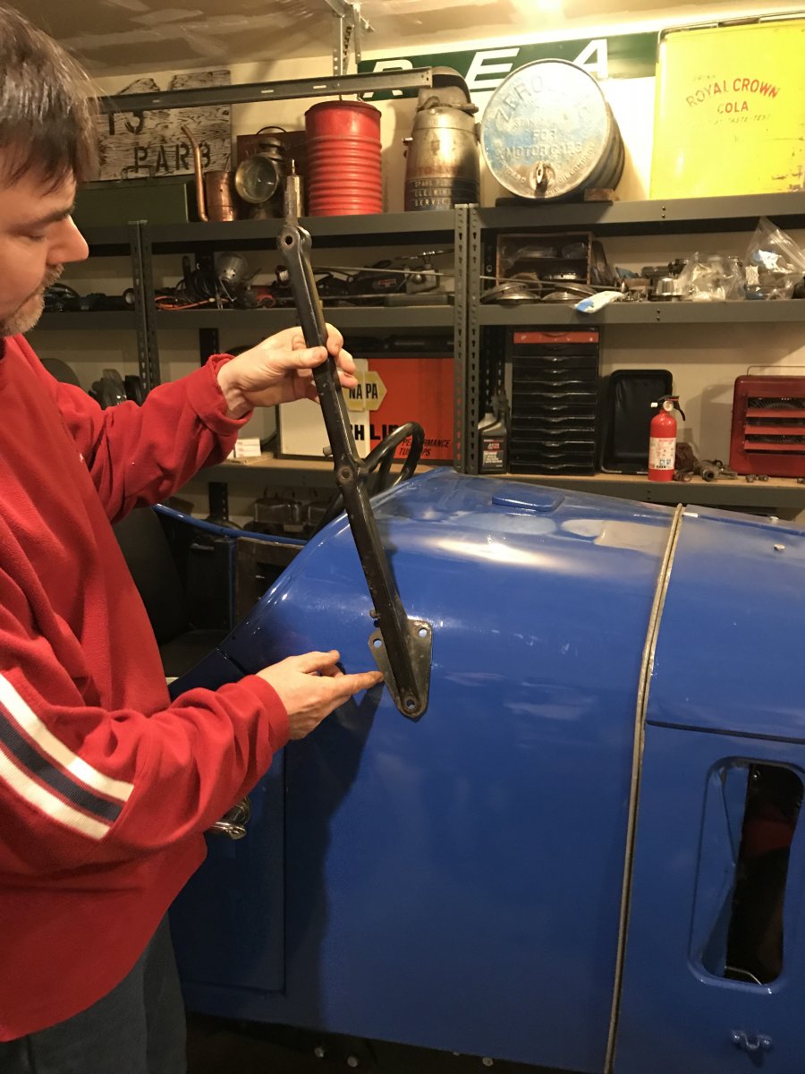

    I’ve been noodling on the windshield for years. The homemade V-windshield the car came with is trash. As for finding originals, forget about it. Mercury-expert Jarvis tried tracking down some repop castings that are rumored to exist on my behalf, but no luck. He also offered to lend me an original set if I wanted to make copies.
    But truth be told, I don't think the originals fit the look I’m going for anyway. Too vertical and stubby. Also, they were noted for cracking. From what I’ve seen, a lot of speedster guys throw up their hands and use those little folding Brookland Aeroscreens. They technically do the job, with one major failing: They absolutely do not shield you from the wind.
    Over the years I’ve test-fit a number of possible stanchion solutions, including early Willys, late Model T and ‘32. The closest I came was a pair of nice chromed br*** boat stanchions from the early ‘50s. Looked decent with a nice rake, but required cutting large holes into the cowl and fabricating braces underneath.
    Then a set of really nice early Chevy stanchions popped up from a guy who’s currently pounding out a T roadster. For some stupid reason I’d always ***umed these would be similar to T stanchions, but looking at the pictures, I figured they were worth a shot. Success! Turns out that when rocked back in a nice rake, the curvature of the base is a darn-near perfect fit.
    I’ll need to bend the stanchions a hair to get them vertical, but they need to be shortened anyway so no big deal. I also have to create a narrow frame—for this, I picked ups some old ****py T frames from the Incredible Hitchhiker Parts Pile. Between this and the Chev frame that came with the stanchions, I think I can piece something together.
    Next step is to measure placement, then grit my teeth and drill into that nicely painted cowl.

    Right on, Bob! Lot's of tape to plot it out and protect the paint. If you look close at the picture where I'm holding the stanchion, you can see I even put blue tape on the bottom of the stanchion to help prevent scratching just while taking this picture.

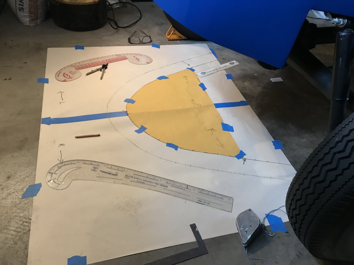

    I’ve put a lot of work into that tail section and want to do something to prevent minor dings, at the very least. These cars didn’t have rear bumpers, and the sole protection was the spare hanging off the tail. This was fine when running skinny lightweight buffalo wires, but a fat 16-inch rim and tire is too much weight to have bouncing around on a tail section that extends 2 feet from the frame.
    I'm experimenting with fabricating a hoop-style bumper out of 5/8 bar, same as the material used on my homemade front spreader. My thinking is to mount it to either side of the frame, and add a center support piece running from the cross-member (i.e. at the high center of the spring) down under the trunk and joining the hoop at the rear. Yeah, kinda weird, but best I can come up with.
    I started with the template I’d made for the trunk floor, which I’d thankfully saved, and plumb bobbed around the tail section to get it positioned right. Then expanded the radius 3 inches.
    Transferred this to a form and screwed it to my workbench.
    Next step, try to bend 5/8 rod around the form, doing my darndest not to catch the workbench on fire. As you can imagine, this was hopeless by hand when cold, so I used Oxy/Acc and rosebud tip to heat the bar one section at a time. Encountered some problems, ran out of Oxy, and put a couple awkward kinks in it. Here’s mockup of where I am now:
    Full disclosure: I am prepared to have this fail. Won't be my first or last waste of time if it does. The hoop extends 2.5 feet from its side mounts and may not be sufficiently stable, even with a center support. Also, heating and bending in a series of p***es is not giving me a perfect compound curve—I’m sure some guys could manage it, but I **** (the pic shows the “good” side; the other is embarrasing and I’m going to mess with it some more).
    I consider this an exercise in proving the concept: if it works, I’ll run it in paint for a while and maybe talk to a fabricator about copying it at a quality worthy of plating. Or maybe try my hand with a pipe and a tubing bender. But in the meantime, at least this will provide a little protection back there, and also give me better options for positioning the license plate.
