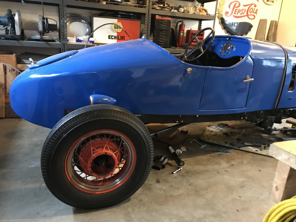

    Ha! You joke, Bob, but I may end up approaching an ornamental ironworks outfit near my brother's shop. Not that far off from a farrier.
    Yeah, that's kinda the idea. Seems to me those are usually two parallel hoopes tied together, with four mount points. Trying to figure out where I might mount a second hoop. Maybe the crossmember. Like a lot of things, I'm making this up as I go along, so suggestions welcome.

    I really want one of those Fatman steering wheels for my T, if the center wasn't messed up, would it bolt right onto a Model A steering shaft? Also, what's the going rate for a decent one? I'd be very curious to know.
    Also, just a thought, but stock Model A Ford rear bumper brackets could be turned upside down and mounted so they step up from the frame instead of down, and the stock bumpers have a nice curve in them on each end, could cut and weld a set into a V shape and mount that on the rear. Not sure if that's the look you're going for but it's a thought.
    I like the look of your windshield posts too, good angle and good period-looking stands. Those little half-moon ones are kinda racy looking but are about useless, I think a proper windshield like the one you're building is a good idea.
    Did you see the Mercury body for a T that sold on eBay a few weeks ago? Can't be too many getting bought and sold regularly.

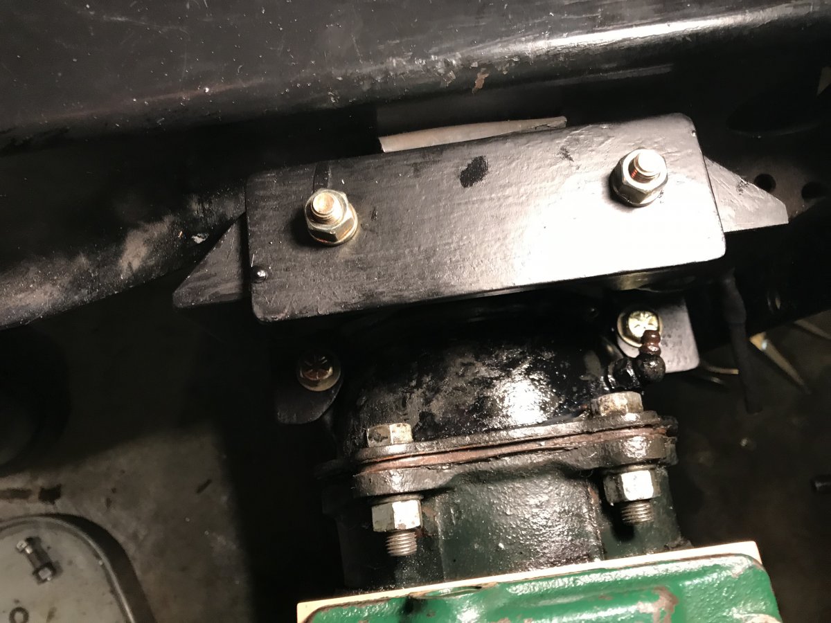

    I'll start with the transmission upgrade. For the record, this '39 trans conversion is NOT a simple bolt-in operation. To be fair, I’m not using a modern Cling’s kit. I’m using a period Ansen adaptor that came with only a portion of its original brackets. Any instructions it might have once had were used long ago to wipe oil off a dipstick. I expect the Cling’s kit (with instructions) is a far superior experience, and the woes listed below won’t apply.
    Things started fine. Installed the lightened flywheel (thanks @Hitchhiker) and new clutch from Mac’s. The clutch was in serious need of balancing—the machine shop ended up welding a large nut on it to make it right. Afterward they informed me it was a metric nut. I feel this is wrong. :oops:
    Adaptor and trans went in fine, but then troubles began. First, the universal joint housing wouldn’t fit. Hunted around online and learned you can’t reuse the Model A universal clamshell, you need one off a V8. Solved that with a late-night visit to Hitchhiker. Two of the pieces I needed where on either side of his garage, the third was in his yard. Man, he is overrun with early Ford parts.
    OK, got that in and reinstalled the rear end, so far so good. Now, my car has a Float-a-Motor—it’s a kit that adds rubber bushings to the two rear engine mounts. There’s also a third part that braces the transmission to the frame cross-member—as near as I can tell this isn’t so much for support, but to prevent the back of the trans from dipping and causing clutch chatter.
    Well it turns out the Model A universal housing is wider than the V8 housing. So my existing Float-a-Motor rear bracket no longer fit. It’s a delicate little aluminum thing and I couldn't see any way of adapting it. I searched online but could not find a V8 version anywhere--new, used or even just mentioned. I know they exist because Hitchhiker has one in the hoard (of course he does), but he’s already earmarked it for the roadster he’s building for @Wallingford Noah.
    So I would up making one. Shown is the elegant original on the right, and my ugly bruiser on the left.
    It'll do.
