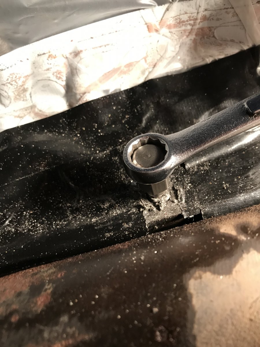

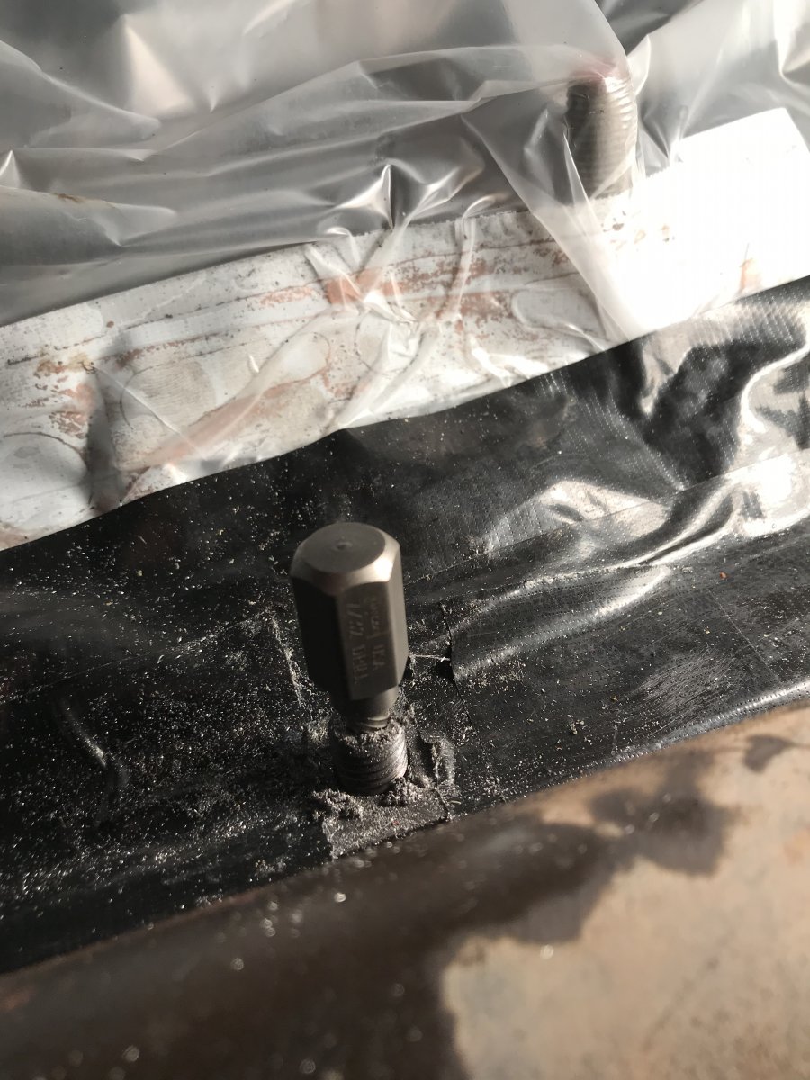

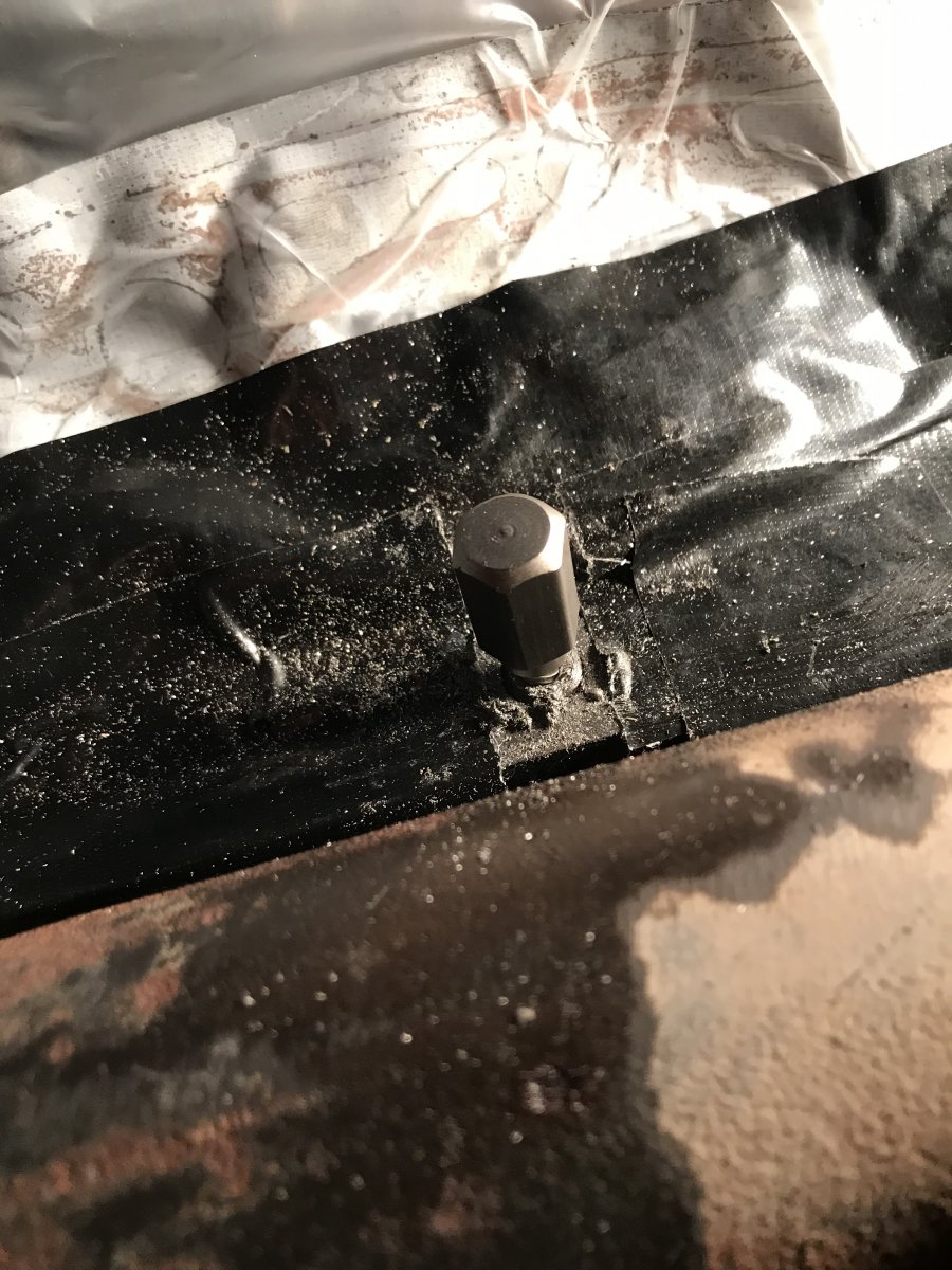

    Huge shout-out to my brother Ric (greatest brother ever), who showed up this evening after work with drill bits and carbide burrs. He quickly reconfirmed that the bits weren't goint to cut it (literally), and then went at it with the carbide burrs. I was hoping it was just hardened at the top, but it was hard the whole way through. Took an hour and a half to get about half-way through the thing, pausing periodically to let my ****py estate-sale dremel cool off. Eventually the dremel broke, at which point we decided to go for broke: We tapped the extractor in with a hammer, said a prayer to god of Easy Out, and started working it. Apparently all that heat cycling was good for something, because it spun right out.
    That first turn of the wrench was such a happy sight! Thanks agin, bro!
    I also want to thank Homemade44 here, who spent half an hour on the phone with me this morning, sharing his metalurgical insights and talking me off the ledge. He gave me faith this thing could be beaten. Thank you, Joe.

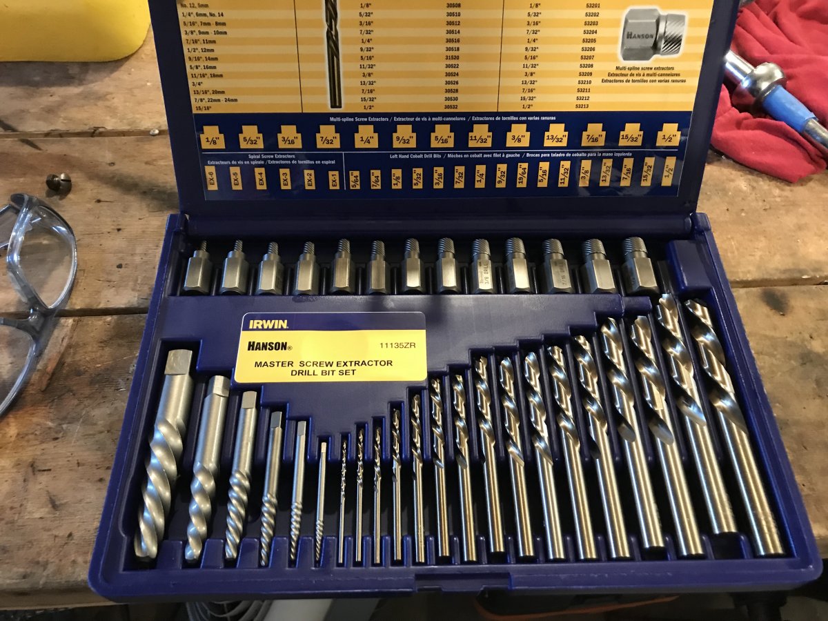

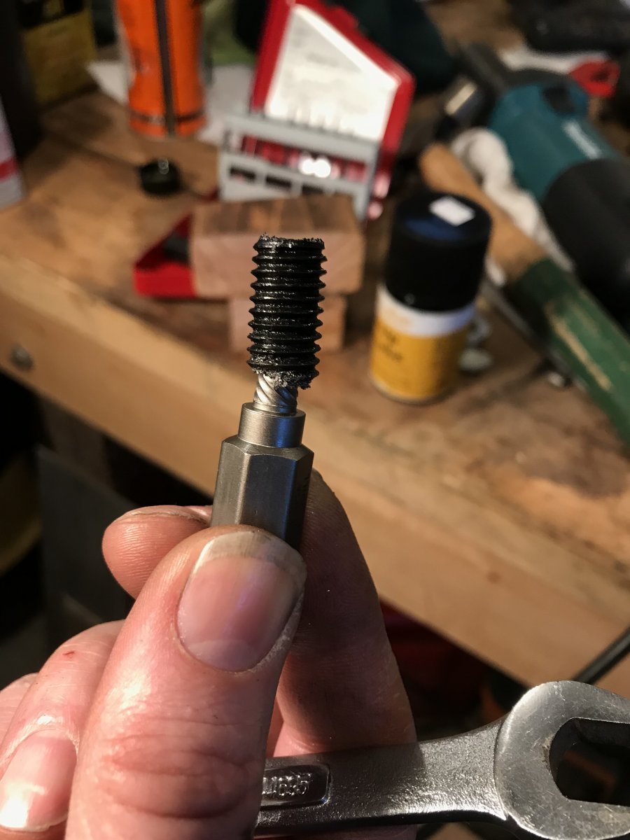

    That bit was one of 13 that came with the Irwin Hanson extractor kit ($100 on Amazon), sized 1/8" to 1/2". They call them "multi spline screw extractors." Beefier than a regular easy out, with a hex head you use a wrench on. See the back row.

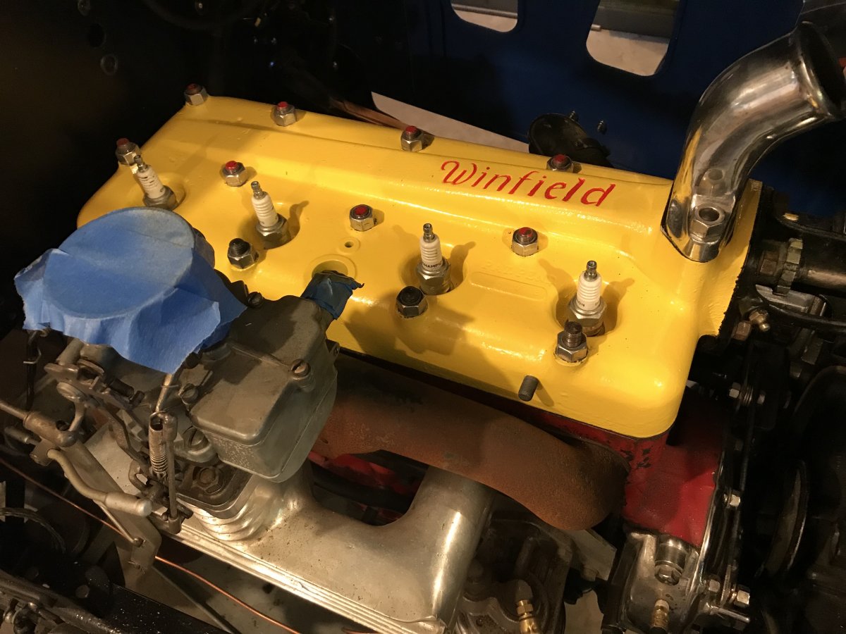

    Some progress, at any rate.
    Discovered that one stud hole had been drilled out and re-tapped. So I’m not the first to have issues with studs seizing in this block.
    Also, killing time while waiting to borrow my brother’s torque wrench, I got started smoothing out the pitted hood panels.

    Pretty sure you knew, and it has probably been covered in this thread
    but those bits in that extractor kit are left handed, they wont drill turning
    to the right.
