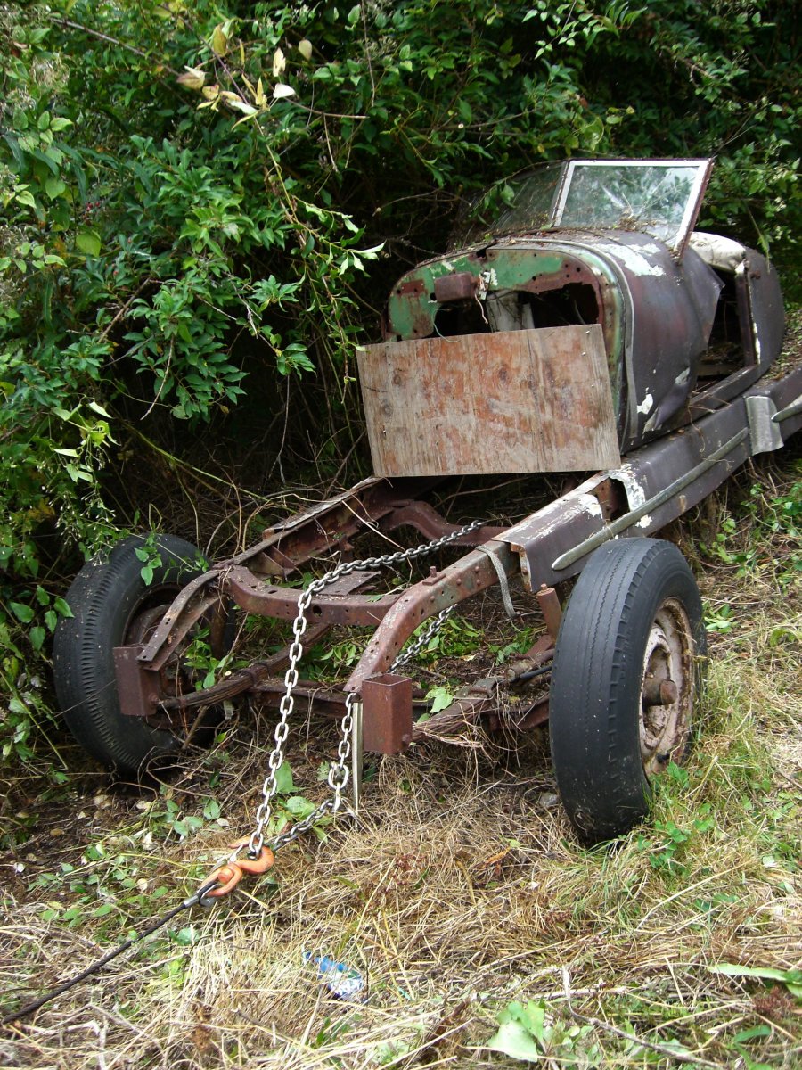

    This is the point where I’m supposed to explain my plans for the car. All along I had wanted to build a hot rod, but the discovery that I had come across something of a rare bird threw me for a loop. I spent many evenings staring at the thing and wondering if it didn’t deserve a more formal restoration. (This time wasn’t wasted however—I used it to take a welding cl***.)
    It was my wife who finally put everything into perspective. “I don’t want a museum piece,” she told me. “I want a car we can have fun with. And besides, I thought you wanted to build a hot rod.”
    My wife is very smart.
    So this will be a hot-rod speedster, if there is such a thing. I’ll keep some of the original builder’s cooler touches—like the hood—while repairing much of the damage he inflicted. It will be era-correct, more or less. I envision a car somebody could have built in the late ‘40s or early ‘50s—as the original builder did—to emulate the Indy/Champ/Racecar look.
    I should also warn everyone right now that this will not be one of those threads that dazzle you with stunning metal work and meticulous welds. I am not Flop. :D When I started this project I had never welded or done bodywork in my life, and my fabrication experience was limited to a few simple brackets hack-sawed from angle iron. Bringing this car back required a steep learning curve, and the HAMB was my primary resource. I’m pretty proud of the results, and feel I’m doing the car justice. But the best I can aspire to is “competent.”

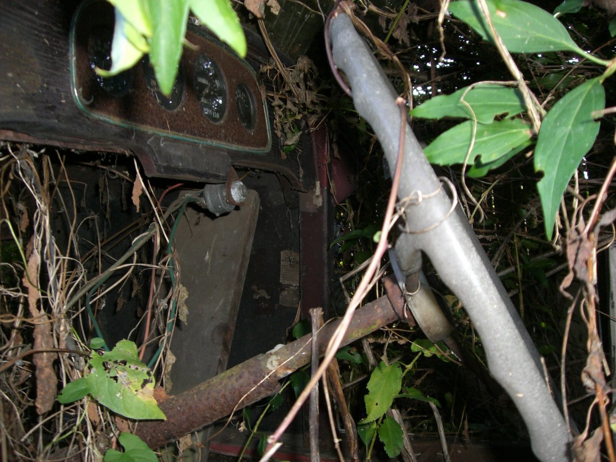

    I'm including this image just because: I felt like a Central American explorer discovering a Mayan ruin.

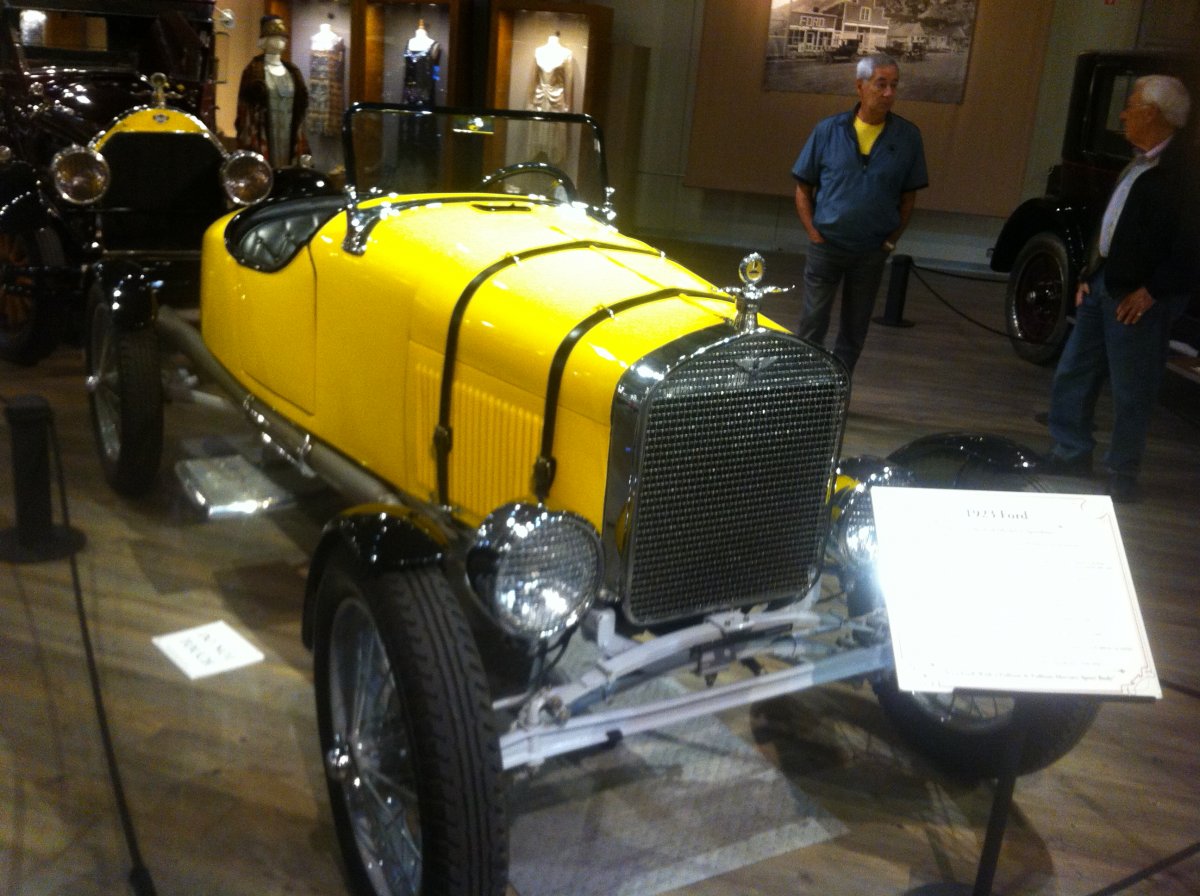

    Model T Ford W/ M 027.JPG ercury body...
    Outback likes this.
  12. The37Kid
    Joined: Apr 30, 2004
    Posts: 32,496
    The37Kid
    Bob is that Mercury in Alaska now? There was one here on the East Coast, a nice older restoration that sold to someone in the PNW and had its original Mercury fenders and Buffalo wires removed and added to another out there, wonder if this is the same car? Bob

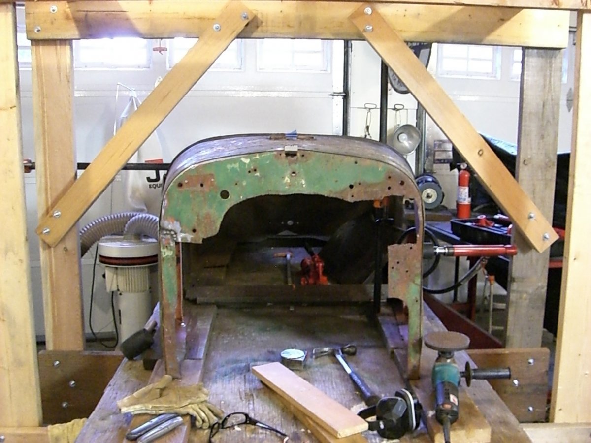

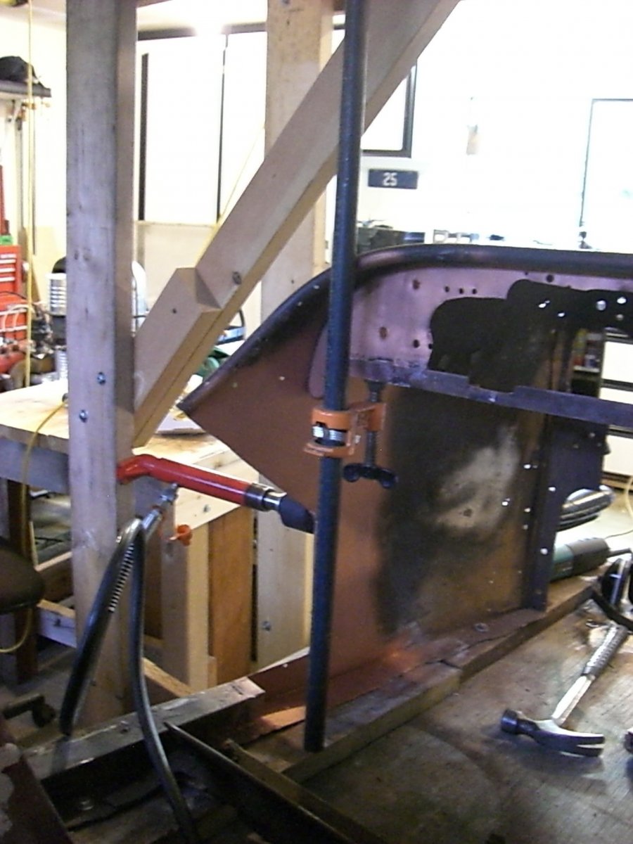

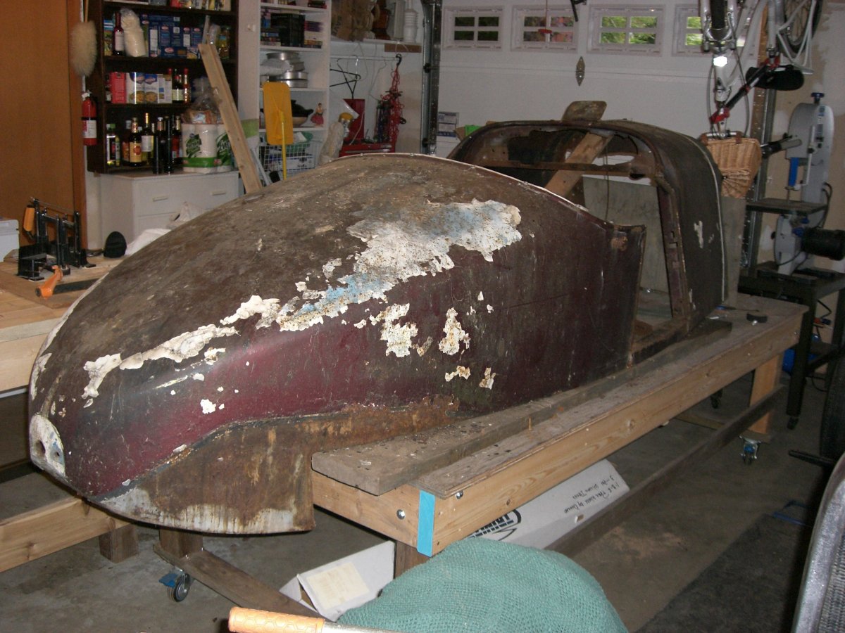

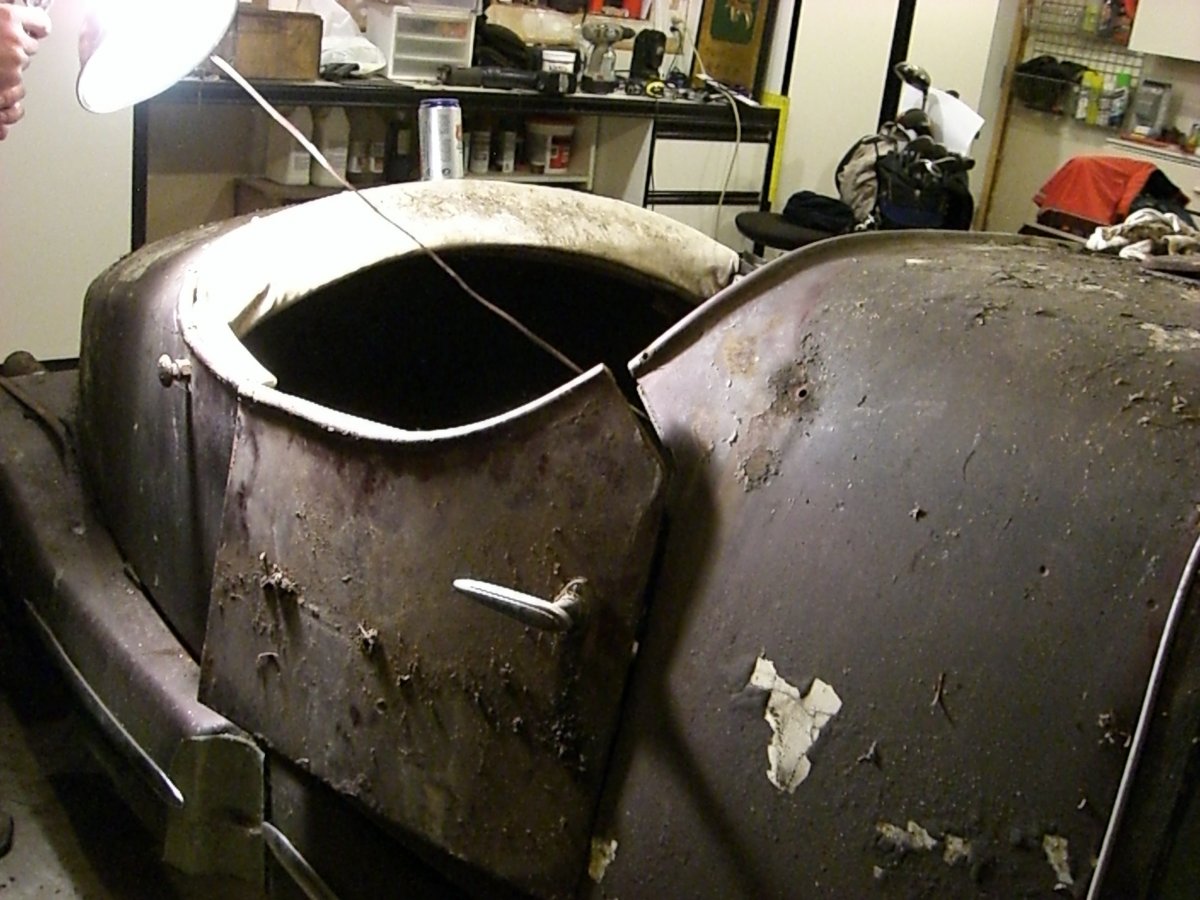

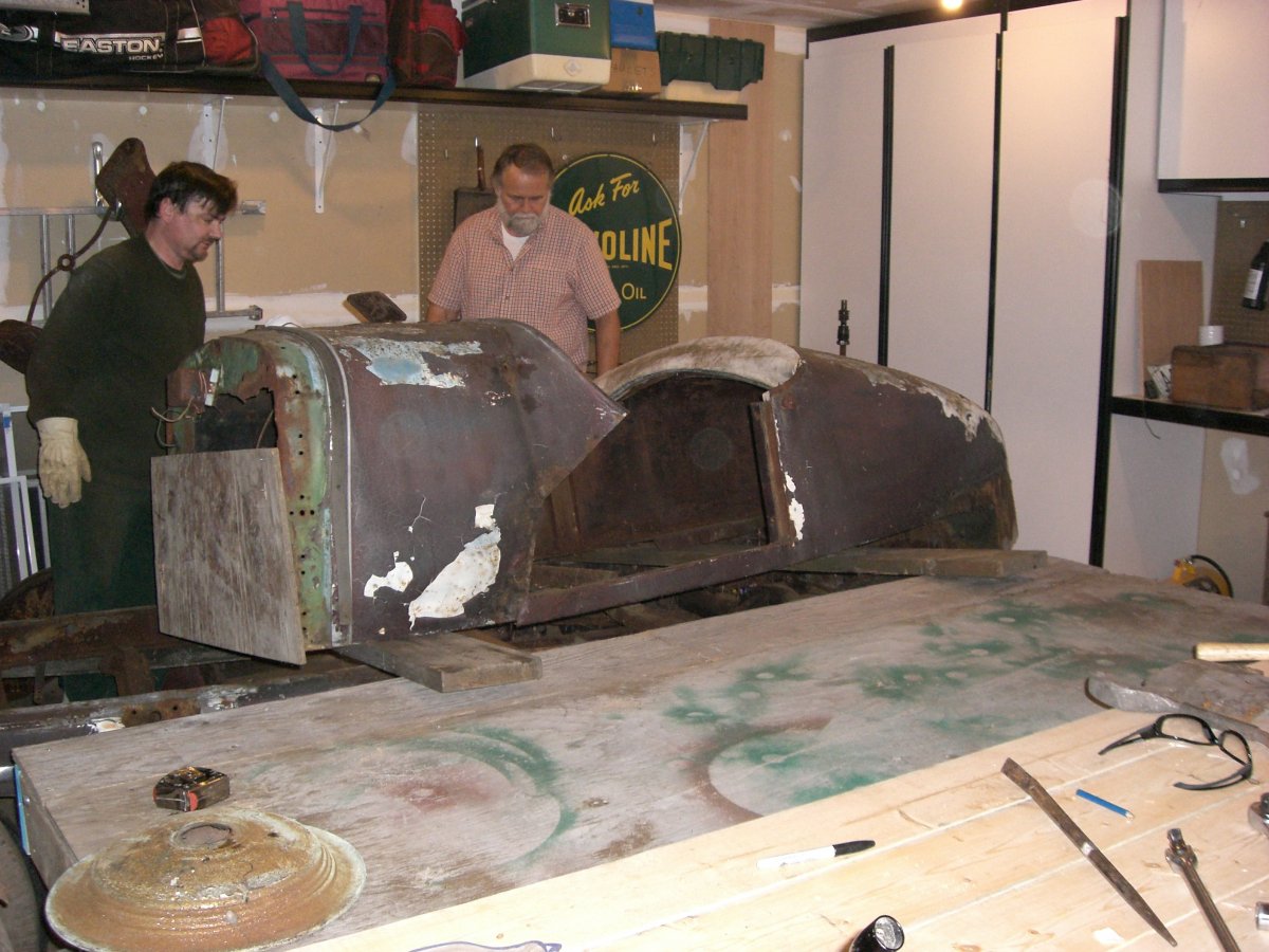

    To get started, I stripped all the components off the body and built a rolling work platform. The body is all one piece and very light—two of us were able to transfer it easily.
    The biggest problem is obvious: the cowl is badly racked, and folded right in front of the driver’s door. This probably happened when the outbuilding it was stored in collapsed. These shots show how far off everything was (sorry about the kitchen overflow in the background—this was taken during a home remodel).
    Earlier, Bob/The37Kid asked about the doors. The driver’s door on this car was a later addition—these cars originally did not have doors. In 1923 a p***enger door was introduced, so the ladies could get in and out with more dignity, but they never had a driver’s door.
    When the body was cut for this car’s driver’s door, the only bracing added was a thin piece of wood for the forward door latch (they’re suicide doors). With the structural integrity compromised, everything buckled when the building fell, and then just continued to settle over time under the weight of the heavy homemade windshield and soggy bushes.
    My solution was to affix a large wooden framework to the platform, and use a portapower and pipe-clamps to pull the cowl back into shape. I’m keeping the driver’s door, so I put my new welding “skills” to work building an internal supporting framework out of square tubing to hold the cowl in place.

    Bob,the yellow Mercury is at the Fountainhead I do not know any of it's history.

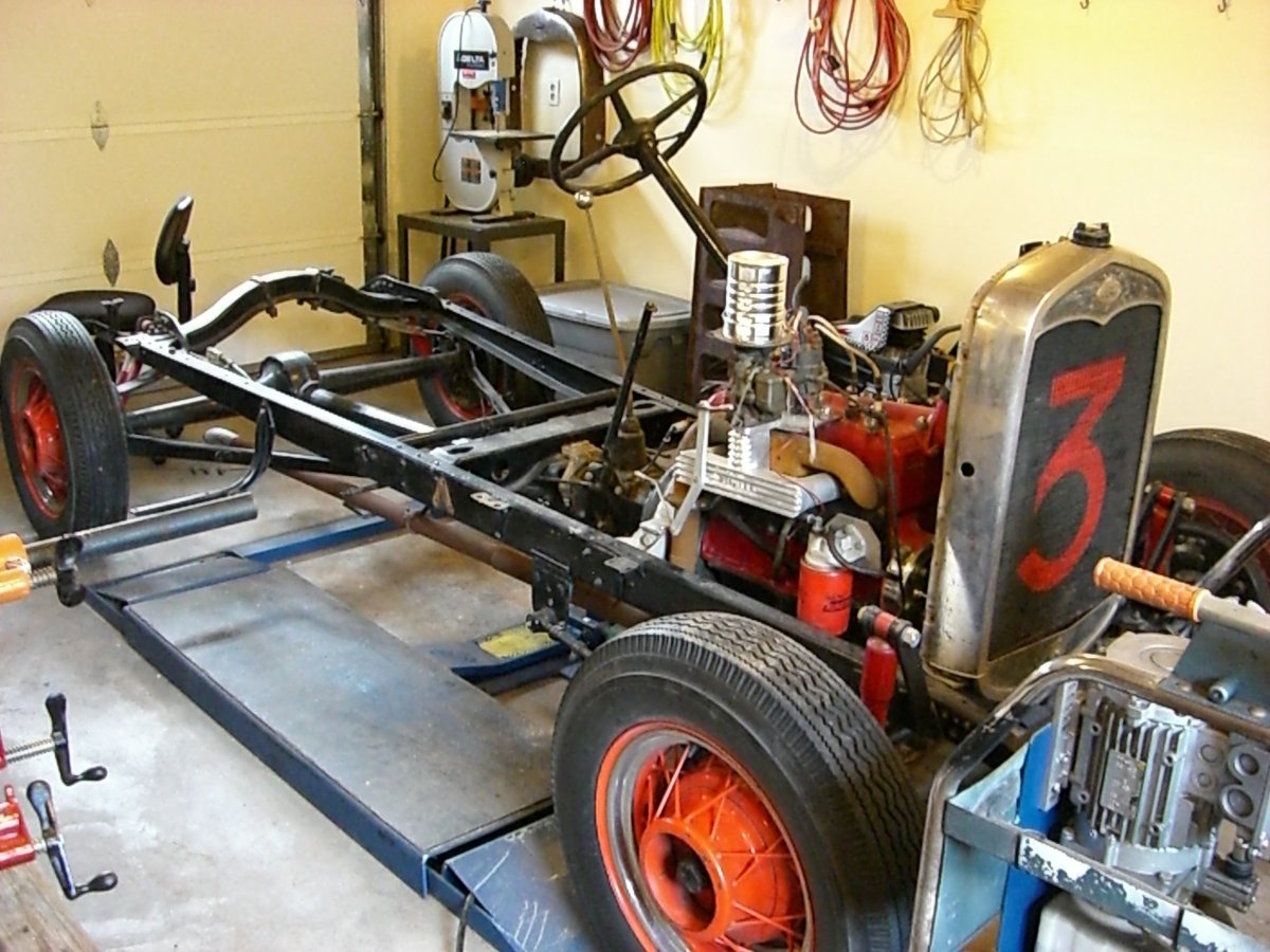

    Since several of you are expressing interest in the running gear, this is a good time to talk about the ch***is. While I was starting on bodywork, I kept looking over at the old ch***is in the next bay and wondering what to do. Although the ch***is looked like it might be Chevrolet (I’m not sure; the PO thought it was Willys), and I realized my car body might be a Chevrolet model (I didn’t yet know), I was quite sure this particular frame was not original to the car.
    Original or no, saving the frame would be a heroic undertaking, because it was a mess. For starters, it had square tubing welded the to the frame horns, to which the leaf springs were attached. I’m guessing this was to raise the nose. Has anybody here seen anything like this? It looked pretty sketchy to me.
    Also, if you look close, you’ll see that the central cross member appears to be welded under the frame rails. This was probably to accommodate the Plymouth 6-cylinder I’m told it once had.
    But worst of all, at some point a notch was cut out of the left frame rail to make room for a larger steering box, thereby turning the C-channel into L-channel. It ran that way for a long time, apparently, and frame had twisted so badly that I deemed it unusable. It went to s****.
    With that decided, I debated my options for a while—Model T, Chevrolet, etc.—before finally settling on the old dependable Model A ch***is. I found a good one on the HAMB. It was an older restoration in need of freshening up, but it had all the right stuff: ’39 brakes, split bones, ’35 wires, and a ’34 axel that gives it a nice “gentleman’s drop” stance. The banger had been warmed over a little—down draft carb, Model B head. Someday I’d like to find a period high-compression head, but that’s for the future.
    I have since learned that a number of these old Mercury Body Speedsters are now on Model A frames. So apparently it’s a common retrofit.
