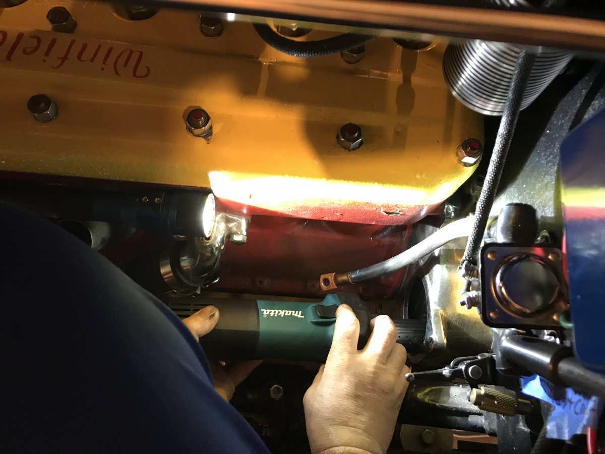

    At last, we’re ready to fire it up. Or so we thought. Turn on power, turn the key, push the starter…nothing. What the…? Battery is fully charged, a test shows power to the starter. ACME Auto Electric had tested that starter for me last year, but we pulled it anyway and it bench tested fine.
    So now we’re considering weird causes. We’d installed a lightened flywheel—did this change the starter dynamic somehow? Seemed unlikely. But wait—we’d also installed the trans adaptor. Took a light and peered through the starter hole. The adaptor has an indentation to accommodate the starter drive—and sure enough, we see fresh s****es on the aluminum. The starter drive was hanging up on the adaptor.
    This was no time for finesse. Out came the die grinder:
    Success! The starter turned, the car fired up, I was off to the show two days later.
    I guess technically using the die grinder counts as a shortcut. So the way I look at it, I was one for three on shortcuts. That’s a piss poor success rate.

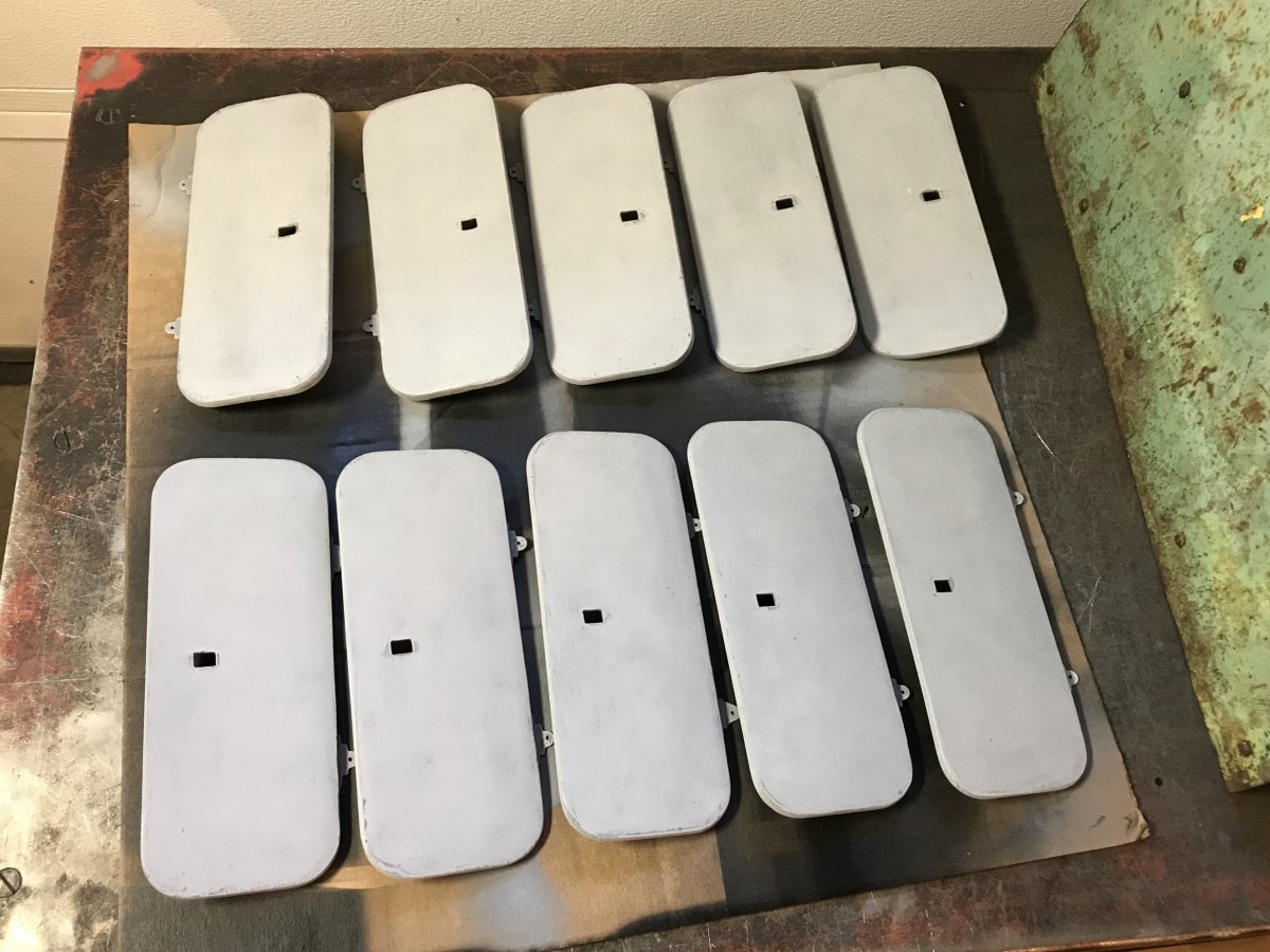

    In addition to being right, you are also psychic. I did my final sand of the panels only two days ago. Just a final clean/degrease left, and then wait for a good weather window for paint.
    I had some single-stage aerosolized. Figured it was simpler than dealing with my gun and compressor for a small job.

    I think the panels were all connected to a rod or some kind of mechanism at one time. But I don't have those componets. All I have is the springs and clips that came with the car in a Mason jar. They're useless without the rest of the mechanism--they don't positively affix the panels to the hood.
    I'm going with a simple solution. I made a set of brakets out of stainless, and I'll use these to positively affix each panel to the hood in the same partially open postion. I'll bend-and-fit one at a time. Means drilling a small hole in the hood for each, but they'll be hidden.
    I also drilled a small hole in each of the forward tabs for safety wire. So they'll each have three connection points (two tabs front, bracket rear). The holes were also handy for hanging the panels while I painted them.
    I'm fine with having the panels in a fixed postion. I doubt I would have ever used an adjustment feature anyway. No different than louvers in that regard.

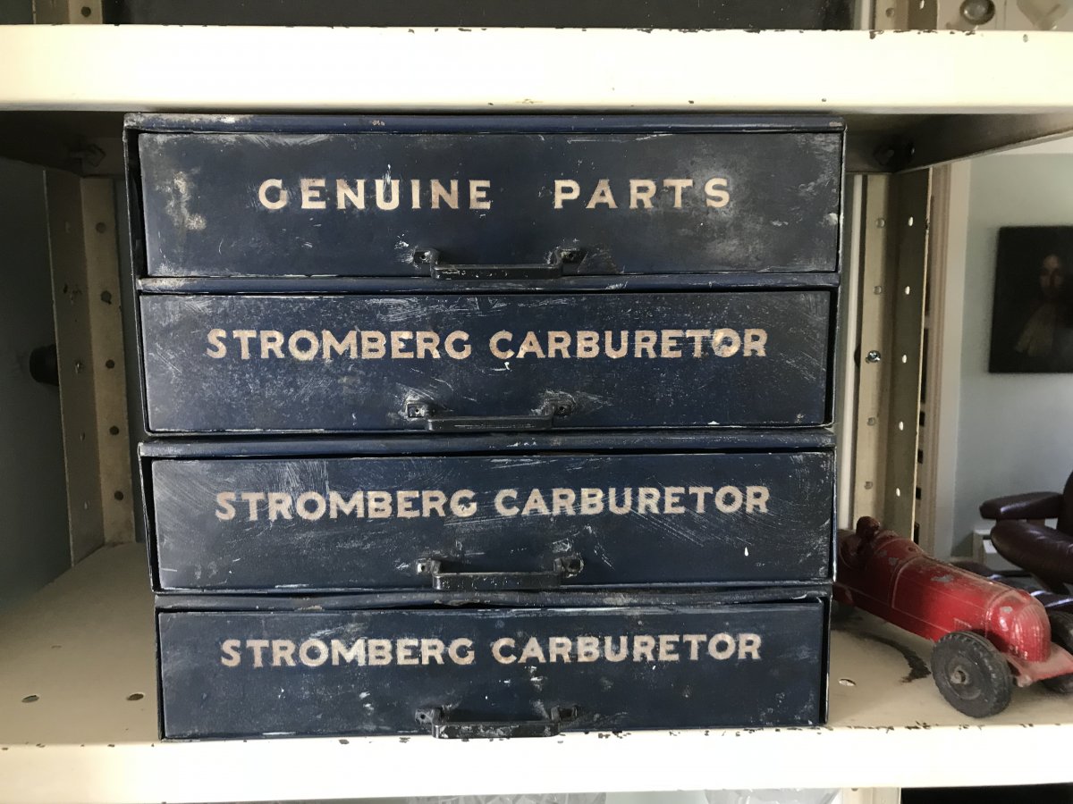

    This is another of those small serendipitous victories. Two years ago my wife and I stopped at a shop on the Olympic Pennisula, where I found this:
    I just bought it for the look--I mean, how could I p*** up a Stromberg advertising piece? Looks great in my office. But it was also full of random parts--some new, some used, a mishmash. I checked, and sure enough there were several accellerator pumps in it, one of which seemed to be slighly larger. We put it in, and it works great! Go figure.

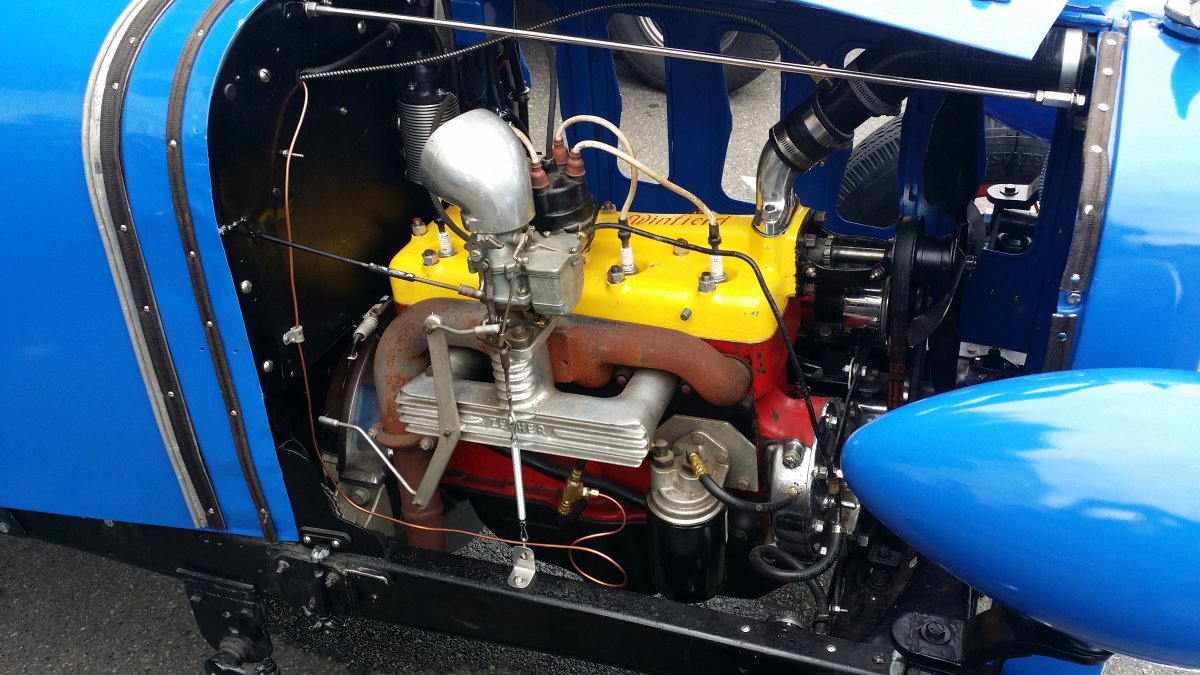

    Been having a blast with the thing. I did a series of 5-to-10 mile test drives, all in close proximity to my trailer just in case a rescue was called for. After each run I nut-and-bolted the whole thing to see if anything'd come loose. So far no surprises, and she hasn't skipped a beat. (Knock on wood.) Made my peace with a few paint chips--that's the price you pay to drive them.
    Only issue so far is I lose around a third of a gallon of coolant on every run. It's coming out the overflow. Nevertheless, it runs fine and does not seem overly hot (I don't yet have a functional temp gauge--long story.) It might be that I'm overfilling the radiator--I've had a couple guys tell me this can happen if you top it up too far. On the other hand, perhaps it's running hot--my fan is 6 inches behind the radiator and no shroud. But this was all country road driving with minimal stops. Wouldn't think that would be an issue. Any thoughts?
    That's the Porter muffler and relatively low speed. I'm very happy with it. She's got a nice rumble when you get on it. The video was shot on Semiahmoo Spit, speed limit 25 mph. Essentially the corner of the country--you're looking at White Rock, British Columbia on the other side. In this car's heyday there would have been rum runners plying those waters.

    How did your fan end up so far from the radiator??? It's very easy to overfill an A engine and it's also very common to let them find their own coolant level. I suspect you are topping it off which you don't need to do.
    I just measured the fan to radiator on my 30 victoria and it is 1" off the radiator.

    Thanks, this is encouraging! I was hoping "finding its own coolant level" might be the answer. To your question, I moved the radiator forward 5 inches and down 3 to accommodate the extra long and low hood/cowl comination.

    OK now I understand. You really need to get a temperature gauge on it to monitor it properly but I would think a fan shroud is in your future. From the looks of your work and fabricating skills exhibited in this thread you probably won't have any issue making one.

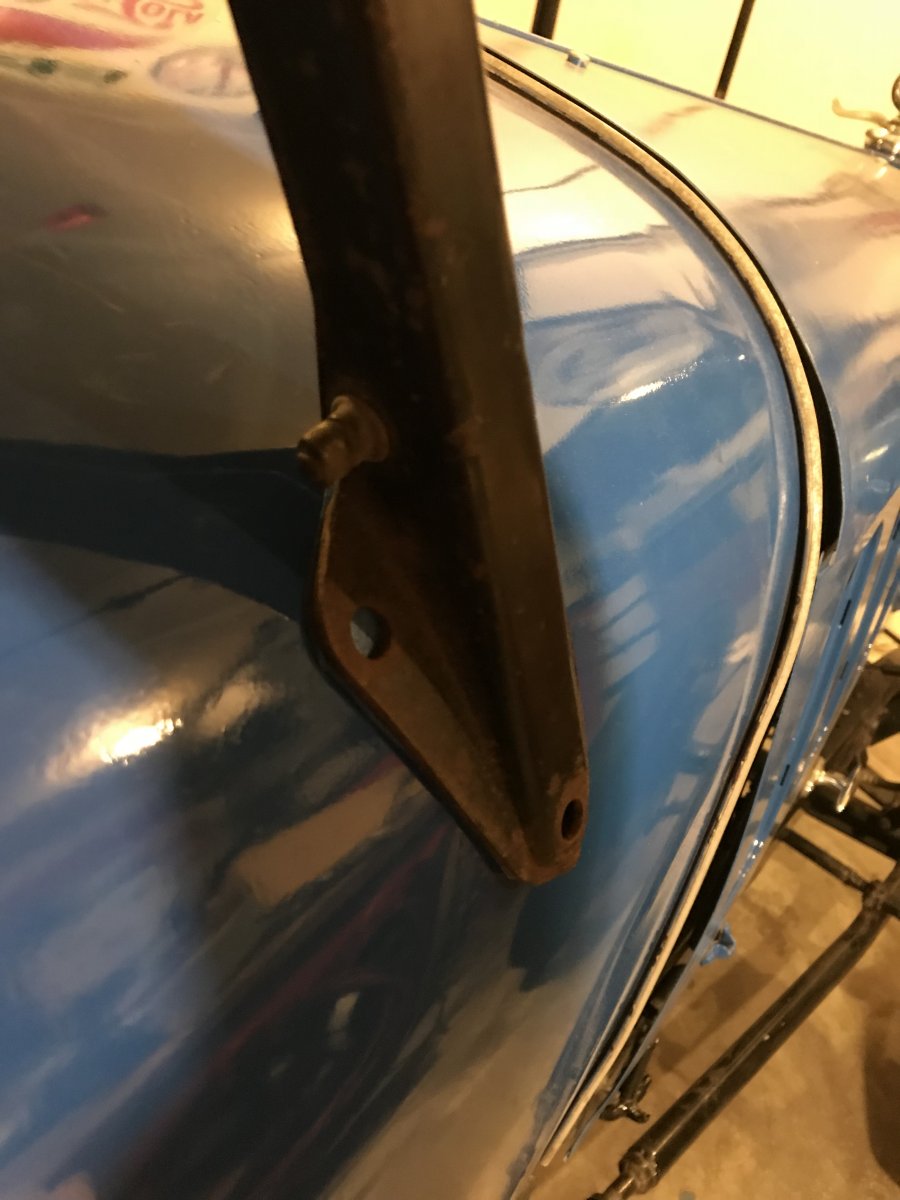

    Funny you should ask, because once again I've started mulling over windshield options again, and I was preparing to throw it out here for discussion.
    To refresh everyone's memory, the car orginally came with a homemade DuVall style windsheild, as seen here:
    It had been gas welded and chromed, but the chrome was shot and at some point somebody drilled it to add big ugly stainless retainers. I thought it was kind of odd, and dismissed it. For a time I debated theose little fold-down Aeroscreens like you see on Bugattis--on the plus side, easy to add. On the negative side, I'm told they don't shield the wind very well, AND you can't affix a top to them.
    Then I discovered that the curvature of the base of '27 Chev roadster posts is a perfect fit for my cowl.
    That seemed to settle it. Would still mean a lot of work becasue the posts need to be chopped and bent to vertical, and then a custom frame will need to be fabricated. Nevertheless, I figured this was the way to go.
    But then last month some lucky dude pulls a cool old speedster from out of the kudzu in North Carolina, and I'll be danged ifthe windshield isn't a dead ringer for the one mine came with. Check it out:
    Well, I dont' need to tell you, that thing's cool as all get out! So now I'm rethinking my original windshield. Maybe it's more "period" than I gave it credit for. I'll dig it out of the shed later and post a picture. Be interesting to hear what people think.

    I also lost coolant out the overflow until I went with a smaller crank pulley. That slowed the pump and problem solved.
