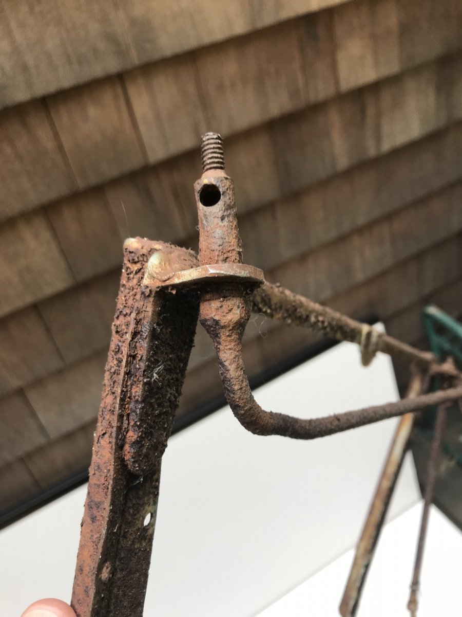

    I completely agree. I've spent 8 years trying to convince myself those Aeroscreens would be OK and could neverbring myself to do it. They're fine on a Bugatti or Jag, but just not right for this car.
    I dug out the original windshield frame and gave it a good hard look. Here it is:
    As you can see, it's designed to have the gl*** rest directly on the cowl (with a rubber seal, obviosly). A close inspection shows that underneath all the rust and failed chrome, it's actually really well made. Here are some close ups (brace yourselves for more images of rusty steel than even a Hamber might want).
    Nice detail at the top of the center piece:
    Side post bases built up to match the curvature of the cowl (this is the bad side where the stud broke off; other side came apart clean):
    Visors nicely incorporated on both sides; I'd probably get rid of these, but keep the brackets as a provision for a top. By the way you can see a littel wiggle here that needs to be corrected, remnant of the ****ed cowl damage--otherwise it's straght:
    Secondary center support nicely flared on either end (ignore the busted up mirror bracket at the top):
    Anyway, you get the idea. If I didn't know any better, I'd think maybe someone adapted an existing windshield frame. The more I look at it, the more I wonder if I can't save it.
    Trouble is, I know what my options are because I just went through this with my hood side panels. I could pay a LOT for a full restoration and rechrome, or I can pay sort-of-a-lot to have the old chrome and rust stripped off, then spend hours filling the pits with all metal before finally painting the thing... and then spend the next decade wishing it was chromed. :confused:
    But against this, I have the fact that it would be easy to install. I only filled the holes on the side of the cowl, which would be easy to redrill. I did not fill the holes for the center supports, because they were too close to lead work that I did not want to risk messing up. Figured I'd repurpose those holes for a mirror or something. Like the orginal windshield, maybe?
    Anther issue is the kind of ugly stainless covers--they thru-bolt to the frame for holding the gl*** in.
    I wonder if these were added by somebody after the fact. They do not have the same elegance as the frame.

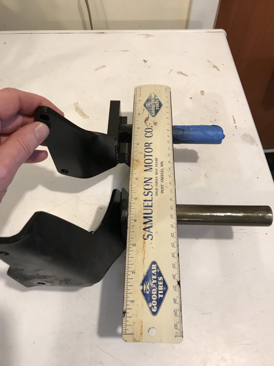

    So after yesterday’s historic digression, it’s back to the speedster. Like I said, a lot of issues identified themselves as I drove the car last summer. Key a**** them was the transmission conversion.

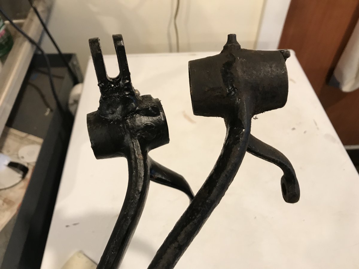

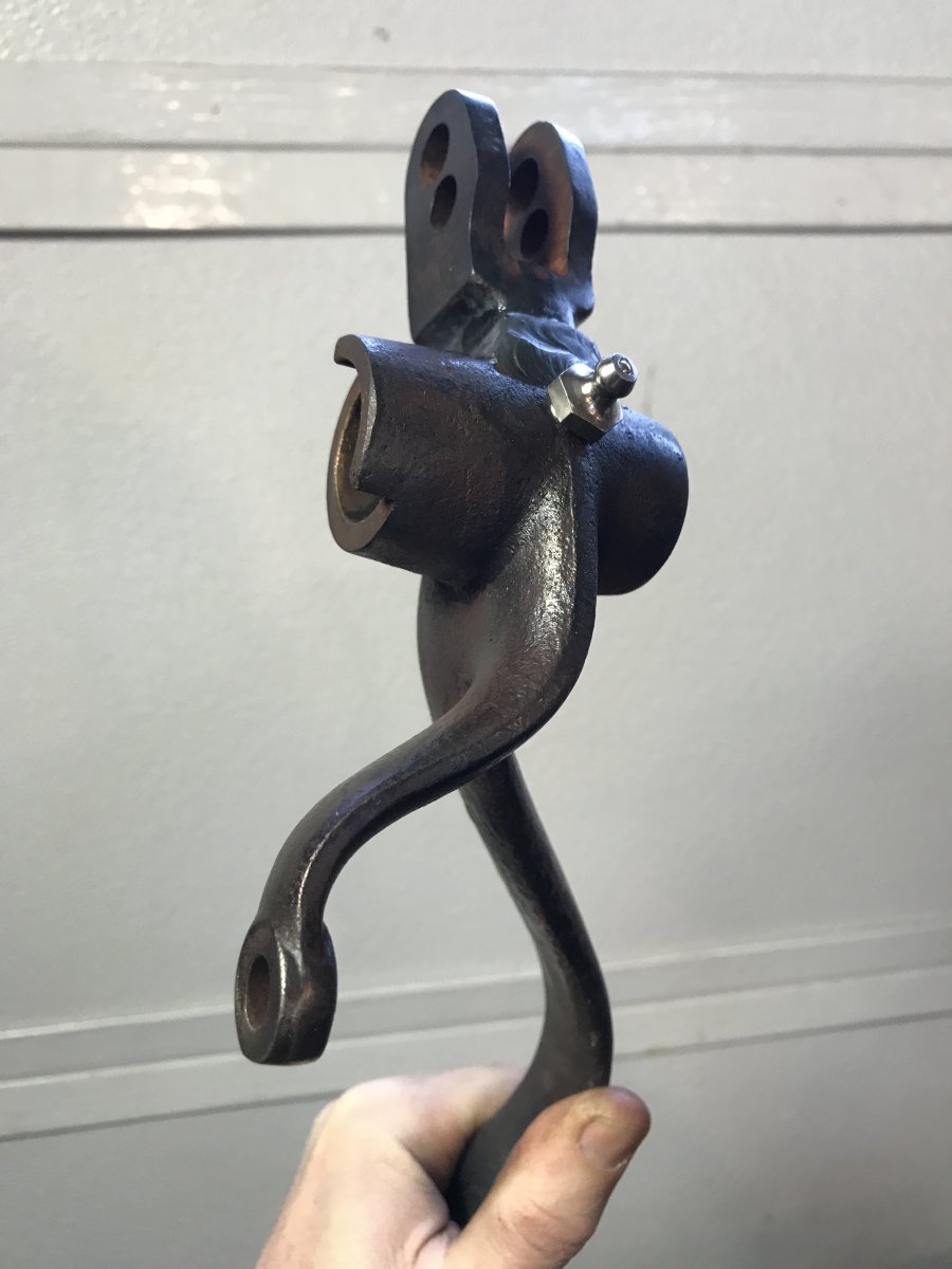

    I love the ’39 transmission I installed with the vintage Ansen adaptor. But I’m not comfortable with the funky clutch and brake pedal system it came with. These adaptors have a secondary mount for the pedals—it attaches to the bell housing and transmissions top. The Ansen adaptor oriented the pedals considerably differently than stock—moved both pedals 5/8” to the left, to be exact.
    I’m guessing maybe alignment was less of an issue with stock Model A. Mechanical brakes still connect, clutch still works, no big deal, right? But my configuration isn’t stock, and that extra 5/8” put the brake pedal out of alignment with the master cylinder, and also created interference with my lowered steering column. Meanwhile, the clutch couldn’t depress fully without hitting the cowl side. (Yes, it’s that tight in there.)
    As shown earlier in the thread, I solved these problems initially by grinding down the barrel of the brake pedal to make everything line up, removing the factory backstop in the process. I rigged up a stop on the floor. Everything worked, but seemed hokey.
    My bigger concern was the flex I was getting out of the pedal shaft. Even with the brace I made for it, depressing the clutch would deflect the pedal shaft half an inch or more. I’m guessing this is probably OK, but thoughts of metal fatigue danced in my head every time I drove it. If it was the just the clutch, I wouldn’t worry—worst case the pedal falls off and I can’t shift. But the brake pedal rides on the shaft as well. Not stopping is a far bigger concern than not going.
    OK, it wasn’t as sketchy as this brake setup posted by @klawockvet on the Wall of Shame. But I couldn’t live with it, and last fall I bought a new pedal adaptor from Cling’s. Right away I could see it’s a well-made and much sturdier unit. And, as shown below, it looks to be aligned properly.
    Above: With the mount holes of both adaptors lined up, the ruler shows the difference. The Cling’s adaptor is on top. Not surprisingly, this measurement corresponds to what I ground off the pedal:
    Above: My ground-down pedal on left, with its provision for master cylinder. Unmolested stock pedal is on right.
    So this should work and I’m happy… or am I?

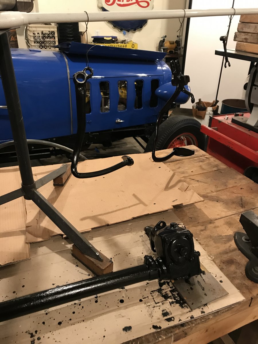

    As I intimated a couple days ago in my cheesy cliffhanger, there’s more things I should do to the car while I’m at it. Chief a**** them is the steering box. And yes, I’ll admit right away that a steering box conversion is pretty rudimentary stuff for a Hamb crowd accustomed to, say, Flop's latest wonder. But maybe you’ll find it interesting.

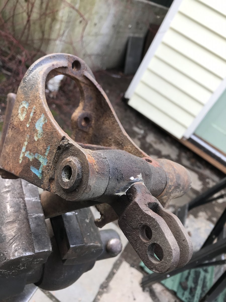

    A lot of people say the stock Model A steering box is a piece of ****. Last summer I learned a lot of people are right. Heavy, leaky and binding (insert your favorite mother-in-law joke here), there’s not much to say for them other than that they fit into the stock frame and more or less turn the car.
    Two years ago I bought an F-1 column and box from @Chris. I’m glad I got it when I did, because if you’ve been watching his posts recently, Chris is on the verge of cornering the market for ‘50s Ford trucks and parts across the entire Pacific Northwest Region. Soon we’ll all be at his mercy.
    Anyway, the thing has been hanging from my garage rafters ever since, taunting me. With the floor and pedals out and me full of energy, I figure now is the time.
    I’m using the Tardel method—cut the snout off the F-1 box, cut the snout off a Model A box, and weld the two together. I’m doing this because it seems relatively easy and won’t compromise the frame. (If the car wasn’t already ***embled and I was dealing with a bare ch***is, I might do it differently.)
    Now, a quick aside on my neighborhood. A great thing about Seattle’s Ballard area is that even though it’s rapidly being taken over by hipsters and software engineers, there’s still a lot of great industry located here. The wrecking yards are gone, but we still have repair shops, machine shops, fitting shops, powder coaters, welders and equipment suppliers,. Oh, and Bardahl. Man, I always get a kick out of driving by the Bardahl plant. (Ole Bardahl frequented the gas station I worked at as a kid.)
    Anyway, a little before Christmas I took my F-1 and Model A boxes into the machine shop down the street from Bardahl. They did it while I waited, and I got to watch and talk old cars with the machinist. (7 dizzying seconds follow.)
    For a couple extra bucks, he cut a provision into the Model A snout for a sector shaft seal. No more leaks! (Or less leaks, at any rate.)
    Next step was to mock up the two halves for fitment in the car. This is where I discover the steering column is now hitting the dash.
    The shaft comes out of the bottom of an F-1 box, whereas the it comes out of the top of a Model A box. So everything got reoriented. I supposed I could have avoided this by using an F-100 box, where the shaft comes out the top, but I didn’t have one. And I expect Chris is hoarding them all by now, anyway.
    I was preparing to make a new column drop when @Hitchhiker reminded me you can get extensions for these. Well, having just learned my lesson about trying to fabricate parts that are already avialable, I got one from Limeworks.
    I fear this means my car now sports a dreaded piece of billet, but it will be hidden by semigloss black. Here’s where the upper column rests now.
    I got to this point a week or so ago. I figured there was no point to trying to find a welder Christmas week. I spent yesterday bending a new set of clutch and brake pedals to fit. Sorry, no “in-process” pictures; I was working outside with the torch and it was raining and miserable. Here’s where I am now. It’s a tight fit, but they'll clear.

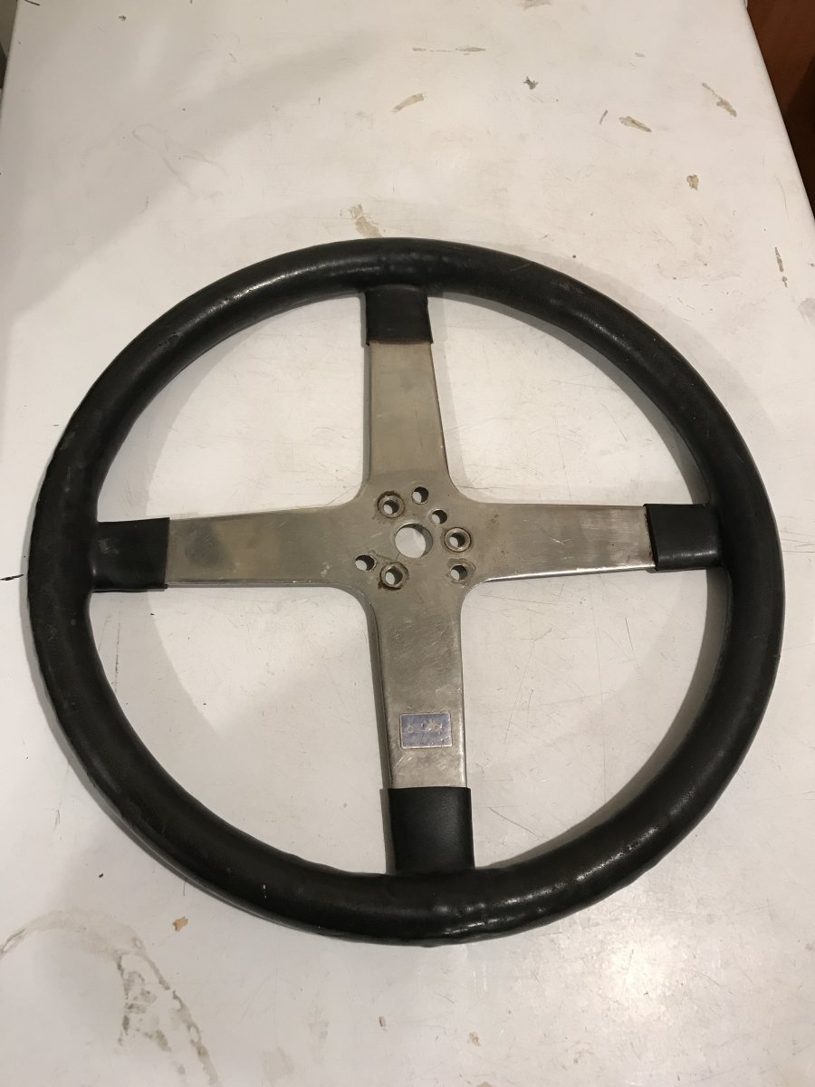

    Another upgrade motivator is that I need a smaller steering wheel, and I’m hoping the later box will help compensate for the loss of mechanical advantage. The 17” stock wheel proved to be a knuckle-buster on this small car. I’m looking to use this old 14.5” Schroeder I got from @JWindsor13.

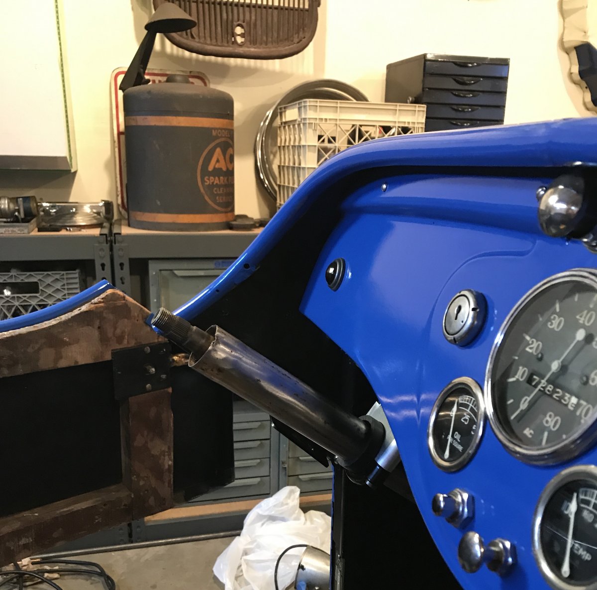

    How does the length compare between the F-1 and Model A column you were using? I have an A box/column in my T and the box is ****, was thinking of doing what you're doing.
  19. ClarkH
    Joined: Jul 21, 2010
    Posts: 1,573
    ClarkH
    Hey @Squablow: The columns were essentially the same length. I was pleasantly surprised. My Model A column was a 1930. I don't know what year F-1 column this is, or whether that makes a difference.
    I just walked out to the garage and got some dimensions for you: Measuring from where it exits the box, the tube comes up 38.5". The shaft is 40". Of course, the boxes are configured differently--on an A box the shaft comes out the top, on an F-1 it exist the bottom. So a better measurement might be from the center of the sector shaft. This looks to be roughly 40.5" to top of tube/42" to top of shaft.

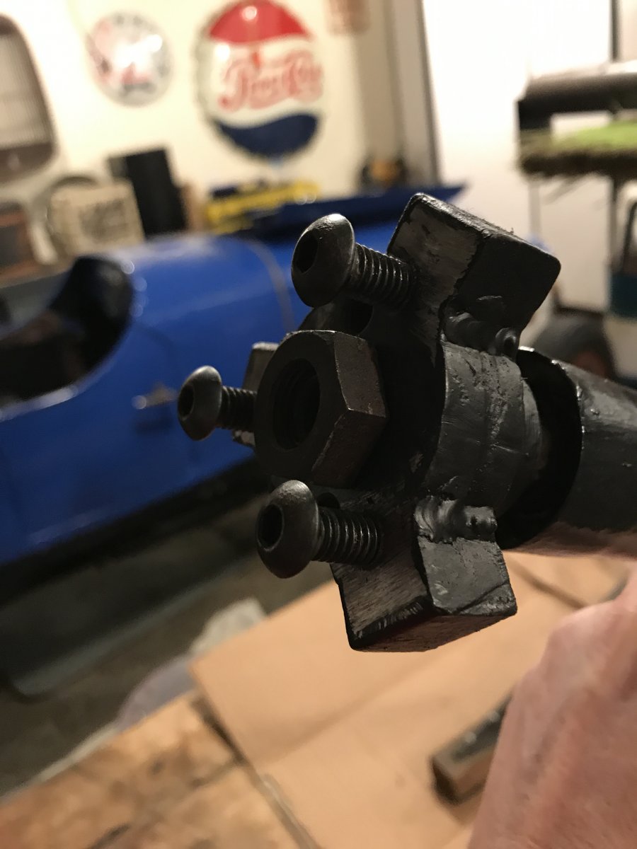

    One odd kicker--neither of the two available Grant steering wheel adaptors for early '50s Ford will fit this column. The spline patterns don't match. I tried Grant part #4257, which is specified for 49-57 truck. I also tried part #4267, which is specified as 49-56 Ford, but the Speedway website calls out for F-1, as seen here:
    It's a head scratcher. I gave up and decided to make my own adaptor. So now there's one less usable F-1 steering wheel in the world.
    Still needs to be welded, drilled and tapped, but you get the idea. Kind of crude, but at least I know it will fit.

    Well, yes, there’s been progress. For starters, Broomfield in Ballard welded up the steering box for me. Their main business comes from the fishing fleet, but I’m told their old man did a lot of hot rod stuff back in the day and the guys seemed to get a kick out of the project.
    My brother and I rebuilt the box one afternoon while waiting for a transporter to come take his ’29 coupe to its new home.
    The worm gear and roller were in great shape, so we just replaced the bearings and bushings. Little tip: if you don’t have the right size reamer, you can get the job done with a wheel cylinder hone. Hone, test, hone, test. Takes about an hour. :oops:
    Also finished the steering wheel adaptor: it’s welded, drilled and tapped. Not as pretty as a Grant, but kinda cool, I think.
    Also did an organ transplant on the brake pedal. The donor was this F1 pedal:
    It gave it’s little all so the Model A pedal now works with the master cylinder.

    I wish I'd known you planned to cut apart a perfectly good set of pedals for that piece...
    Sent from my SM-G965U using The H.A.M.B. mobile app

    Not a set. The clutch pedal was already torched in half when I got it. From YOU, I hasten to add, after you couldn't get $10 for it in Puyallup. :D

  27. Hitchhiker
    Joined: May 1, 2008
    Posts: 8,507
    Hitchhiker
    A rare and valuable set of automatic transmission pedals!!!

  28. ClarkH
    Posts: 1,573
    ClarkH
    I guess now it is an even rarer and more valuable set off the self-driving F-1.
