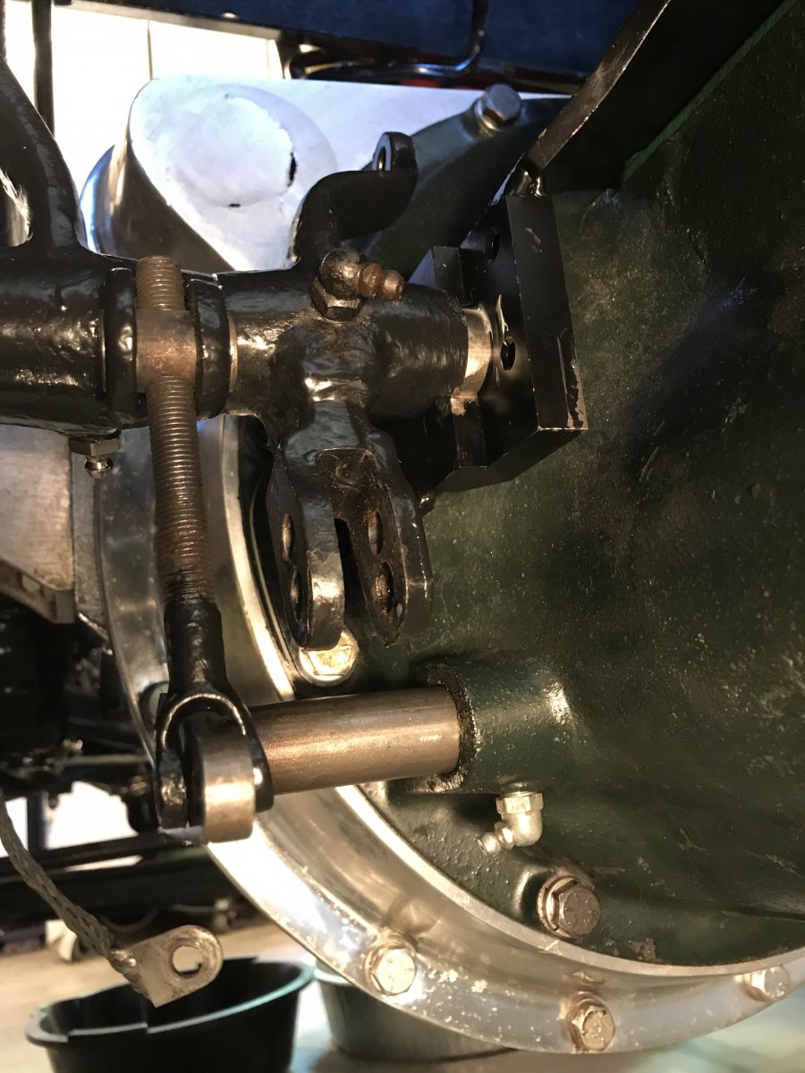

    But through it all, the speedster has been coming along. I got the modified steering box, column and wheel installed, so that was good. I’m digging the new wheel; still fiddling with the horn ****on.

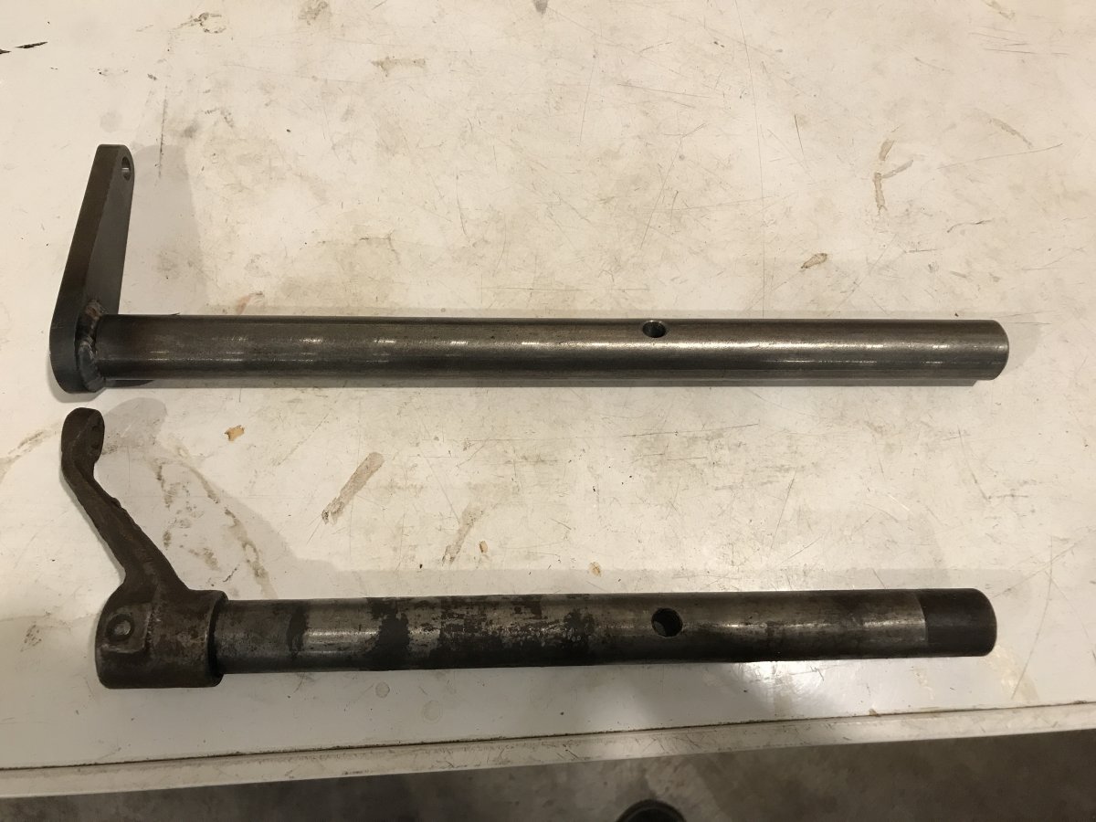

    But I did run into a problem with the new pedals. Turned out the brake actuator I had welded onto the pedal was interfering with the stock clutch arm. I kind of figured this might happen. It was oh-so-close and maybe OK with just a little grinding, but it's brakes, so I didn't want to risk it.
    The solution: Clings rod and arm, which has a 90-degree angle vs. the stock arm’s 45-degree angle. Here’s what I’m talking about (Cling's top, stock bottom):
    Of course, doing this meant pulling the diff and master cylinder so we could remove the transmission. Thank goodness once again for the help of my Hudson-owning brother.

    Everything clears now. And yes, those are my new tires in the background of that first image. More on that and other subjects, to come.

    Looks good, a clean solution, can never be too safe with brakes.

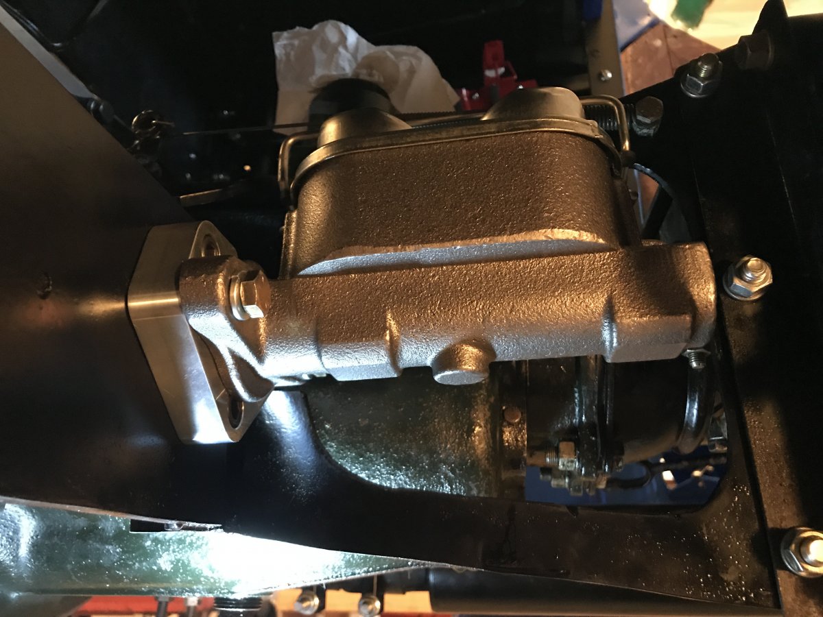

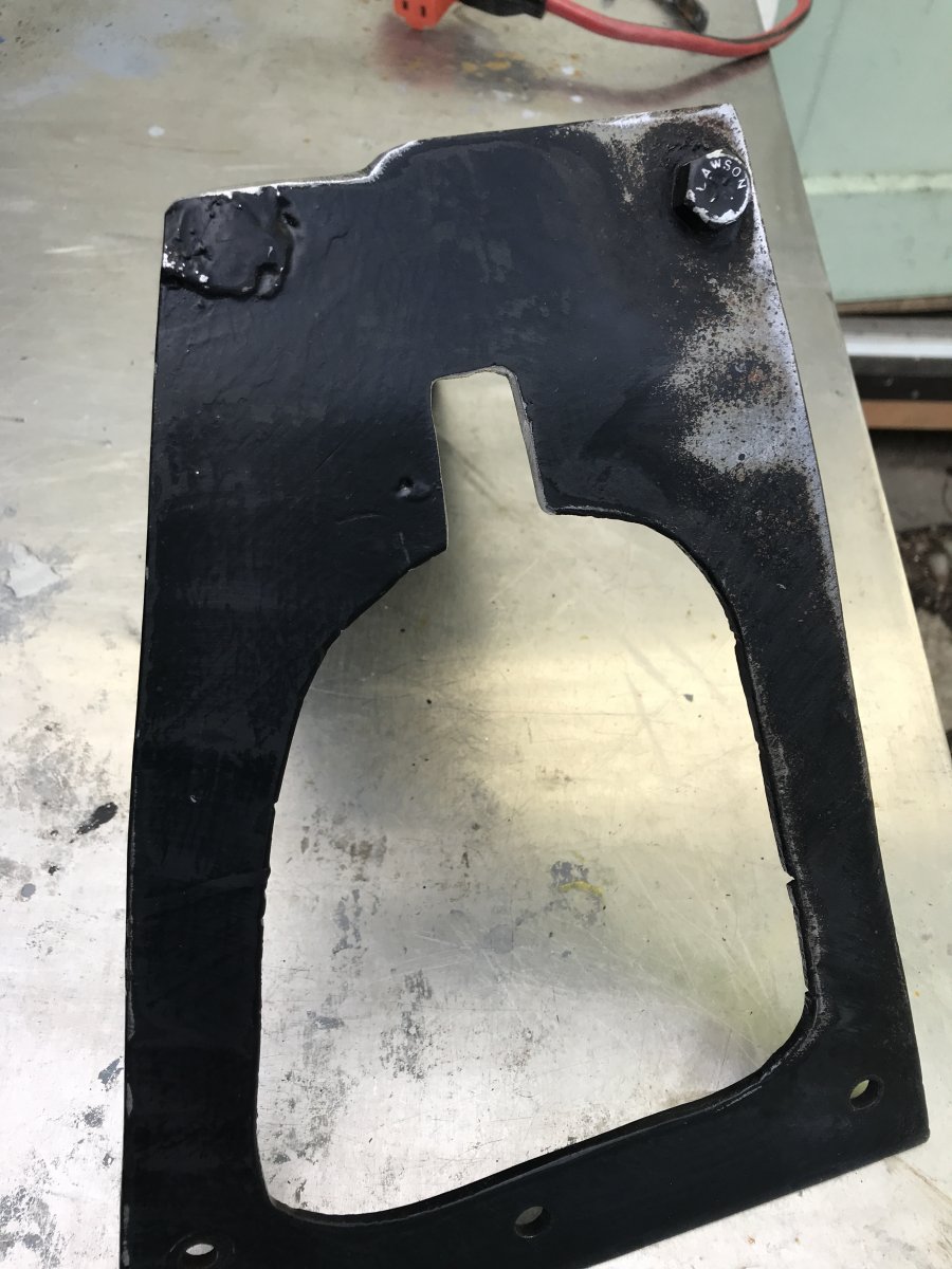

    I put a new single reservoir in this thing a few years back when we redid the brakes. That choice has been nagging at me ever since. I know, I know, people got by just fine for decades on single reservoirs. But the fact is, in my driving life I’ve actually two single-system failure episodes. So I think about it.
    To be fair, both of those episodes were on ****py $100 high school cars, and the failing was probably more the result of my ****py maintenance than it was the technology. And both times I got the car stopped safely (picture a Ford Country Sedan jouncing across a gr*** field).
    But since I had the m/c out anyway, I decided to go ahead and upgrade to a dual reservoir unit. Mainly so I would stop thinking about it.
    Now admittedly, this is really basic stuff, but sometimes even basic stuff is interesting
    First step was to modify my homemade m/c mount (had to cut a slot to fit the ear of the m/c).
    Then installed an adaptor from Ch***is Engineering (you can see how the ear fits the slot).
    Then uninstalled the adaptor when I discovered the holes didn't align. (See bolt on left. And yes, should have test fit before installing…) A round file to the m/c took care of the problem.
    And now it’s in, along with a proportioning valve.
    Yes, it's a bunch of anachronistic modern stuff sitting under the floor. But like I said, now I can stop thinking about it. Emphasis on stop. :D

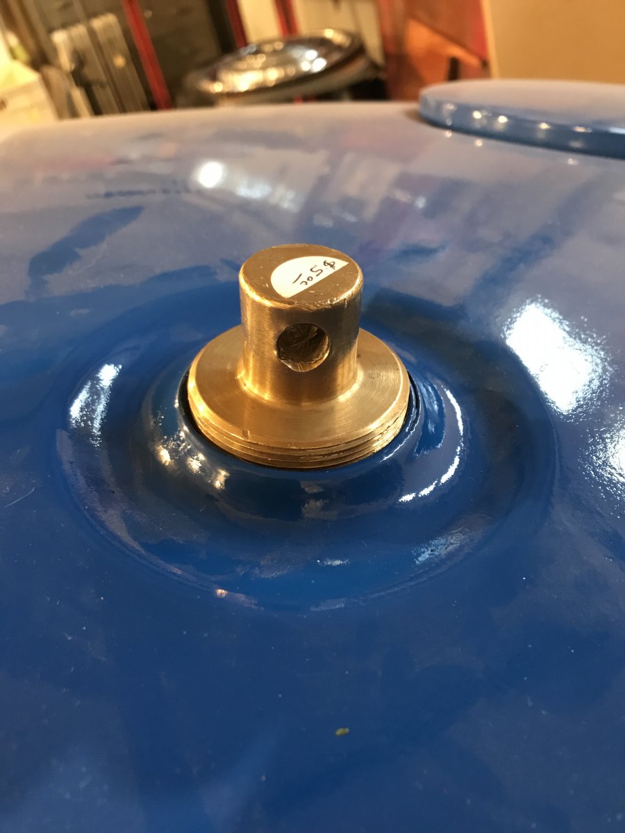

    This is the story of how the Car Universe threw me a bone.
    Background: I have been searching for years for a gas cap I can use on this car. The inlet is a two-inch hole with some kind of weird thread pitch I can’t identify. I’ve talked with Mercury-guru Jarvis and others, and nobody seems to know. Net result, I have a swap meet box full of male-threaded gas and radiator caps I’ve bought over years in a failed effort to find a match.
    So recently I was heading home from a visit up north with my dad, and stopped by one of my favorite junk shops. The guy always has a lot of tools, and I needed a 1.5” open-end wrench for my spring spreader (which he had for $10—Snap-On, no less).
    While I’m poking around the place, I find this:
    The threads looked to be too co****, but at only $4 (he knocked a buck off :D), I was willing to risk anther addition to the swap meet box. Got it home, walked into the shop, and I’ll be darned if it didn’t thread right in:
    I took the thing to Tacoma Screw Products and they identified the threads as 2-14 National Special, which I gather hasn’t been used in decades. Old Jarvis was delighted to have this bit of data for the next update of his Mercury Parts Book.
    Then just yesterday, Jarvis let me sort through his various boxes and cabinets looking for something cool I could braise to the top of the thing. Lo and behold, I found this dog bone radiator cap with matching threads. No need for braising, it just spins onto the exposed threads.
    Now I’ll admit, some might find this dog-bone-as-gas-cap to be a little odd. But I think it’s kind of a cool solution. And even if you don’t like it, you have to admit it’s better than nothing, which is what I had previously.
    I also only regard it as short term. Long term, I have a better solution in mind, in the form of this very cool flip-cap I got from a fellow Hamber at the Early Bird Swap Meet in Puyallup.
    I really dig the flip cap, and now that I know the thread pitch, I figure I can have a sleeve made that will adapt it cleanly to the car. However, with so much going on right now, that’s a winter project for the future. For now, I’m just happy to be running with something cooler and more practical than a rubber bung.

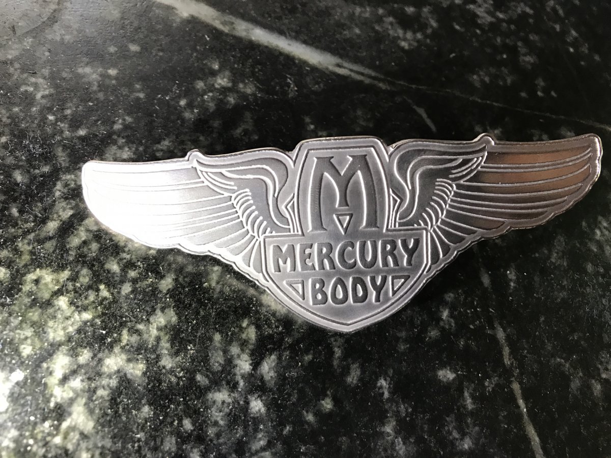

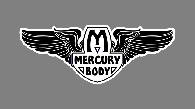

    Now here is a very cool development. Ever since I got the speedster running and out into the public eye, one glaring omission has really stood out:
    No radiator badge! Whenever people inspect the car, they try to sneak a peek at the badge—seeing none, they’re stuck asking, “so, uh, what is it?” In some ways this is a fun conversation starter, but still--without a badge, the car lacks iden***y.

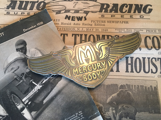

    I’ve been noodling on this problem for long time. Finding an original badge is hopeless, obviously. I got some badge suggestions from the Hamb last summer, which I appreciate. Of course, a Ford oval is the easy and obvious choice, but I felt something unique was called for. Question is, what?
    This is where @Saxman comes into the picture. Saxman runs Liberty Speed Company, producing custom-etched shift knobs, and other cool accessories including the legendary Hamb shift knob. I was fortunate to get one of that limited edition (#78), so I’m familiar with his work. Very high quality.
    Saxman was happy to take the project on. We had several exchanges about size, shape and the overall design, and I could tell he was really focused on what I wanted as we worked through a couple of iterations. Ultimately, he combined the original Mercury logo, my thoughts, and his artistic vision into this rendering:
    Which he then transformed into THIS:
    Is that cool or what?!?! This is a glam shot he took, and I hope it makes its way on the Liberty Speed Company website.

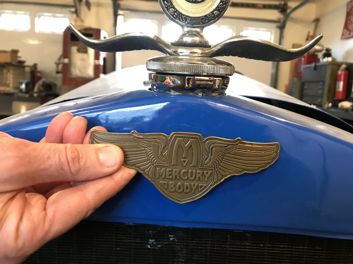

    I have the badge in hand now, ready to install for summer:
    So now I owe a huge debt of gra***ude to Saxman. I could not be happier with this. The car really needed something, and the scale and look of this badge are perfect.
    To paraphrase the Big Lebowski, “It really tied the car together.” :D

    Fantastic collaboration and outcome have you considered shine or a partial polish? I am not a big shiny guy myself but driven shiny I don't mind at all.
    What is it made out of...it looks br***y.
    Great work @Saxman...;)
    @ClarkH your thought process has been absolutely spot on throughout the adventure with this Ole Crusty...if it was human you'd be getting lotsa good loving...that said it's delivering that in smiles per mile...;)

    I love it! The rendering and the metal piece are clearly the same design, but they look so much different, judging by the rendering only I would have said I don't like it, but it really looks right in the metal. Takes a skilled eye to know what it's going to look like when it's made, and I would have been dead wrong. Well done Saxman.

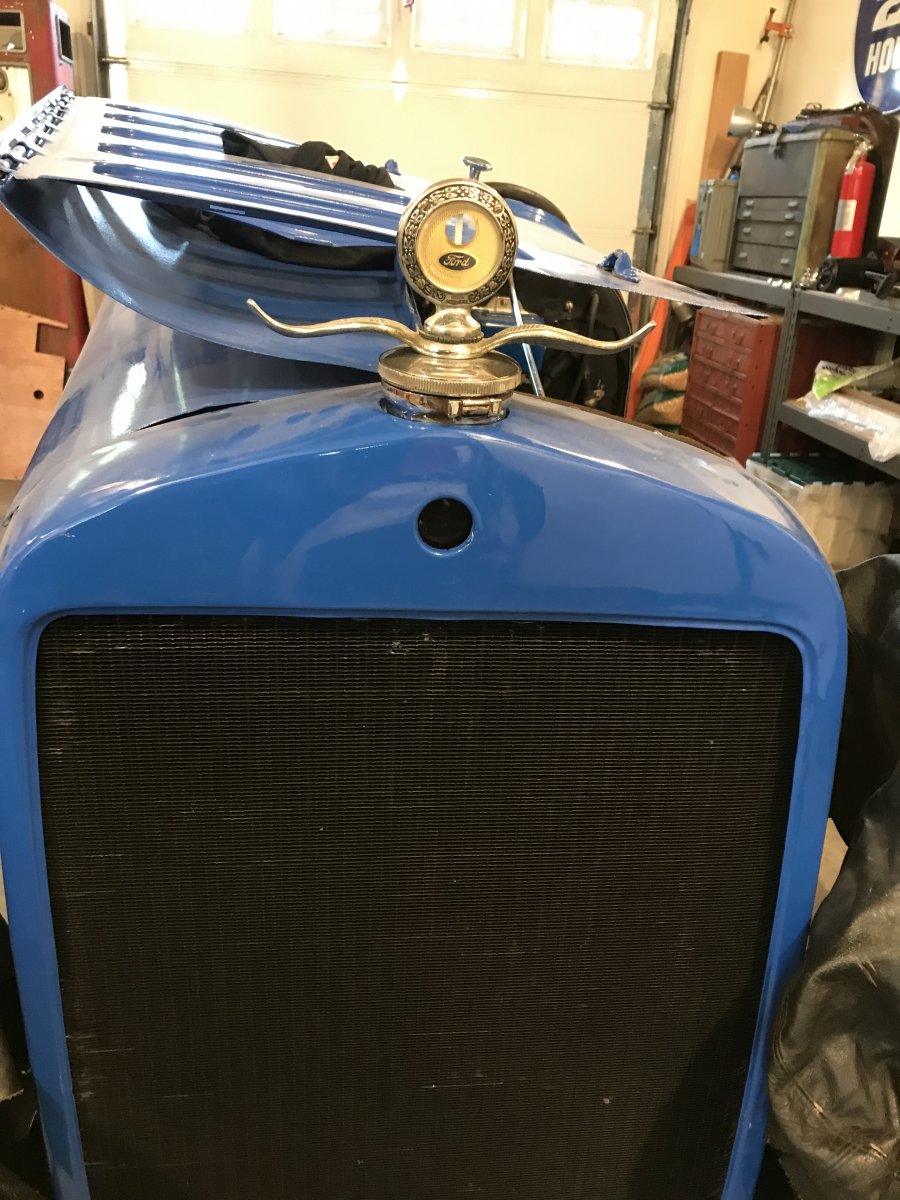

    Got the radiator shell badge back from the plater. Dull nickel. Looks really good.

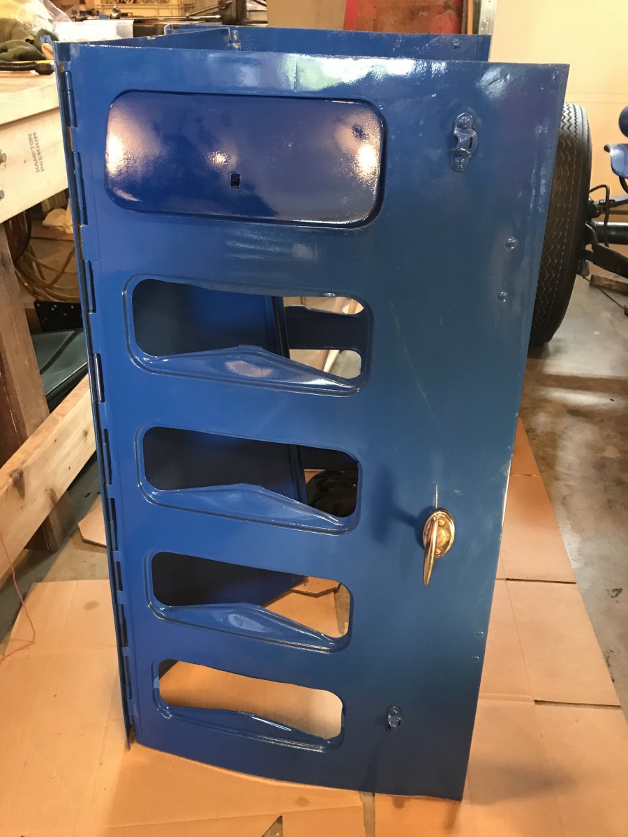

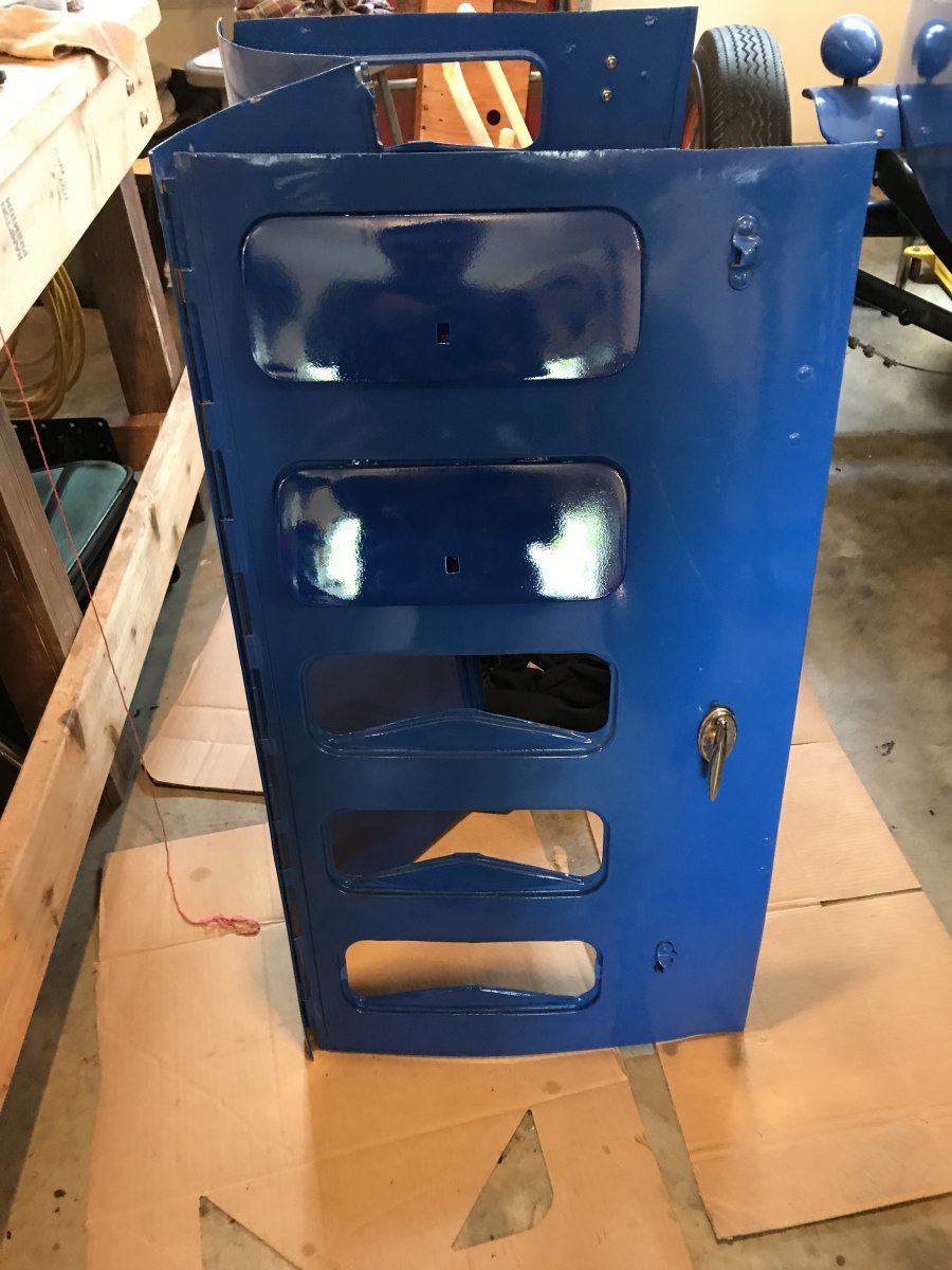

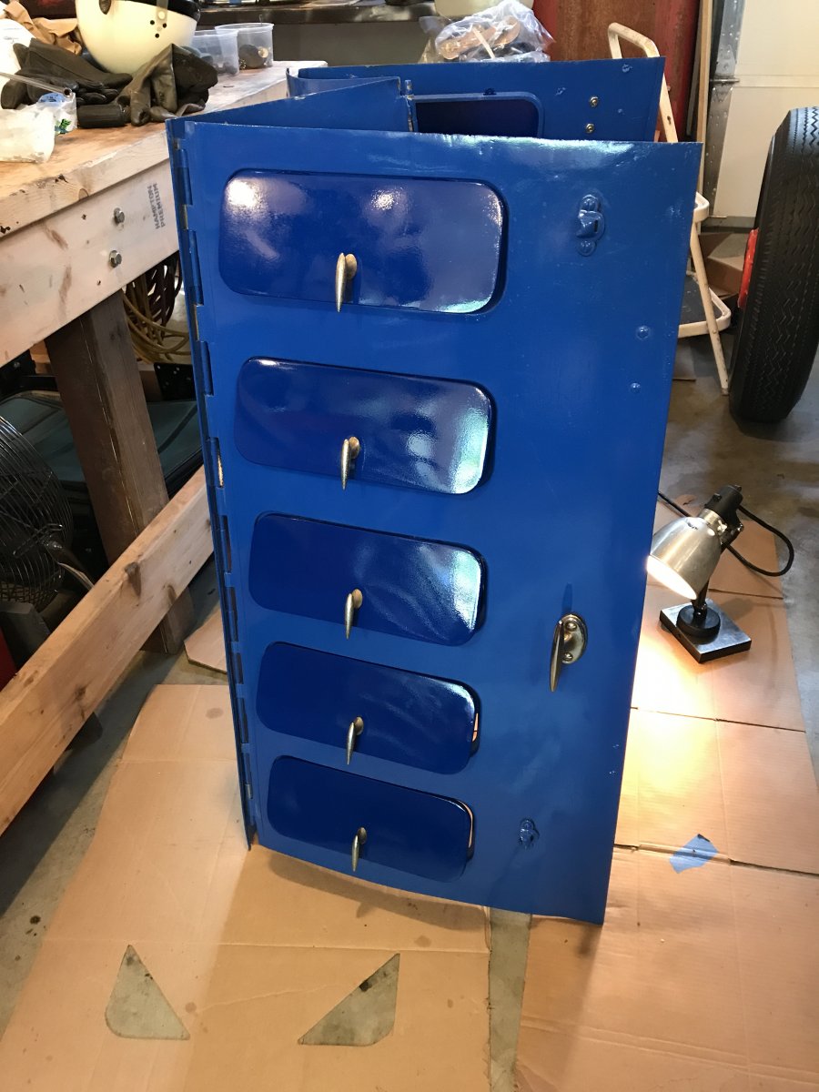

    Meanwhile, since I had to remove the hood and shell anyway to access the radiator badge, it was finally time to install those hood panels I painted last summer.
    Even though I’d already made my brackets, each panel had to be individually fitted, which was time consuming. Affixing the first panel took the better part of 3 hours to sort out.
    Second one about an hour and a half.
    By the time I was done with all 10 panels I had it down to 45 minutes per, followed by more time adding the little bullet doodads.
    Now back to the badge. When Saxman made the badge he brazed a threaded post on the back. The distance between the badge and radiator is 5/16”. Allowing for a bracket, nut and lock washer, it’s pretty tight (had to grind the nut to half its original size). The post is plenty solid, but being a belt-and-suspenders guy, I also used a couple drops of 3M emblem adhesive to get it on there good and secure.
    Everything’s back together now.
    I’d like to roll it outside for a wash and better pics, but as you can see she’s not exactly in a rolling state at the moment. Lots of brake and steering fiddles still in process.
    Soon though!
