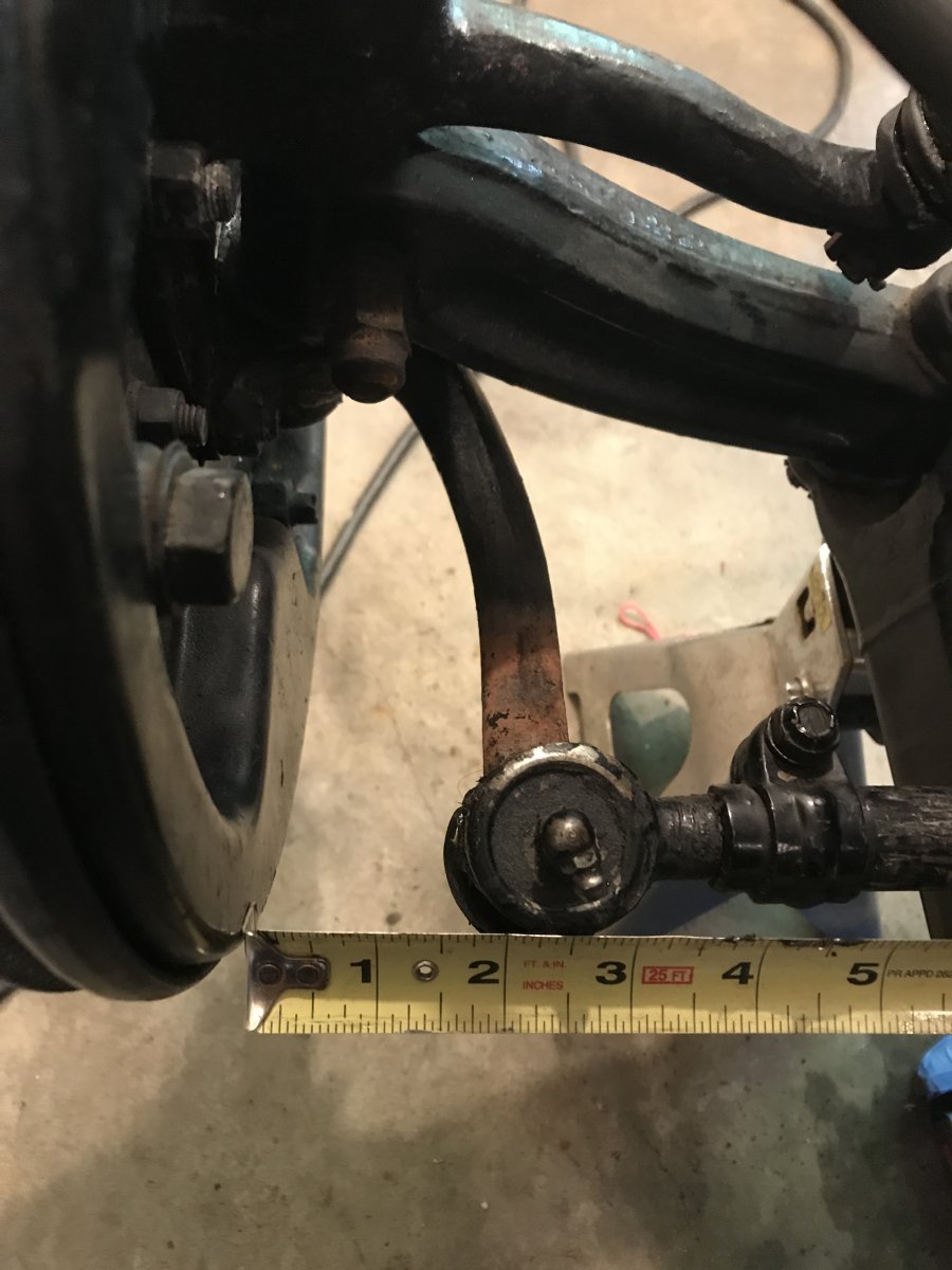

    Well, I’ve run into an issue with centering the steering. I’m hoping you guys can tell me whether my reasoning is on the right track or totally off base.
    The situation:
    I have an F1 steering box and what I believe to be ’34 axle and spindles. The F1 box is 4.5 turns lock-to-lock, and my car is 3.5 turns lock-to-lock. So to get everything centered, I aimed the wheels straight ahead, disconnected the pitman arm, centered the box at 2.25 turns, and then reattached everything with the pitman arm pointed straight down (i.e. 6:00).
    The problem:
    Starting at center, I now reach the left bump stop after 2.2 turns of the steering wheel, and reach the right bump stop after only 1.3 turns. (Re***embled it three times to confirm.)
    Looking everything over, I see a possible source of the problem. These steering arms have been bent, and do not mirror each other. The arm on the right is half an inch shorter and a half an inch further away from the backing plate, compared to the arm on the left. Here are pictures:
    Left side:
    Right side:
    I’m thinking the fix is to heat and bend that right arm to make it match the left, then reset the toe. This is where I’m hoping you guys can give me a reality check: Am I on the right track, or am I missing something?
    Any advice is greatly appreciated!
  5. ROADSTER1927
    Joined: Feb 14, 2009
    Posts: 3,288
    ROADSTER1927
    Your idea will work fine. As we are in driving season I would just center the box when going straight and not worry about it turning a little shorter one way for now.
    Stogy, ClarkH and loudbang like this.
  6. s55mercury66
    Joined: Jul 6, 2009
    Posts: 4,367
    s55mercury66
    from SW Wyoming
    You may want to check your Ackerman angle also while doing this.
    270ci, loudbang, Stogy and 1 other person like this.
  7. ClarkH
    Joined: Jul 21, 2010
    Posts: 1,571
    ClarkH
    Thanks for the suggestion. Just did the measurements: Left side is perfect, right side a little off.

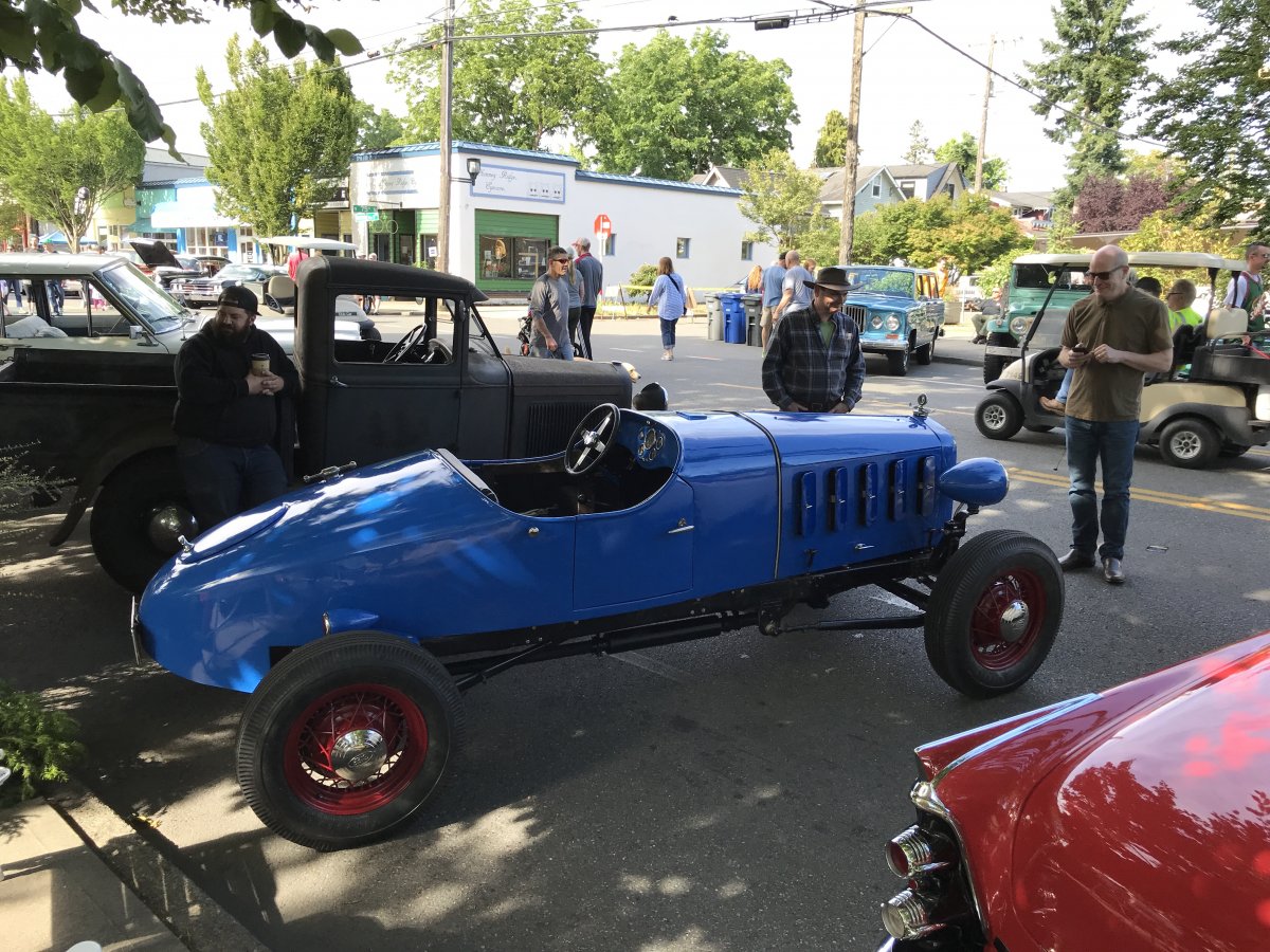

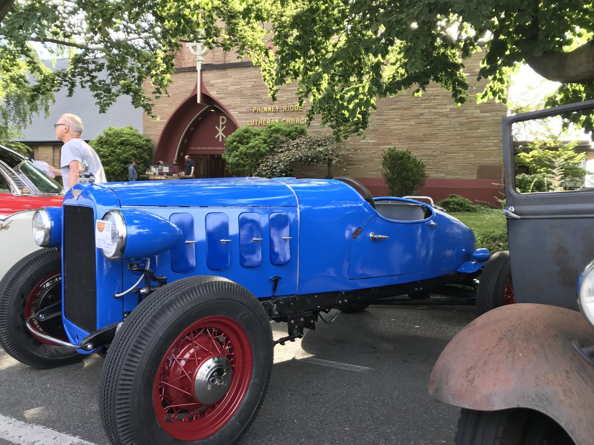

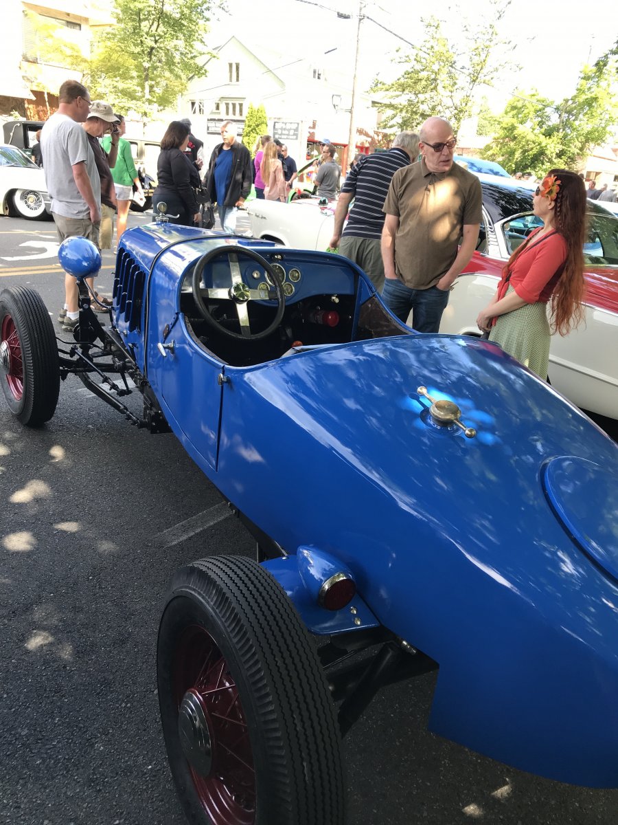

    My brother and I were going to take Dad out for a big drive this weekend--the speedster and Dad's '31 coupe--but the weather ****ped out. So here I am on the Hamb! I haven't posted much lately because I'm taking the advice of @ROADSTER1927 and more or less just enjoy ing the car for the summer.
    Here's the car at the Fourth of July show in Blaine:
    As you can see, she's now sporting new Firestones and powder coated bent spokes.
    Here's the car at the Greenwood Show, where there was a lot more sunshine:
    That's my wife with the flower in her hair in that last shot. She loves the shows (she's the one who insisted we do the event in Blaine, a town she spent summers in, growing up). She's wonderful answering questions about the car--so long as they have nothing to do with the running gear, which is a closed book to her. :D

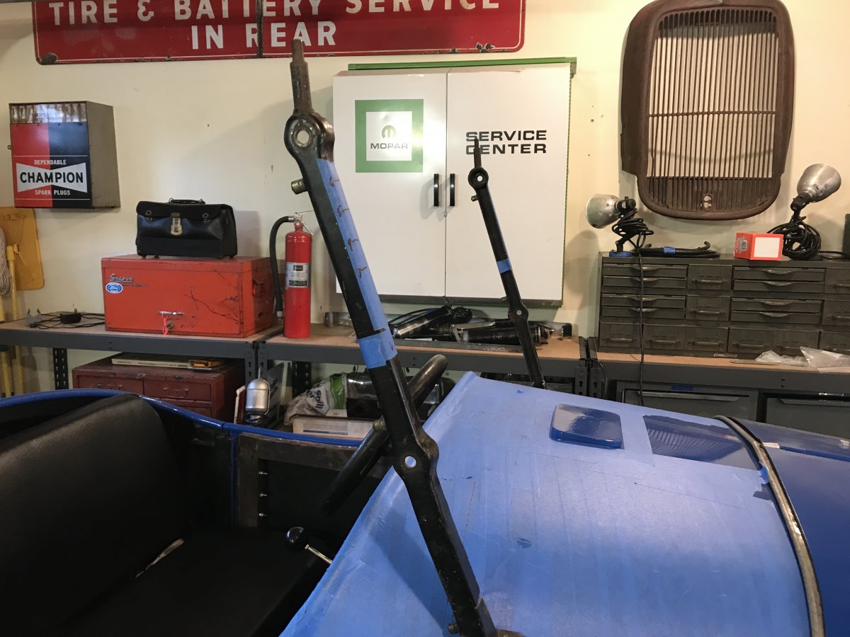

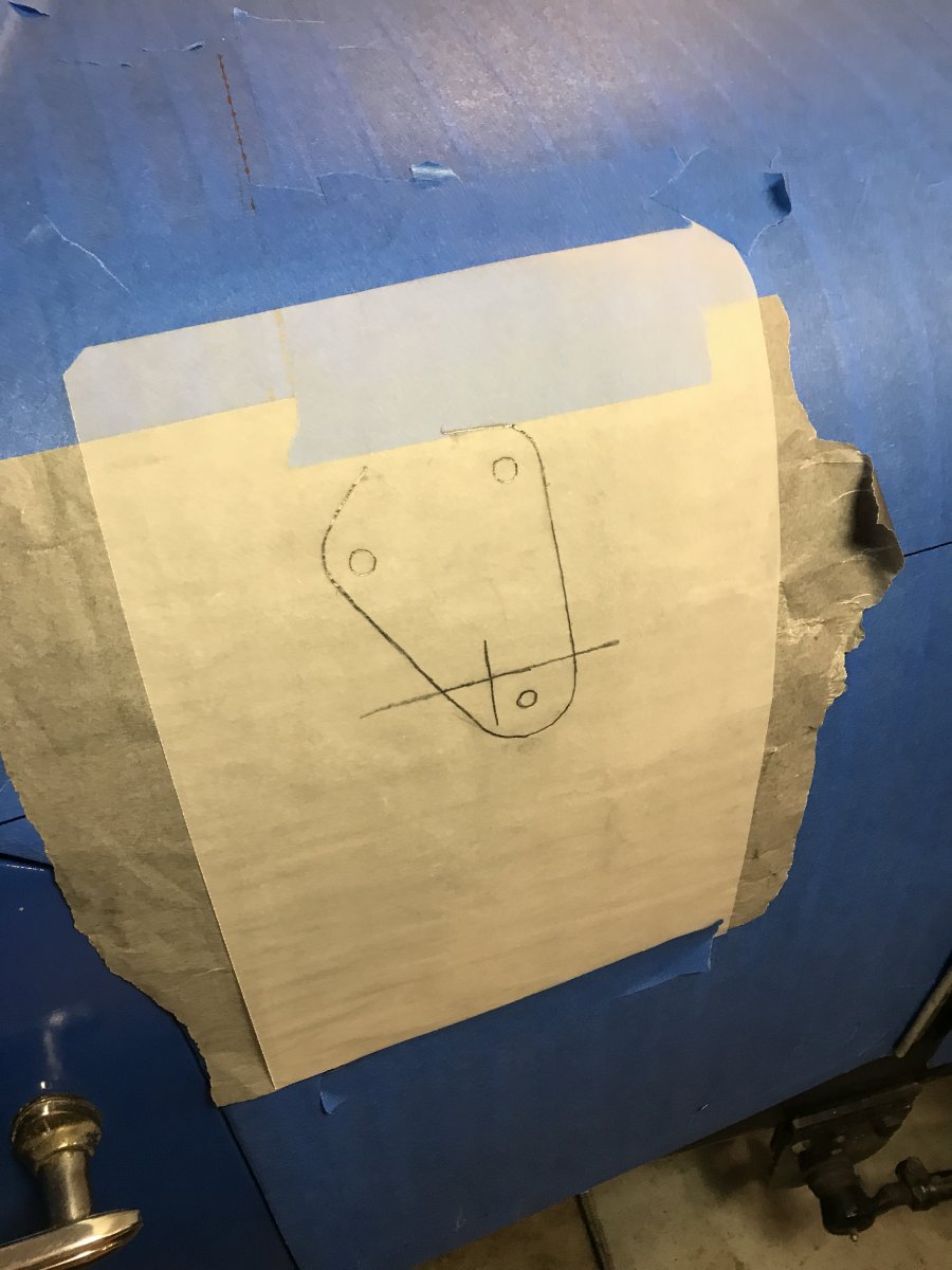

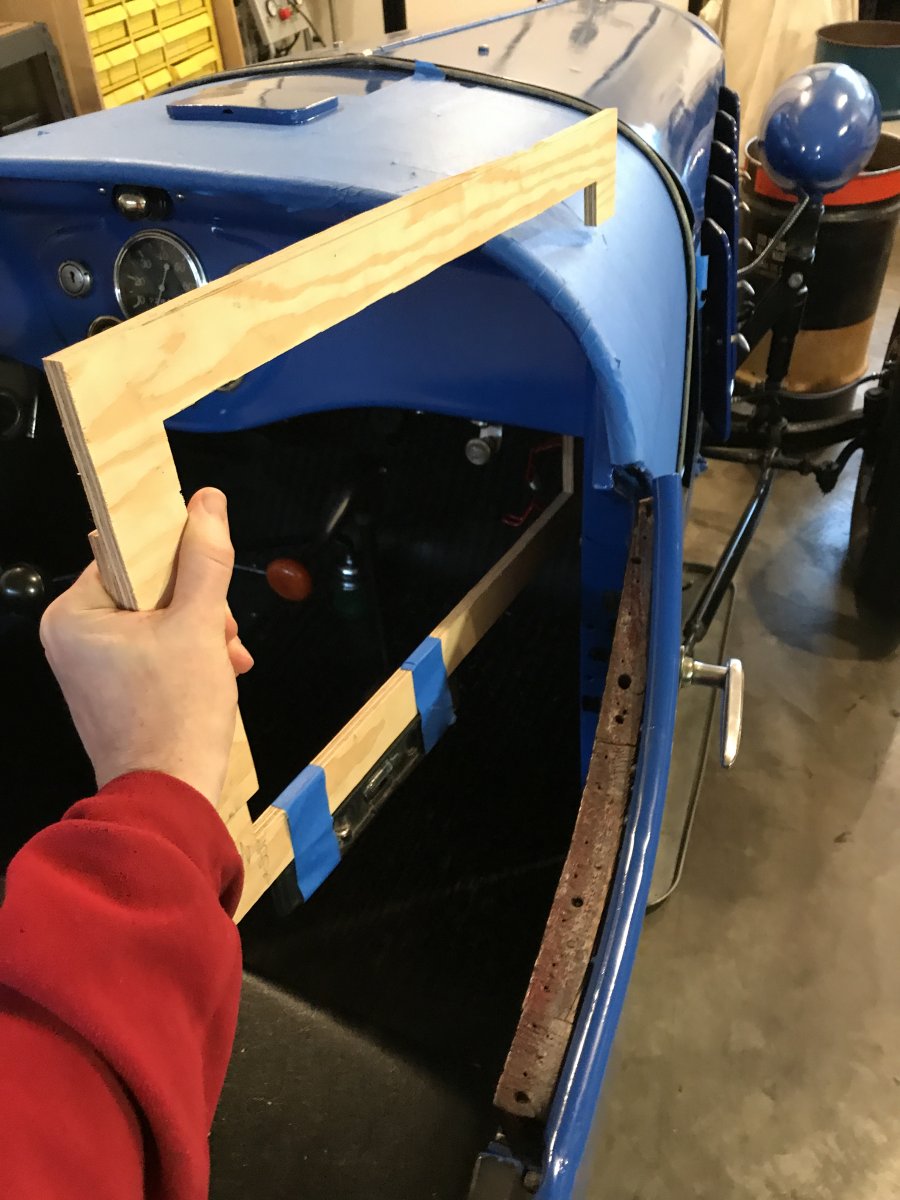

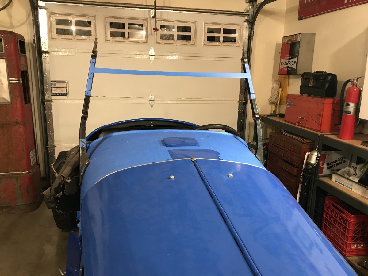

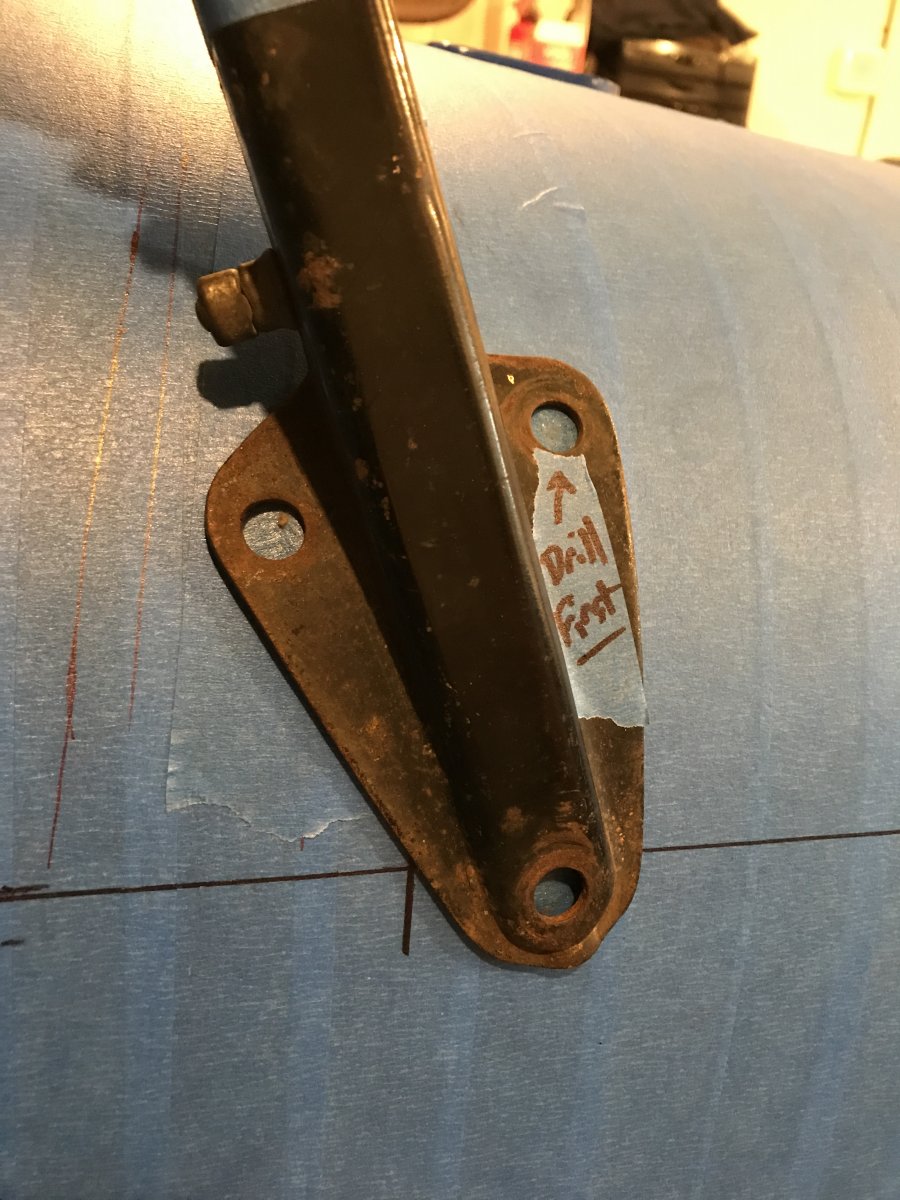

    OK, the time has finally come. The speedster is getting a windshield.
    After going around and around on this, trying over a dozen options, I settled on mid-20s Chev roadster posts. While not the most beautiful of the w/s posts I considered, they are the most practical: Their curvature at the base matches my cowl, they are easy to mount, and their square profile makes modifications relatively straightforward.

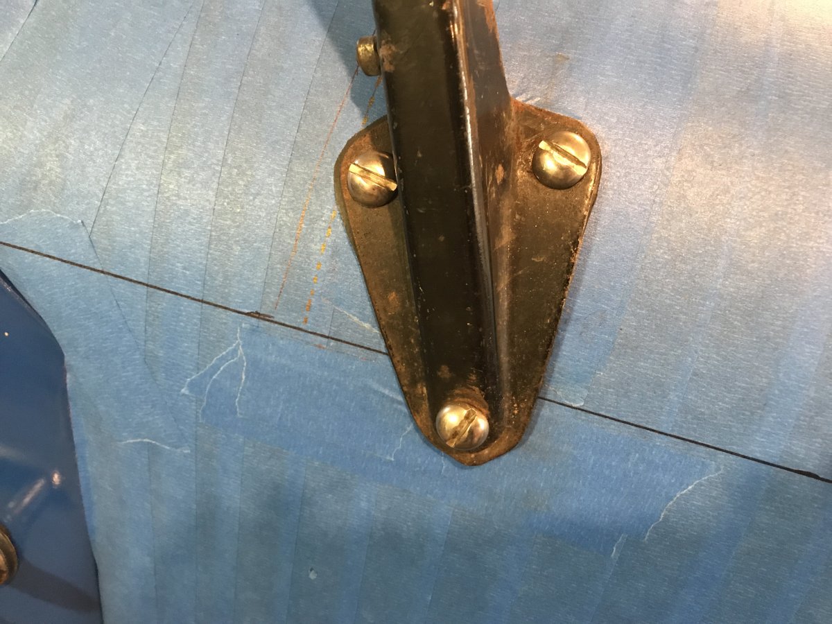

    With the car already painted, this was a somewhat delicate operation. First step was to slather the cowl in blue masking tape. Next, I had to establish reference points on either side of the car—not easy to do on a car with so many curves and asymmetrical doors.

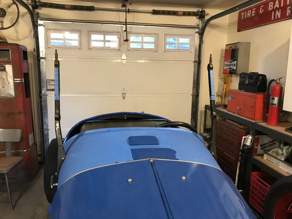

    I triangulated using the firewall, cowl base and cowl vent. I also made a little measuring doohickey to confirm I wouldn't drill into the internal cowl support. Got my spots marked.

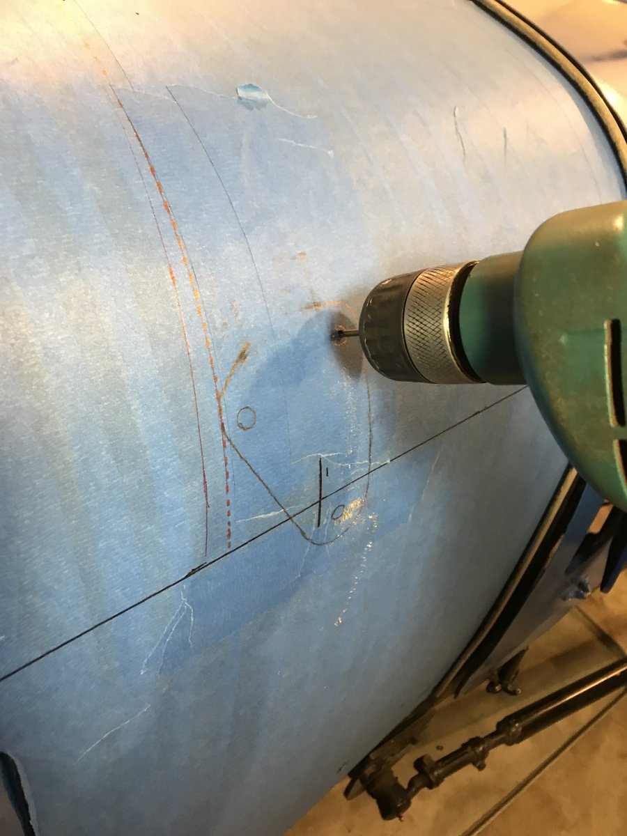

    I got one side set, and then transferred it to the other. My wife is an illustrator (a**** other things), so we have lots of tracing- and carbon-paper on hand.
    tracking post.JPG Took a big gulp. No turning back now.
    All done. Made some gaskets out of sheet rubber—edges are rough; I’ll trim them later.

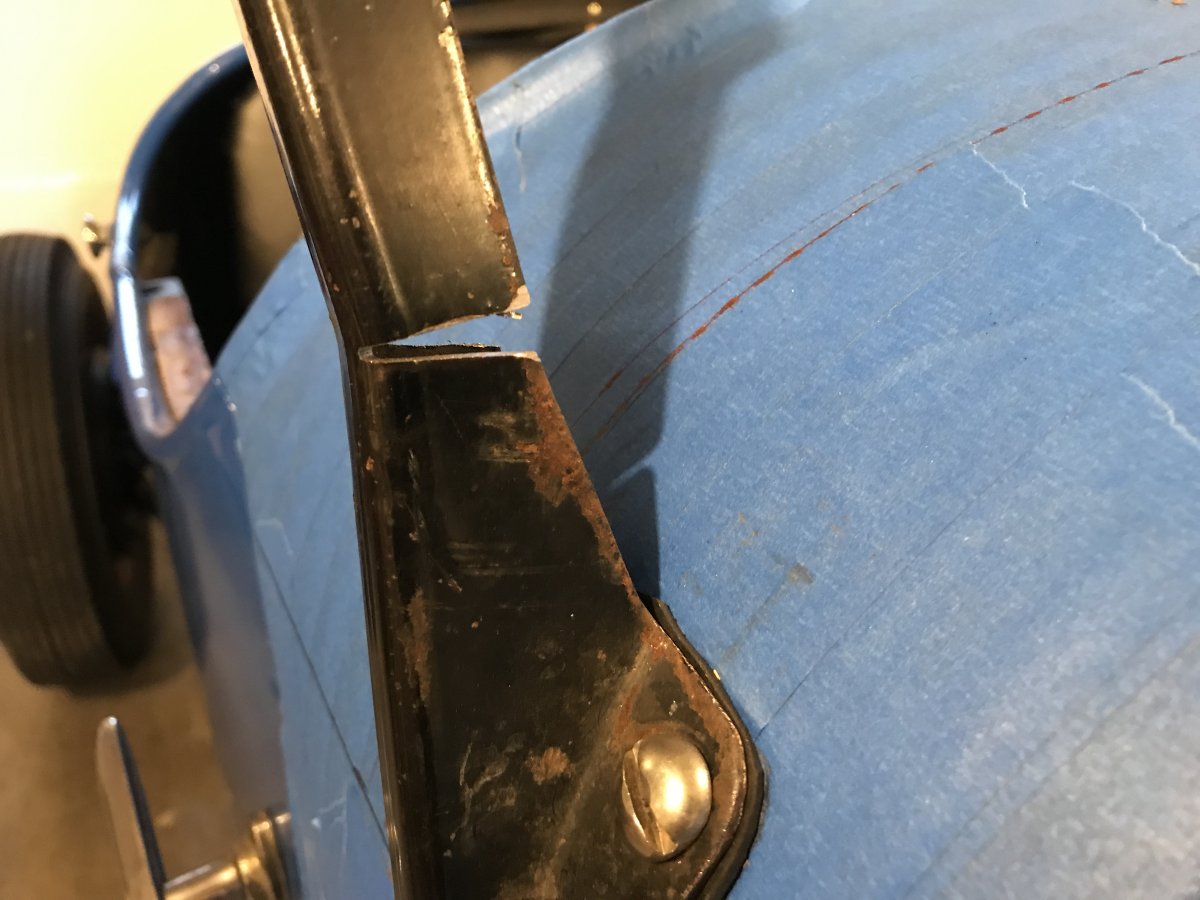

    This left me with inward-leaning posts. They looked like they were doing the last move of the YMCA. (There’s a reference that will date ya :D)
    This is where the square Chev posts paid off: one cut, bend, done…at least for the moment…until they get shorter…
    Nice little rake, ~20 degrees.
    All for now. Next up: Windshield frame
