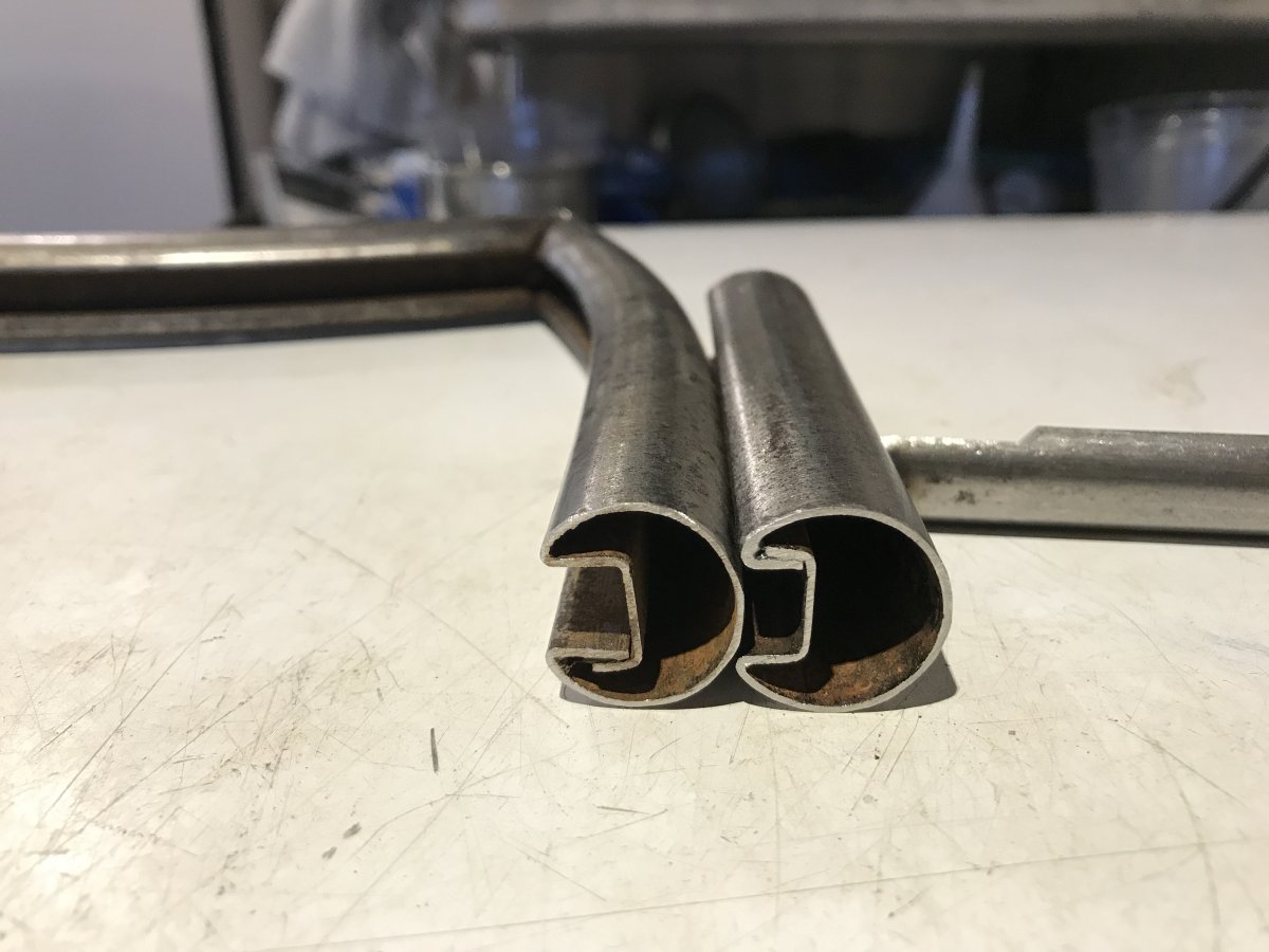

    With the w/s posts in place, it was on to making a frame. In years of scouring swap meets, searching online and pestering friends, the only viable options I could lay my hands on were two-piece mid-20s Chev roadster and 26-27 Model T.
    I considered my options. Both frames would need to be narrowed. The lower Chev frame already fit the stanchions, leaving a perfect gap for the rubber seal that goes between frame and cowl. However, Chev lower frames being shorter than Ts, I would need to also use a cut-down upper frame—in other words, a two-piece windshield. Testing showed this put the seam between the two sheets of gl*** directly in my field of vision, and when cut to what I judged the right height, put the upper frame at the edge of my upper vision. On top of that, my wife didn’t like the look of a big squared off frame topping off a beautiful curvy body. (I made an ****ogy to ***y librarians wearing heavy black gl***es, but she wasn’t having it.)
    The other option was to just use the T lower half, like so many guys did in the day. No upper frame blocking vision, just a gl*** edge. A nice look. Problem is, the T frame was too short. Remember, the cowl on this car is ~4” shorter than a Model A. So even with my seat dropped as low as possible, testing showed my eyeballs would be looking just over the top of the gl***.
    I considered having a curved windshield top made, like @Paul did several years ago in his '27 Roadster Saga. But several things made this problematic—chief a**** them my plan of making a top for it later.
    So in the end, I went with the odd-yet-obvious choice of extending the height of the T frame. Wasn’t sure I could pull it off, but figured it was worth a try. Started on this a few days ago, and here’s where I am so far.

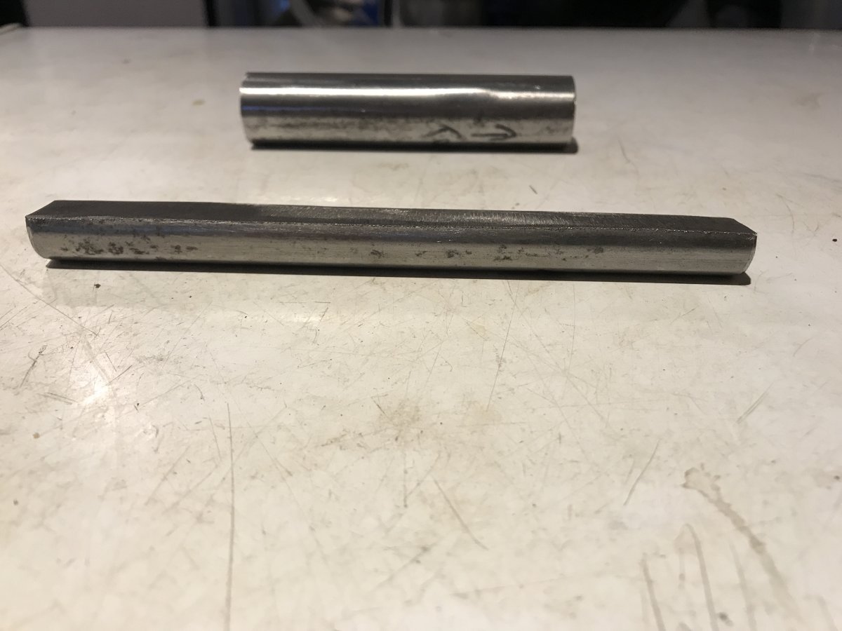

    Cut a pair of 4” slugs out of an upper frame, to be grafted into the lower.
    Made an insert out of round-stock to tie everything together. Ground the top to match the half-moon internal profile.
    Discovered that the upper and lower frames had slightly different internal profiles. So I carefully ground and filed the ends to match, using a crude leveling method to keep everything more or less square. (Aside: that carpenter’s square was a**** a batch of new tools my father gave me for my 6th birthday. Still using it all these years later!)
    Clamped everything into a section of angle and welded the seams.
    For added strength, I drilled through each section and inserted tension pins. Yes I’m a belt and suspenders guy. Just like Santa!
    And here’s where I am now.

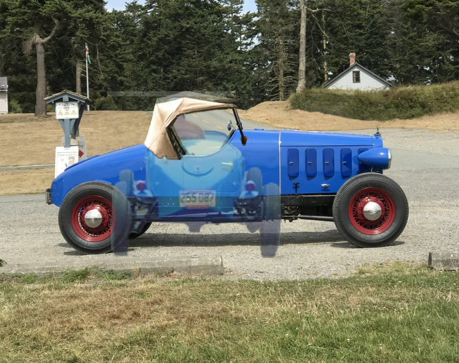

    :rolleyes:...New Years Inspirations...;)
    Based on this Seating Profile below...
    All the Best in the Year Ahead @ClarkH
    Credit to All That Inspired this

    That actually looks pretty cool even though it takes away from the speedster look a little. I'm all for extending the driving season. Glad I live in the south.

    Dang Stogy, that's some impressive work there! I think the profile would be better if it was chopped a couple of inches, but as your work showed, that looks about right for Clark's height, unless he can drop the seats a couple of inches.

    Thanks @Stogy! That is certainly something I can envision for the future. Key to that folding windshield would be grafting stout pivots into the stanchions. Probalby also means making a low valance across the cowl and using a flat-bottomed frame, maybe a T or Chev top. Fortunately those Chev stanchions are relatively easy to find--I've collected 3 pairs—so I can experiment down the road.
    I'm also with you, @Blues4U, on trying to get the top as low as possible. Also on my winter project list is cutting a hole in the plywood seat bottom to add webbing, which will drop driver and p***enger down and inch or so. That's about all the room I have left.
    Of course for now, the windshield will be fixed—it's the most expedient path, and I've got a big punch-list to get through before spring. But I love having future concepts like this to noodle on. At Christmas, a well-meaning inlaw asked, "When will that car be done?" My answer, "Well, it's drivable now. As for being done, if I'm lucky, that will never happen." They didn't undertand. :D

    :rolleyes:...;)...Thanks @ClarkH and the others...I'm enjoying this challenge and agree lowering the top would aid in visual aesthetics...but it would take some seating mods that you would have to get creative on...it's truly a fine line as where and how you sit matters.
    While I was doing this I was thinking as Blues, floor pan drop between the frame or modding the seat frame and as you said the seat pad itself could net a few inches...all under your discretion of course.
    I will drop it down a couple when I have a moment...for furthur pondering and inspiration...
    Clark do you have any side profile pics with you sitting in it?...I believe I'm close but it may offer a more accurate rework...

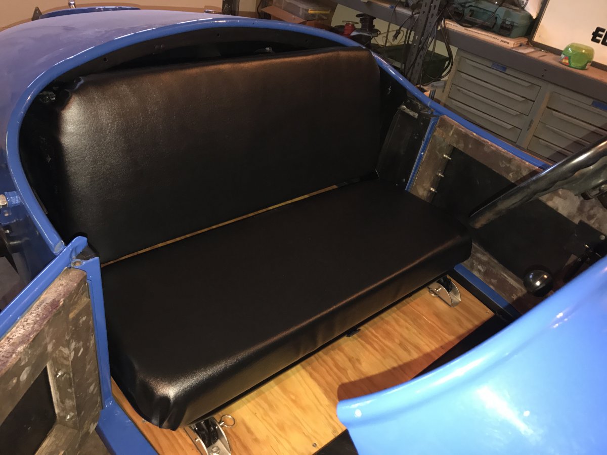

    Clark did have some stripped down Anglia seats to use but chose a vintage bus seat he modded...
    I went back in the thread and here are some pics highlighting the area around and below the seat...one bonus is the wooden floor...I think
    Pretty nifty installation and the rear tabs go through slots in the subfloor cross brace...
    https://www.jalopyjournal.com/forum/threads/a-speedster-comes-out-of-the-weeds—build-thread.1003005/page-13#post-12108578
    Upholstered...
    https://www.jalopyjournal.com/forum/threads/a-speedster-comes-out-of-the-weeds—build-thread.1003005/page-14#post-12189977
    Perhaps as your mentioned proposed mod,
    Clark with cutting relief and webbing combined with a foam with the right amount of give you can achieve your goal.
    I see possibilities in cutting holes through the plywood and inserting metal pockets with flashing that inserted would provide additional drop...the back being a Stiffener/Crossbrace would be a more challenging mod but entirely possible if needed...and I'm thinking you could gain another 1"-1.5"perhaps...
    I can see your not done with this journey yet and I'm happy to be along for the ride...

    That seat is already pretty low. May have to sink the seat into the floor to get the top lower.

    Yes, I was initially thinking some kind of bomber-style seats, because they’re cool. But with only 34” of width to work with in the ****pit, there wasn’t enough room. So I went with the bench. And now that I’m actually using the car, I’ve discovered something else. Turns out the driver’s door on this car is strictly decorative. Using it requires a contortion act, squeezing my thighs through the 7” gap between steering wheel and seat. Much easier to enter on the p***enger side and slide across on the bench seat.
    I really appreciate these thoughts on seating! I’ll put webbing in the seat-bottom for sure, because after about 10 miles or so that plywood starts to feel pretty harsh. But now you guys have me thinking about the possibility of additional relief via the floor. There's room for it under the driver side, no problem. Doing it on the p***enger side would require relocating the battery shut-off and cables. No sure I want to do that; I like having it at hand in case of emergency. Then again, my wife is so pe***e that she doesn't need the extra clearance anyway. Thanks very much for this idea; good to have options!

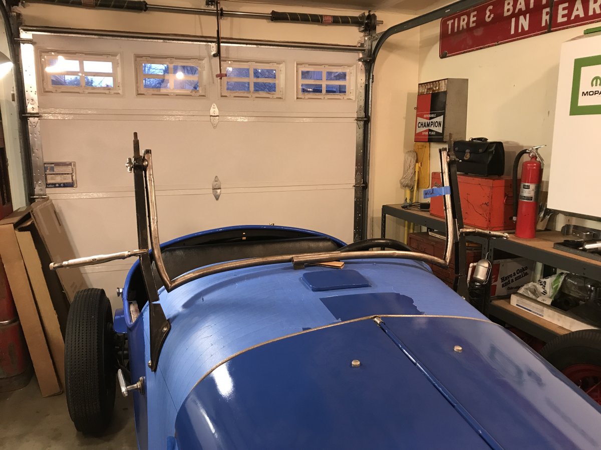

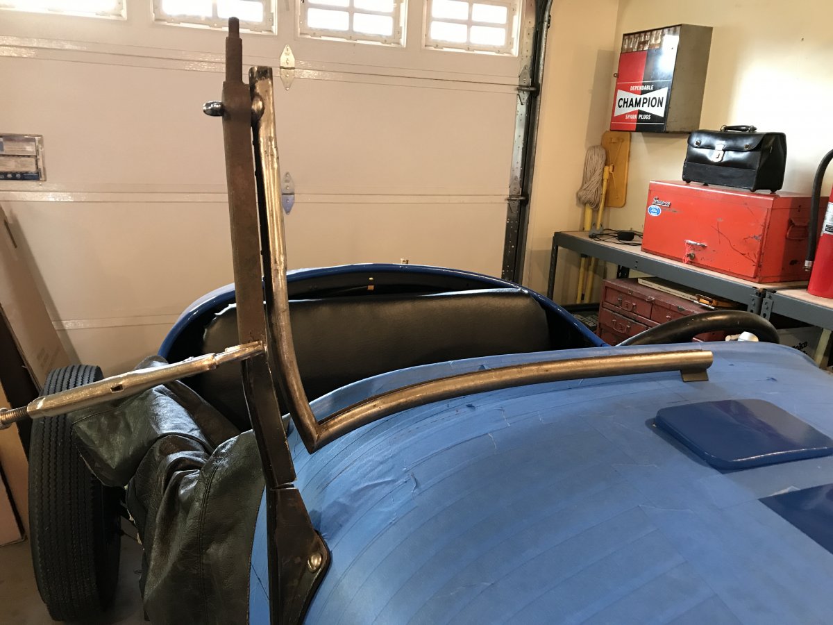

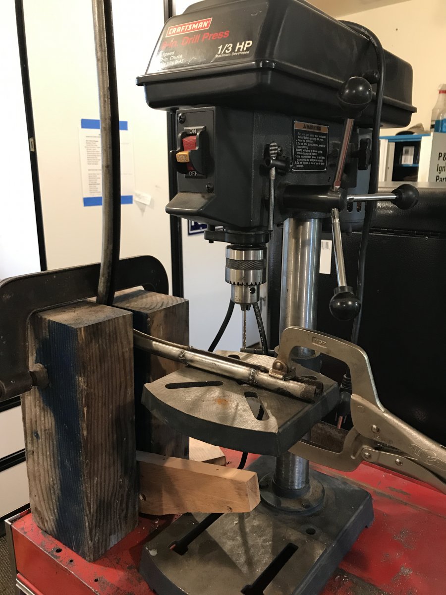

    Spent some time in the garage today. Here’s the latest on the windshield project: First, I cut the w/s posts down to stubs and mounted them to the car.
    Next, using a rusty and mangled post as a template ($5 swap meet find), made a series of chops until I got it right. Wound up removing about 4”, which is what I had initially estimated.
    Chopped my good posts and clamped everything together for fitting, then came inside for coffee and to check on the Hamb.
    I’ll fiddle with everything later to get the spacing right, then mark my final cuts to the bottom of the w/s frame.

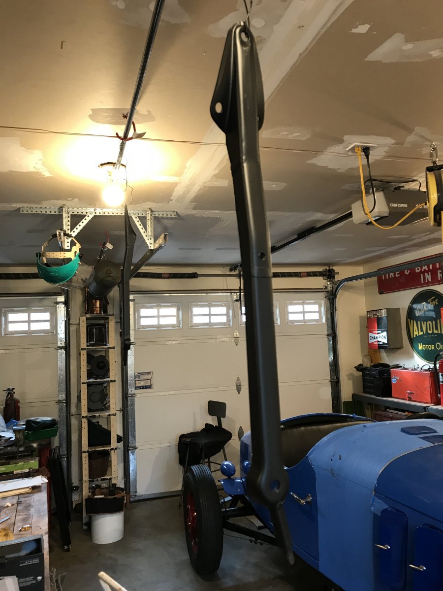

    Thanks for the nudge, @Hitchhiker and @s55mercury66 . Yes, there’s been progress. I finished the frame, and now have gl***.
    Huge thanks to Doug and Ken at Victory Gl*** in Auburn. Great guys with an amazing portfolio of work, but still happy to take the time for humble project like mine.
    Here it is mocked up for final modification/fitting of the posts.
    With the frame centered I added the little wedges needed to square-up the posts.
    A little welding, a little grinding, a little prep, and now I’m waiting for paint to dry.

    OK, the windshield is done and installed, and I’m pretty happy with the result. After all, I've been going around and around trying to devise a solution in my head for years! Yes, it’s an amateur job cobbled together from multiple parts of multiple marques. But it ended up looking pretty good.
    I could maybe wish I’d made it an inch or so lower, but that's splitting hairs.
    Chevy w/s mounts being slightly bigger than Ford, had I to shim up the Model T mounts to fit. I made the shims out of 18 gauge, which filled the gap perfectly. Since they are tapered, the shims are essentially a segment of a cone, 1 1/4” top, 1 1/8” bottom. This was probalby overthinking it, but it was a fun opportunity to dredge up ancient junior high memories from Mr. Wade’s technical drawing cl***.
    I think Mr. Wade would have given the project a C+. But it got the job done.
    More elegant is the matched pair of vintage beveled mirrors that I dug up out of @Hitchhiker 's Big-Box-O-Mirrors. Thanks Matt!
    I drilled and tapped them right into the posts. A huge improvement from the clamp-on mirror I was using.

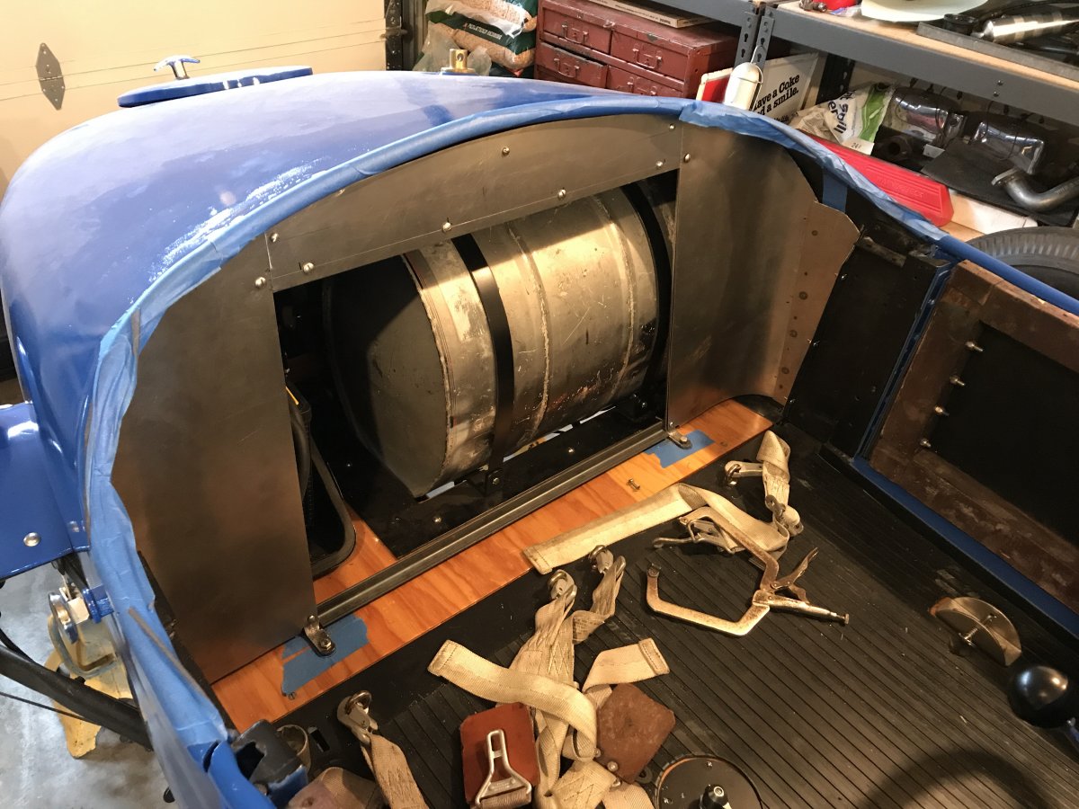

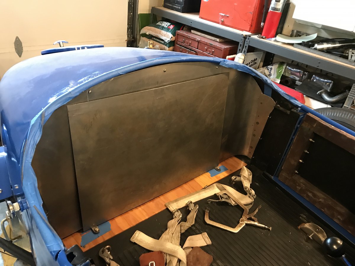

    Another winter project has been the installation of a back panel/firewall in the ****pit to separate the seating area from the gas tank. In some ways it seems kind of shame to do this—everyone gets a kick out of the peekaboo view the cool aluminum aviation tank back behind the seat. But sometimes those darn safety considerations have to take precedence.
    My thinking is to create a curved back panel with a removable access hatch for the battery and fuel tank. Frankly, at this point I'm afraid it may not be the most graceful thing. But thankfully it will be covered when I get around to installing a proper interior (next winter’s project?)
    I initially tried (and failed) to form the curved side panels and mounting lips in one piece. That would have been a nice clean approach but proved to be beyond my skill set. Rather than waste sheet metal on repeated attempts, I just cut the lips off and made overlapping flanges that could be fitted and tacked together. Easy but ugly. Anybody with a s**** of dignity probably would probably skip posting these pics, but here goes.
    First try:
    Fail! (Hard to see, but in the pic below the flanges don't align with the door support where they're supposed to attach.)

    So now I’m fitting the panels and framework together, and then I’ll get to work on the hatch cover.

    Well, more to report. And since like most of us I’m going to have time on my hands in the coming weeks, I’ll try to keep the updates coming. We all need something to occupy our minds
    With no stores or salvage yards at hand, I'm forced to be little more creative with materials, and a little more accepting of good enough. I guess that’s hot-rodding.
    I got my firewall fully roughed in and started work on the cover panel. Some of the fastener heads are mismatched because I’m using what stock I have squirreled away in my old Equipto boxes; least of my worries, as fasteners can be changed later.
    I lined the panel with rubber trim to cover the sharp edge and reduce rattles. Used a section of rubber trim with an internal band of metal clip that I turned up in a box of random estate sale stuff from years ago.
    Then I discovered the discreet little clips I had planned to use for this were too small to span the trim.
    I thought on this for a bit, and conjured up a dim memory of something, somewhere, that might do the job. This led to couple hours sifting through my swap meet boxes. (Pause for a sigh or two—tomorrow would have been Portland set-up day.) Eventually I found them—a set of stainless hasps that I picked up in a building salvage yard a while ago and, thankfully, nobody wanted to buy at the last two meets.
    Now I’ll be the first to admit, these don’t look period at all. On the plus side, they will be hidden behind the seat, and they are adjustable, which will make fitting a lot easier. And their primary feature is that I already had them.
    So, the next thing to do was make some catches for these to latch into. I figure I’d use my torch and pliers to make some from flat stock. Heavy duty overkill, I suppose, but easy to do. Fortunately, when I saw the shutdown coming, I exchanged my oxy/acc and mig shielding bottles so I wouldn’t be caught short. Unfortunately, I now discovered they gave me an empty acc bottle! :(

    The cover is 20 gauge and kind of floppy. I figure I can roll a couple of beads into it later (when I have access to a bead roller). Again, the tension on those latches is adjustable, so I can easily accommodate any minor distortion the beads introduce.
