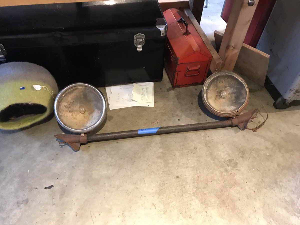

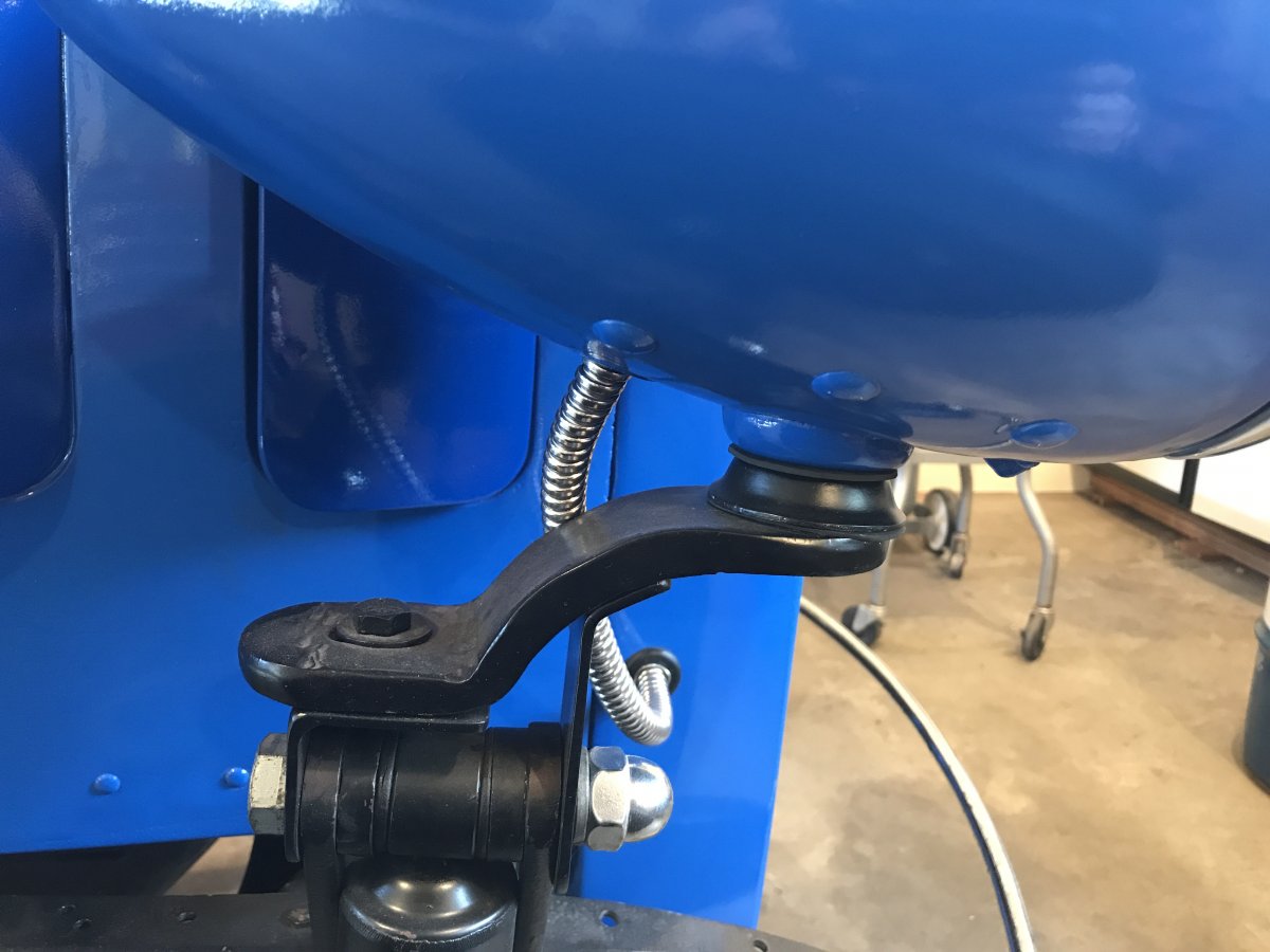

    Here’s another Quarantine Project in Progress: Headlights.

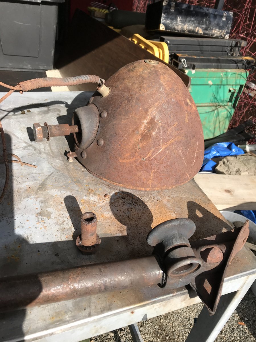

    I have never been happy with my headlight mounts. They are an adaptation of the homemade mounts that came with the car, and don’t work well.
    The lights are difficult to align and don’t stay in adjustment long. Any time I drive it, the car ends up all googly-eyed—one light pointing slightly up, the other slightly sideways. I don’t drive at night and most folks don’t notice, but it bugs me; seems like I fiddle with them whenever I stop.
    I’ve been keeping my eye out for a solution, and it presented itself in February at the Puyallup Early Bird Swap Meet (ah, remember swap meets?), where I scored this Tilt-Ray setup for a whopping $12. Off a truck, I’m guessing.

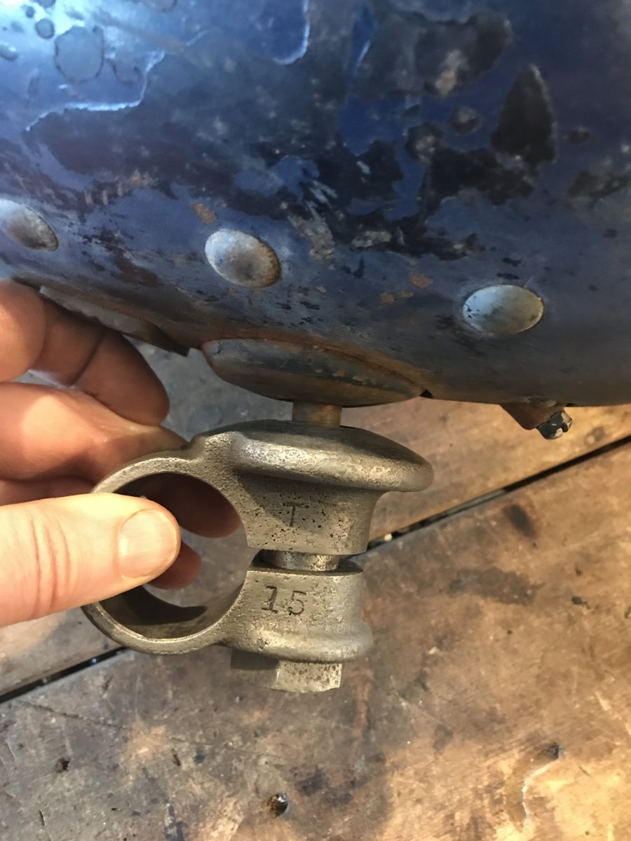

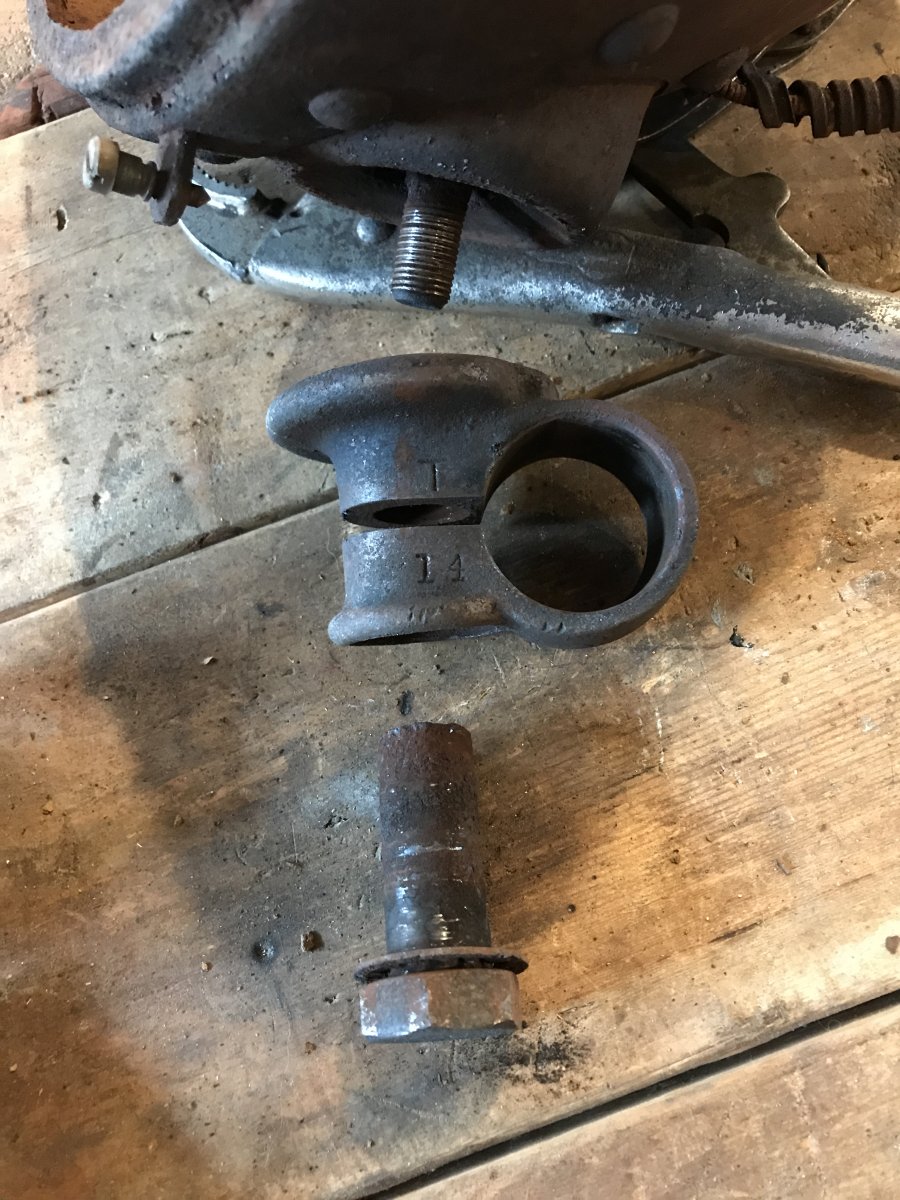

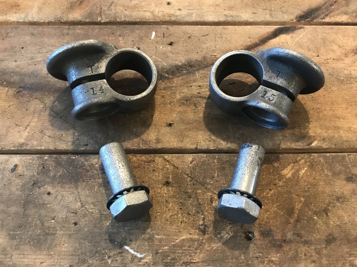

    Ignore the bar and headlights, it's the mounts that caught my attention. Each is a collar that clamps to the bar, allowing the individual bucket to rotate up or down as a unit, as well as pivot on a horizontal axis. Some of you guys are probably familiar with this setup, but it’s the first time I’ve seen it. I presume this is where the name Tilt-Ray originated.
    That tensioning “bolt” runs through the mount and has internal female threads into which the bolt at the base of the headlight threads. Nice, positive attachment that also serves to tighten the clamp on the clamp bar. Here they are, mocked up after three weeks soaking in mol***es. (Not shown is the double-concave spacer, which fortunately I do have.)

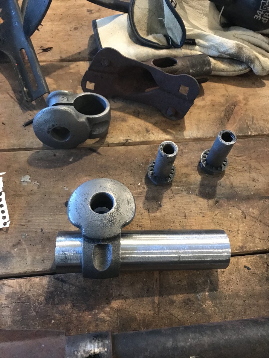

    So my thinking is to create a bracket for the shock tower that incorporates a short piece of tubing to which these clamp-mounts can be affixed. A little bit of rummaging in my s**** pile turned up a piece of tubing that was close to what I needed, and after grinding it down about 1/16 of an inch (i.e. 1/32 all around) it fits perfect.
    For the bracket itself, I have an odd plan. More rooting around turned up a likely donor in the form of this old battery tray, which is now taking its turn in the mol***es bath.
    Since I can’t draw a picture that’s worth a damn—Mr. Wade, my old technical drawing instructor whom I’ve mentioned before, could attest to that—I must I leave you all to ponder exactly what it is I have in mind.
    That’s where I am now, and I’ll give a headlight progress update once the bracket donor is sufficiently de-rusted.

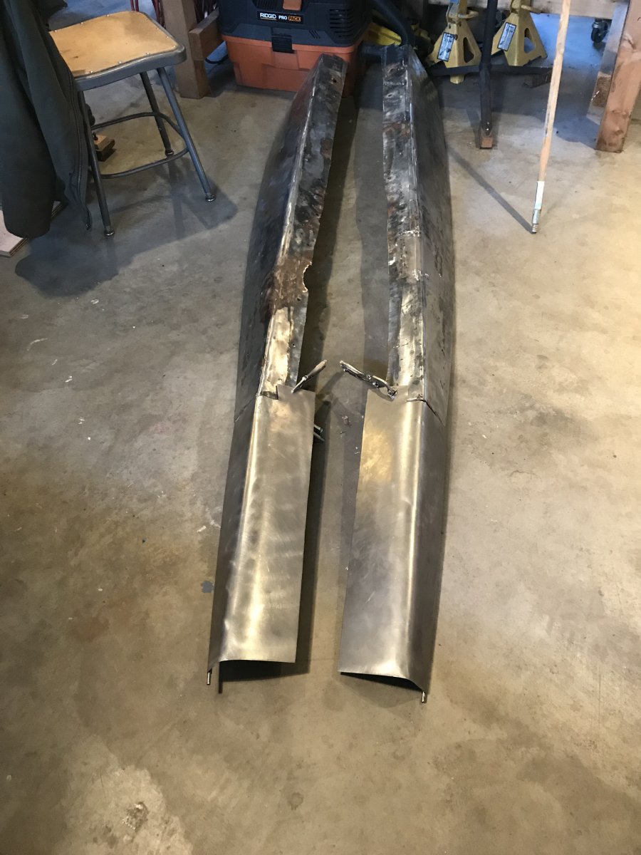

    So I’ve moved on to a project that’s been in the works a long time: Splash Aprons. And I’ll tell you in advance this is turning into another of those hit-and-miss operations any other damn fool would just keep to himself. But you’re used to this sort of thing from me by now, so no holding back.

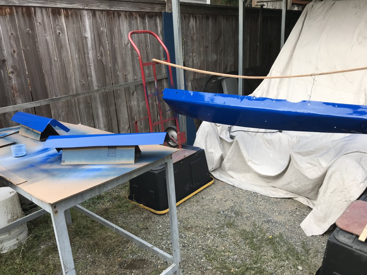

    This car came with home-made splash aprons from its original build. They were fairly well made at one time but decades of abuse were showing. A couple years ago I repaired them as best I could—beat the dents out and patched a big hole—and made some new extensions for the front. I did a post on that project back in December 2017.
    Finally, last September, I took advantage of the last 65 degree+ day of the year to paint them using the remainder of the dark blue I’d used on my hood panels.
    Despite being a quick-and-dirty gravel driveway job, the paint came out pretty decent. And that’s a problem, because the darn things have plagued me ever since. When they were raw metal I just stacked them together on a shelf and didn’t give them a second thought. Once painted, they preyed on my mind; I kept them wrapped on a bench top, and I knew it was just a matter of time before I did something stupid to screw up the paint.

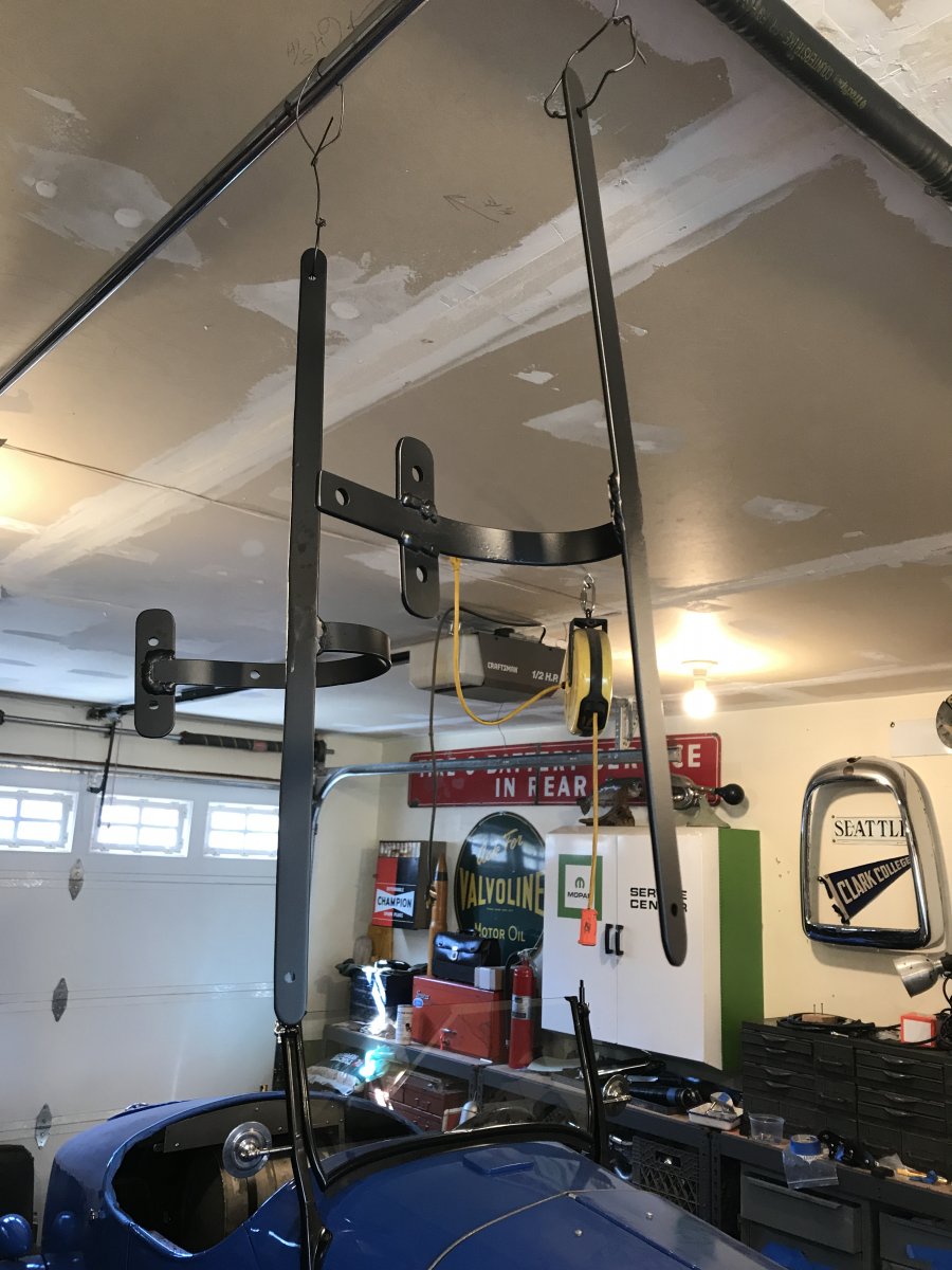

    Here’s a look at the starting point:
    In true hot-rodder fashion I tried the hopeless shortcut first: removed the bolts holding the body to the left side of the ch***is, wiped the apron with Gibbs, and tried to worm the splash apron in between the body and the top of the welting. Well, that didn't work. This is as far as I got; can’t go further without lifting the body:
    So I spent yesterday getting started on the “right” way. i.e. uncoupling or loosen every hard connection (steering column, seat braces, ground wires, etc.) But all the while I kept wondering how the body would react to being lifted as a whole. How will my humble floor welds fare trying to support the weight of the entire body? This body is all one piece, and I kept imagining it getting sprung at the door openings. And what if I don't like the look of the things once they’re in there? Am I going to do this all over again to remove them?
    That’s when it hit me. I channeled my inner @porkn****** and realized, just like his recent thread warns, I was over thinking this. Just because the guy who built this car in the early ‘50s sandwiched the apron lips between body and frame doesn’t mean I have to. I can just cut the damn lips off and make some brackets to bolt them to the outside of the frame. Easy to install, and easy to remove later, in case I don’t like them or want to replace them with nicer louvered ones (a project for the next pandemic).
    That’s where I’m at now, plotting out where exactly to cut these apron tops and how the support brackets will work. Kind of a shame I had to do all that removal work before I could get to this point, but sometimes that’s how my mind "works."
    And besides, it gave me something to do. I’ll keep you posted.

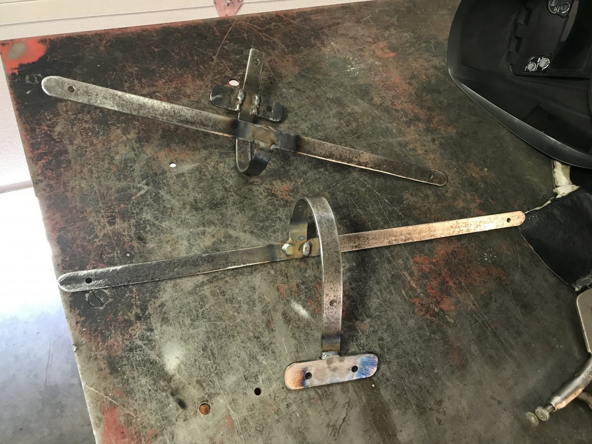

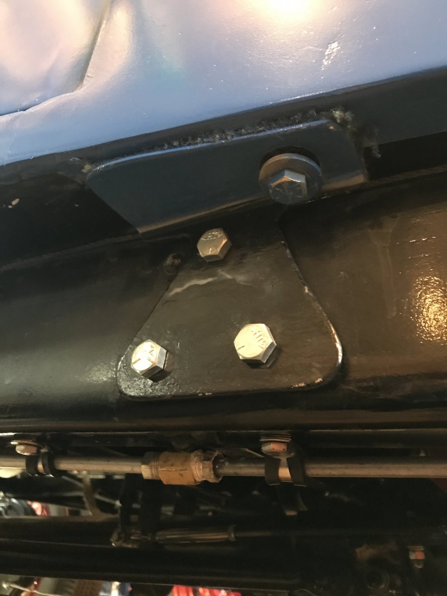

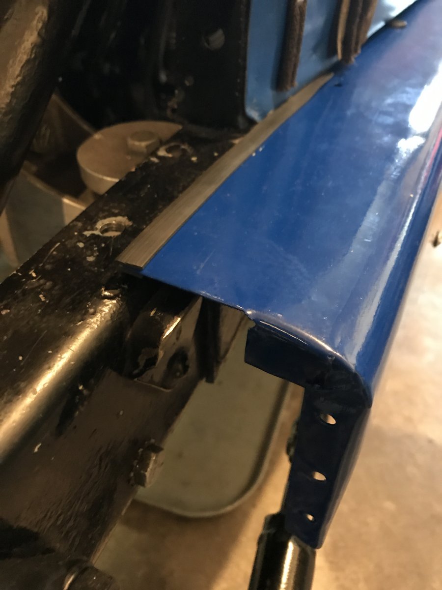

    The splash apron project is coming along. I started with the driver’s side because it’s the harder of the two and it’s alignment needs to take the steering components into consideration. I made a template out of cardboard and trimmed the splash apron to fit the curvature of the frame. The car already has a pair of homemade body mounts that affix to the frame in place of the running board brackets.
    It was relative straightforward to remove these, insert the upper edge of the apron, and clamp into place. The brackets had welting on them which I replaced with that old hockey player’s friend, friction tape. This allowed for the additional material sandwiched in there--the mount bolts wouldn’t align otherwise.
    That got the aprons roughly into place, and next I had to stabilize them. The aprons already had four bolt holes in each side, so I proceeded to make a pair of brackets that would lock into them.

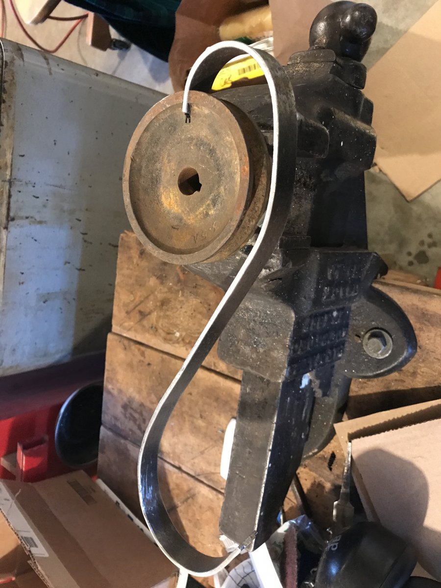

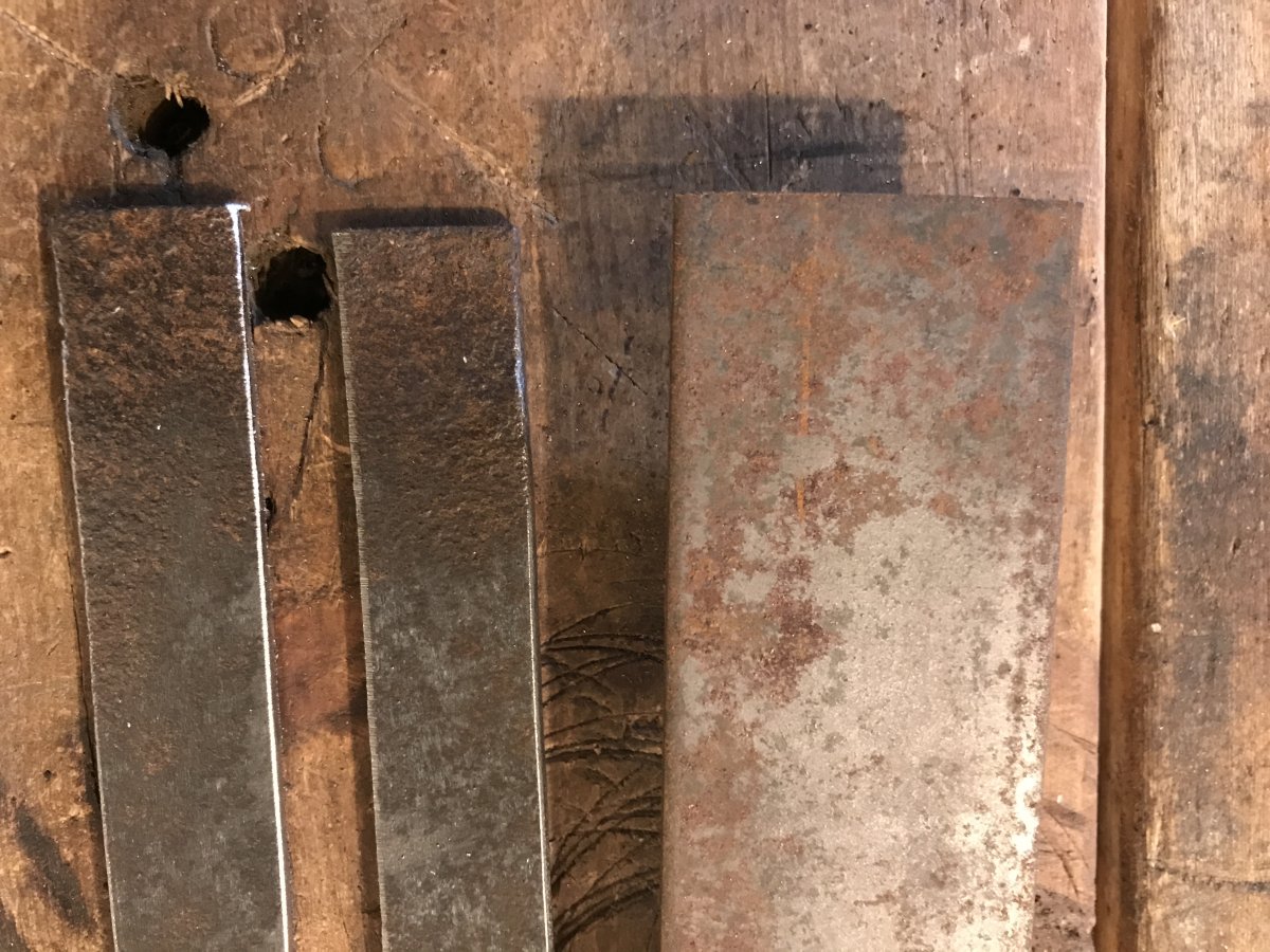

    I wanted to use 1/8th bar stock for this, but the smallest I had was 1.5” wide, double what I needed. So I split it using a jigsaw and carefully filed all the edges smooth. That was probably the most tedious part of the entire exercise.

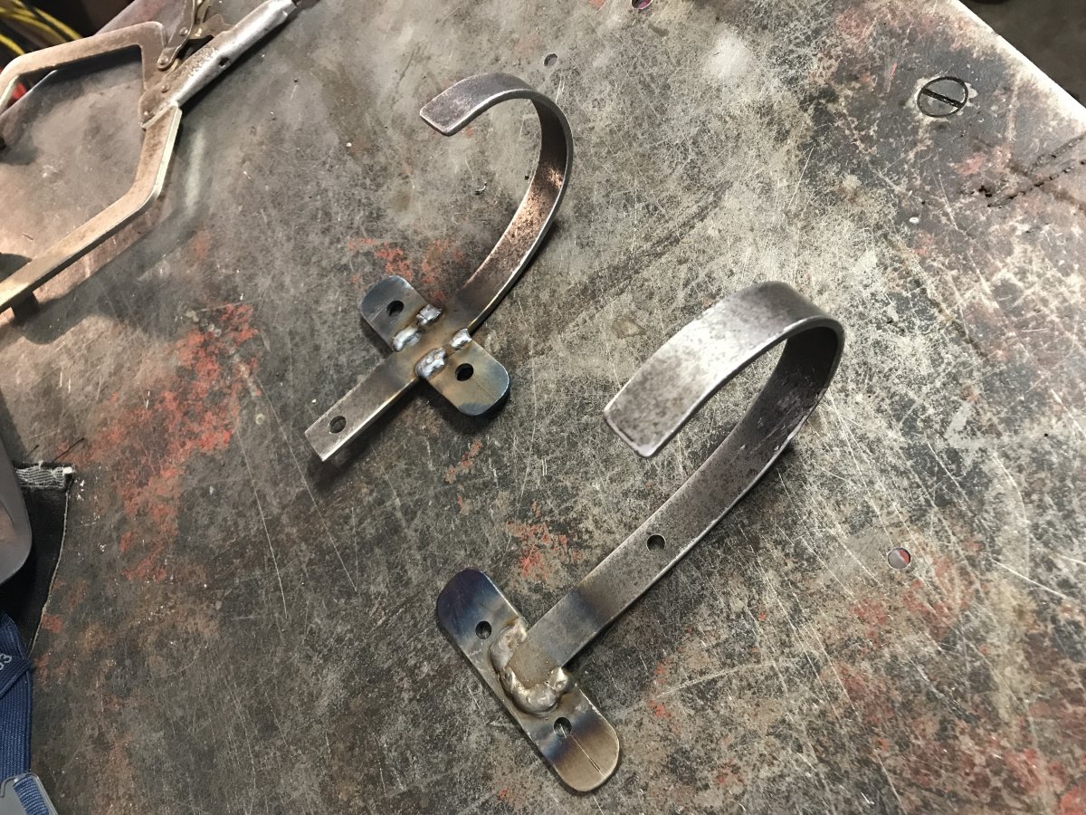

    I wanted the brackets to be firm but not rigid, and also to be somewhat adjustable. So I put a big curve into each support, and then welded and drilled tabs that correspond to the existing holes in the frame.
    I then added a pair of bars that each span a pair of existing holes in the apron. Installed and clamped everything, then tacked it lying under the car (everyone knows how fun that is). Put a big piece of copper between the bracket and apron so I wouldn’t cook the paint. Then removed, welded them up and painted them.
    When I got it all together, I was pleased at how solid it ended up. I was concerned it might be floppy. It isn't. After the stay-at-home order is lifted, I may replace the exposed fasteners with something more subtle--maybe black oxide or painted blue. On the other hand, I have exposed stainless elsewhere, and it kind of works.
    As a finishing touch, I used some new rubber trim I got at the last Puyallup Swap meet to put a nice clean edge on the exposed portion. Put another section at the rear; it’s out of sight, but should help reduce rattles.

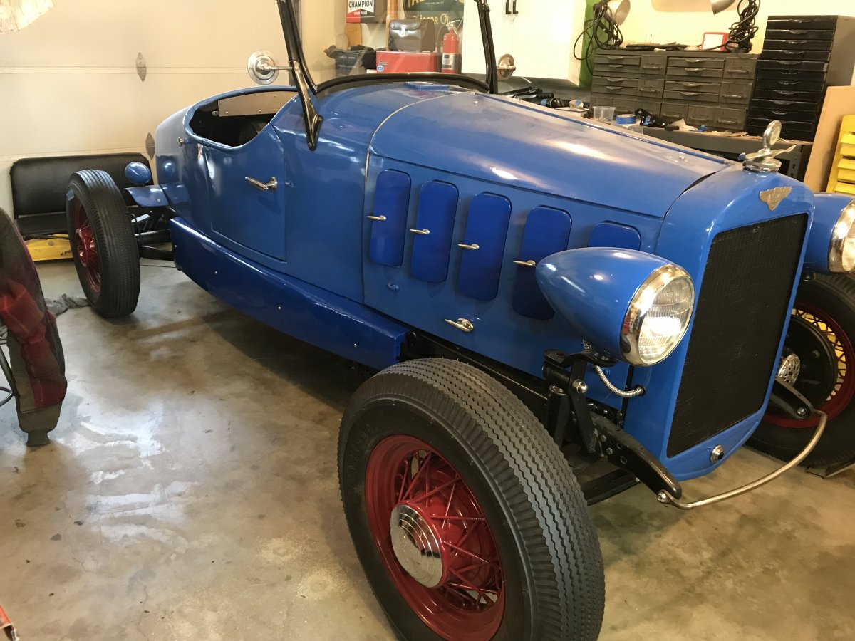

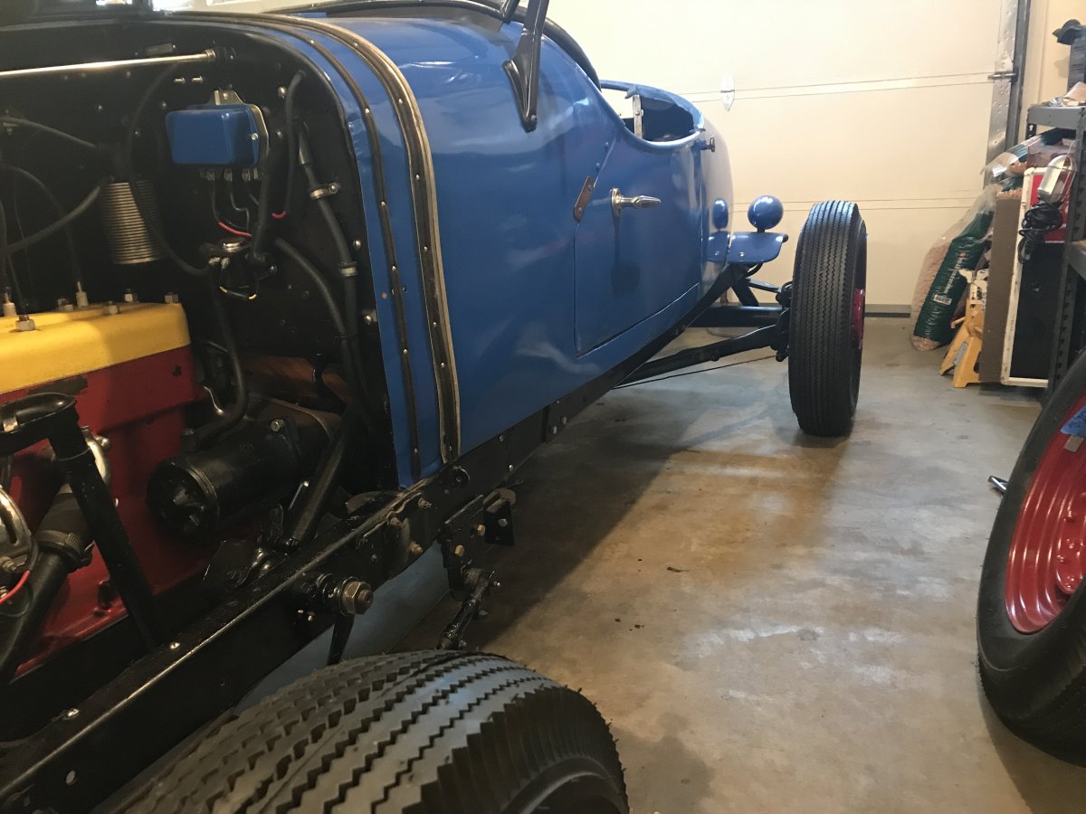

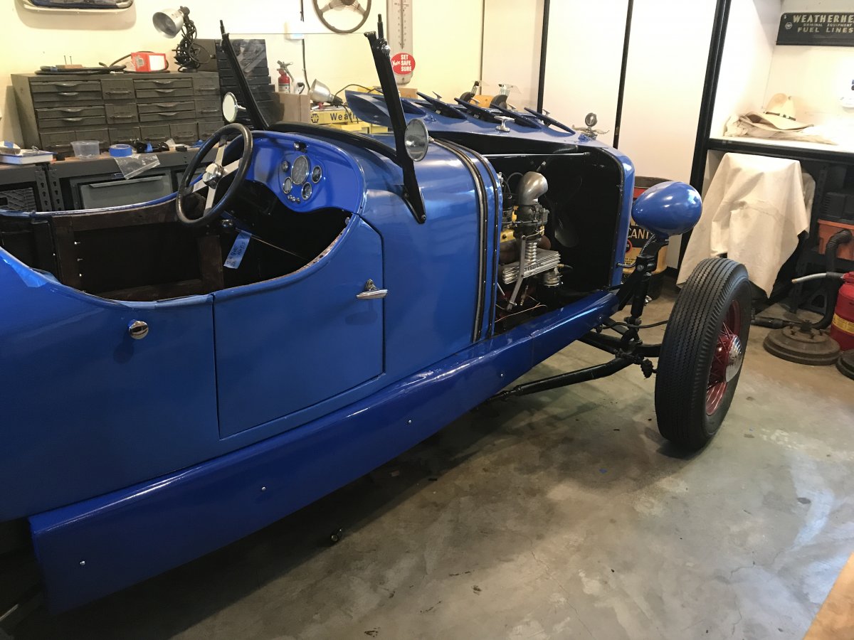

    Right side done! Installation was much easier second time around, so long as you don’t count the three times I banged my head on an exhaust clamp bolt. On to the front extensions.

    You know, I'm not a big fan of the splash guard look, and I thought you were making a mistake installing them, but I have to admit, that looks good, you did the right thing there.
    loudbang, Stogy, ClarkH and 1 other person like this.

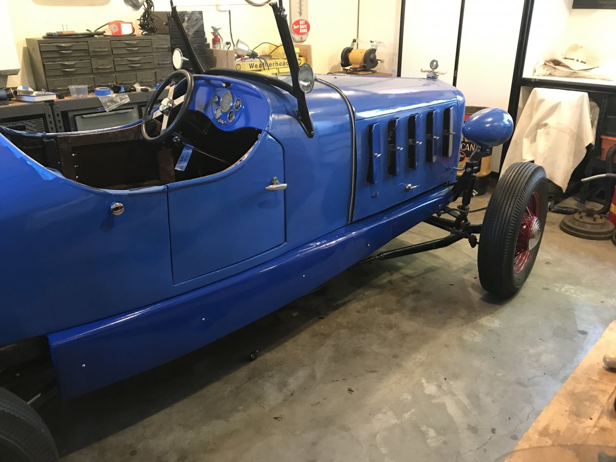

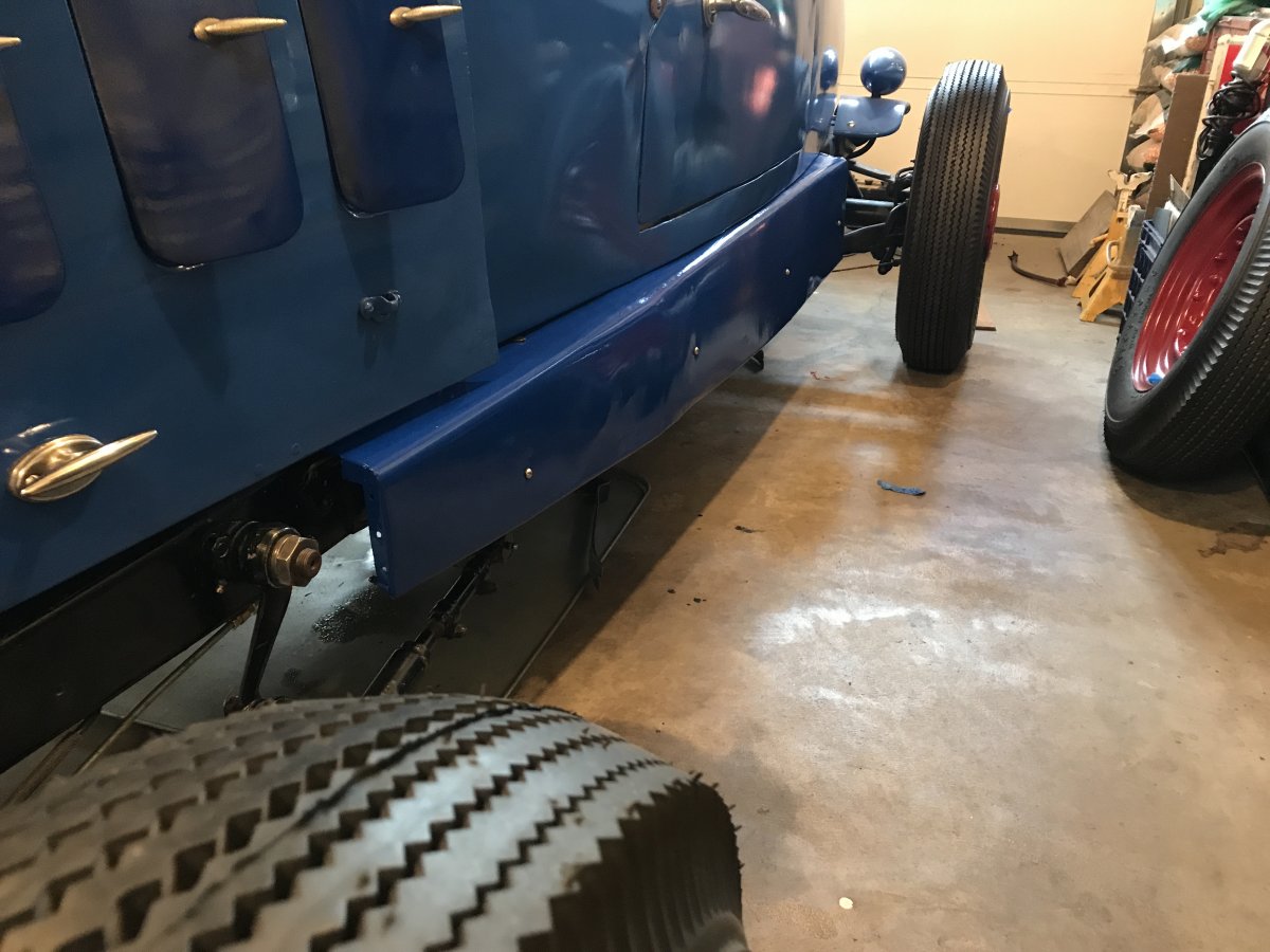

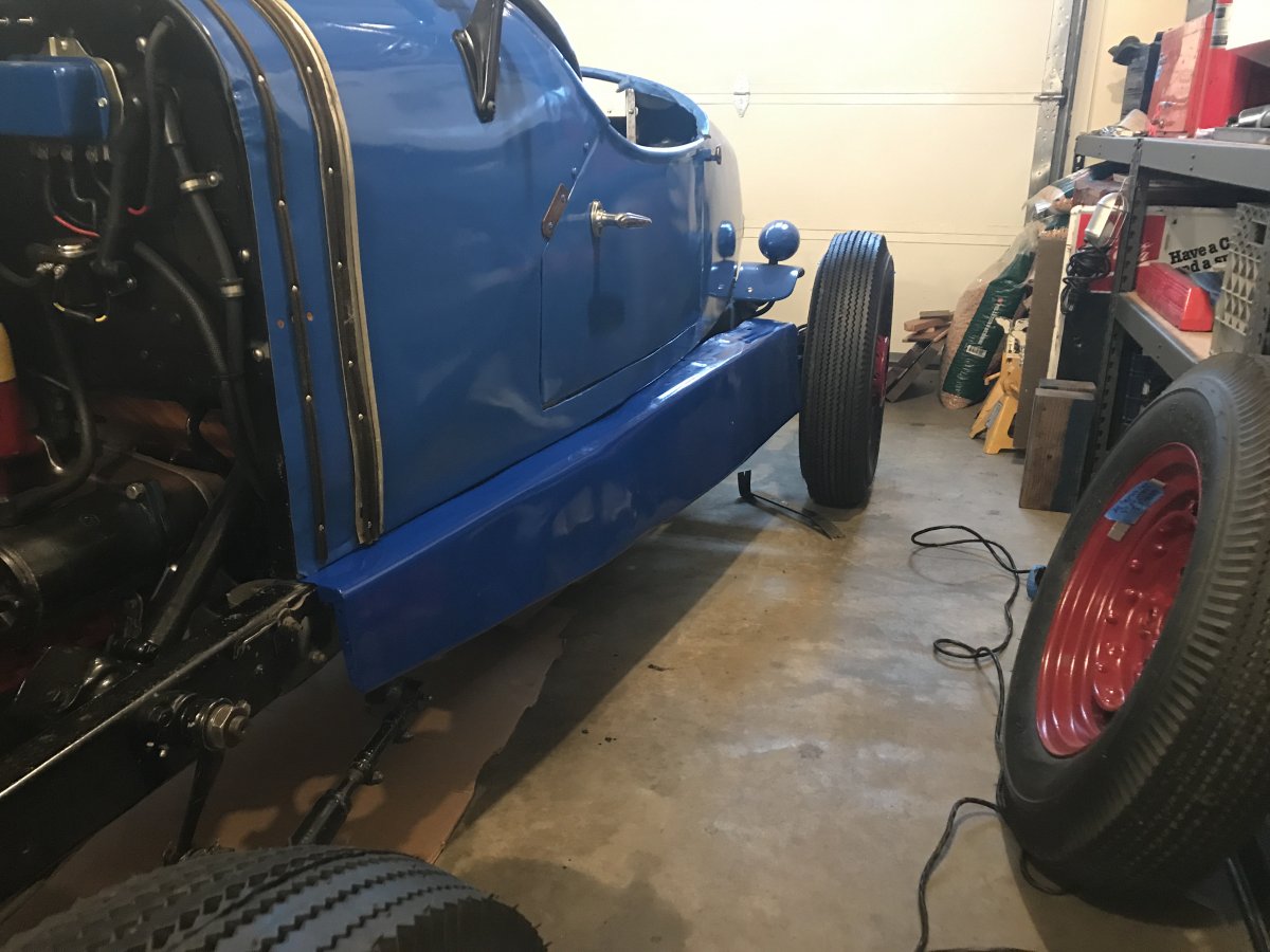

    Right front extension is in place. I started on the easy side this time. I like the overall upsweep.

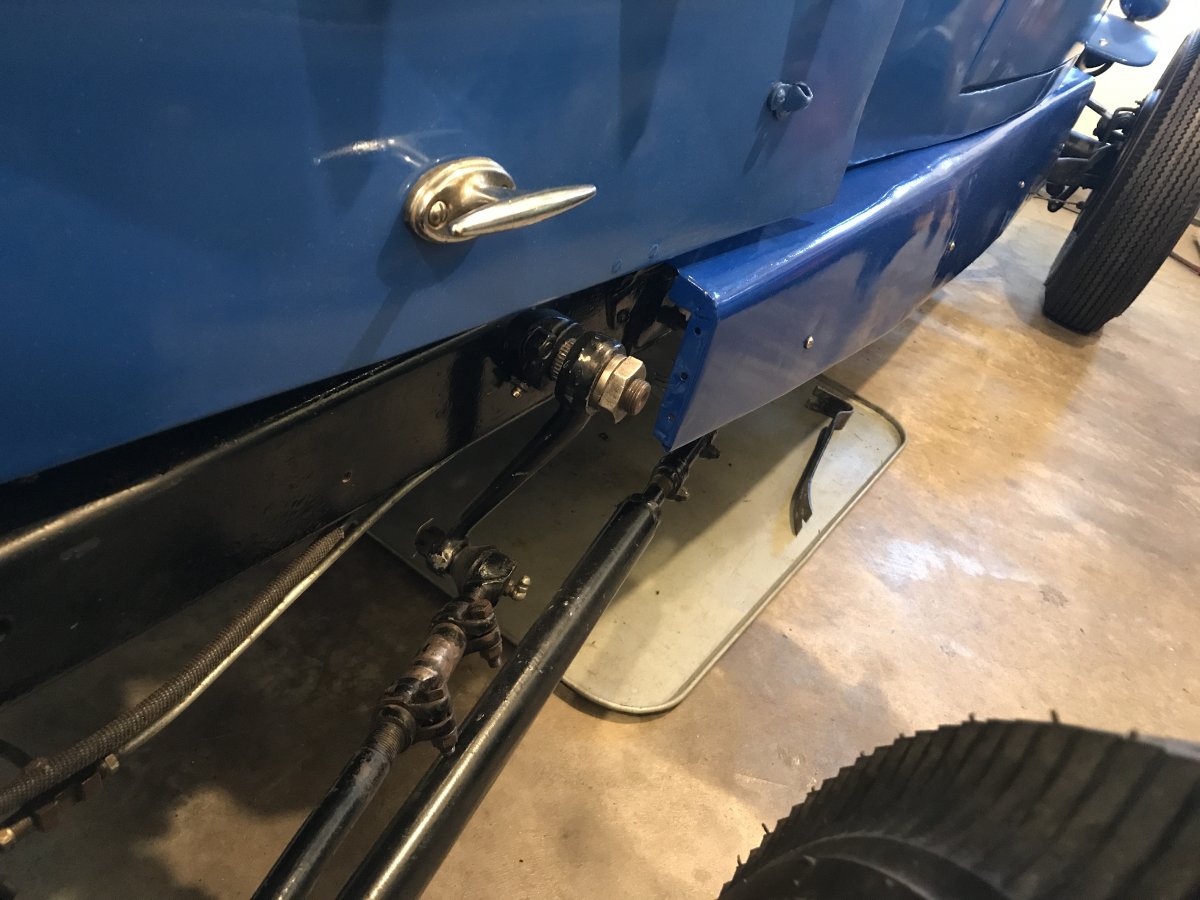

    Next up, the tricky left side. Here’s a picture of the challenge—interference with steering sector.

  22. ClarkH
    Joined: Jul 21, 2010
    Posts: 1,571
    ClarkH
    Got after the left extension yesterday. At first I was concerned about the size of the relief needed to allow for the steering sector and the fasteners holding the pitman arm. But after some careful measurement, I determined I could reduce the size of the hole by removing the thick lock washer from the shaft, thereby moving the nut inward.
    Now I only had to allow for the sector shaft itself:
    Does anybody see any reason why I can’t just use Lock***e on that nut? I can’t envision it coming loose spontaneously. And besides, the pitman arm has a taper fit—it won’t come off without a puller.

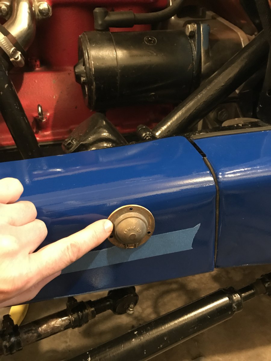

    Hadn't thought of that. Was thinking I'd maybe add a thin star-type lock washer later, but now you mention it a lock nut might be better. This is predicated on access to a fastern supplier, which is probablby a month away.
    Thanks Bob. Yeah, I'm planning on covering this with something. Problem is that making the hole larger to allow for the nut brings the hole into the curved area. Harder to cover cleanly.

    Thanks! Yeah, the hunt is on for a suitable cover. This the sort of thing I'd love scouring swap meets for under normal cir***stances. My preference would be something chrome/nickel/stainless, or else something I could paint. The hole is 1 1/8” diameter and the protrusion is just 1/4". So it doesn’t need to be big.

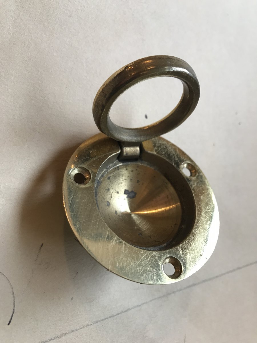

    I’m considering taking a page from @rwrj's Shade Tree thread. He's a wizard at adpting br*** marine stuff. Hunting through my boxes of stuff I found this:
    It's a fush-mount pull from a boat. If I remove the handle and flip it, it would cover everything.
    I’d want to file off the lettering and see if it will take a polish. Still, not sure about br*** or whether I should stick with my chrome theme. I’ll ponder.
